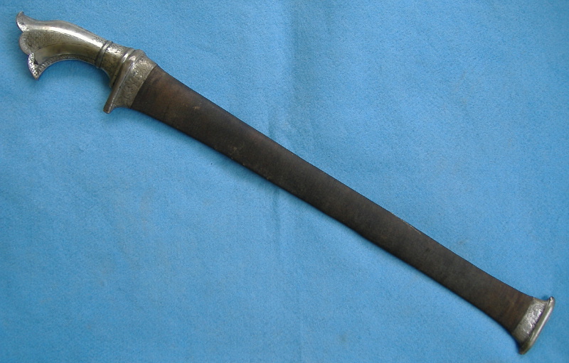

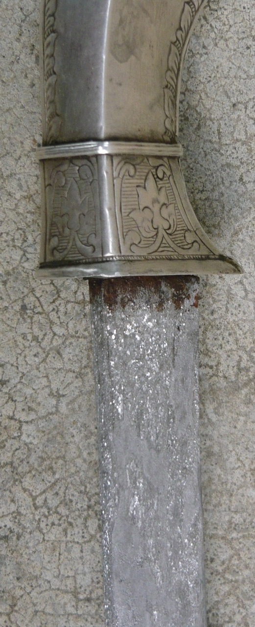

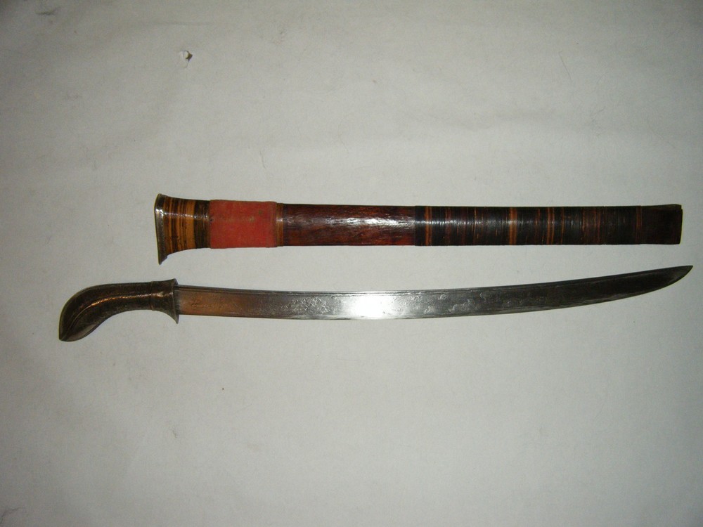

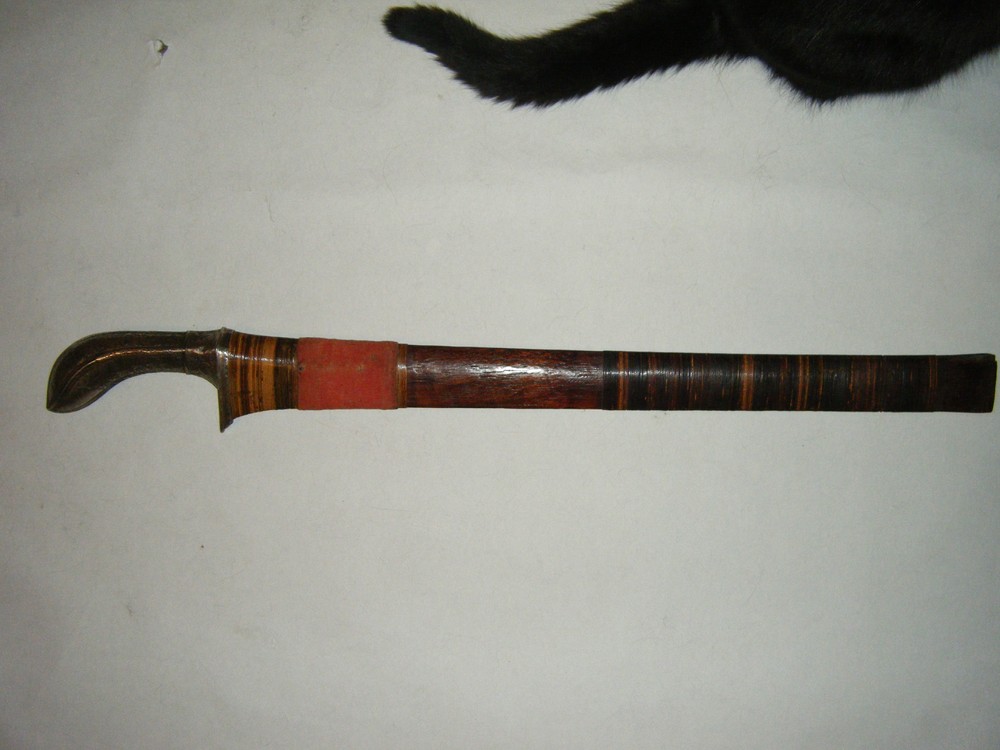

Today I received my new sword. I am nearly sure that it is a sudanga from Makassar. Look here: http://www.vikingsword.com/vb/showth...light=sulawesi, a example from Marco and here a example from Bill Marsh: http://www.vikingsword.com/vb/showth...light=sulawesi
Here some first fast taken pictures, will post more at weekend.

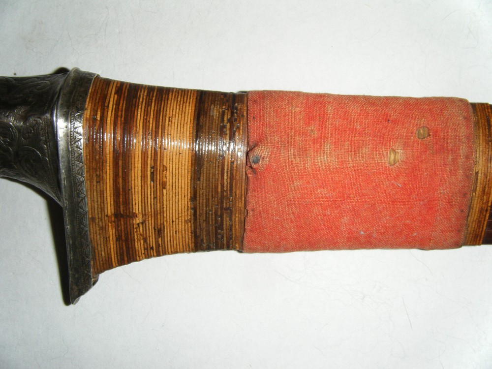

The silver end cap of the scabbard is missing as well some bindings from the rotan bindings. The silver handle has a small swassa ring and I think that the blade has a coating with some sort of clear varnish.
I am curious what you think about the sword and if you agree that it is a sudanga from Makassar.

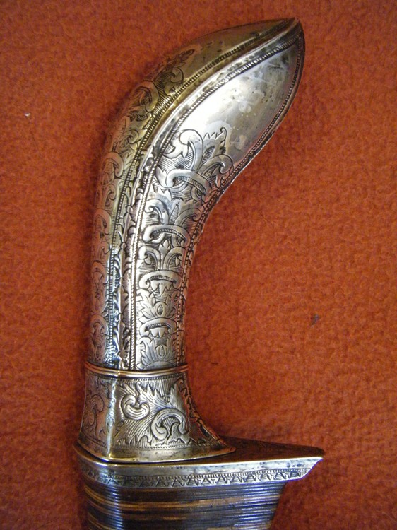

Interesting piece. Like the metal hilt - not too often seen. What is the material (hard to tell from the photos)?

Very nice . Is the hilt silver if so try using a silver polishing cloth on it. Would love to see the embossing. Actually was able to make it out what a beautiful hilt

Nice sword Detlef!
I would also place it as Makassar.

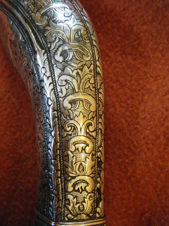

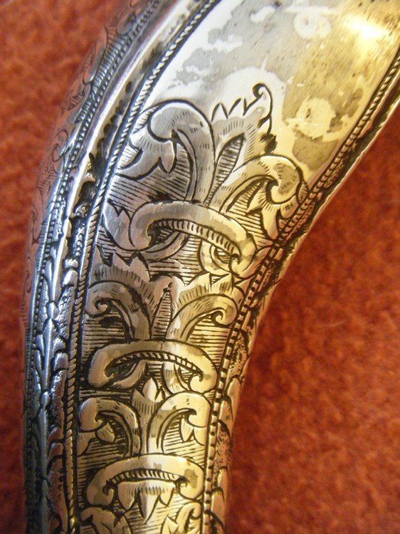

Hello Jose, the hilt seems to be from white metal (german silver ?) and silver plated. The ring seems to be from swassa.

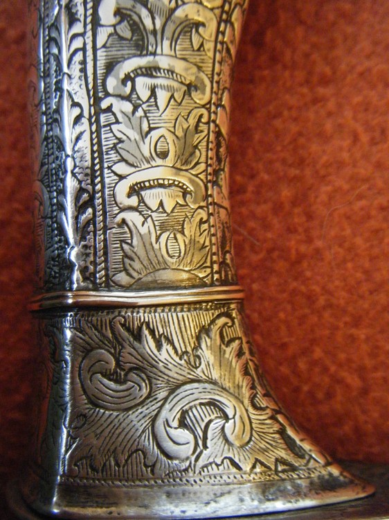

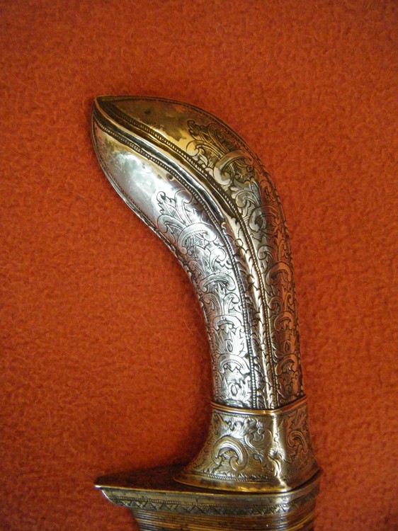

Here some additional pictures by daylight without flash.

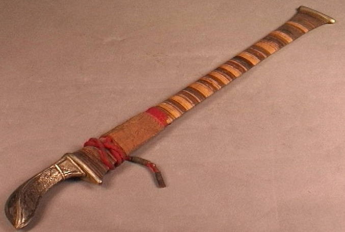

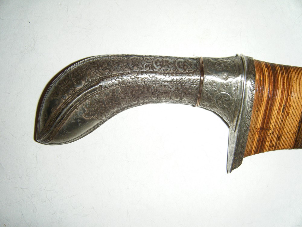

Hello Michael, I am sure we are correct. Here what Sipakatuo have written: "Sudanga the same as Kelewang/Parang. Makassar and Bugis people called Sudanga or Alameng. Sudanga wear by Chieftain or Panglima Perang/Ade Pitue (Member of tetua adat) therefore it is also a symbol of leadership. Not many people know about the shape of Sudanga/Alameng because of its prestige (produce limited). Congrats!.
" about the sword from Marco in this thread: http://www.vikingsword.com/vb/showth...light=sulawesi
See also the affinity from the embossings from both hilts.

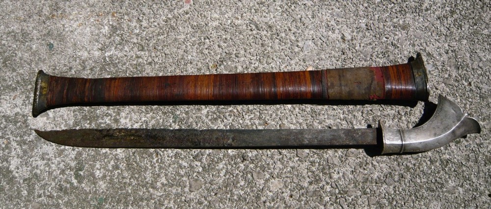

And now I am sure that also the beautiful sword from Bill Marsh, shown here: http://www.vikingsword.com/vb/showth...light=sulawesi
belong to this family of swords.
Old 25th January 2013, 12:14 PM   #8
Posts: 9,776

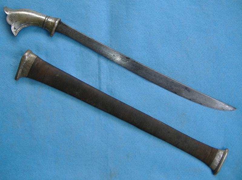

Here the three swords side by side for a easy view.
Hope it is ok for Charles that I have add his one to the overview!
Last edited by Sajen; 25th January 2013 at 03:32 PM. Reason: add Charles sword to the overview

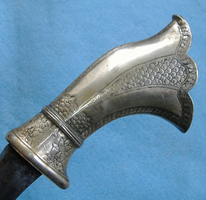

I had always associated this sword with Java, but now am beginning to think it is from Sulawesi afterall. Would you agree???

Hi Charles, yes I agree! look to # 7, the embossing in down of your handle is again very very similar. And the complete appearance of yours fit very well to the other shown examples. Very nice sword BTW.

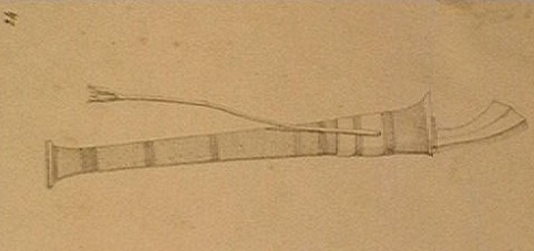

Found this on my search......
A very old drawing, no info further

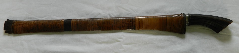

I've found a very old one from Preanger -> West Java.
The scabbardtip and - mouth are gone, but a nice addition is the inlay at the back of the obviously old blade. Never have seen inlay on these swords before at the spine of the blade.
It's very likely that these swords are from before 1850 (and probably earlier), as there is a big possibility they were out of fashion allready at that time.
I think a very undervalued piece in private collections, probably because people don't realize how old these pieces are!?!

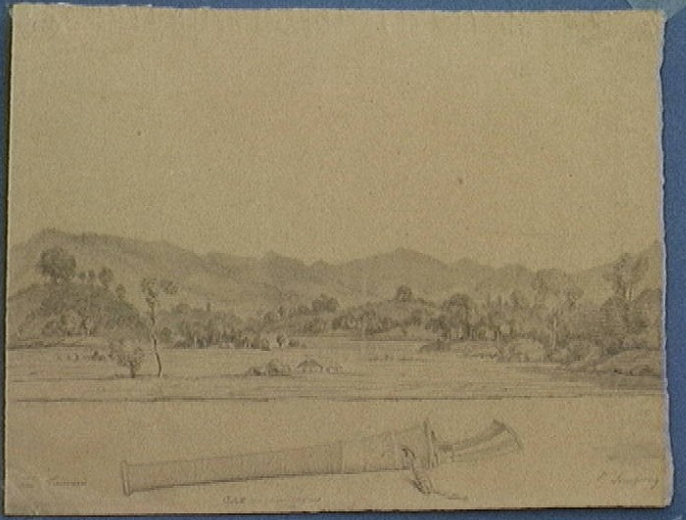

It's similar at the ones from the old drawings (post #24 and #25), which were made around 1825 (as I found out recently with help of a friendcollector).
Rg,
Maurice

Hi Maurice,
very nice one, thank you for posting this for our eyes!
