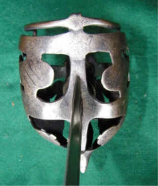

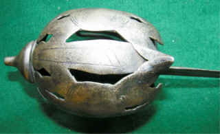

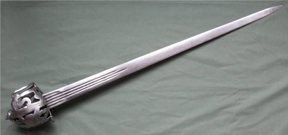

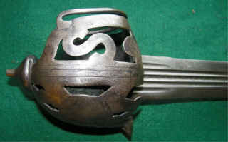

Default Scottish Ribbon Hilt Sword. Maker info
After much saving and scrimping I have at last acquired what I would call my dream Sword!
Can anyone help me with any info on the maker?

My God, this is a beautiful sword! May I ask where you found it?
I looked in my sources, even Bezdek's "German Swords and Swordmakers" and there is no listing of "Peter Knavee," nor is there a "Knavee" family.
I am curious to find out more about this.
Can you give us some stats, like weight, point of balance, total and blade length?

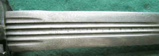

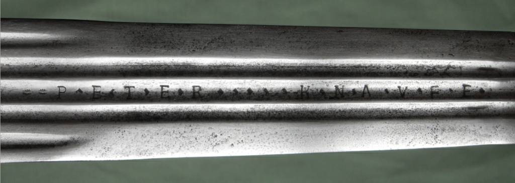

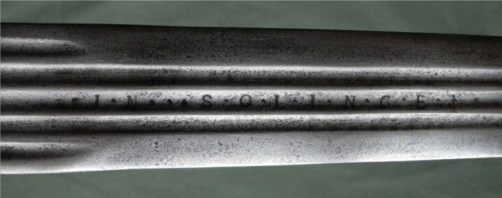

I acquired it recently from a fellow collector of Swords. I believe he bought it at Auction.
The Sword Blade is 84.5cm long, total length 98cm. Its 5.1cm max width.
1.52k in weight and the point of balance is about 7cm up from the Forte.
I think the surname is actually KNAVFE
Hope this helps.

Hi,
could et be "Knauer"?
This is a German family name.
Greetings, Helge

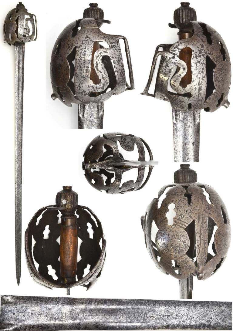

Originally Posted by templarnight
Many thanks for your comments.
Im having to clear out a few other items to keep this one though!!
A worthy exchange I would say!!!
These are very much my dream swords as well, and quite honestly the few examples I have seen of this 17th century form were in pretty rough shape.
The hilt style conforms to examples C4 and C4a ("British Basket Hilted Swords" Dr. Cyril Mazansky, 2005, p.71) and the disc as well as the connecting 'S' shape are distinctive features of these 'ribbon hilts'. It seems these typically will date in 1670s-1690s, and the Solingen blade form is characteristic with central triple fullers and short parallel fullers at either side.
In most cases, these blades seem to carry the familiar 'ANDREA FERARA' wording, so this one is of course quite interesting. This particular name does not occur in any of the regularly consulted references, however it seems to me that German surnames can vary considerably within the same family group as well of course as the spellings. This blade seems an outstanding example of the 'Grosse Schotten' type blades, distinctly produced by Solingen makers for thier Scottish clients, as large formidable broadswords for the Scots.
I personally have always considered the 'Andrea Ferara' as a kind of 'brand' labeling this style rather than being intended to spuriously represent a maker. This is discussed in the 'trademarks ' thread.
It would seem quite reasonable for a maker to use his name in place of this typically used term, and it would be great if we could find some record of him to better establish period for the sword.
While the sword itself is in accord with the forementioned period, it seems to me that the grip is more in the style of later British hilts using rayskin or fishskin with Turks heads and wire wrap. While some British 'mortuary' swords of the 17th century period seem to have had these type grips, most Scottish hilts used leather grips. It is my view that this sword may well have been refurbished for an officer in a Highland regiment later in the 18th century, or of course remains the possibility of even later refurbishing. In any case the blade and hilt seem homogenous.
This is a beautiful example, and without a doubt with a profound history which piques my own Highland ancestry!! and a Drambuie salute to this proud Scottish warrior!!!
Nicely done, and thank you so much for sharing it here,
All the best,

the name of the maker seems to be PETER KNAUFF or KNAUFE

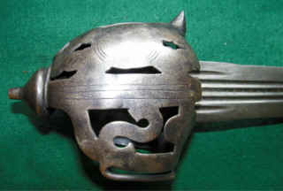

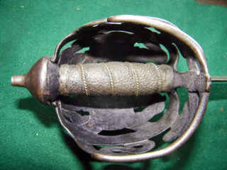

Is that just a scroll, or an "S" in the hilt?
Richard
Old 1st January 2014, 02:52 PM   #13
Richard
It looks like a well defined "S" ... for Scotland ?

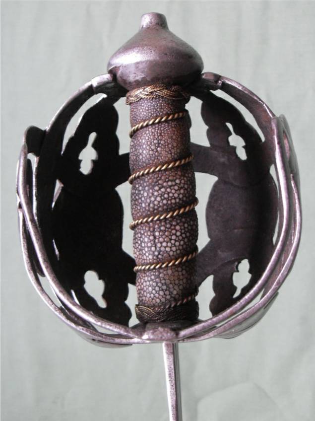

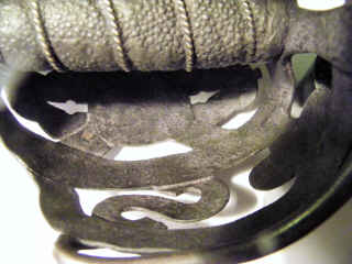

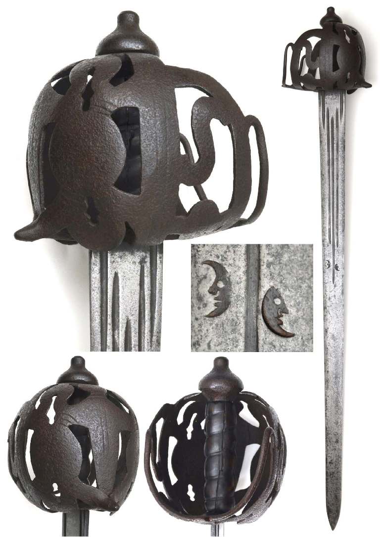

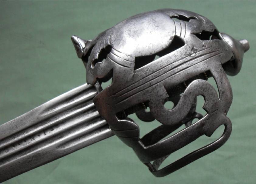

I have just joined this forum because I saw Templarnight's ribbon hilt last weekend. I have its twin brother or at least a kissin' cousin.
The only significant difference I can see, aside from the decorative piercing is that while his blade has the name Peter Knaupf, mine has the unbiquitous Andria Ferara, along with armourer's marks of an arc with three stars at each end on both sides of the blade.
The dimensions are nearly identical. It suggests that these swords, at the least, came out of the same shop.
I believe they are late in the ribbon hilt series based on the ring that joins the arms of the guards under the pommel. I have an earlier ribbon hilt in which the joining piece is simply a thin piece of iron.
The welding of the plates inside is very well done and all but invisible on the outside.
Most of my swords are on a thread on SFI started by Cathey Brimage, who also launched one here. Cathey, Eljay Erickson and I have been posting swords there are the last few months.
I saw some beautiful pieces on the thread on this forum, which Cathey was also involved in. Hope we can all share the goodies.

Sorry not to have posted this warning sooner.
After studying my sword closely and comparing it with known authentic ribbon hilts I concluded that it was a beautifully made reproduction.
I returned it to the dealer who did not dispute my conclusions. I learned very recently that it was sold on to another collector to whom I have explained my reasoning.
First, it is simply more than coincidental to find two swords, purportedly made in the 17th Century, with the names of different makers -- one of whom is unknown -- that are identical in every respect.
Second, it is also more than coincidental that neither sword shows any marks of use, no dings or dents, which a real ribbon hilt has in abundance.
Handling the one sword in comparison with other, authentic, swords offers the "feeling" that it just isn't right.
I learned later that my sword came through an English dealer who has a reputation for distributing iffy pieces.
In my case at least its purchase was a matter of enthusiasm overcoming good sense because my firm belief now is that both swords were not made in the 1600s but in the late 1900s or early 2000s.

I have been unable to find a Peter KNAVFF or KNAVEE in any of my references and if someone was going to add a fake maker, I would have thought they would have picked one who is easily identified and/or more desirable. The grip on both of these is obviously a latter replacement, but again given the age this is also not unusual and swords passed down through generations would require some upgrades if still in use.
I have two ribbon hilts which I will post, one early version and another similar to the ones posted here, although mine has had a much harder life. The hilt has a period replacement pommel from a rapier and someone has added to the collar to fit the wrong pommel. Very sad, but I have left it as is at this stage. This sword feels absolutely wonderful in the hand, very light and balanced.
