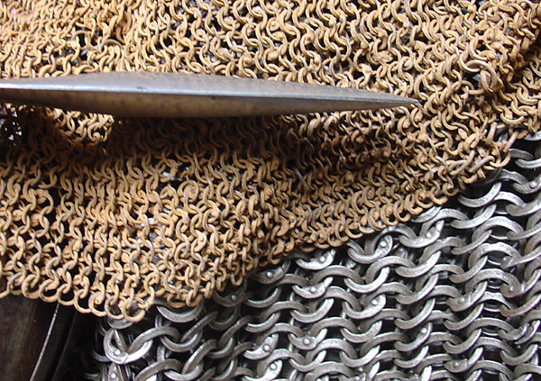

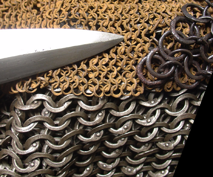

as for the katar and the chainmail shirts, this is a double ended arguement. some katars couldnt pierce chainmail, and some could. some chainmail could protect against a katar and some couldnt.
this is because no two shirts of the 800 were the same. the best fo them had two solid, heavy gauge plates at the front, with 3 rows of 'lamellar' plates at the back. the mail above the front plates (up to the neck area) were of a much heavier gauge and thickened for strength. each link was well crafted, and some chamfered to an almost sharp point, like mini chackrams. the mail reduced in size (evenly) down the arms and towards the bottom of the tunic. some had a mail collar, which doubled over the neck area. some had a seperate section, like a bishops mantle. these were the best of the lot and each shirt could match the quality of european shirts and repel even the thickest of katars. also, some had interspersed links with koranic verses (again, like the earlier ottoman shirts) which provided a talismatic feel for the wearer.
all the above description was not the majority of the shirts, but a large handful.
more than half were relatively crude. the front plates were thinner, the rear smaller plates of lighter gauge, the links uneven and poorly made, even small and light. i have seen a riveted chainmail shirt of the same period with some of the links of absolutely tiny size, giving a feeling of 'silk' when holding it.

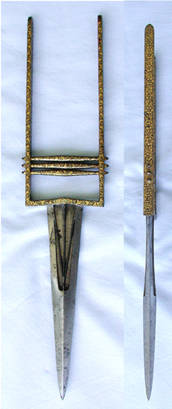

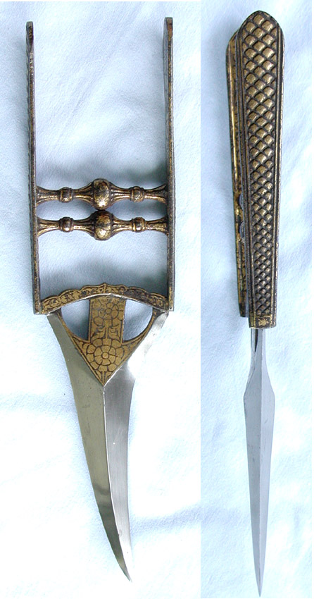

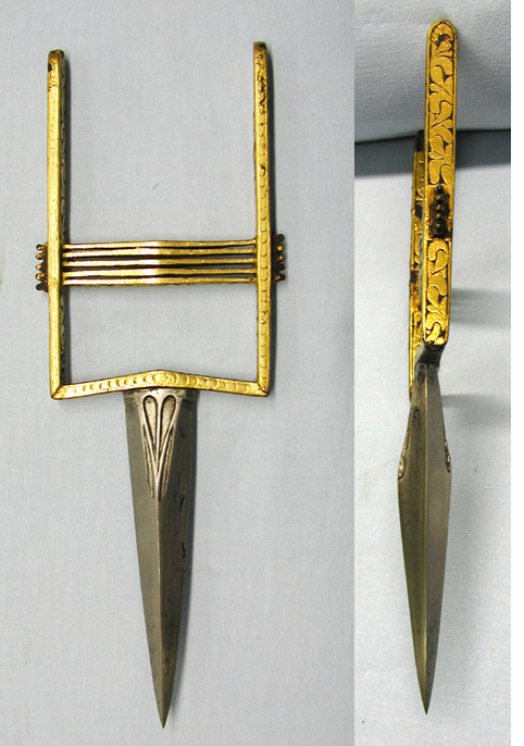

a good, thickened katar, wielded by an expert could not only punch through the chainmail, but maybe even the front plates as well.
it is for this reason i dont think a modern armourer can give an accurate assessment, as it would fully depend on both the offensive and defensive weapon in mind. a katar vs chainmail is way too vague.
a good katar vs a poor chainmail - yes.
a poor katar vs a good chainmail - no
a good katar vs a good chainmail, well life is too short to speculate on an arguement that will never have any conclusive answer :-)
as for the katar being purely civilian, or secondary, or not meant for battle - i think definately not. the katar was as much the national weapon of india as the tulwar was, maybe even more so. known in miniatures and sculpture since the second half of the 16thC, its form remained so for over 400 years. whilst the south and north both adapted there own style of sword (in the 16th/early 17thC), the katar remained the second weapon.
of course it could not be a primary weapon, as its a dagger and no warrior would go into battle holding a dagger first. however, it features in almost every 'battle' miniature throughout the moughul empire. there is no reason for them to carry it unless it was of some use. unfortunately most miniature show the warriors carrying a sword, but the katar is prominent in their belts, ready for use.
