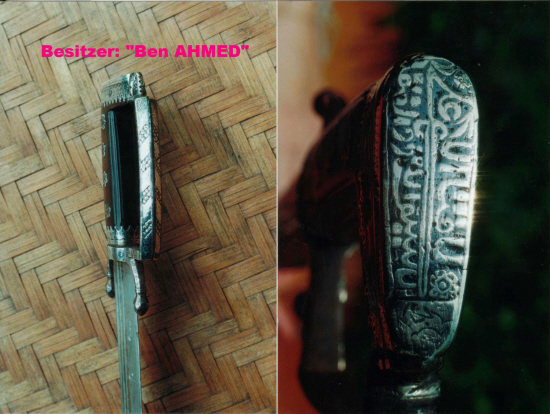

Old 7th August 2011, 04:24 PM   #39
Kurt
Kurt's Avatar
Join Date: Jul 2008
Location: Germany
Posts: 197
Default Nimcha ? Saif ?
Hi ,
Have found those pictures in my sold archives .
Think it is a Saif from the 18 century.
Does anyone know more?
Kurt
sorry for my bad English !
Kurt is offline   Reply With Quote
Old 9th August 2011, 05:16 AM   #40
tom hyle
Location: Houston, TX, USA
Posts: 1,254
very interesting! This style pommel is usually seen on Middle Eastern Arab swords, but usually with a Turkish/Persian style guard; here we see it with the Coastal African "nimcha" guard; an interesting combination.
Old 9th August 2011, 05:23 AM   #41
tom hyle
Posts: 1,254
Is that a picture of a double edged broadsword on the pommel of a saber?
Old 9th August 2011, 04:37 PM   #42
Kurt
Kurt's Avatar
Join Date: Jul 2008
Location: Germany
Posts: 197
Default broadsword
Hi Tom ,
Yes, it looks like a broadsword.
But I think it should represent the sword of the prophet.
Best
Kurt
Old 9th August 2011, 05:36 PM   #43
Posts: 10,862
The sharply angled hilt on this silver mounted sabre reminds me very much of certain Palestinian or Sinai Bedouin sabres, most of which I have seen are with crudely fashioned wood hilts and seem almost 'shashka' like. The heavy sabre trade blade seems like its been around a while, and interesting to see these most attractive mounts incorporating the Moroccan sa'if hilt. As such a hybrid it would be hard to accurately place in these more modern mounts, but definitely has some history, particularly the blade.
Interestingly the blockish and angled pommel cap, while of course aligned somewhat with the more refined design on most Persian shamshirs, has distinct affinity to certain early (c.1790s) British cavalry sabres. These in turn derived from a number of European 'hussar' sabres in use for considerable time before.
By propensity of style this sabre might be considered a Maghrebi anomaly, however it seems more likely from Arabian regions congruent to or with perhaps intertribal contact with these Bedouin groups in the areas mentioned.
Regarding the intriguing broadsword on the pommel cap, the Saudi Arabian emblem with Dhul'fiqar (I hope I spelled that correctly) does represent the Sword of the Prophet with bifurcated point as typically seen. However the Broadsword (double edged) seen here does show a distinct ridge or fuller in the blade center, bisecting the blade. As I have been led to understand, the translation of Dhul' fiqar is literally 'possessor of spines' (believed to be of course fullering) and perhaps here simply represents the 'cloven' or in two concept. In any case the mounts are of the type seen on the Sacred Swords in Istanbul, and very well may be intended to represent the Sword of the Prophet.
Old 9th August 2011, 06:06 PM   #44
LPCA
Join Date: Oct 2008
Location: Toulouse - FRANCE
Posts: 83
Nein, nein, nein, Kurt, not one of the Prophet saber for a lot of reasons
see there http://le-carrefour-de-lislam.com/At...eliquiae_2.htm
Yes Jim, it looks like a telescoping of an arabian Middle Eastern saïf and a Moroccan Nimcha guard. A blade of broad saber.
Really very curious.
Louis-Pierre
LPCA is offline   Reply With Quote
Old 9th August 2011, 06:18 PM   #45
A.alnakkas
A.alnakkas's Avatar
Join Date: Nov 2010
Location: Kuwait
Posts: 1,340
Nice sword. The sword inscription is indeed Dhul'fiqaar. The inscription even says the frequent line "la fata ela Ali, wa la saif ela dhul'fiqaar"

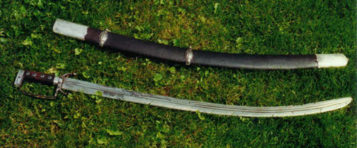

Old 18th August 2011, 10:10 PM   #46
Ibrahiim al Balooshi
Ibrahiim al Balooshi's Avatar
Join Date: Jul 2006
Posts: 4,408
Default Nimcha.
Salaams, I cannot add much to the already full and excellent discussion ...except...Nim means half in Baluchi and they take that from the Persian as noted in a previous detailed thread. It is not an Arabic word but again that is already discussed... so ...
This is a Zanzibari Nimcha. Not the cloisonned Algerian version nor the classic Magreb style. As Jim was saying in this and other related Nimcha threads these swords started life in Italian or Venetian roots. There are other variants including the Saudi item and cheaper hilted Yemeni variants but the one which makes ones eyes sparkle is the Omani or Zanzibari version ... When people say Omani Nimcha what they actually mean is Zanzibari (as already noted Oman owned it for a considerable period and it even became for a time the Omani capital !)
Apart from the obvious, there are two clues to origin;
1. The Hilt of Ivory.
2. The decorative gold Hilt pattern style.
Zanzibari traders favoured the Ivory hilt on their Nimchas...Being a trading hub for all things African, Zanzibar was well placed for the Ivory trade.
The decorative gold style is Indo/ Persian "Miri Bota" leaf pattern. Not likely to be done on a Nimcha other than a Zanzibari Nimcha. More than likely craftsmen from India worked in Zanzibar and the decoration was either done there or in India from which much trade exchanged with the Zanzibaris.
I have to add that the Nimcha puzzle is or has been one of the most difficult to crack open... and thanks to the Forum it is now somewhat clearer.
Ibrahiim al Balooshi.

Just received this one. Zanzibari......or Arabian made in Zanzibar?
Stu

Salaams...Looks like a Magrebi Nimcha. Ibrahiim.

Nice one Stu, congrats. Looks Zanzibari imo.

I own exactly the same Nimcha shown by kahnjar1. It is an arab nimcha made in Zanzibar, for Yemen i believe.
There are some keys to better recognize the different saïf and nimcha.
1 - the button that blocks the tang: see image (left: zanzibari - right: maghrebi - often a coin)
2 - the profile: see image - from left Saïf - Zanzibari - Maghrebi
3 - the Guard: first image: D Zanzibari guard - Second image: straight guard Maghrebi
3 - the protection against the shots sliding over the flat of the blade
image 1: Maghrebi protection (pitones) - image 2: Zanzibari protection.
With my kind regards
Louis-Pierre
NOT Magreb. The Magreb (Moroccan) has the dropping quillons and no D "guard"
Stu

Thanks Louis-Pierre, I think that clarifies things, and I do appreciate your clear comparisons.
If the idea of the hilt shape is sourced from other cultures or not, I guess we in the 21st Centuiry will never know for sure. Many long hours and thousands of words mean nothing without CONCLUSIVE proof, and I suspect that hundreds of years on, we will never be absolutely sure. Sufficient to say, we can only go on information we currently have to hand.
Regards Stu
