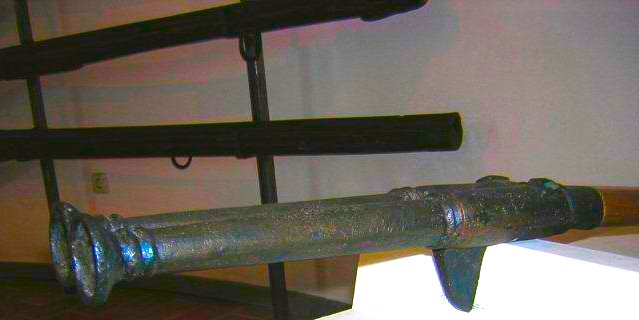

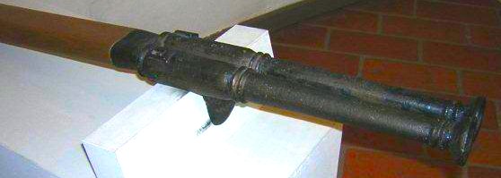

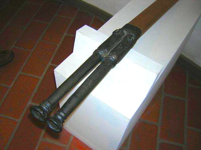

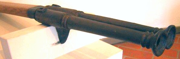

Got these pics from a pal who took them in Schloss Gottorp, the Schleswig Holstein Museum.
He did not give any measurements but, neglecting the replacement stock, I would estimate the length of the barrels to ca. 50-60 cm.
Please note the rectangularly raised priming pans that seem to be characteristic of the North of Germany and the early 15th century.
The recoil hook was perfect for firing them from behind a a large set targe or a hand targe in field fight. It is the only DB sample known to me to have survived from that early period.
This piece is also remarkable for its angled barrels designed to cover a broader range, and possibly loaded with a 'buckshot' like number of balls or pieces of lead or iron, in one word: blunder.
Best, Michael

Old 17th June 2010, 01:52 PM   #2
Superb .
Now i know where the modern gunmakers took the idea for blunderbuss barrels .
'Nando

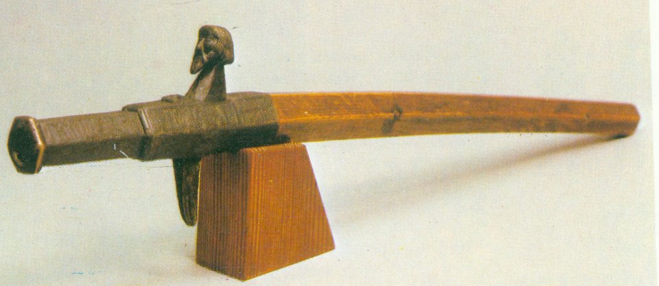

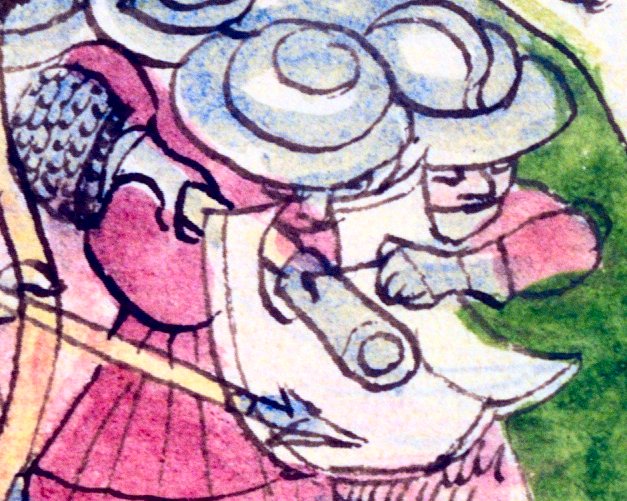

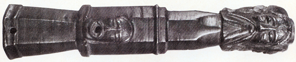

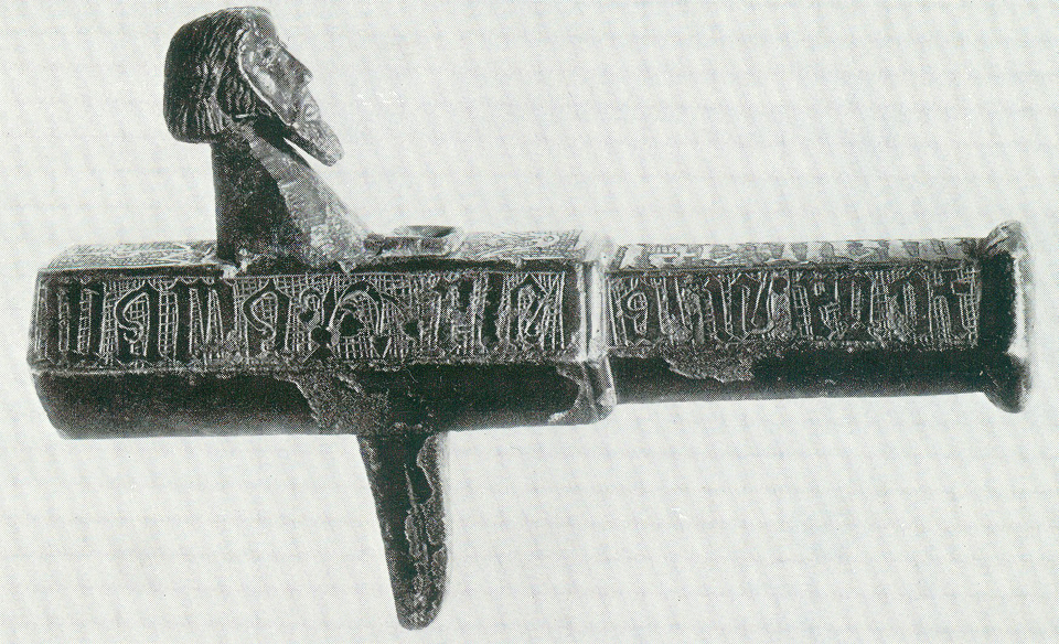

This is the famous Morkö gun, preserved in the Swedish National Museum Stockholm, early 15th century.
It, like the above posted double barrel gun, is of cast bronze and has a rectangular touchhole with a raised brim. As far as I remember, the Gothic minuscule script is illegible, its letters being just stylized ornaments.
Much has been said and written about the bearded head behind the touchhole; it seems like it reminds many people of traditional portraits of Jesus Christ.
I should add that the hand in the picture holds the small gun at a hook very similar to the one on the DB piece in Stockholm.
I will look for better pics of this fine and unique High Gothic little guy. Of course I will strictly keep them to myself and would never share them with anybody - except you, pals, that is:

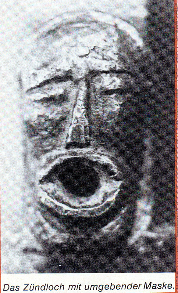

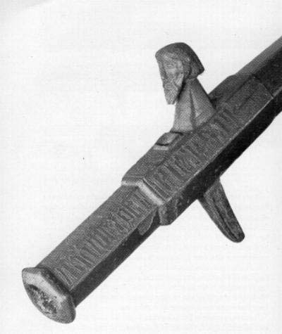

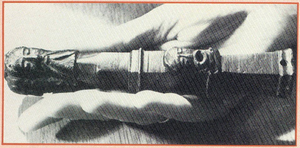

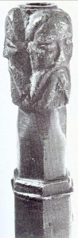

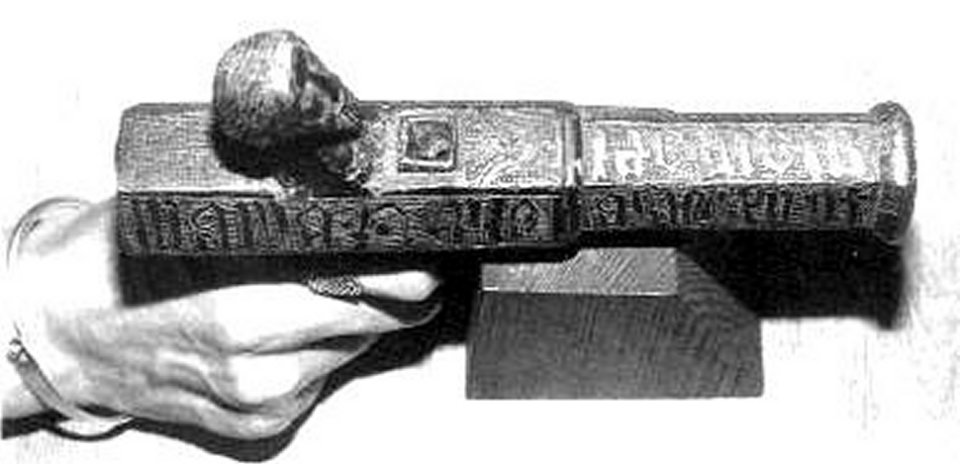

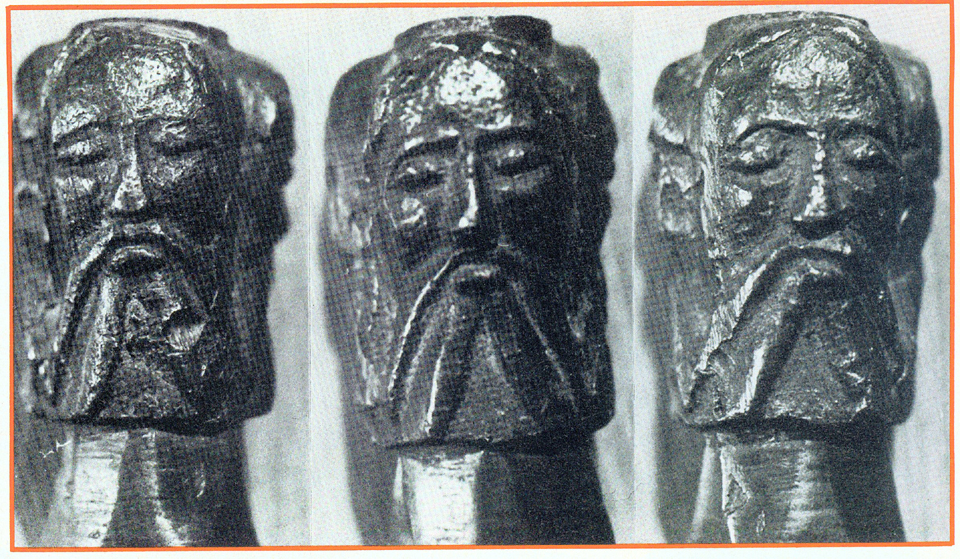

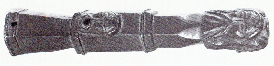

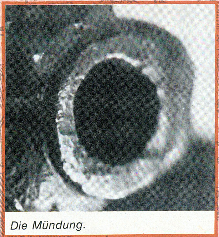

I have to apologize but I could not find but one single better photo of the Morkö (or Mörkö) gun.
The gun was excavated from the Baltic Sea near Nynäs, on the coast of Södermansland, by a fishing boat before 1828. After being in a couple of private collections, it finally found its home in the Swedish Royal Collections. It measures 19.3 cm overall, with a steady caliber of 21 mm smoothbore, weight 945 g, of hexagonal shape, which is characteristic of guns around or shortly after 1400, and the rear socket for the tiller stock is 6.9 cm long. As the first hooks on barrels do not seem to have appeared before ca. 1430, this feature gives a good reason for attributing this small gun (German Faustrohr) to about that date.
Depicting a bearded face in high relief is quite usual for artisans of the High Gothic period around 1400 and is also found e.g. on contemporary stoneware (see attachment of an earthen jug decorated with three bearded faces, ca. 1420, preserved in the Museum of Arts and Crafts in Frankfurt/Main). It certainly has nothing to do with the portrait of Jesus Christ but simply reflects the taste of fashion of that period and, of course, has an apotropaic (warding off disaster) function in those superstitious times as well.
This head of course blocks the sight when the gun is aimed but on the other hand acts as a fire guard.
The Gothic minuscule script mentions the word maria several times; the rest is, as I said, illegible and mere decoration. This religious invocation of Holy Mary is sometimes found on helmets and swords.
There is only one other contemporary and stylistically comparable small bronze Faustrohr known to exist, namely in a German private collection (not mine ). Its barrel is four-staged (the conical socket which has two opposite nail holes for fixing the wooden tiller neglected): a hexagonal breech section with a raised mascaron as touchhole, a hexagonal middle section, a short forward section with offset sides and a reinforced muzzle head in the shape of three bearded faces (please cf. the above-said).
This piece was dug up from the sludge of a pool near Schwedt by the Oder River before 1920.
The supposed date of ca. 1430 is backed up further by the small touchhole with its slightly deepened, rudimentary pan molding. While the Mörkö gun, as well as the double barrel sample, has a small trough with a raised brim around the touchhole, the latter here is formed as the mouth of a distorted human face.

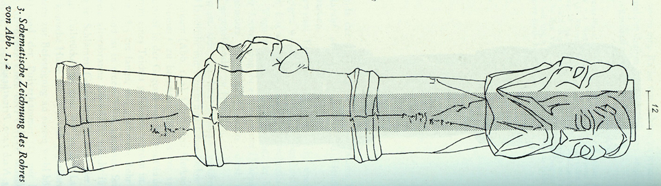

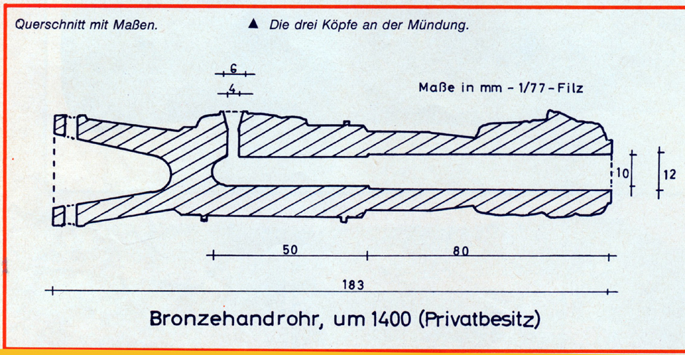

The measurents are:
overall length: 18.3 cm
barrel length: 13.0 cm
caliber inside: 10 mm
caliber at muzzle: 12 mm smoothbore
diameter of the touchhole: 4 mm (at the vent), widening to 6 mm inside
weight: 720 g

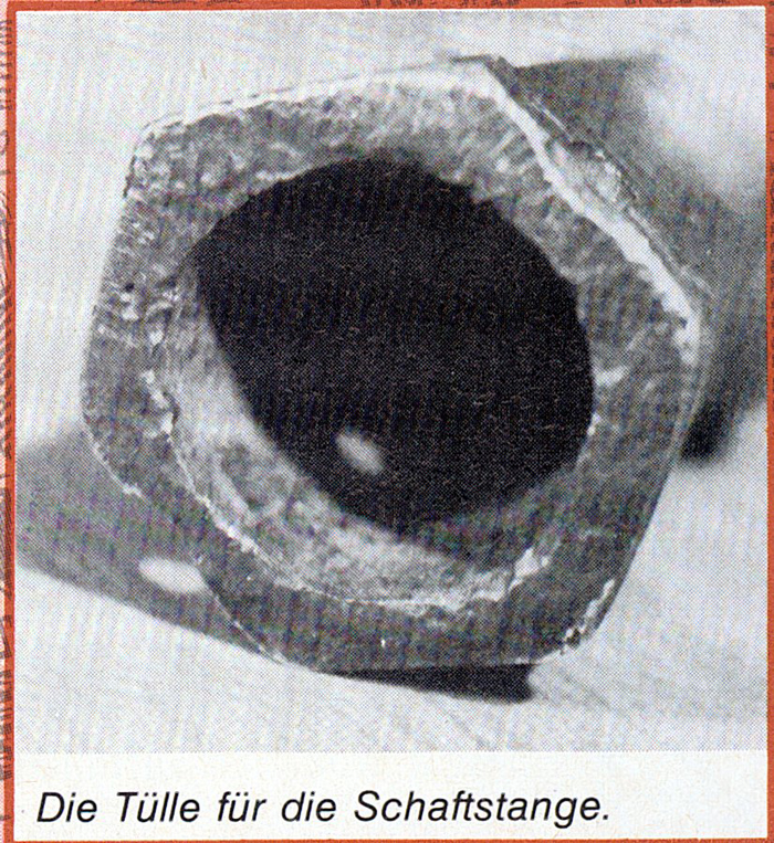

The attachments from top to bottom:
the Mörkö gun
the gun with three bearded heads:
- overall view, top
- overall view, slanted
- two sectional drawings
- held in hand
- muzzle section
- the three bearded heads at the muzzle section

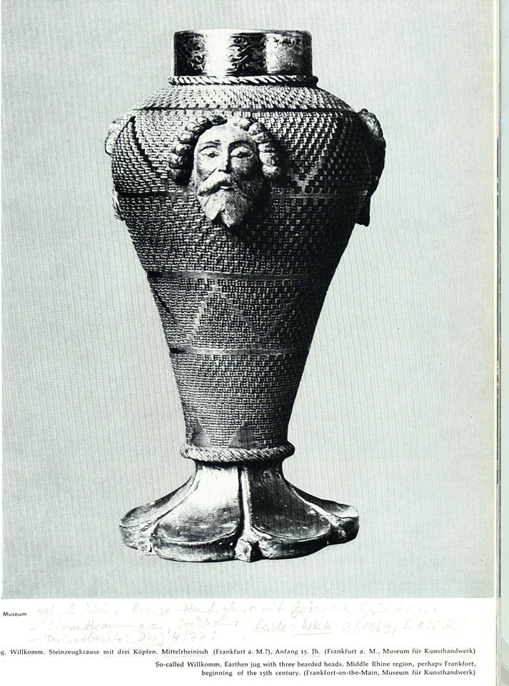

- a contemporary earthen jug with three heads
- a distorted face, its open mouth forming the touchhole
- the rear end of the tiller socket
- the muzzle
Enjoy!
Michael

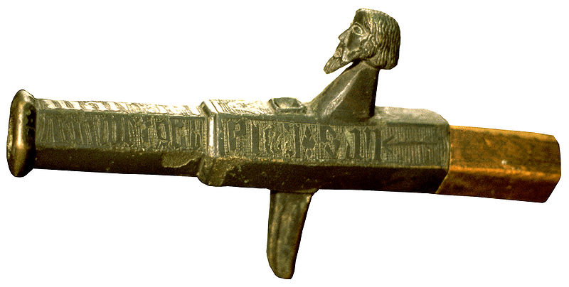

It is one of my fovorite handgonnes. I have a photo from another view:
Spiridonov is offline   Reply With Quote

Excellent, Alexander,
I didn't know that view - thanks for sharing!
Michael

This is the only color image I have, sadly of poor quality.
The stock of course is a very convincing reproduction.
Michael

Before the early 15th century, no makers or other marks are known, be it on guns or on any other work of arts and crafts; it was only during the 1st half of the 15th c. that artisans and craftsmen began to develop that special self confidence.
As I stated in some of the earlier posts in this thread, the Gothic minuscule script here is mostly ornament in the form of letters; only the word maria is identifiable as a religious invocation.
I would say that the ornamental script was engraved after the casting of the barrel; it looks just too delicate and neat for being the result of casting.
Michael
