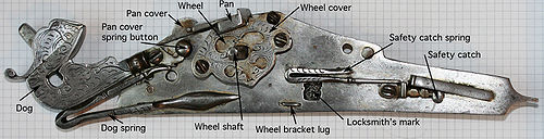

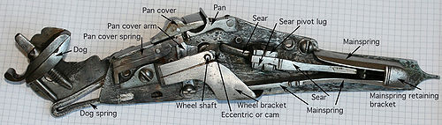

References I have found on the history of the 'wheellock' note that this action is believed to have been invented by a German mechanic, with a drawing from Germany dated 1505, with a subsequent Austrian purchase of one of these mechanisms in 1507. It is also noted that there are a number of scholars suggesting the DaVinci device as the true origin of the wheellock, presumably from these drawings.
For those just entering the realm of firearms, the terminology used in these early weapons is formidable, as there seems to be considerable dispute on correct application and usage. The term 'matchlock' seems pretty straight forward, as does wheellock, but others such as snaphaunce, doglock, and others seem confusing......with the venerable flintlock finally largely superceding all.
From what else I could discover, the wheellock was tremendously expensive for the times, and was never really widely used in the military, with the larger use of the matchlock in place until later in the 17th century with the advent of the flintlock firmly in place.
I really do look forward to hearing more views on this seemingly rather obscure DavInci development, and if it perceived by the early firearms community as a viable claim to the beginnings of the wheellock. Also, does anyone out there have information on the German drawings or origins?
Attached self portrait of Leonardo, and two illustrations of a later 16th century wheellock mechanism.

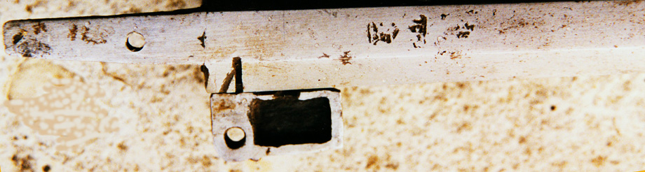

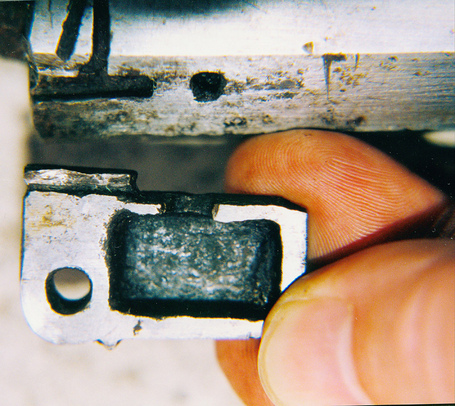

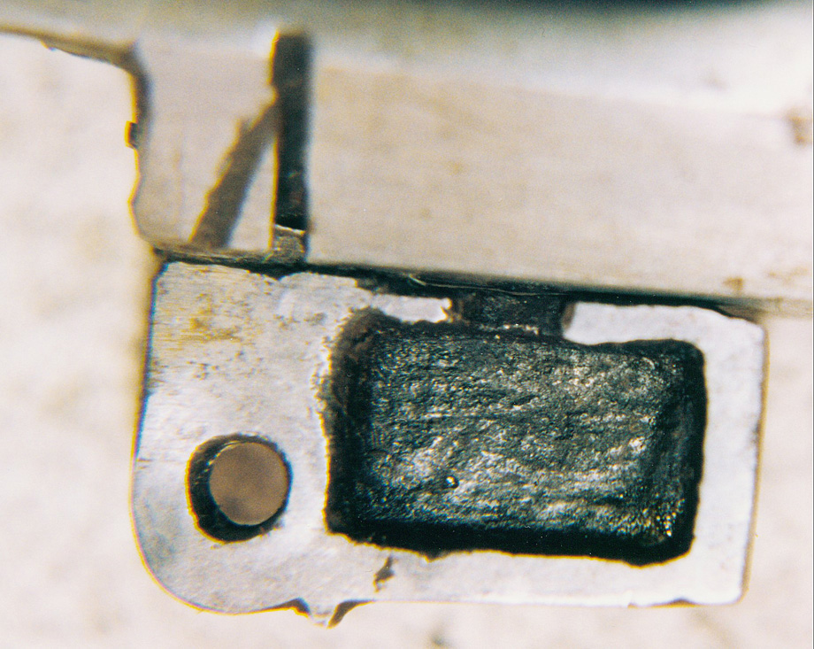

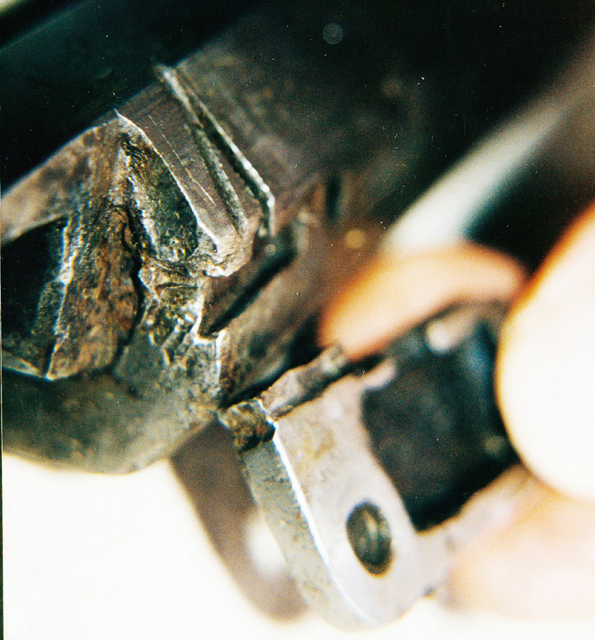

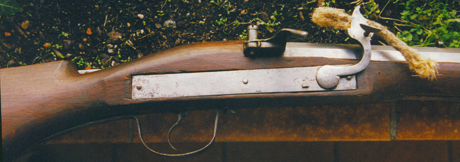

May I point out that an ignition pan (that's obviously what you mean by cazoleta) was never forged integrally with an iron barrel; as I pointed out in a former thread, they were always dovetailed and still today are easy to take off.
The attachments show the dovetailed pan of a mid 17th century German (Zella near Suhl) matchlock musket (author's collection).
The only exception was bronze (copper alloy) barrels where of course the pan was cast integrally.

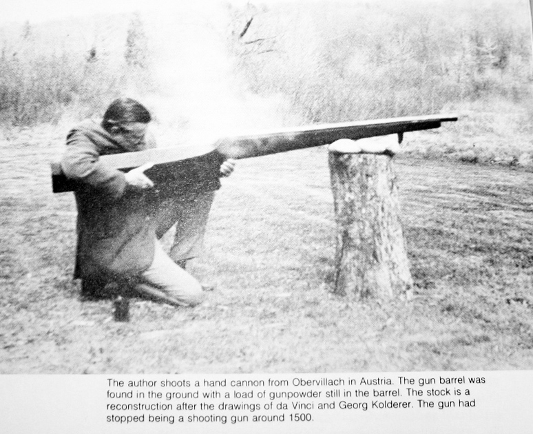

I think I can assist in helping understand my friend Alexander: I'm sure with sacrilege he meant that the original load of powder was fired. If that were so indeed I would fully support his meaning.
Well, the photo shows the author and collector Merrill Lindsay (One Hundred Great Guns), who died some 20 years ago. The photo is taken from his less known book The Lure of Guns (1976). Unfortunately his own collection which was auctioned at Christie's revealed lots of failures due his not really experienced collector's eye.
Unforunately, the text does not refer to this photo, as often in his books. Lindsay bought that wrought iron barrel he is shown firing as an excavated find and I am sure he cleaned it very thoroughly as was his usage. In doing so I am absoutely sure he took out the original powder load. I once did the same with of my fine Munich haquebut barrel dated 1481 and have kept the load as kind of sacred ever since. Nevertheless, I tried to lit a small portion of it. Well, nothing happened. It was meal powder, of course. Not only had it gone wet and dried again many times of its 500 year history, its main substances had also become unmixed. So all it did was sparkle and bizz a litlle bit, but far from going up whoosh like a rocket.
To cut a long story short, I am far from believing that Lindsay used the original load for one reason or another. If we start from that presumption I think we should not call it a sacrilege - unless Alexander meant the fact of firing a 500 year old barrel. In that case I would say it is up to him how he feels about it.

Thanks for explaining. Im sure this must have been quite apparant to those well versed in guns, but for novices like me we need more than a single word to get the meaning.
Indeed.
I applaud your knowledge, sir!
