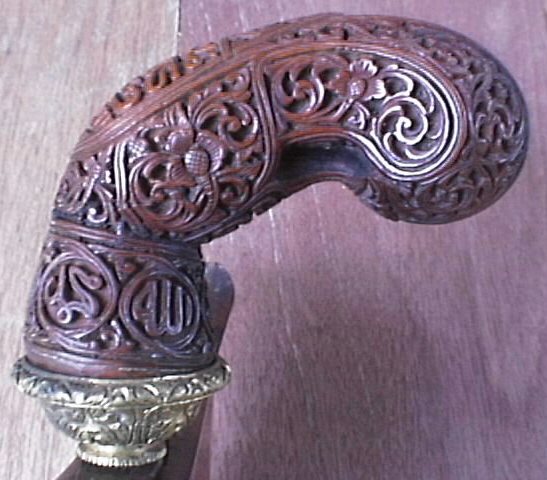

Dear All,
I obtained this (Bugis) keris this weekend. The blade and sheath, and separately the hilt, the hilt cup. I got too separately, six handles with motives. Is this Bugis with luks? I would like to have your comments, please...

Hi,
Sheath is Sulawesi,
pendoko is Trengganu (N. Malay).
Hilt looks new, but there is a Sulawesi form like this as well. I think most forumnites must be thinking of the Riau Bugis form which is similar to this. But I think this form is more akin to Sulawesi. Jon posted a similar kind of hilt a while back.
Blade has been washed in hi-contrast manner akin to Javanese kerises, but I don't think it is Javanese. From the dapur, it could be Sumatran Bugis.

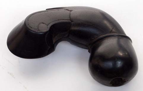

Ok, here's the hilt on the Sulawesi keris belonging to Dave Henkel, which was on Kampungnet:

Yes, BluErf,
I think this sheath is Sulawesi. Pretty sure, Bugis. Pendoko? This is something new for me. Thank you for informing, that this pendoko is Northern Malay. The hilts, I don't think this is a new one. I have cleaned it, with tooth-brush-shampoo and then with auto-polish . Really, this is not new one. I just think this is original. The blade? Sure, not Javanese blade -- from the forging of pamor, and the details of keris.
The pamor, in Javanese term we call it "pamor tritikan" and not "untu walang" (grasshopper-teeth). But not as fine as Javanese pamor.
Thanks alot, BluErf. Very useful information from you...

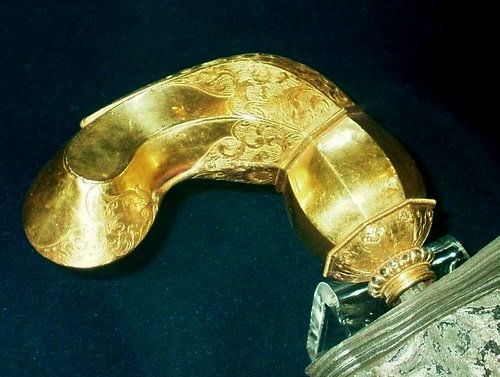

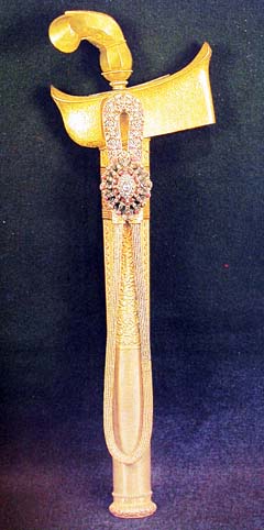

BluErf,
This is the sole picture of the hilt. And please regard too, to the other picture I took from Mr Hamzuri book, "Petunjuk Singkat tentang Keris" (Short Guide on Keris) published by the Department of Education and Culture (1973). Mr Hamzuri showed to the readers a Riau Lingga (Sumatera) keris which appearance looks like Sulawesi keris...
Ganjawulung

Originally Posted by ganjawulung
BluErf,
Ganjawulung
Ganja, I've seen the picture from the book and had seen the hlit up-close, when it was loaned to Malay Heritage Centre (in Singapore), some time ago. Also featured on the front cover of the book, Court Arts of Indonesia.
The form is similar but not the same...
BluErf,
Ganjawulung
Hi Ganjawulung,
This keris you referred to is a famous keris, and it is an archetypal Riau Bugis keris. I would say it is the benchmark for all Riau Bugis kerises. Shahrial has a couple of Riau Bugis kerises with similar hilts. Perhaps Shahrial could post pics of his 2 keris hilts for comparison.
The reason why I think your keris hilt is Sulawesi rather than Riau was because of the pierced-through 'appendage' on the underside of the head and the more acute angle of bending of the head. The "appendage" is also present in the 2 examples I referred to above, but is not so obvious in Riau examples. The more acute angle of bending is a common feature in Sulawesi pistol-grip hilts.
However, I may be wrong. So if anyone has any information, references, please raise them. Thank you.
