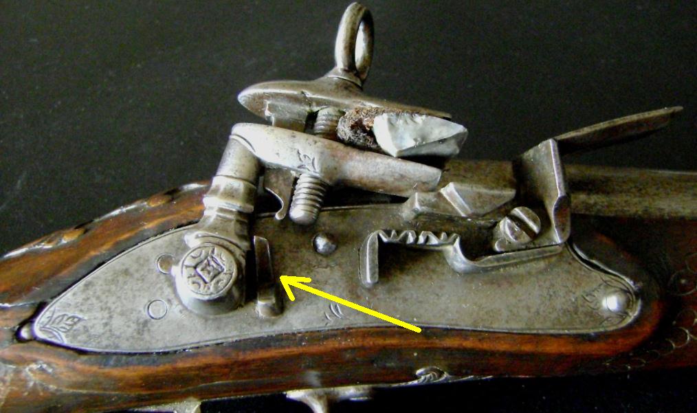

Lest the viewer be confused by the preceding image, what appears to be a projection at the base of the cock is a separate component, a swiveling "brake" which acts as a manual safety catch, to block the fall of the cock at the "half" position. The photo was taken of the lock in half-cock or "safe" position with the brake in rearward position against a ratcheted notch at the cock's base.
This brake has a similar function to the rear mounted dog catches seen on early English flint systems, or on the Catalan and Algerian agujeta type miquelets.

Philip, thanks for enjoying (once more) my fine example of a goat foot lock with an 'armoured' frizzen posted by Udo, as also the molinhas diagrams i have 'stolen' from Daehnhardt's page whom, by the way, told me in his exuberant manner that, he was certain that the manual safety catch you talk about, was the best safety cock system he knew.
(Attached one of such lock examples in one of my finest blunderbusses ... ex-Daehnhardt, by the way)
