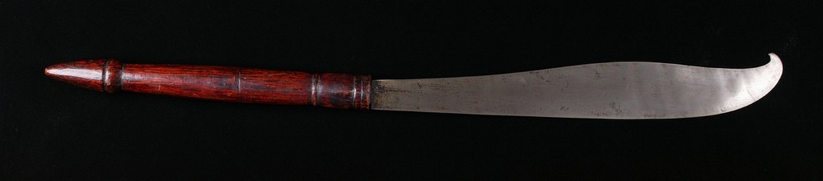

Hello all,
I have recently obtained a very interesting sword from a fellow forum dweller who is also a respected dealer. Let's call him "FFD" for now. The sword in question has what would seem like a solid identification from a respected previous owner (who indeed was so certain that he published it). However, FFD and I agree that the features don't seem to match. So what is it?
So as not to prejudice the investigation or produce a hasty conclusion, I will reveal the clues one by one.
Here is the first clue: the pommel. It is a hard wood with a deep brown-red color, lacquered. (The entire hilt, long enough for two hands, is the same and of a single piece.) The shape of the pommel is an elongated cone, at the base of which the shape is a reverse truncated cone that leads to the hilt grip proper. See the attached photo.
Anyone recognize this shape pommel?

Hi Dave,
when I not complete wrong it is the pictured chopper you ask about. It is for sure not Indonesian like suggested but a Thai or Laos chopper when I am not wrong.

Looks a bit like an old-time Aussie cane knife, used for cutting sugar-cane --- yeah, yeah, I know its not, but it has similar features.
As Detlef says:- not from the Indonesian Archipelago.

I agree that this one is not necessarily from the Indonesian Archipelago. HOWEVER, in Anthony Tirri's book, Islamic Weapons: Maghrib to Moghul, there is a picture of the identical sword (but with a blue background) that he calls a parang beng kok from Bali (see fig. 300B, p. 424). That sword is mentioned also in van Zonneveld's encyclopedic reference on Indonesian arms, although with a different hilt and the sharpened edge is on the S-shaped section (not the straight back). This example is based on Gardner (1936), and the information provided shows that is sharpened on the opposite edge to the one pictured in Tirri's book.
Based on the shape of the pommel alone, which is the initial subject of this thread, there is a passing similarity to a Tengerrese sword that was discussed here a few months ago (see: http://www.vikingsword.com/vb/showthread.php?t=18718). The Tengerrese are from eastern Java. Interestingly, van Zonneveld describes a ruding lengon (p. 115) from East Java as "an ancient weapon with a heavy, fancifully shaped blade which may be thick along the back, ending in a point curving forwards. The edge is extremely S-shaped." The drawing for this one is based also on an example shown in Gardner (1936) and appears closer to the subject of this thread than a parang bengkok.
Despite the comments to date, I would not dismiss an Indonesian origin just yet based on the shape of the pommel alone. Let's see the rest of the actual sword first.

This is the same sword once in Tirri's collection and depicted in his book as you cite.
Here is what sets it apart from similar style cane knives/swords: It is sharp along the flat straight edge as shown in the picture, not the curved edge.
The Laos idea is interesting.
Other ideas?

Hello Ian,
my opinion wasn't based alone by the pommel shape but by the complete sword/chopper. When it was for selling I was interested as well and have discussed it with a friend.
Hello Dave,
you have got a great bargain, this choppers are very rare. Maybe I will be able to show a similar example soon.

Aussie cane knives are sharp on the opposite side to the hook.
After the cane has been burnt to get rid of excess foliage and snakes you cut and then turn the knife over and use the hook to throw the cane behind you. Its rotten work.
Like I said:- this knife is similar to the knives used in Oz to cut cane.
Interesting thing to me is that this knife has no ferrule. Balinese tools for cutting cane, grass, light scrub have either a solid ferrule, or a socket to accept the hilt. The construction of this knife shown appears to have no ferrule, which means that it seems not intended for any sort of heavy work, and certainly not as a weapon --- first bone you hit the hilt would split. Even knives intended to cut grass in Bali have ferrules --- in fact even the fruit knives and kitchen knives have ferrules.
So what was it designed to do?
Maybe harvesting some sort of fruit, or nuts?
Place a partial cut through the stem and use the hook to pull the fruit down?
No impact that way, hence no need for a ferrule.
That does sound like what Alan is describing below, doesn't it? I'm not sure wether I'm getting the description in AvZ - sounds similar though.

please post the dimensions from the chopper and the thickness of the blade, this will be very helpful.

Chisel grind?
Hook forms a hand-stop on the blunt back edge.
This design would be perfect for splitting bambu.
No, of course it is not any sort of chopper, let alone a cane chopper. No ferrule on a wooden handle and with a longish blade? How long would that stay in one piece if it was used to chop anything?

OAL is 33 1/2 inches
Blade length is 19 inches
Blade thickness is 5/16th inch with distal taper to 1/8th inch
Blade width is 1 1/2 inch at base and 2 5/8 inch at the widest point of the bulge along the backside.
The edge is sharp along the straight edge on through the curve up to the tip.
The blade cross section is full flat with a flat grind (on both sides).
This is a very solid and relatively heavy weapon. I've no doubt it would find good use chopping in the fields or in battle.

See Gardner, "Keris and other Malay Weapons", plate 58. The drawing shows the parang bengkok (Java) #6 sharp along the hook side. The parang bengkok (Bali) #1 is ambiguous about the edge. Gardner doesn't claim to have actually seen this weapon.
A. Von Z. p98 image 382 (btw, this is the identical drawing from Gardner) describes the back as straight and the edge as "between S-shaped and concave." (I.e., on the hook side) This is in concord with Gardner's illustration, or at least we share the same interpretation. Curiously, Albert says the "blade's tip is curved sharply upwards." If the sharp edge is the curved side, it would seem correct to say that it "curves downwards." Yes? This suggests to me that Albert was working only with Gardner's text (which he cites) and never actually held the sword himself.
Tirri shows us the first real photo I can find in published sources. On p.423-424 there are depictions of three weapons from Bali. Figure 300a is a Teabuna and figure 300 is a Kudi Tranchang, both with a superficial resemblance to our subject weapon which is shown in figure 300b. However, compare the hilts and other features and I think you'll agree our subject weapon seems out of place.
I feel like I once saw a similar hilt on a Laotian or Cambodian weapon, but unfortunately I cannot recall anything more specific.
Dave A

Isnt there a blade like this in Rawsons work a Burmese dao/dha of some sort?
Also the hilt may not be original & may once of had a bolster/ferrule?

That pommel is really not a typical feature for mainland SE Asian weapons. While there are occasional blades that resemble a ram dao (which your example also resembles IMO), the hilts on mainland SE Asian examples are quite different from yours and more closely resemble either those seen on ram dao from India/Nepal or hilts seen on dha/daab of that region. From memory, all that I've seen had a metal bolster or ferrule adjacent to the blade.
There is an old thread started by Oriental-Arms concerning two "bird swords" that were possibly dha and showed elongated and pointed hilts (See: http://www.vikingsword.com/vb/showthread.php?t=2324). Those are the only two wooden hilts on dha-like swords that I can recall coming anywhere close to the elongated form on your sword.
It's hard to know what that elongated "cone" pommel on your hilt might represent, but it is quite different from the "lotus bud" depicted commonly on the pommels of dha/daab and which is an important Buddhist emblem.

Old 11th December 2014, 03:54 AM   #25
Posts: 7,228
Yes Ian, you're right:- there needs to be a common language, and if that common language includes words from a foreign language, it probably doesn't matter.
Provided that collectors as a whole recognise that the names they use for these ethnographic things are their own names, not necessarily the names that are used in the societies of origin of the things so named.
With keris its a pretty similar thing. When Ensiklopedi (second edition) came out many people commented that a lot of the names used for various things included in the work were very puzzling and probably incorrect, but the book did provide terms of reference that everybody could use to communicate.
I personally like the idea of naming weaponry with an alpha-numeric system. Maybe a latter day Stone will do that some day.
Re the Kabui dao.
My Rawson is a 1969, ARCO, New York edition.
Plate 36 has the Kabui dao shown, but it is nothing like Dave's thing.

Posts: 470
Default The pommel
Ian, the pommel resembles more closely an uncircumcised penis than a flower, but for me that is no clue.
Alan, we've discussed nomenclature before and I concur with your view. My interest is far less in what this sword is called and more in its regional and ethnic origin and function.
The idea that this sword might be related to a Naga Kabui weapon used for dancing was the first to occur to me when I saw it for sale. Please see the pictures attached - two depict my Kabui dao and the third is a dancer with a substantially smaller Kabui dao. My Kabui dao is a two-handed weapon of roughly the same size and even greater heft as the mystery sword we are discussing. The overall length is 25 1/2 inches with a 16 inch blade. Also, the Kabui dao is sharp on the curved edge, not the straight edge like our mystery sword.
I consider Assam as fertile hunting ground for identification of weapons that don't seem to fit the surrounding regions very well. Consider: The Kabui are one of the Naga tribes who reside in the area around Manipur. The dominant sub-tribe is called "Rongmei". In Manipur, "Zemes" and "Liangmais" together were recognised as "Kacha Naga", while the "Rongmei" and "Npuimei" as "Kabui".In the Brahmaputra valley and nearby are found other tribes such as the Kuki, Kachar, and Khasi. [See references below]
Much blending and cultural interchange has occurred since British occupation, but they retain distinct identities. The Kuki tribe is known to decorate their weapon blades with copper and brass and this may have, for example, influenced the decoration of my Kabui Dao.
This has led me to the idea that Assam deserves more attention; there is scant information available regarding edged weapons of the region.
References
P.R.T. Gordon, The Khasis. Available from Project Gutenberg
Rongmei Naga, Wikipedia
Last edited by DaveA; 11th December 2014 at 08:27 PM. Reason: added dimensions of Kabui Dao

Default Reiterate Dimensions & more pictures
Since this thread is getting long, for your reference here is an annotated picture of the sword showing the dimensions I reported earlier.
I also am attaching:
  • three pictures of where the hilt and blade meet
  • a top-down thickness picture
  • a tip detail picture
  • a picture showing me holding the sword with one hand -- note this was very difficult due to the weight distribution. This is not a one-handed weapon unless you are very strong.
Thank you very much for the comments and discussion thus far!
Dave A.
Old 12th December 2014, 05:28 AM   #30
Posts: 4,736
Detlef: That Sino-Vietnamese polearm is socketed whereas Dave's sword has a tang. As far as I have seen, polearms from Vietnam are all socketed in a similar fashion to this one. Similarly for polearms from Burma, Thailand, and Laos. While the blade shape and edge seem to have the same orientation as Dave's sword, the attachment to the handle is completely different.
Dave: As I noted earlier, and I think Alan agreed, the Kabui attribution seems a bit shaky based on Rawson's description and picture, and what you have shown here. The blade of the Kabui dao has a significantly different shape from yours, having a diamond shape and being especially wide midway down its length. Also, the hilt of the Kabui dao has a ferrule and its sharpened edge appears to be on the same side as the hooked tip; both of these features are different from your dao.
Thanks for the close ups of the hilt and adjacent blade. That hilt looks as though it has been on the sword for a while. I'm also seeing a crack in the wood that runs through its end, and Alan's earlier comment about the lack of a ferrule leading to splitting in that area may be pertinent.
I agree that Assam and neighboring parts are an interesting mix of styles, with ample opportunity for blending and migration of styles at the local level. The Kuki dao, for example, is another hooked tip sword but has a solid brass hilt of various forms.
Ian.
