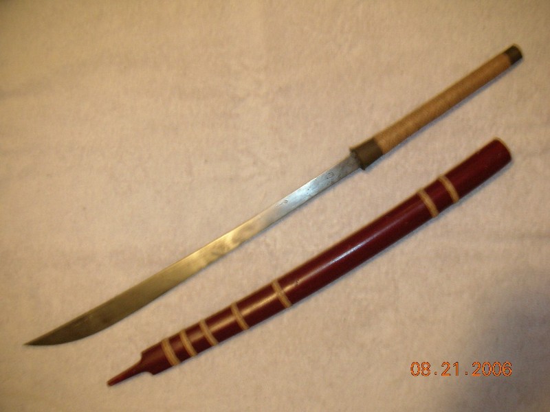

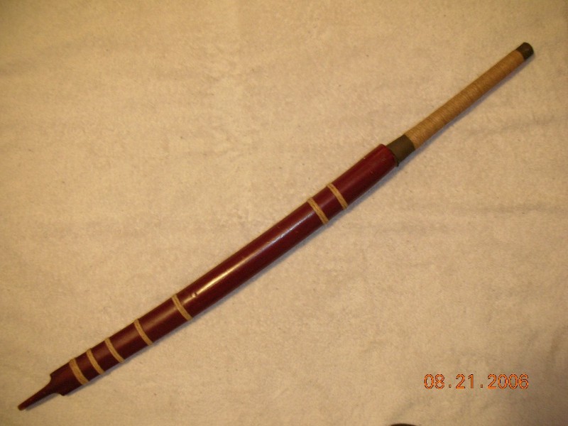

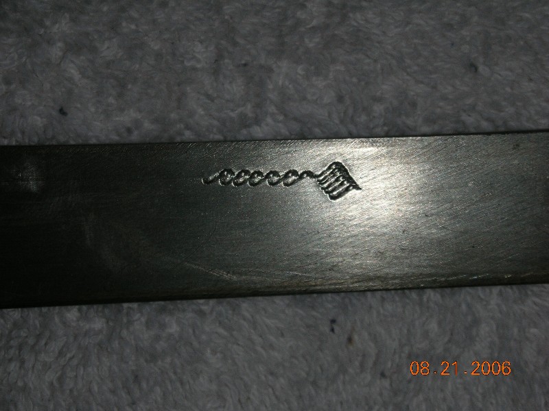

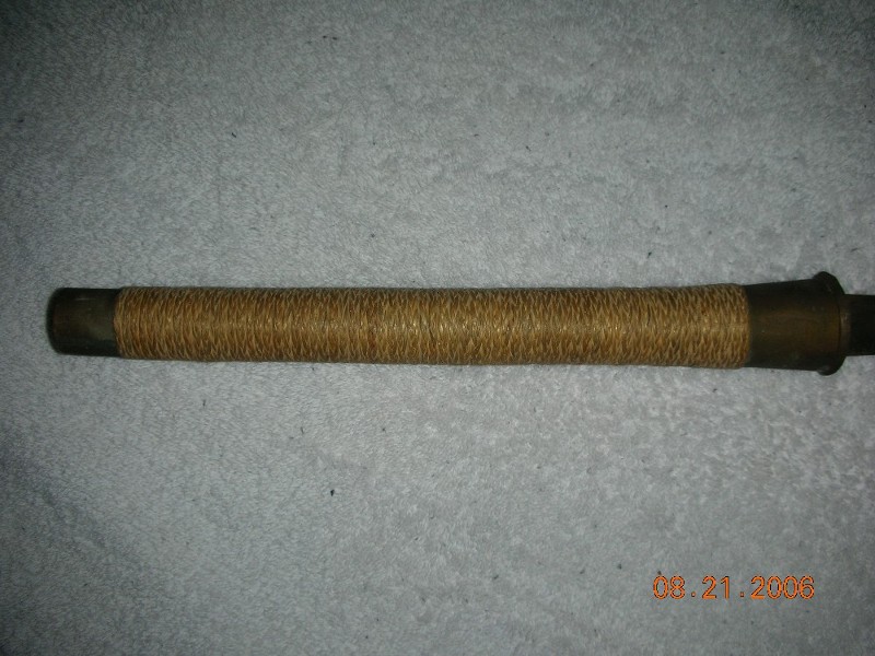

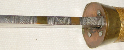

I was given this sword over 20 years ago by my father and know nothing about it. Where it came from? How old it is? Etc.
Any help would be greatly appreciated.
If it would help to have a better picture of a particular part of the sword I would be happy to provide one.

Your father passed on a Thai sword called a darb. It is of relatively recent (second half of 20th C) manufacture. You can find a lot of information about these swords using the forum's search engine. Type in Thai darb and you will find some similar examples as well as older forms and some very elaborate ones.
You will find a lot of info about your sword here also: http://www.vikingsword.com/ubb/Forum1/HTML/001291.html
Ian.

many of these swords are made for the trourist market. Some are not even hardened. But quality swords are still made for use in this region of the world. Its hard to say from a picture which this is ( a tourist sword or a use sword ) Some questions to ask yourself as you look at it:
How tight is the handle to the blade ?
What condition and quality are the wrappings on the handle?
Is the copper at the throat and pommel thick or thin ?
Lastly the thai smiths do have a technique to use a file or cut a nail to demonstrate a hardened well made blade but you may not be comfortable with either of these.

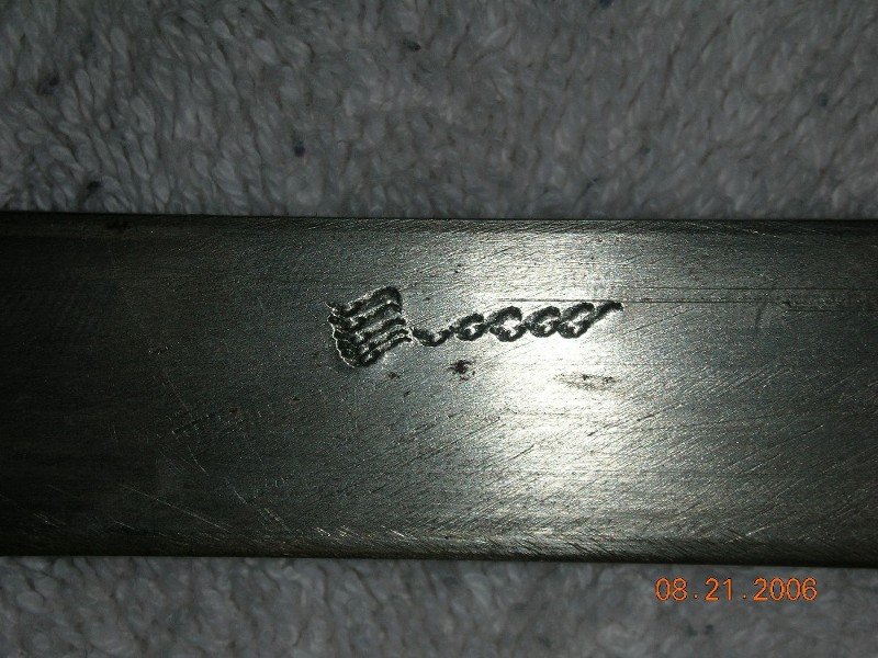

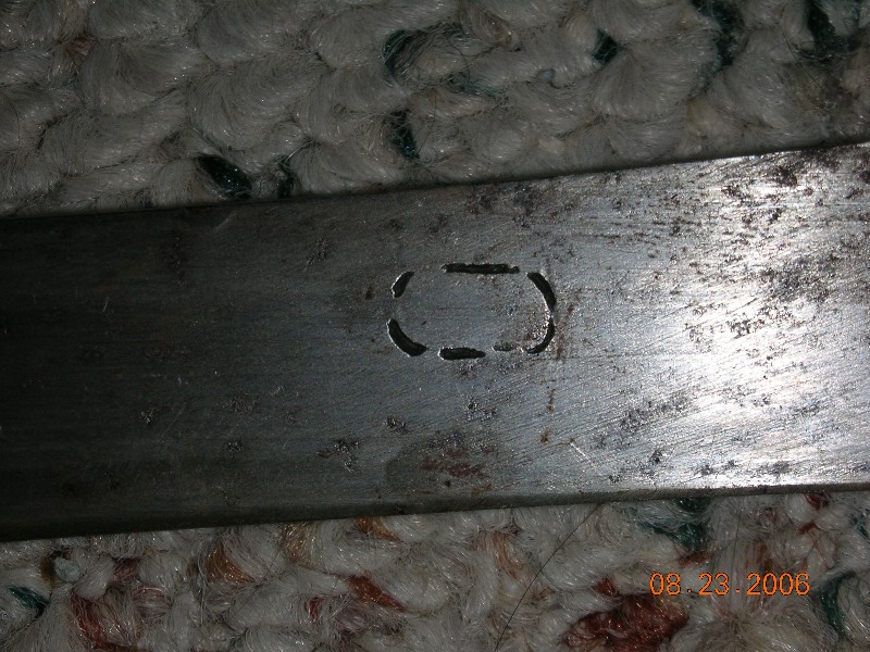

Is this an ellipse mark?
This mark could be related to either Aranyik (central Thailand) or LumPang (Northern Thailand) 's product.
However, the pointy tip on the scabbard 's usually associate with modern Dahb from central Thailand. Also, the rattan works on the scabbard 's are not very neat. It 's likely to be a tourist type from Aranyik. Narrow/untaper spine (2/8" or less) will confirm this. A popular souviner from Ayuthaya (or Bangkok) though
Excuse my ignorance, but I'm not sure what you're telling me to look for in reference to the spine. If you don't mind if you could give me a little more explination.

I believe Puff is describing a relatively thin blade which does not taper in thickness from the hilt to the tip.

The spine definitely tapers. It's much thicker at the handle and tapers to the tip.

Can you tell us anything about the markings we see on the spines of these swords? Any significance to the brass/copper/silver inset slugs?

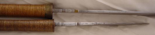

Yeah, that is the "turtle" mark, sort of poorly struck. Some other examples:
Puff, Dan has reported that Lung Som calls the lower one the "bitter melon seed," but it occured to me that he might have been referring only to the rosettes on either side of the turtle, which I have also seen by themselves. Do you know if the "bitter melon seed" the same as the little turtle, or is it the rosettes? Lung Som said that the mark on the lower blade was used by two collaborating smiths, one from Aranyik and the other from Chiang Mai. which made me think that the turtle represented the Aranyik smith, and the two rosettes, the "bitter melon seeds," represented the Chiang Mai smith.
Abravefan, about the spine, a typical dha/daab is quite thick at the base (as much as a 1/2 inch), and will taper dramatically in the first 1/3 or so of the blade down to about 2/3 or 3/4 of that, then more gradually taper to a very thin width at the tip. The best way I can describe this "double taper" is that if you hold the blade up, spine towards you, it looks sort of like the Eiffel Tower.
One modern technique of making daab is to cut out the shape from sheet steel, and refine the shape by stock removal. This results in a less dramatic, or sometimes very little, distal taper, with the blade being a fairly uniform width and tapering nearer the tip (like swords from many other parts of the world, actually). The dramatic taper of the daab blade moves the point of balance very close to the grip, 2-3 inches or less. If the point of balance of your daab is further out, closer to the middle of the blade, this also indicates less distal taper.

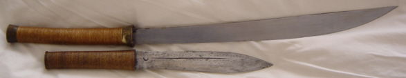

This is one of the same construction from WW2, the scabbard is rather different. If you are a film buff then you can see the same version is worn by the beautiful Thai lady porters in the film "Bridge over the river Kwai"

Bitter melon/cucumber seed 's ovel/elipse shape (bottom-right of the first pic).
The name 's interchangable with the turtle mark.
The mark was used by both LumPang and Aranyik guilds.
The round mark is called Dok Keaw (Orange Jessamine, flower). It 's not found in Aranyik 's product. Mostly related with LumPang guild.
Currently, there are hypothesis for marks on the spine. The first one is helping a calculation or strategy note. Another one which 's come from more reliable source is that spine marks are blade registration. The marks can be transfer to a paper or cloth with a piece of charcoal and a copy will be kept by town/city officer.
The slug, however, is related with spiritual believe. The most reliable one is that the copper material has a warding power against evil or person's spiritual protection. Some smiths point out the metal keep rust away. But the hypothesis 's less solid sice it 's scientificly not true.
Both marks and slugs may serve their purpose in the old time. But in this modern time, although the marks and slugs are traditional preserved, but its real purpose has been forgotten and they are purely used as a decoration.

Thanks so much again for the useful information. Registration marks make sense and the old idea about the slugs is one I had not heard previously. It is interesting that we see these marks on edged weapons other than Darb. I have a small axe/chopper that is probably 100+ years old with similar markings. http://www.vikingsword.com/vb/showthread.php?t=605

One other item of note on your sword and others of the like can be found at the guard. There is a thin brass plate nailed into the stock of the handle and in every version I have seen there is no pitch under that plate securing the blade to handle. I've been told that means it was never made for true fighting as the pitch not only secures the blade but acts almost as a shock absorber.
Dan

I know what you're talking about in reference to the thin brass plate nailed into the stock of the handle. I'm not sure what you mean by "pitch."
Is this something I can see without taking the handle apart? If not how would I go about disassembling it?

Pitch would be a vegetable resin used to glue the blade into the handle. What Dan is referring to is that these kind of daab are often just pressure fit into the handle, without the pitch/resin to glue it in. It makes the blade even more likely to "fly off the handle" as the sword ages and the wood of the handle shrinks. I do have one sword that is simply pressure fit and is clearly a "user," though. It was said to be from Laos, but its hard to tell. In Burma, at least according to Ferrars & Ferrars, the dha blade was pressure fit, rather than pinned, so that it would not vibrate as much, and could be pounded back in when it became loose (this last seems a bit circular in reasoning, since it wouldn't tend to come loose if it were pinned in the first place). This doesn't exclude the use of glue, though. Plus I sometimes question the accuracy of what Ferrars & Ferrars wrote.
In Higham, The Archeology of Mainland Southeast Asia: "Yen has noted that the Canarium and Madhuca [butternut] are exploited by the local Shan for their resins and guns, substances valuable in hafting composite weapons and coating pottery vessels to improve their water retention." P. 53.

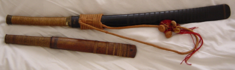

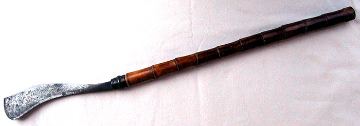

I found this picture of another flying blade. I hope he will not mind.
