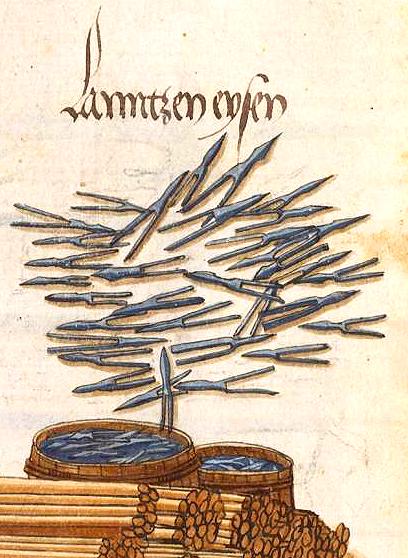

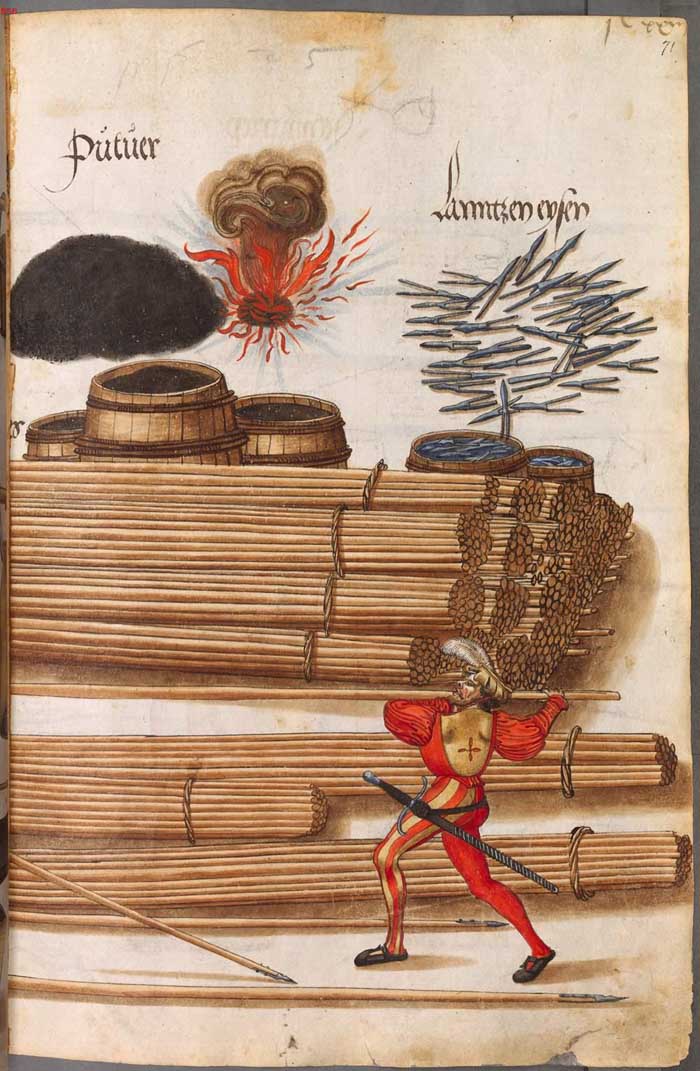

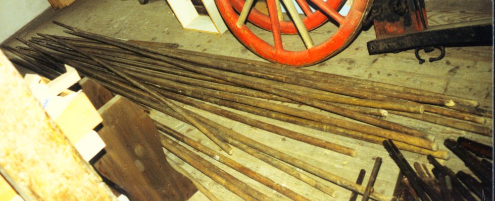

From the cod. icon. 222 in the Bavarian State Library in Munich.
Note the ash hafts which could be more than 5 meters long, and the blued wrought-iron lanntzen eysen with their integral short side-straps kept in wooden barrels, ready for mounting.
As the shape of the irons indicates, they are of the well known early 16th century 'Maximilian' Landsknecht (mercenaries') type called Froschmaulspiess (frog's mouth lance).
Michael
Old 23rd September 2008, 07:08 PM   #2
Again outstanding.
Was there a pile of hafts also in the previous picture ?
Fernando

Is this the one that you are referring to, Fernando?
As the rest of that illustration pictures parts of handguns, and telling from the relative proportions, I should say that these are ramrods, belonging to the heaps of barrels and stocked guns.
Michael

Quite right, thanks.
... and quite a lot of them, too

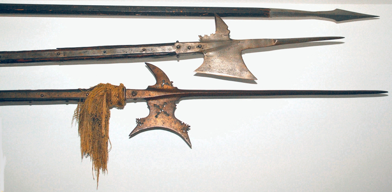

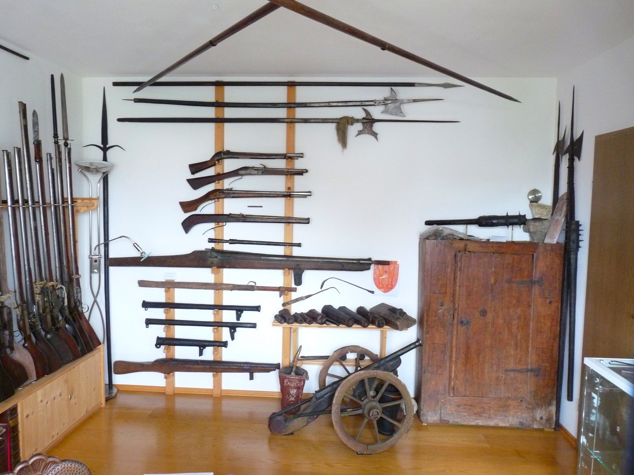

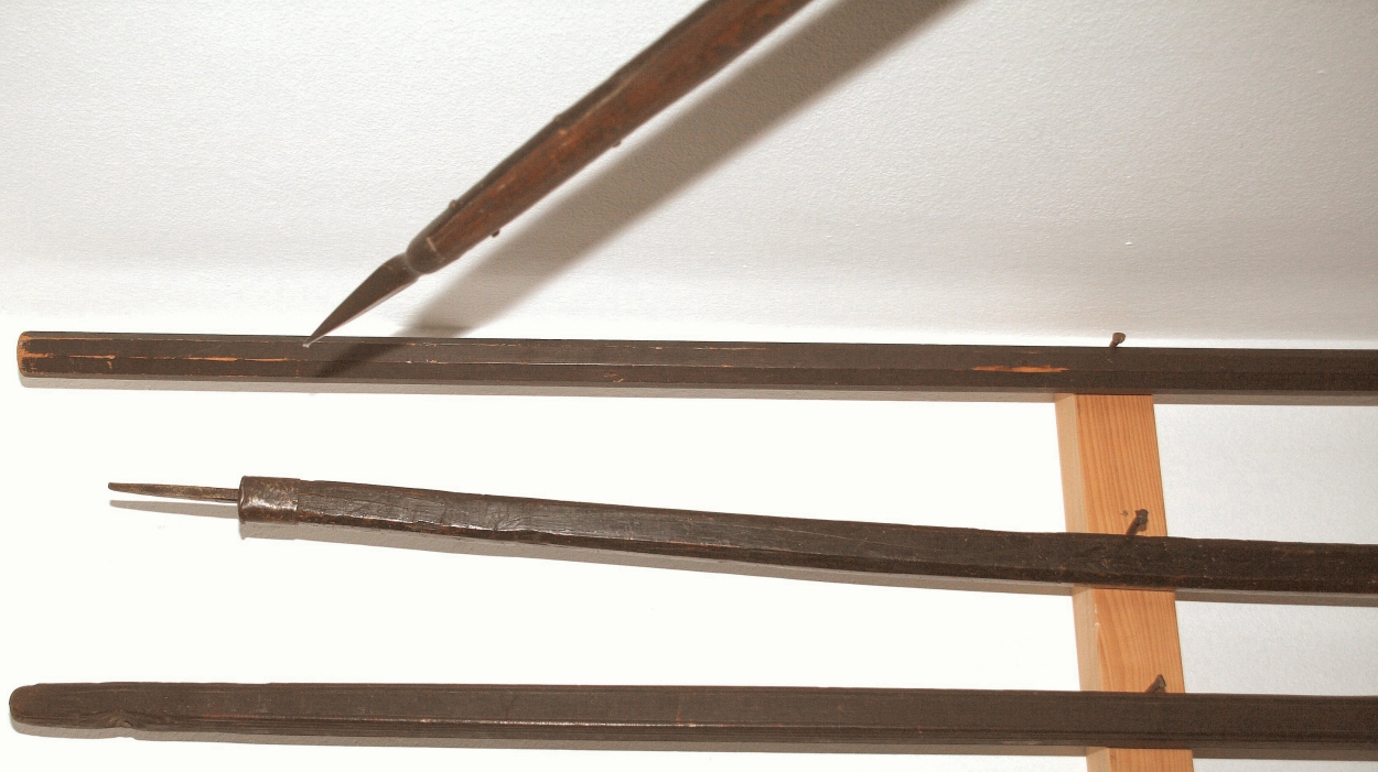

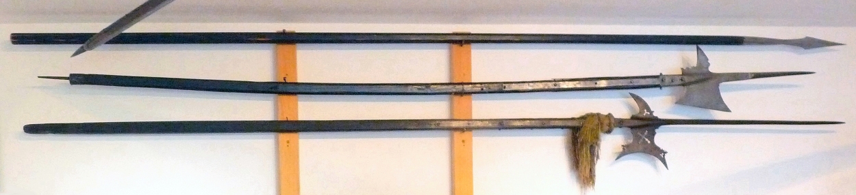

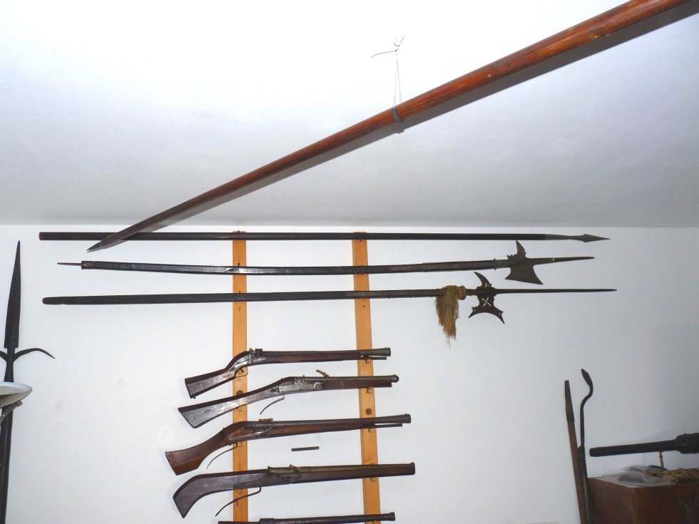

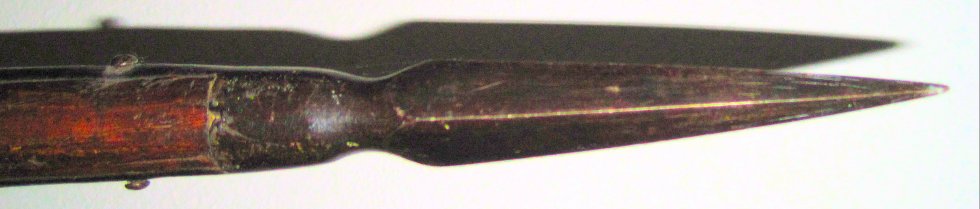

Default Two Mid-16th Century Hapsburg/Austrian Pikes in my Collection

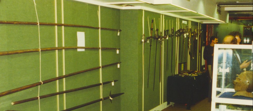

From Christie's, September 19, 1990, lots 47 and 48, an image from their showroom attached. There was three of those, so I chose the better two. Originally they came from the arsenal of the Fortress of Hohensalzburg; an image of a pile of those in the reserve collection there attached.
I never saw any other of these again. Apart from these, and the Historic Museum Basel, Switzerland, I have never seen pikes with their irons still blued!
Both retaining their original blued irons and straps (!), as well as their oiriginal ash hafts (one slightly bent).
Overall lengths 4.66 and 4.57 m respectively. They might even have been a bit longer originally.
The only way to display them in my showroom was to suspend them crossed from the ceiling.
Michael

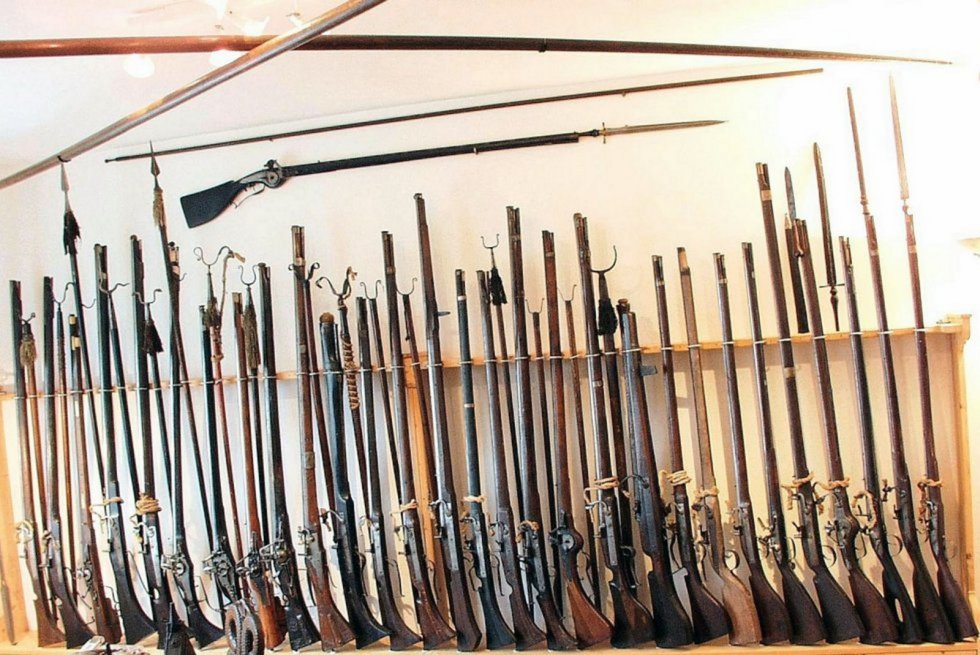

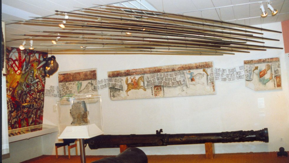

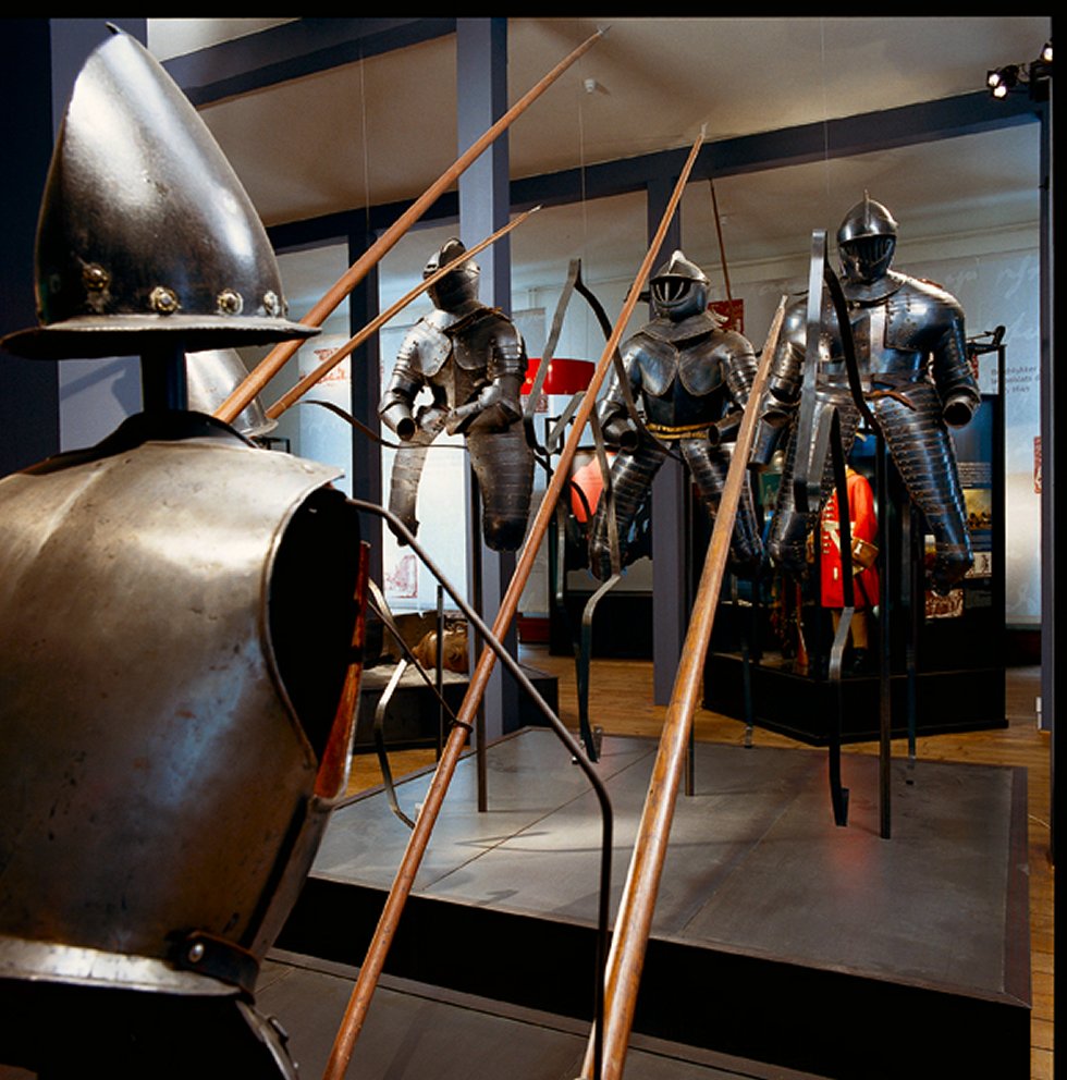

Default Pikes Against Cavalry - a Thirty Years War Impression
... in the Tojhusmuseet (Armory Museum) Copenhagen.
m

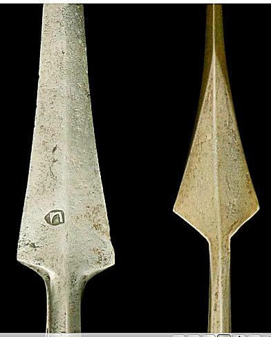

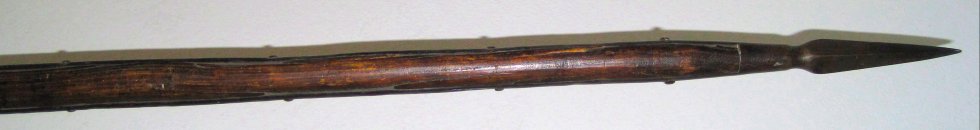

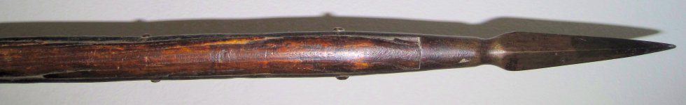

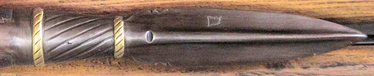

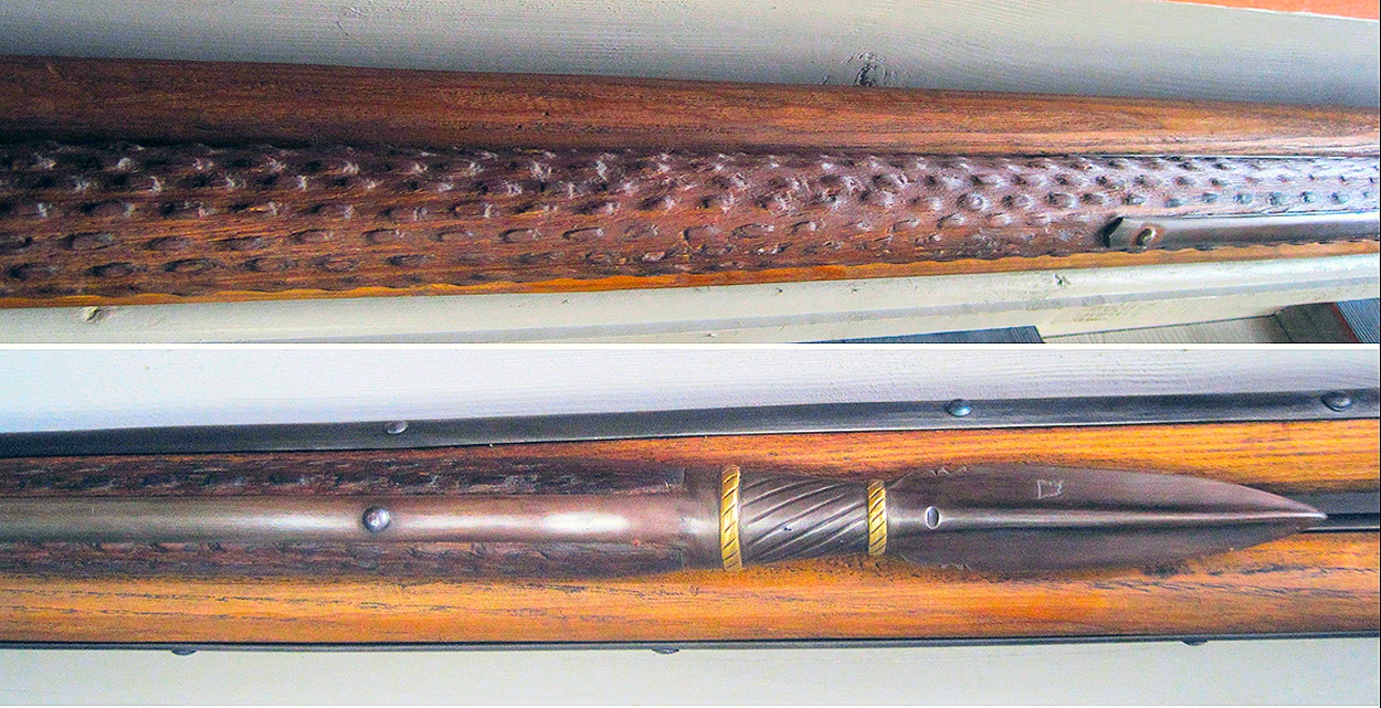

Generally, all items of manufacture, of arts and crafts alike including weapons, convey the basic style of the respective period.
Between ca. 1480 and 1520, Landsknecht's long pikes measured more than 6 meters overall – reflecting the “Hyper Gothic” period sense of style when churches got built with lofty steeples seemingly touching the sky and humans, too, were pictured to be very tall and slender.
While newly made spike heads from the Early Renaissance period, ca. 1520-50, were often decorated with a roped ornament and brass inlays, the complete pikes were about 5 meters long, and the hafts of surviving Late Gothic specimens got cut back to that length.
Consequently, by the mid 16th c. spike heads became rectangular in shape, and the whole pike now measured ca. 4.5 - 4.7 meters. Cf. two samples suspended below the ceiling in The Michael Trömner Collection (see post # ... above).
In the 1620's
, after the beginning of the Thirty Years War, they got cut back again to ca. 3.5-3.7 m, until most surviving specimens finally got reduced in length to about 2 m in the 18th and 19th centuries.

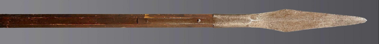

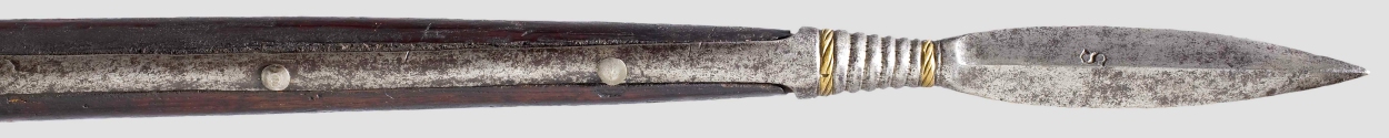

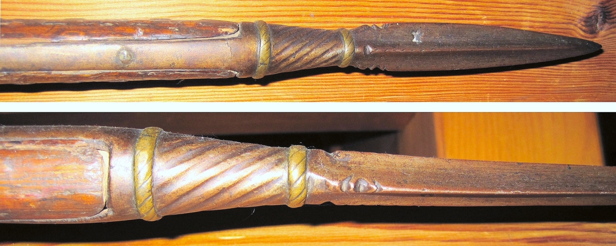

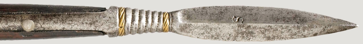

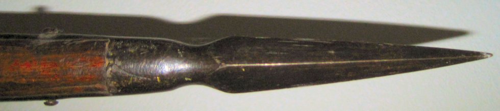

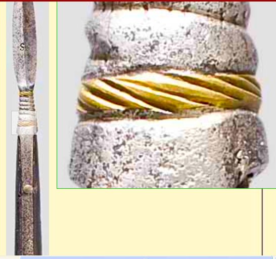

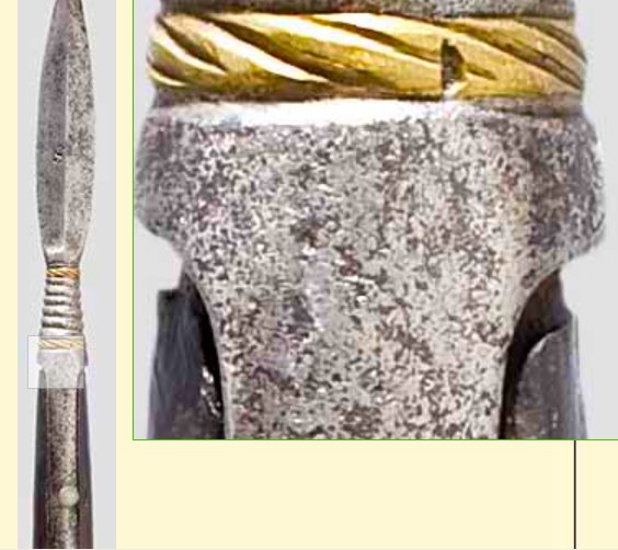

Discussed here is a truly singular South German Landsknecht's long pike still retaining its original length of ca. 6 meters.

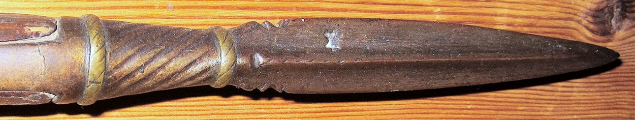

The two brass friezes of the iron head, characteristically decorated with a punched roped ornament, together with the notches, all denote that it was made in ca. 1520-30.

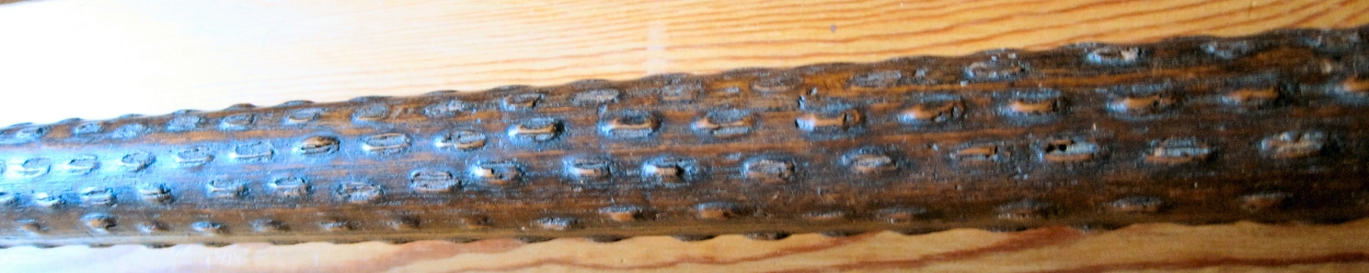

Its ash wood haft is decorated in an incredibly profuse manner, with what must be hundreds of knobs.
My skilled friend Armin König copied it. It took him many hours to get that knobbing done effectively on the hard ash wood that he told me he would never submit to such a toil again ..
The attached photos depict the original pike in the collections of the historic armory at the Veste (fortress) Coburg.

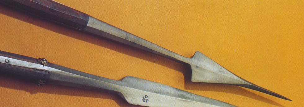

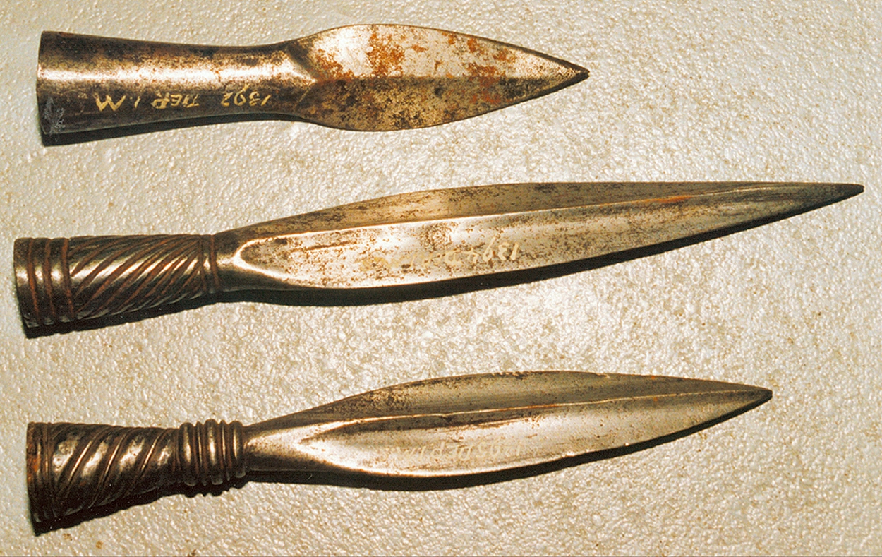

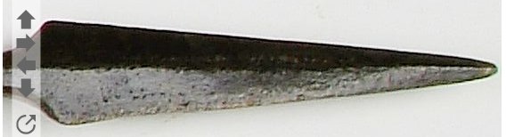

Also attached are three similarly early spike heads the author photographed in the reserve collection/depot of the Historisches Museum Luzern, Switzerland.
Michael
The first three photos copyrighted by Armin König,
the bottom image copyrighted by Michael Trömner.

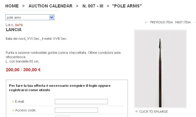

Another early 16th c. pike with brass inlays, the haft of usual round section; Hermann Historica, Munich, 8 Oct. 2009.

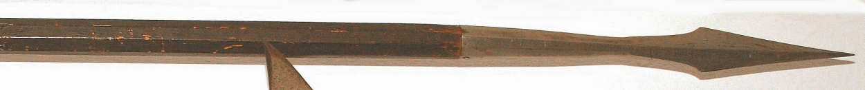

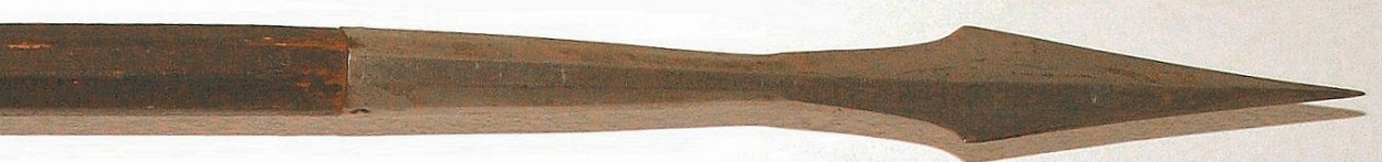

A mid 16th c. pike iron, the straps cut down to mere remnants, and mounted on a later haft.
Dorotheum, Vienna, 10 June 201
4.

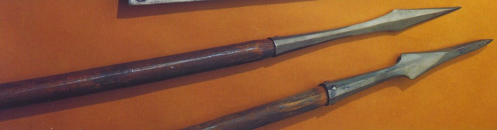

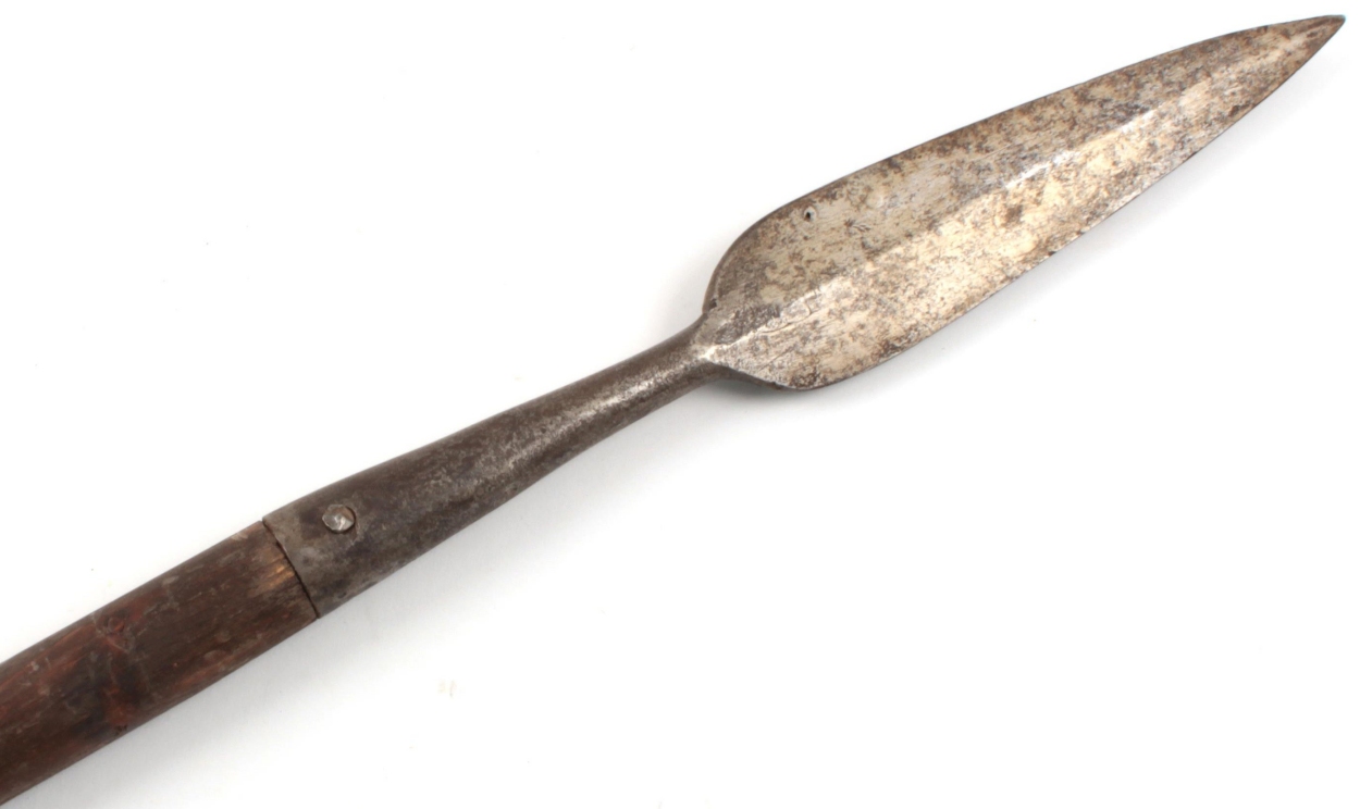

Two Styrian pikes, on later hafts.
The first of Frog's mouth" shape, 2nd half 16th c.; Bonhams, San Francisco, 20 Nov 2013;
the second ca. 1600, San Giorgo, Genua, 1st March 2009.
m

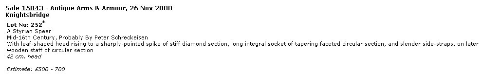

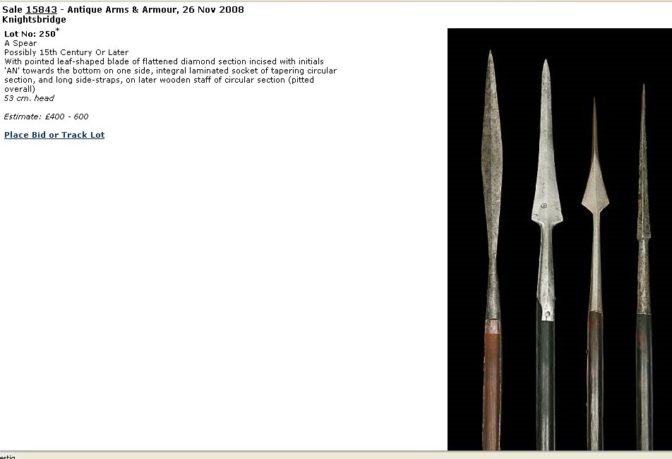

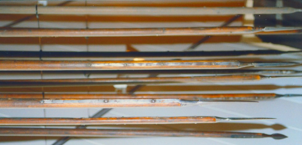

16th c. Styrian lances/pikes in the Landeszeughaus Graz, and Bonhams, London, 25 November 2008.

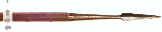

A Styrian Froschmaulspieß (frog's mouth pike), early 16th c., on its original but shortened haft of octagonal section throughout, overall length 2.86 m, and bearing an inventory stamp of the Metropolitan Museum of Art, N.Y.
The Michael Trömner Collection.

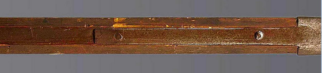

A very fine and extremely rare Landsknecht's Langspieß, Southern Germany, Bavaria, ca. 1525-40, the original ash haft profusely profusely covered with knobs all over; the head struck with a maker's mark.
Overall length ca. 6 meters!
Rüstkammer, Kunstsammlungen Veste Coburg.
My brilliant friend Armin König, Hohenberg a.d. Eger, built an exact copy of this piece - striking the hard ashwood with hundreds of knobs that took extremely long to soak in water and stand up in the end; Armin told me he would never again in his life undertake a toil like that ...
http://www.engerisser.de/Bewaffnung/.../Firearms.html
On the photos, his copy, the head struck with Armin's maker's mark, is shown together with the original.
Photos copyrighted by Armin König.
