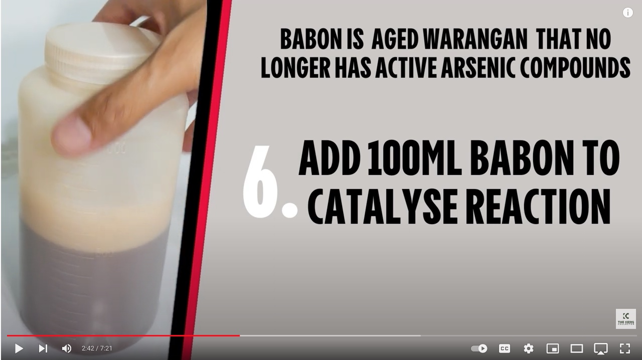

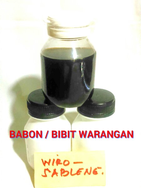

One of his steps is to add 100ml babon to "catalyse the reaction".
What is babon? Google isn't giving me any leads.
in the video says that Babon is aged (old?) warangan which no longer has active arsenic compounds
apparently it is possible to acquire it
https://www.bukalapak.com/p/hobi-kol...warangan-keris

Actually, in Javanese, a "babon" is a hen (ie, chicken, chook) that has laid eggs. I think it can also be used to refer to any female animal that has reproduced, but I'm not sure about this.
But it definitely is a laying hen.

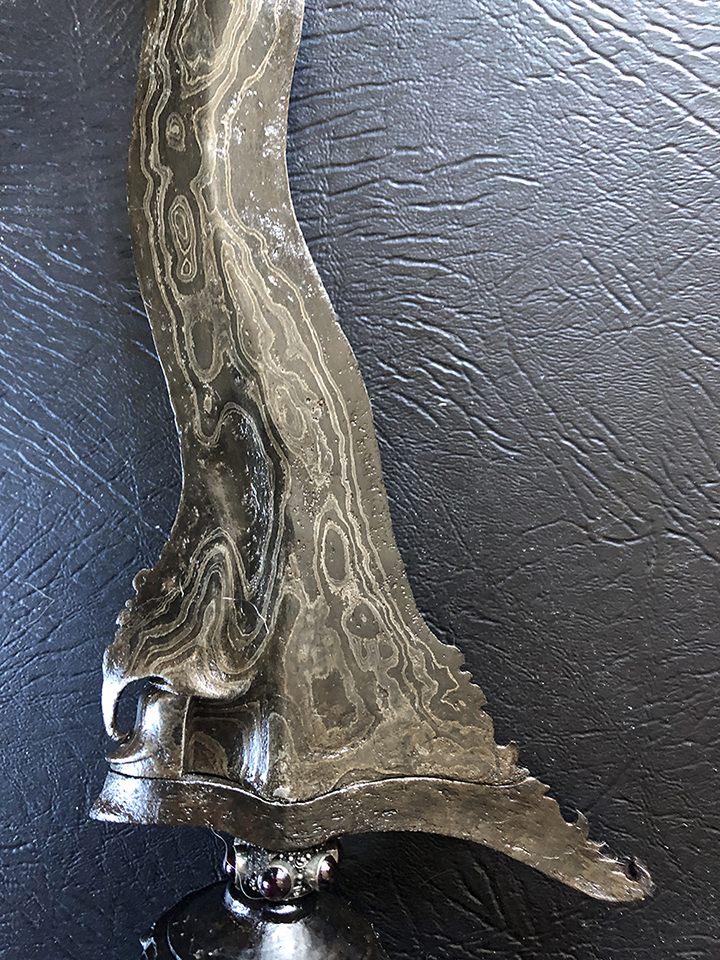

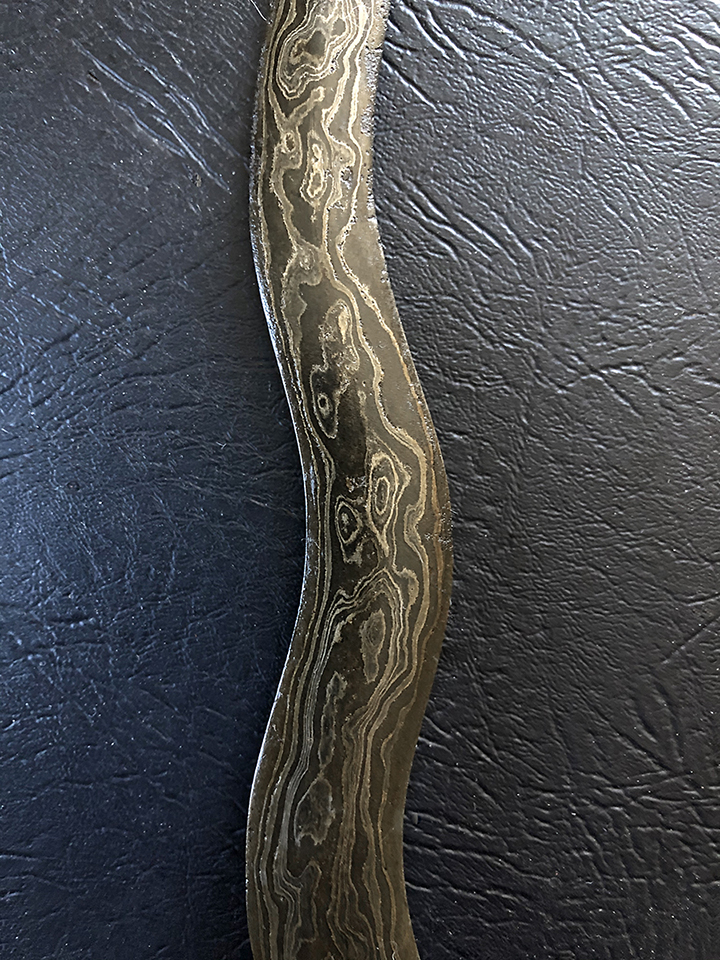

Not always as tedious as my description sounds Anthony. Sometimes you can get a passably decent stain on an old blade with vinegar and a bit of brushing.
On the other hand, this keris is one that I made, to get a decent stain on this it took me two full days, most of the time working in full sun in the middle of summer.

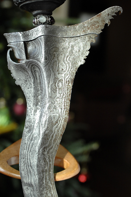

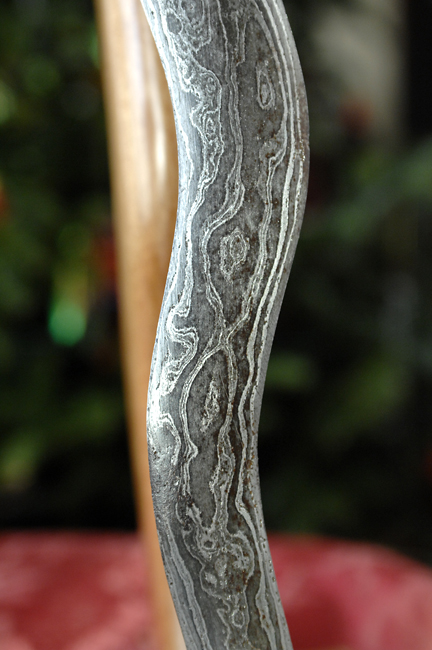

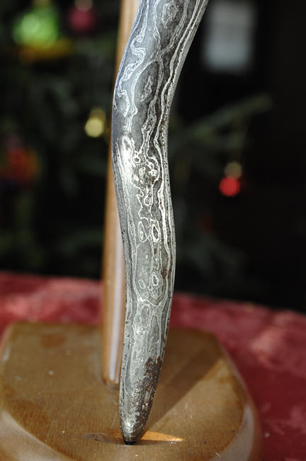

I have done the warangan process a few times on some of my keris with varying results.While i am sure a professional would do a much better job i just did not find it practical to send any of my keris abroad for staining as well as the worry about loss or theft along the way when sending the blade numerous times over great distances to foreign countries. I was fortunate to be able to obtain some lab grade arsenic trioxide some years back and though i have never had any training in handling such material as Alan suggests i treated it with the utmost respect and care and believe i handled it all pretty safely.
I used the brush on method that was described by Alan on this forum some time ago.
I have learned a few things since that i believe might make the procedure even more successful the next time i try it, but i suppose that remains to be seen until i make the next attempt. But while it is a slow and perhaps tedious process to go from a rusty dull blade to something that presents good colour and pamor i don't think it is difficult to be able to at least improve upon the appearance of a keris if you follow simple directions. I do find the videos presented by Milandro to be rather drawn out and overly complicated using methods which seem unnecessary from what i have seen and experienced.
Here is a Bali keris that i stained about 13 years ago. When i found the blade it was not in the best of shape. It had lived in a store window of a curio shop in South Orange, New Jersey for some time and was covered in a thin layer of active rust. The first group of photos shows the keris after i cleaned the rust off with a soak in pineapple juice and regular scrubbings for a couple of days and then gave it a warangan treatment. I must admit that i did not use Tahitian limes, but rather whatever regular limes were available at the supermarket. As described before, i used lab grade arsenic trioxide to make the warangan.
As you can see, my first treatment was weak at best. It was certainly an improvement over the original condition (sorry, i didn't take any before photos) and revealed the pamor pattern, but it was not satisfactory for me. The second set of photos (sorry for the quick and poor cellphone pics as i did not photograph this at the time and just made these now for this post) shows my results from may second attempt on this blade done soon after the first. It is still far from perfect, but i decided not to make another go at it and to live with it as is. The stain seems to have help up well over the more than a dozen years since it was applied.
I do have a few blades i have been wanting to attend to for some time and maybe i will get around to them this year as the weather improves. If i do i will be sure to document the process for thoroughly.
nice.

Cheers Alan aside from the dictionary meaning, the fact that searching for the word Babon together with warangan on google returns a large number of hits all to do with products meant to stain blades looking the same must mean that Babon refers to this kind of thing in whatever way. If you search babon warangan for images it will only show this kind of products
this is a screen shot of the search for images

Thanks Milandro, but I don't use google searches much where keris are concerned, I much prefer to rely on my own experience.
I use google for things i might want to buy, or for quick possible answers on things I don't know, or for things to do with travel --- hasn't been much of that lately.
All this stuff that relates to mixtures & etc for warangan looks to me like preparation of the stuff used for commercial staining of large numbers of blades, it is very definitely not in the smallest degree relative to the type staining I've seen done, or that I have done myself or that I have taught to other people.
My interest in the use of the word "babon" in a context that I have not seen nor heard previously is more to do with enquiry into language rather than enquiry into these warangan mixes.

It, was just to show that a number of people use the word babon in a warangan context.
Also in the last link to the video above (I will repeat here) there is a video where this guy mentions babon in the tile and shows it during the video, sicne you understand the language it may clarify the use of the word.
“ Cara Membuat Larutan Warangan dengan Babon”
https://www.youtube.com/watch?v=OcqFXU4CVLk

I believe i understand the relationship between the warangan solution & the word "babon" now.
The "babon" relates to the idea of beginning a reaction, just as a hen begins life by laying an egg. The word "bibit" means seed, or origin, or beginning, and that word is there somewhere too. so "babon" & "bibit" both relate in general terms to the idea of origin, just as a hen originates a beginning by the laying of a an egg that will produce a chicken. The reference attached to babon is one of origin, the beinning of something, and in this context that makes sense.
I find that it helps me to understand something, both in English, and in other languages if I can understand the relationships between ideas and words, not just pick up a word and use it without some sort of understanding of the net of ideas that drive the word.
As I have said, my interest was in use of the word, rather than in the substance that the word referred to.

It would be very nice that someone would make a video comparing the etching of a kris blad with the sulphur method to a warangan
Milandro, you may want to see this post for a line up of stained blades, one of which has been stained with the sulphur method. It may show you a good comparison.
There is also this blade that I stained using the sulphur, salt and rice water method. You may use this method and result to compare.
A hypothesis has been made on the latter post that the sulphur stain method may yield a better result on blades which have been stained with arsenic in the past, compared to those that have never been stained with arsenic before.
