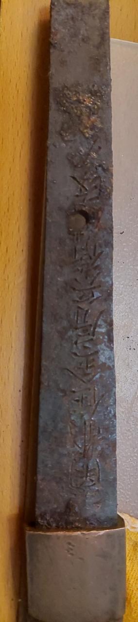

Gentlemen, i am desperatly needing help on this one !
I felt tempted for this piece, without having absolutey no idea how to check these things genuinity. I have just disassembled the blade and i see inscriptions that could (could) be a good sign. I still have to spend some time to examine the whole piece integrity; some parts are a bit 'tired'. But before that, i would like so much to know whereas this is a real naginata or a worthless dud.

Form looks legit. Can't read signature (posted upside down). In terrible shape. Can tell nothing of hamon nor hada. Would cost in four figures to properly restore (not a DIY project). Better be real inexpensive IMHO.

This is certainly a "real: naginata. It certainly dates from the Shinto- era - about 1700, I'd say, but I certainly can't read the signature - too rusty. We foreigners think nagtnata a complex, interesting, and graceful. Japanese collectors see them as "odd" and in Japan that is never good. This is not a good "investment" IMHO.

Looks a genuine old naginata. Personally, I like to see such good old, honest signs of age and wear. Not so keen on the woodworm holes though. But, judging Japanese arms and armour is a very different thing compared to ethnographic/tribal.

I would agree, it looks good and also not so far gone that it cannot be re-polished, but as Rich says, that is expensive but costed per inch of blade so less for a naginata than a long sword!

The characters look much more than a signature and may well include a date or the place it was made. Dates are usually in a form relating to the year of the then emperor's reign.
Go for it!!

Unfortunately, I can't translate the signature, but I really liked the calligraphy. Beautiful, strong, confident handwriting!

my 2 cents; the tang (nakago) seems to be shortened, ending square and I would expect it to be about the same length as the blade part. At the japanese sword forum Nihonto Message Board they have a translation help section, advice would be to post it there. Signatures often follow patterns, in this case possibly: Provence name -honorary title- smith name-"made by". Please let us know what it turns out to be
Oh, and maybe redundant; don't clean/sand/polish/whatever the nakago. Color and filemarks are indicators of age.

Thank you Eric; will do. Someone is already helping me establish such contact.
And by the way; about the shortened tang:
http://www.ksky.ne.jp/~sumie99/naginata.html
