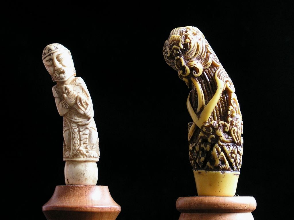

i bought this thinking it was cool and someone told it is old and i should look it up. i pretty sure it is a keris. what kind and where its from, i have no idea. any comments on this blade will be welcomed. i posted some pictures on another site but i didn't get anything definite.

Hello Joshua,
I doubt that this keris is old
the hilt looks that it's made of some sort of resin
(The overall appearance and the visible air bubbles on the bottom)
But I like the pendok (sheath) with the wayang figures
Yeah, a new Madurese blade and Madurese hilt made from resin, see its twin on the right of the picture.
Old 9th August 2011, 06:37 PM   #5
Posts: 7,303
I am afraid that i must agree on all fronts. Looks like a resin molded hilt on a fairly recent blade most probably produced for the tourist trade. The pendok (metal sleeve that fits over the stem of the sheath) is interesting with it's depiction of wayang characters, but it doesn't look to be of a very high quality. And, of course, the rest of the sheath is gone...
