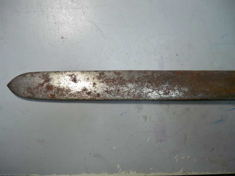

I was watching an "old sword with 22" blade". on ebay. I didn't buy it, but was rather interested! As I know nothing of these weapons, I wonder if I might enquire wether this was a good purchase. The price was very reasonable, I Think!! It needed a bit of work, but the "Ganjo iras" was very neatly decorated ...to my untrained eye. The lovely blade decoration of these weapons has me intrigued, So I ask what I should look for, if & when I can afford one! Here is a pic. of the blade & rough looking hilt;

Interesting kris, but it looks wholly Moro to me, not of the Indonesian variety. I would also suspect that it is not an Iras blade as i clearly see a line there. Sometimes these lines are etched there in Iras blades to simulate a separate gongo, but my feeling is that is is not the case here.

Firstly, I don't believe the piece to be a Sundang as such. It looks more like a kris from somewhere like Mindanaw. Secondly, I don't think that it's a "Ganjo iras", as I seem to detect a distinct separation between the blade and the base section. As to what to look for, that is largely a PERSONAL CHOICE. I'd tend to examine the blade first. Shaved or beaten into shape? Laminations or not? Damascene pattern or not. If it's got curves, what type (e.g. deep/shallow amplitude, scalloped). Then I'd investigate the fret-work; what style, how distinct etc. From there, I'd move to the handle. Scrutinising the fittings/collar, grip & pommel; what materials were used, what decorations etc. Finally, I'd examine the scabbard. Best, |

May I ask how you rate the fret-work on this one? To me, it looks like a lot of care was taken in its execution. Any idea of age? As I said, I know nothing of these, so am trying to get a feel for them. I must now go and find out where Mindanaw is! Re Moro; The seller had one or two definitely Phillipine pieces for sale also, so it does seem possible this sword came from the same spot. Any other comments most welcome!! Thank you again, Richard. |

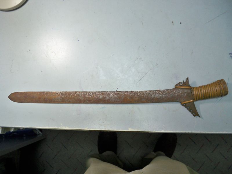

We as Western collectors tend to generalize (or perhaps simplify) our terminology with these weapons, but it is important to remember that each of the Moro tribes have there own unique ways of referring to their weapons and parts of them. Kai, i'm not really sure what you see that makes you lean towards doubting a separate gangya. I don't think we see enough info in this one image to be clear in either direction. The hilt may indeed not be original to the blade, but it certainly wasn't originally attached this way. This is an old field repair and what it tells me is that this kris was a "user" and that someone did what they could in order to make it functional quickly. I'm also not sure what you are implying Kai when you say that this "greneng" is not "traditional". It certainly is unusal, but i have seen other variations on this theme. What "tradition" do you think it comes from? Does anyone have a link to the original auction? Were there more photos? |

Here the link: http://cgi.ebay.com/Old-sword-wooden...item2eb11dbbb7
Only two pictures more were shown by the auction. |

Having seen the piece in its entirety all I can say is !wow! what a beautifully made and proportioned blade !!
The form is close to perfection, IMO . Now the problem would be whether to leave the old soldier as he is or go full restore ? I think I would just try to stabilise it were it mine . The piece speaks for itself just as it is . Last edited by Rick; 16th November 2010 at 01:09 AM. |

Always nice to see the whole piece for over all perspective. If it were mine i'd have trouble removing the rattan on it since it's such a nice example of a jungle repair and you wouldn't want to lose that history. It would be tough to fully clean the blade with it attached though.

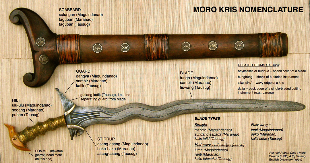

Can't find the specific term for a straight-blade kris, however. But on a related matter, here are the Maranao terms for 'sword': Sword: diaoaq, inalongan panampao, karis [i.e., kalis or kris], koiang, ledao, maindan, minar, miros, panangan, pedang, pinotiq, sarab Sword or fighting knife of Sulu: kalis Sword or kris with wavy blade: lingiq Sword used for fighting, has straight edge: kampilan Sword--card game: ispada Sword--either wavy or straight blade: sondang Sword--samurai: pedang a apon [i.e., pedang of the 'Hapon', or Japanese] Sword--two-bladed and curved along entire length: sikoq Sword--wooden: kaboran |

One of these days, I'll go down to Maranaw territory and look for a professor who can validate these terminologies. In the meantime, I suppose Cato and SIL are reliable sources. Thus we can rest assured that the terms are ok. |
