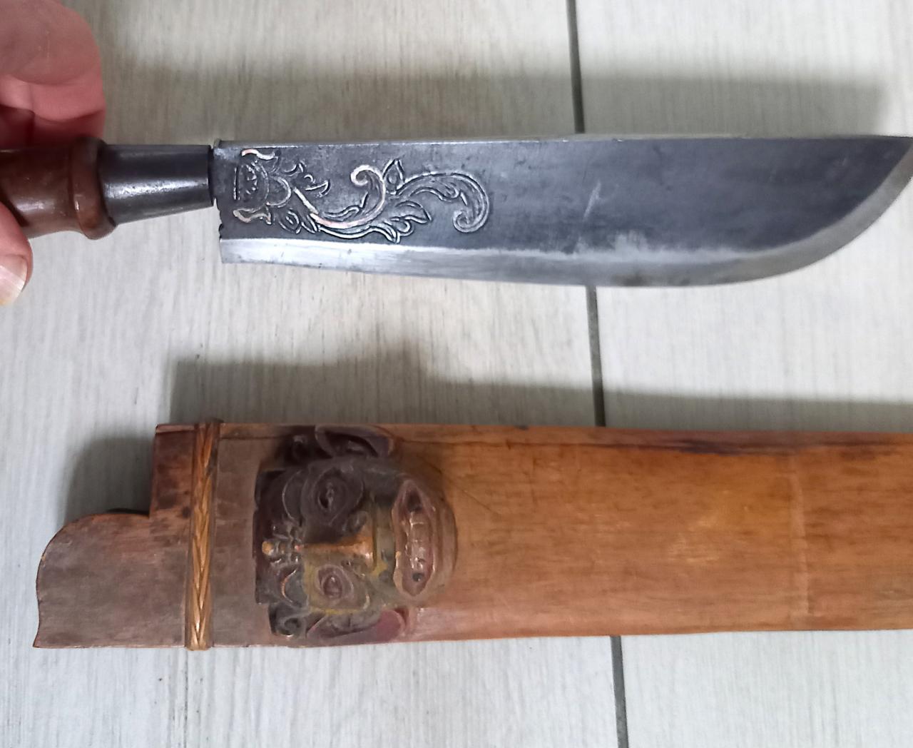

Default Thick knife frome Bali/Lombok

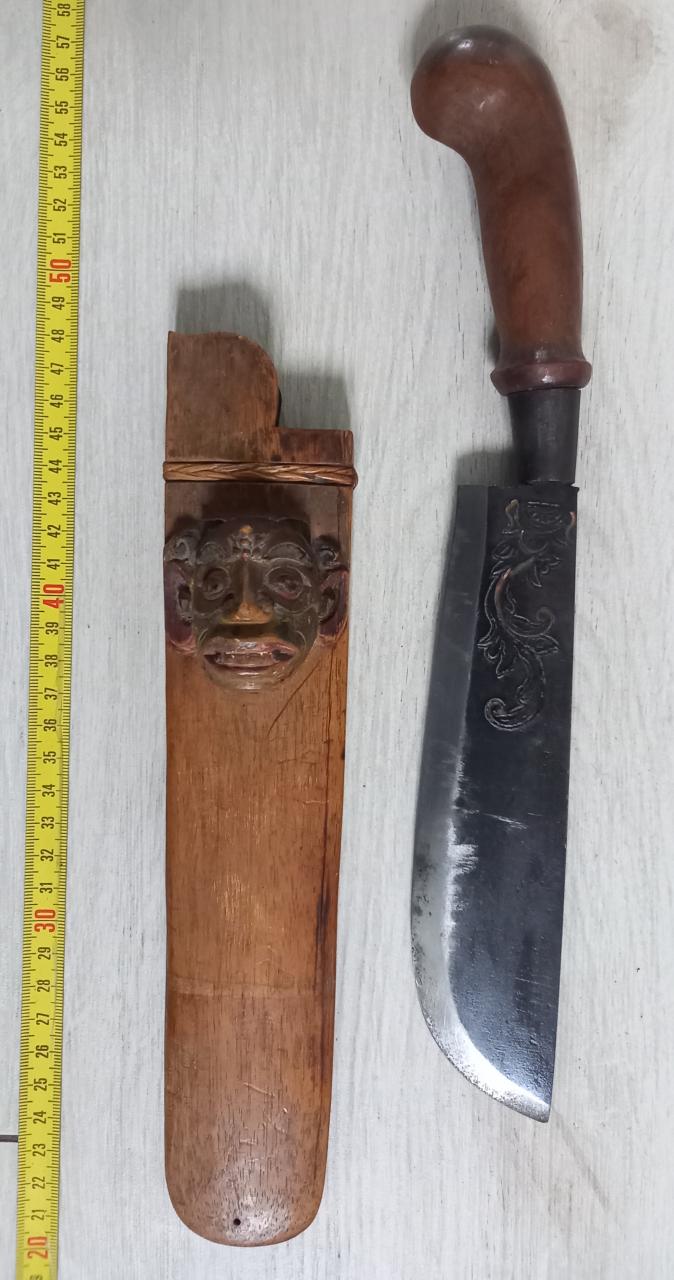

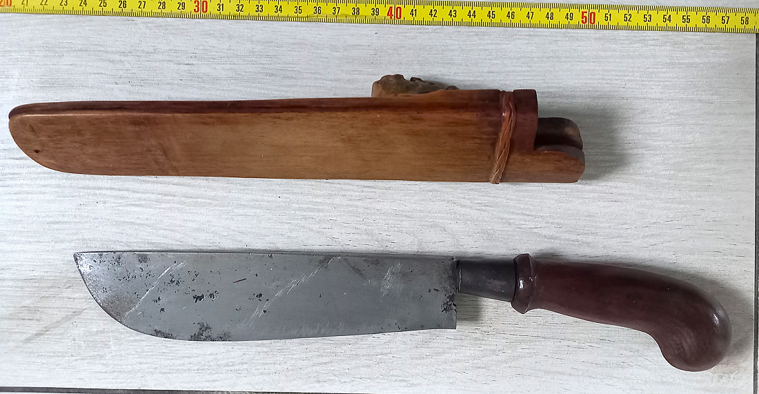

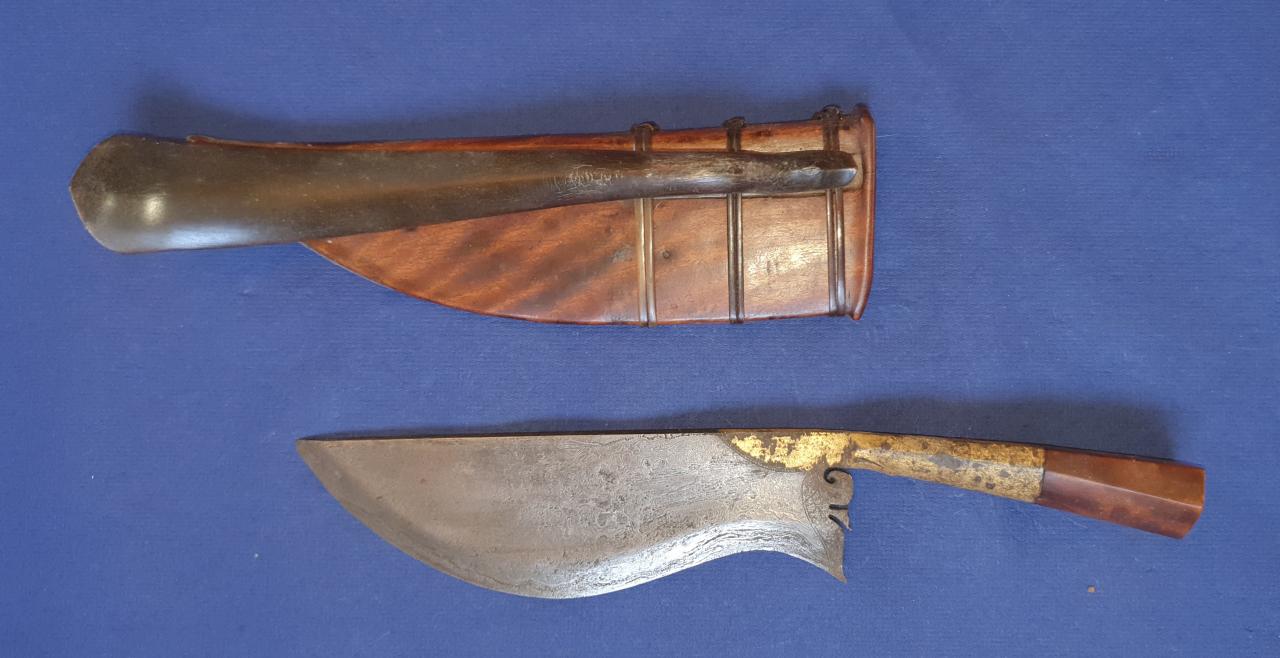

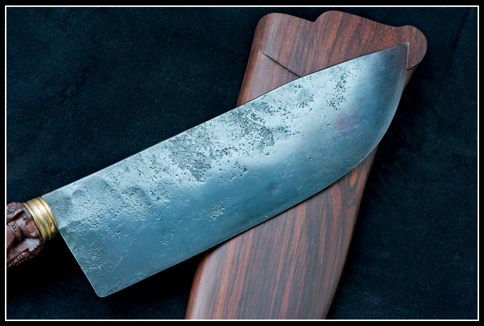

I have this thick knife from Bali/Lombok but I don't know its exact origin or its function.
Is it a ceremonial knife, like the Tiuk Pengentas, used in funeral ceremonies?
or is it just a nicely decorated utility knife?
When do you think it dates from?

Hello Séverin,
Nice knife! I guess a Balinese origin but I am unsure. Utility?

I agree with Detlef - Bali. I think it is ceremonial but for what I don't know.

is this old? Looks pretty " fresh" to me (especially the engraving) and the cold shuts aren't particularly nice
Old 1st March 2025, 11:58 AM   #5
Looks to my eyes like it has a good age, an utility blade doesn't need a good surface finish, I could show several really old blades with a rough surface finish.
The engravings seem to have remnants of polish paste inside, at least it looks like this.

that engraving looks awfully crisp
Old 1st March 2025, 09:44 PM   #7
Posts: 4,748
The engraving seems to have included some inlay work, most of which is now missing. That would suggest some age for the blade and a likely ceremonial piece.

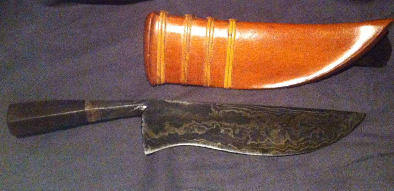

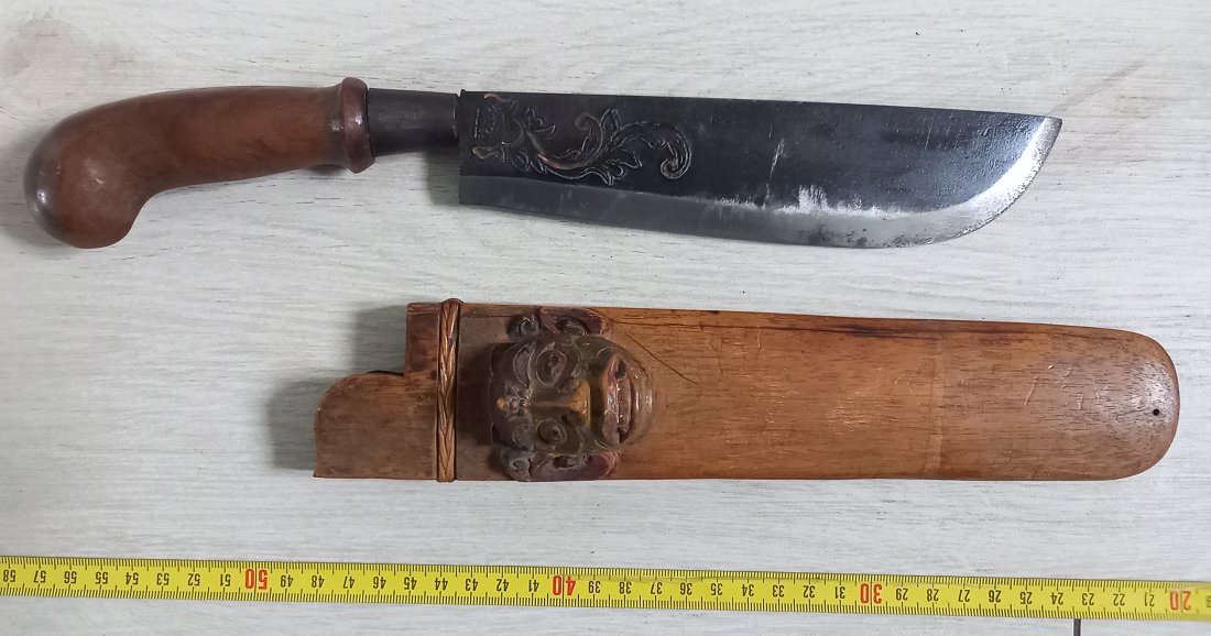

Hi All,

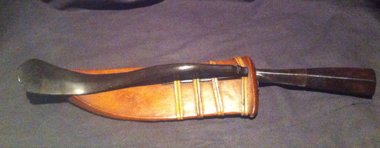

The hilt/ferrule arrangement looks similar to a knife of mine which I had always thought was some form of Indonesian wedong. The ferrule is silver plated steel. The blade is about 7.625 in (19.3675 cm).

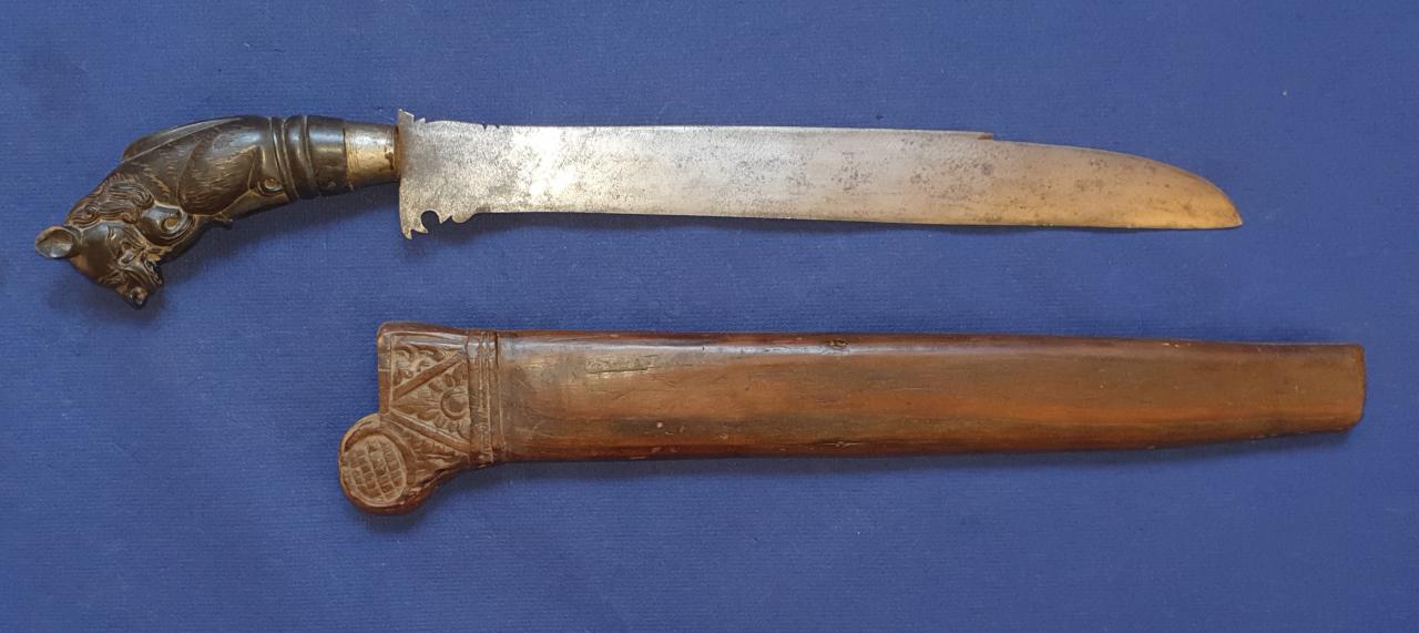

I've seen several knives, "bolos", working knives from Bali/Lombok, some we have discussed before here: http://www.vikingsword.com/vb/showth...ht=wedung+bali
But I am not convinced that we can name them all with a special term, I'll try to research in future on this matter. See for example my one in the first picture.
There is no "some" form of a Javanese wedong/wedung, a wedung is a ceremonial court knife and follows a given pattern, see sec. pic. attached.

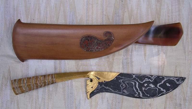

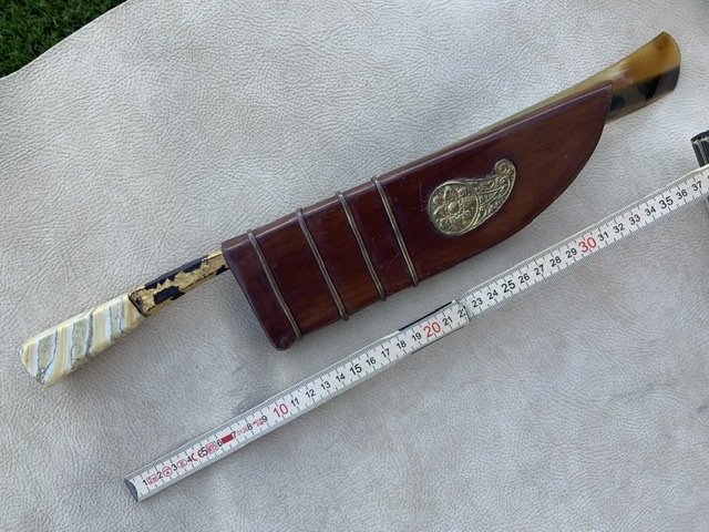

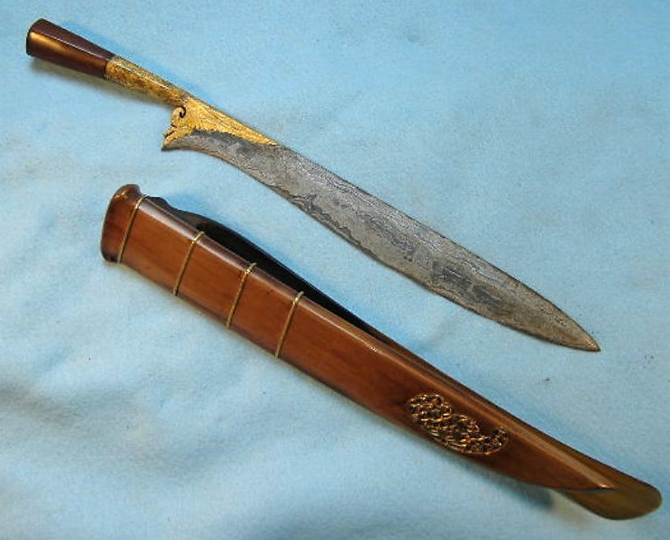

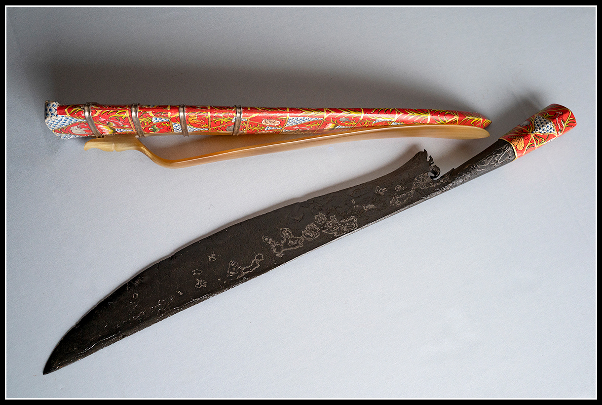

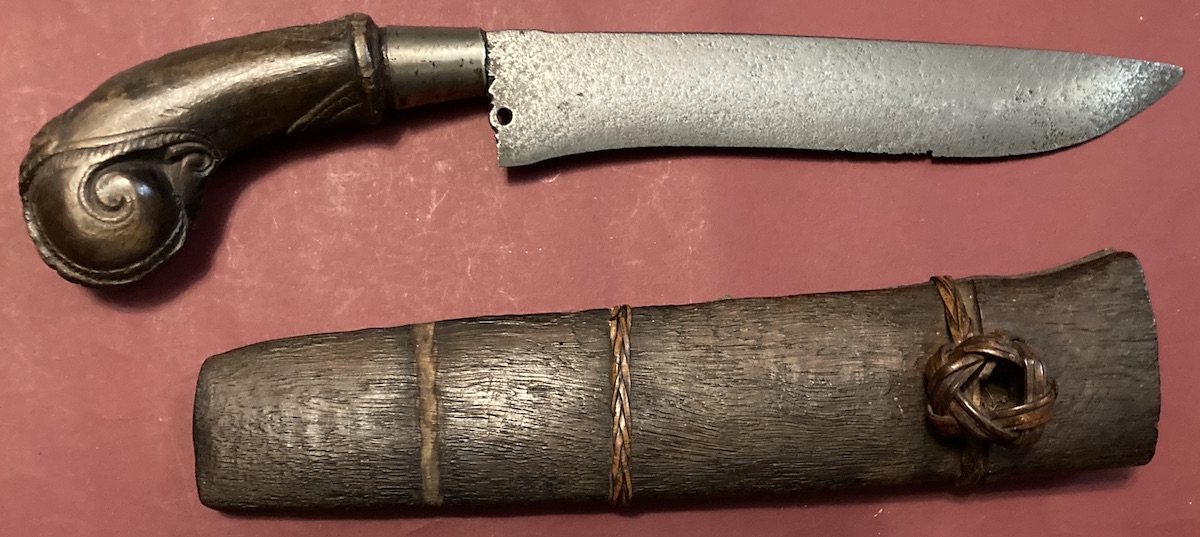

Other wedung, all taken from this site from other members, I'll hope they don't mind. You can see that they differ but follow a given pattern in general.
Old 2nd March 2025, 05:55 PM   #11

Thank you all for your answers.
Hello Séverin,
Please don't let us die unsuspecting, what is the white stuff in the engravings?
Old 3rd March 2025, 01:43 AM   #13
Posts: 7,416
Looks like silver to me.
Old 3rd March 2025, 04:23 AM   #14
Posts: 4,748
That was my thought too, Jose. It looks as though there is quite a lot missing from the rest of the engraved area.

Sajen,
I am well aware of the form of the Javanese wedong and have an example. When I said that the knife I presented in this post was “some form of Indonesian wedong”, I meant that I believed that it was some sort of ceremonial knife from Indonesia that had a roughly equivalent function to a wedong (eg the Balinese pengentas tiuk). Antiques by the Sea is currently offering a pengentas tiuk for sale and they are selling it as a “balinese wedung”. Wikipedia also shows a pengentas tiuk example which they call a “Balinese style Wedung”. There is also a rather full discussion on vikingsword of these knives begun by Gustav on 12/20/2012 (http://www.vikingsword.com/vb/showthread.php?p=149921) in which Atlantia says “shall we call them 'Wedung'? I know some do and some don’t”.
I don’t know whether my knife is from Bali or from somewhere else in Indonesia. I assume that it had a ceremonial function like a wedong but for all I know, it could just as well have been some sort of utilitarian knife.

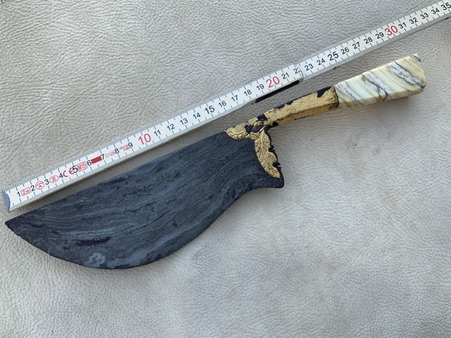

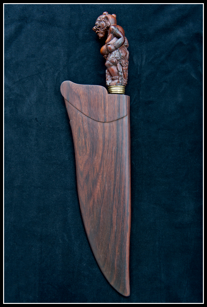

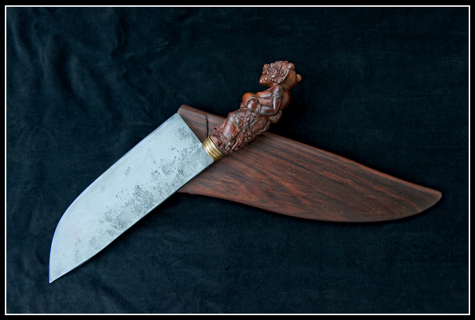

Hi Rob. I completely agree with Detlef here. We just need to stop calling Balinese pengentas tiuk a "Balinese wedhung". It's not a matter of whether "some do and some don't". It is simply indorrect, regardless of what Antiques by the Sea or a wikipedia page calls them. The bottom line is that there just is incorrect information floating about out there and as annoying as it might become regarding these particular knives i am afraid that i will step up and say the same thing every time someone calls a Balinese pengentas tiuk a "Balinese wedhung". LOL!
Yes, both Balinese pengentas tiuk and Javanese wedhung serve ceremonial purposes, but they are not at all related. The wedhung is solely for wear in the court of Javanese keratons. It symbolizes the wearers obligation and promise to "cut a path" for their Sultan. Though mostly symbolic, the wedhung might indeed be put to practical uses at the bidding of Sultan for small tasks around the keraton. The keraton is really the only place that the wedhung is worn.
Balinese pengentas tiuk, as i think you already point out, serve a ritual funerary function. During a cremation, a priest uses the tiuk pengentas to cut the deceased's cloth cord from their body. This symbolizes cutting the person off from earthly life.

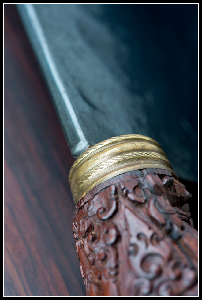

That said, to me your knife most resembles a Balinese temple golok. These knives are used by priests (Brahmin) for the preparation of temple offerrings. Compare yours with one from my collection. Mine is a fairly large and heavy blade, weighing in at 900g (2 lbs). It is also razor sharp.

Very nice hilt on your knife!
Isn't it though.
But the blade is even more remarkable to me. It is hard to get a good grasp of the size and weight of this beast from my photos. And supper sharp. You could probably easily chop a small tree down with it.

Isn't though.
Hi David,
I can imagine! You're like usual good pictures, let's suggest like this!

Hello Séverin,
In the engraving there is copper wire embedded but a lot of it is missing.

Thank you Séverin!

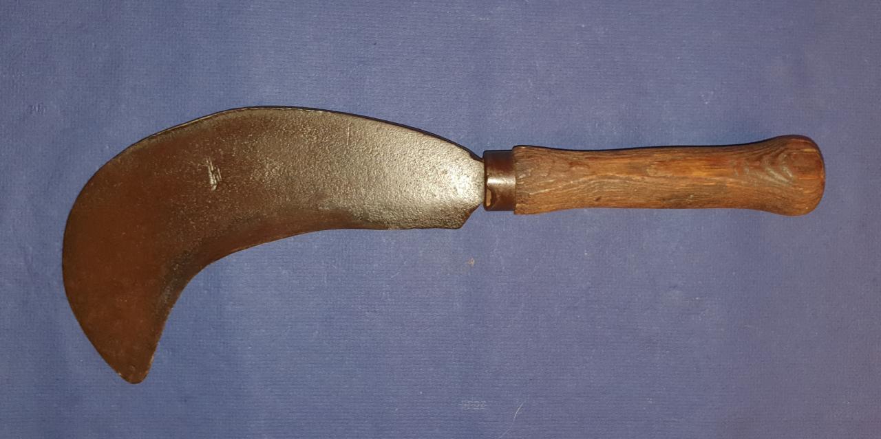

But again with English. I habitually carry a pocket knife. Many of my friends carry one too. Some of my friends call their pocket knife a folder, some call it a jack knife, a very few might give that pocket knife its technically correct name, like "barlow knife", or "stock knife", or "pen knife" or whatever. I don't know why, maybe it was usage in their own families, or in the location where they grew up.
This phenomenon we have everywhere, the sickle knife attached I know under the name "hippe", my grandmother used such a knife in her garden. But this knife is known under several names in Germany, in other regions you would call the same implement "heppe", "häbe", "hape" "knipp", "säsle" "sesel", "schneier" or "gertel".
