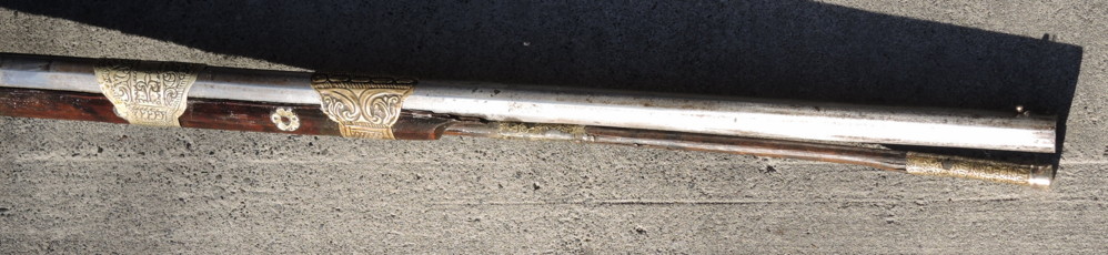

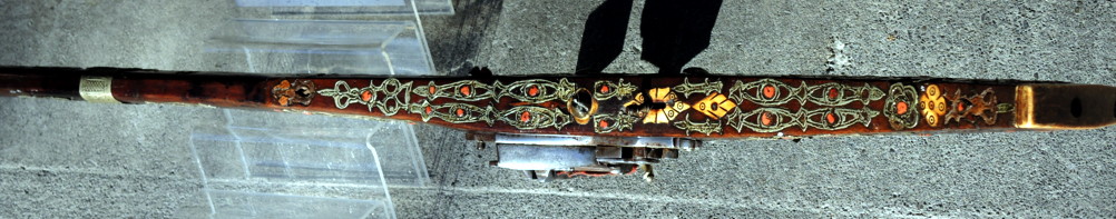

A recent addition to my collection is this Algerian Miquelet Kabyle Smoothbore Musket. Bore is approx .50. Probable age mid 19th century.
Profusely covered with nice inlaid very thin brass decoration and corals. Unfortunately some of the decoration has been lost over time, but the majority remains.
Comments welcome.

Well well well it's a pure beauty.
The most typical Algerian rifle, in very good condition.
If you don't have the book Gold and Coral, you should buy it immediately.
You will see plenty of them, exactly like yours...
I think that the lock was decorated and some brass or silver is missing.
