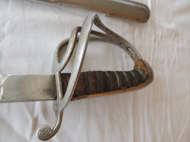

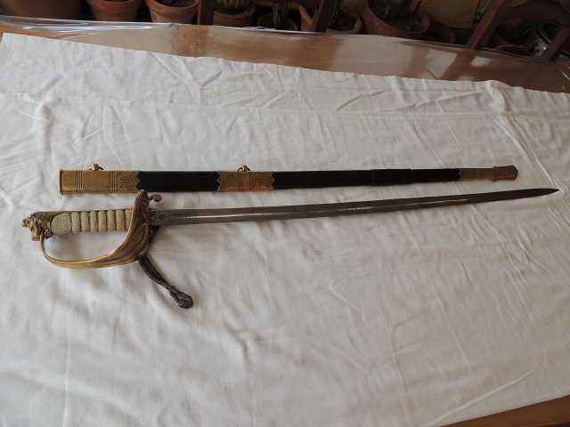

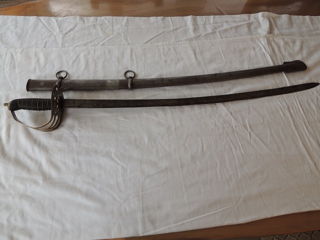

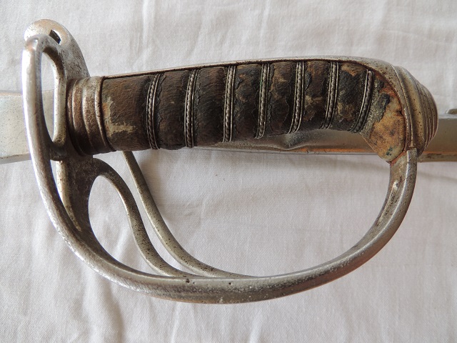

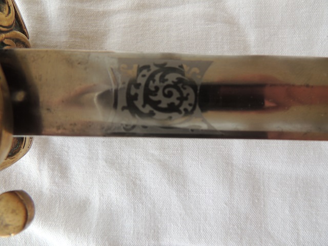

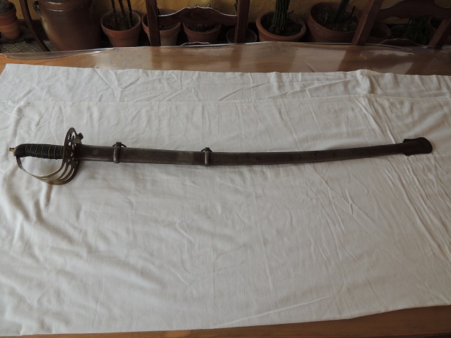

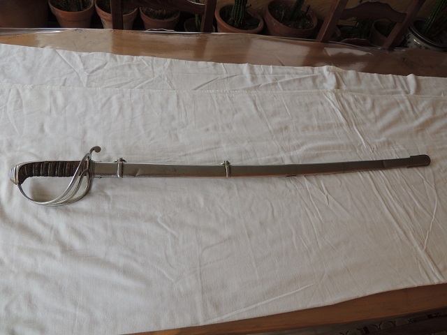

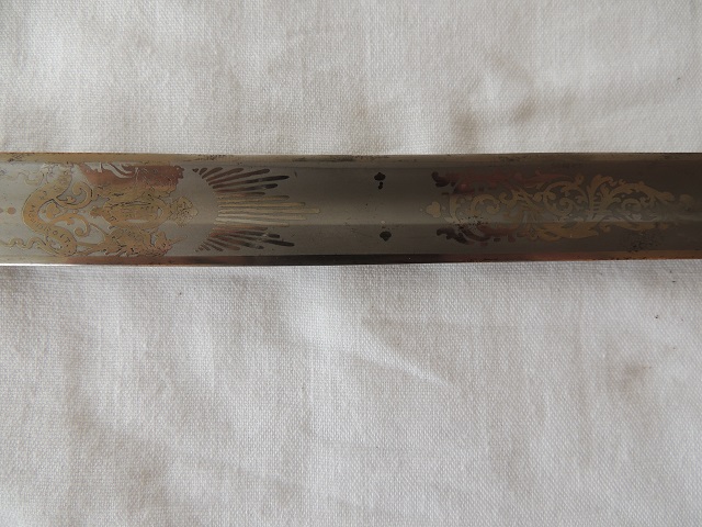

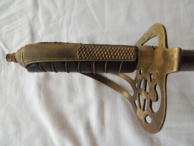

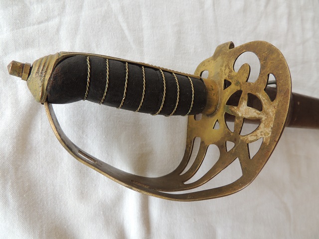

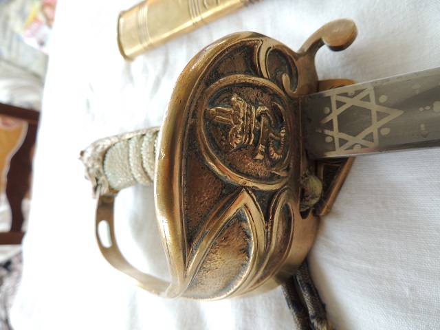

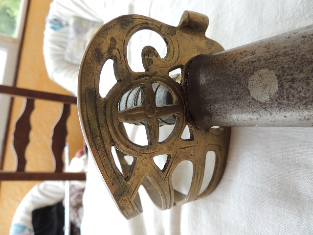

Hi

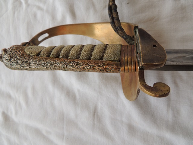

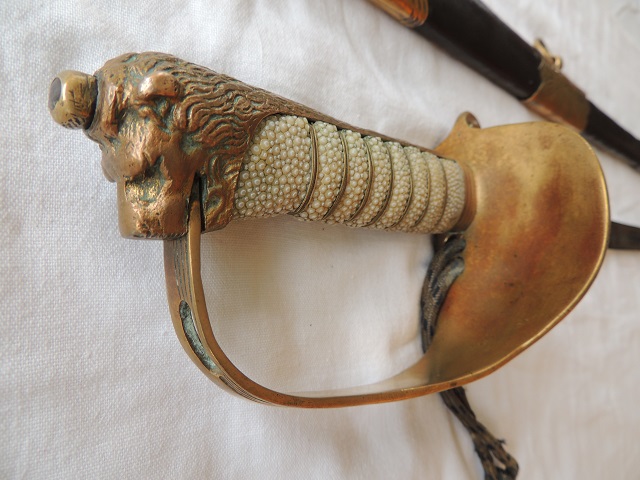

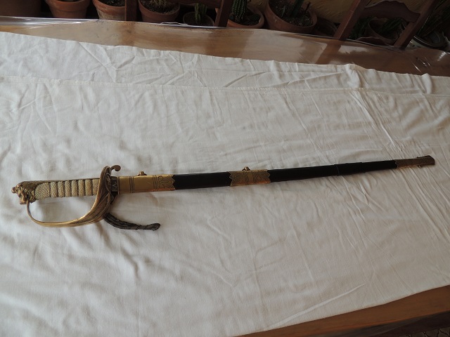

I would question the two brass guard swords, the casting on the naval one is very rough and I do not think this is an issue item, grip wrapping looks v poor.
The one with the cross motif also looks not to be of the best quality either

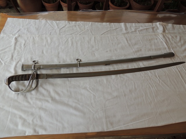

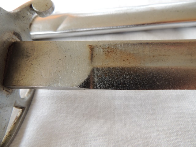

The silver coloured guard sword looks to be better quality.
Might be a 1821 troopers sword or an artillery model
I aim looking on a phone do images are on the small size
I have robinsons book so will come back to you later on
K

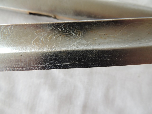

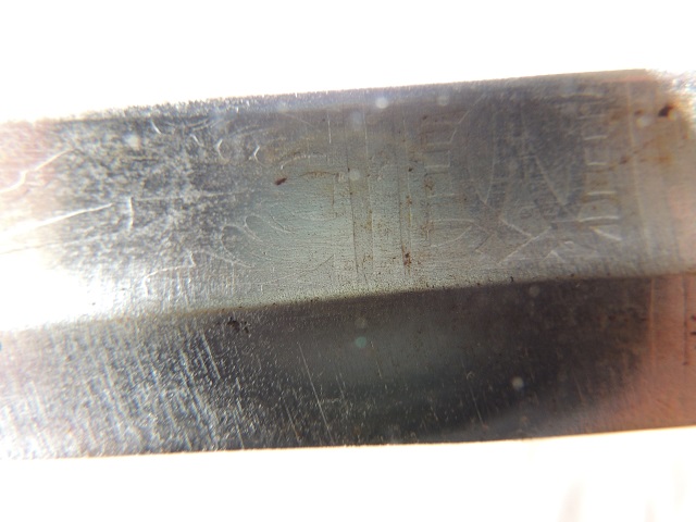

Old 1st August 2016, 07:36 PM   #5
RobertGuy
Join Date: Aug 2015
Posts: 135

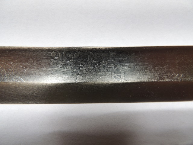

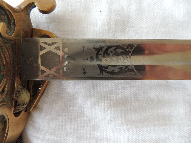

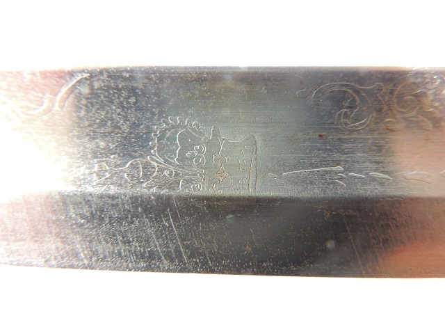

I agree the first sword is a cheap Indian tourist item. The 1827 pattern Royal Navy sword seems a bit rough but I would not label it a fake without closer examination. Interesting that it seems to have the remains of a correct pattern sword knot attached. The other sword looks to be an 1821 British Light Cavalry Officers sword. The etching on the blade has all but been rubbed away but it obviously was etched. Troopers swords were not. Closer examination of the the latter two swords might reveal makers or traders names etched on the ricassos.

Old 2nd August 2016, 03:56 PM   #6
weapons 27
Join Date: Feb 2012
Posts: 462

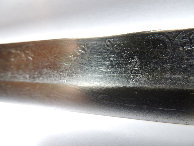

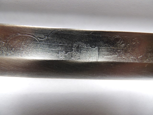

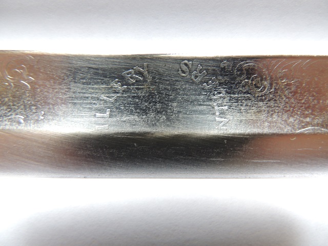

No it has no markings on the sword ...
on the second there are some things written on the blade ... I am unable to read entirely !!
for the first it is a copy made in india ???
