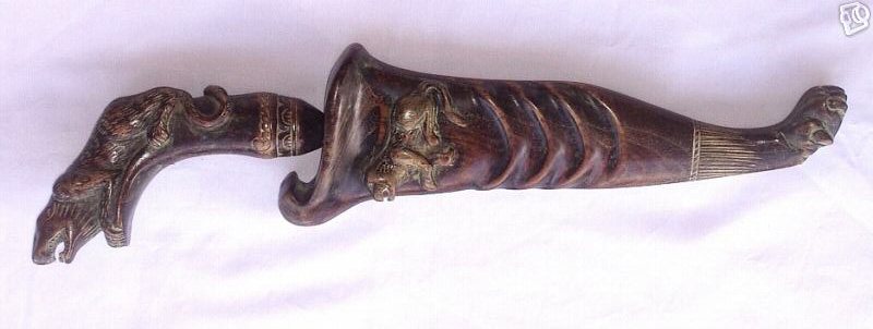

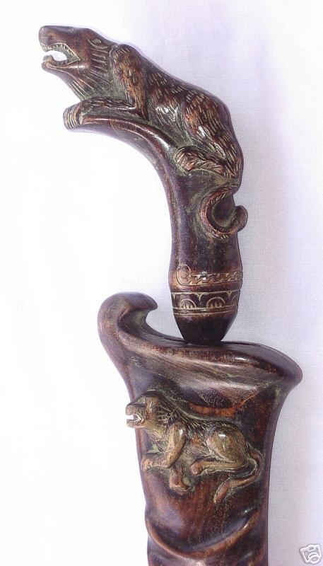

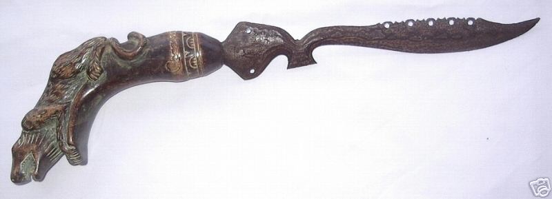

I got this kudi. The seller told :" the blade is not one of these lots of fakes..... it is antique". I like to have Your comments about the "antiquity" of the blade and on the whole item (I never saw a similar one), whose origin should be West Java (Java Barat).

Do you think this is a recent manufacture?
My first thoughts too. Reminds me of Valiant Co pieces... [ examples here ], [ more ].
However, the curvature of this piece is 'straighter' than the Valiant Co examples.

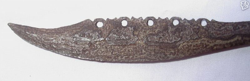

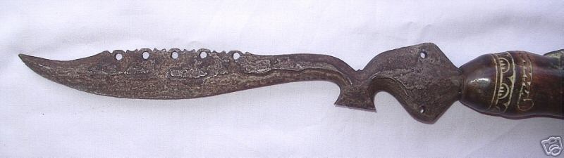

Surely my kudi looks similar to the Valiant Co, but IMO is of an higher quality. I know that with arsenic bathes is possible to have an older blade, but the pamor has a good patina, that doesn't seems dued to repeated washes. Also the wood looks old, but I guess newer than the blade.
Paolo

Sorry but this seems to be a nice reproduction.
The blade texture Or patine looks be etched into the blade.
The dapur is not like the old ones. (to perfect holes and outlinings)
Nice but Modern sarong.
