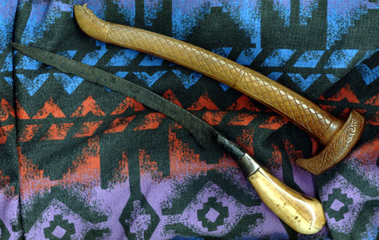

Hello All,
Just received this knife today. Looks like an Acehenese Rencong to me. Blade seems to be hand forged monosteel of good quality. Scabbard and hilt are brass with a silver wash. Craftsmanship is pretty good. I'll try to get better pictures this weekend. Any comments or information are very welcome. The completed auction is here.

Some (hopefully) better pictures. If it's just an average piece, it doesn't hurt my feelings. I like it anyway.

It's definitly brass. Someone has cleaned to vigorously and worn through in spots.

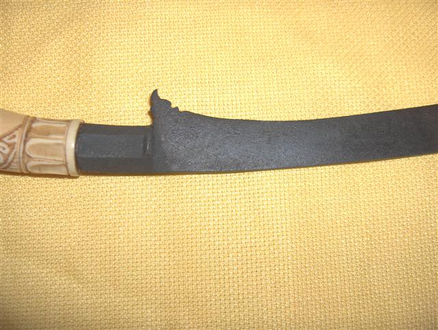

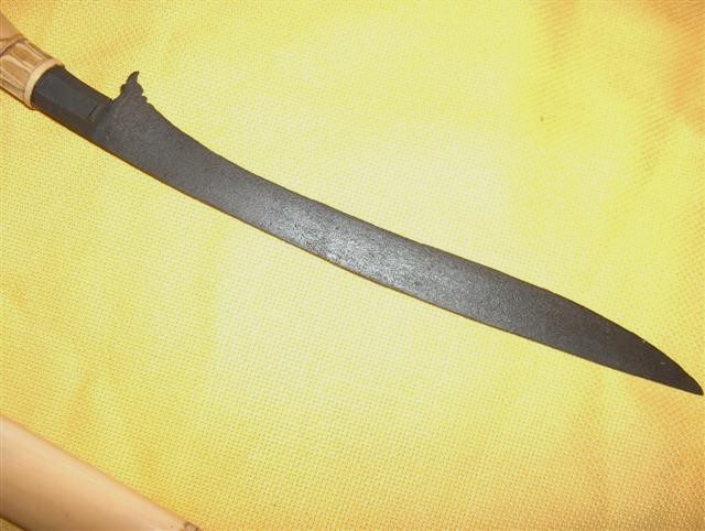

My 'average piece' rencong.

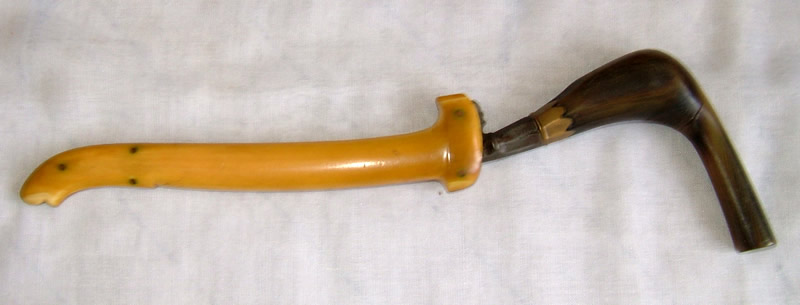

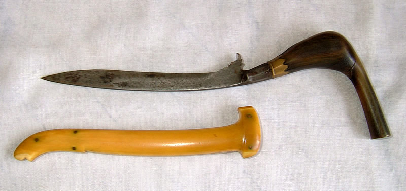

I have two, a very old ivory hilted piece with the blade nearly disintegrated from age and a second that looks to be only months old and yet still made with some care, although definitely an average piece or below.
Mike

Conorge, that's a very nice old piece you have there...drool.
Any idea how old is it? The blade material look like those of keris.
A close up picture of the blade would be nice.
Where's the other picture...?

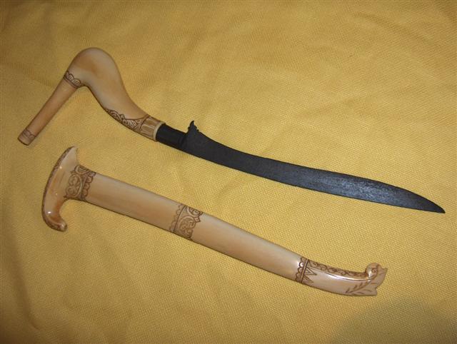

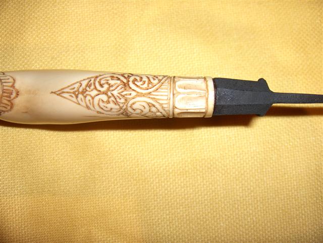

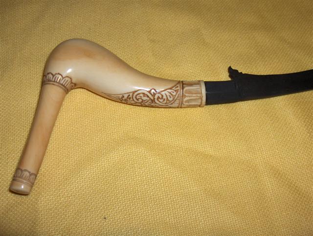

Posts: 374
I received my Rencong so here it is. I have to say I think it is the nicest thing in my collection at this stage. The blade is 18 cm (7") and overall length about 30cm (12"). Well made and the patina on the ivory is developing nicely. It would certainly inflict a nasty slashing cut but if used as a stabbing ripping weapon (as described in A.G.s post) I think it would be much more damaging. Sorry about the quality of the images, no natural light around right now.
