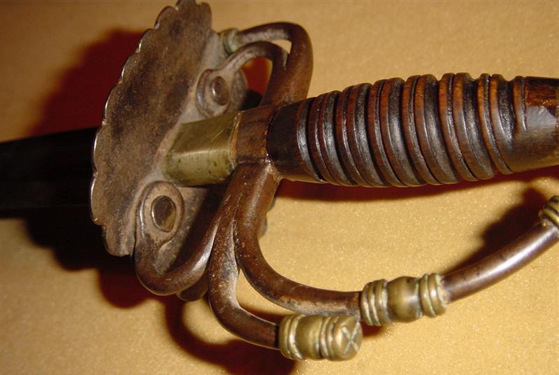

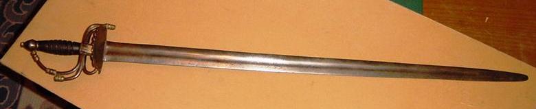

I am not at home, my camera batteries are ran out and i don't have my precious tripod. But i couldn't wait to show this piece, for which payment i had to get naked . These lousy pictures try to show an aledgely 18th century Spanish colonial tigela ( bowl ) sword.
The double edged blade, with a wide central fuller, is 76 cms. (30") long and 3,5 cms. (1 3/8") wide.
Clear marks on the blade left side and only a half dozen letter traces remaining on the right face ... probably impossible to decipher.
Anybody to coment on the marks and, obviously, on the sword ?

Indeed this does appear Spanish colonial, and seems to be an interesting hybrid of the bilbo type guard system, as well as reflecting the influence of European smallswords. The scalloped type edge of the shellguard is further evidence of the colonial possibilities, as well as the shape on the terminals and elements on the guard.
The blade looks to be one of the heavy military type broadsword blades that are now thought to have been actually Solingen made c.1770's and typically have the 'Spanish motto' in the triple fullers.
The large initials appear to be of either an owner or possibly a unit? In any case they would not be makers initials as far as I know.
The only associations with espada ancha would be that during this period, many of them carried these type blades, often reduced in length. The scalloped shell theme also occurred on some espada ancha in a flat extension of the guard that was like a large langet parallel to the blade.
Very nice! and its interesting to see a 'smallsword' type example that seems to be contemporary with many of the 'bilbo' swords, probably end of the 18th to early 19th century, and probably for an officer.

Marc would like to be able to say something about the marks, but he can't It's a small brass inset what I seem to see in the mark closer to the hilt in the reverse of the double "B" (fifth picture, DSC00010.JPG)? It may be an optical effect...
I'm still looking around for it, but as a first approximation it's indeed Spanish/Spanish Colonial. It's not the first one I see, with some minor variations. Blade seems to be "import", probably German. It's a military sword, Cavalry/Dragoons, second half of the 18th c., and a nice piece to boot, my sincere congratulations

Fernando, if I were trying to classify this it would be as a dragoon officers shellguard dress sword with bilbo style quillons and of latter 18th century, probably Spanish colonial. The true Bilbo does have a bowl type guard, and it does seem that there may be some association with Bilbao as far as the derivation of the term. While a bit lengthy in words, it is better to be more descriptive when an atypical form is the subject.
Marc, its great to hear from you on this, and I agree it really is a nice example. I was hoping you might something similar among the regulation Spanish swords, but for the most part this seems like a cavalry officers sword that reflects the smallswords of the gentry, much like the British M1796 Heavy Cavalry officers dress sword.

What is the significance of the brass on the Ricasso and quillons? To my eyes they look to be added later than the swords original manufacture. Could there in fact be other marks under the brass that covers the ricasso?

Come on, it IS nice, and you very well know it o wouldn't have bought it to start with... *grin*
It's Spanish Colonial and very likely for mounted forces, hence cavalry/dragoons. The "bilbo" thing it's a bit more complex... English-speaking collectors (and as far as I know others influenced by the English-speaking arms collecting world) tend to loosely call "bilbos" to swords with a double-shell guard. The term is somehow historical, and in period referred to late 16th and 17h c. rapiers with this kind of hilt.

As you can see, the "colonial" versions were slightly different, with an alternate shell and the brass highligths. The brass ricasso it's there because these swords mounted all kinds of imported blades, some of which had no ricasso to speak of, so they put that hollow brass "capsule" on the tang in the right place to create an operative "fake ricasso".
The blade in Fernando's sword seems to be an import, probably German, as said before. Again, the marks are not familiar, I'm sorry.

The sword is indeed a cavalry form, and resembles the style of horsemens swords of the low countries, sometimes referred to as 'walloons' (another term with interesting history) and used by the British also in the late 17th century. This sword seems to reflect a combination of these, the bilbo (M1728) and as mentioned the dress swords for officers of beginning of the 19th century. All of these suggest the profound preservation of traditional form that is a hallmark of the beauty of Spanish weapons.
Gavin, good observation on the brass, which is often used in variation on Spanish colonial weapons, and typically seems to be an aesthetic affectation. It is possible a makers stamp might be under the brass collar on the ricasso within the pas d'ane. The brass terminals and en suite additions to the guard appear for dress, in Spanish colonial application much favored.
