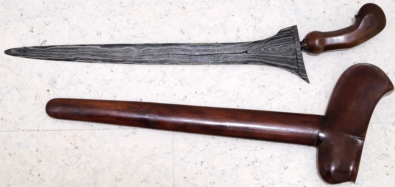

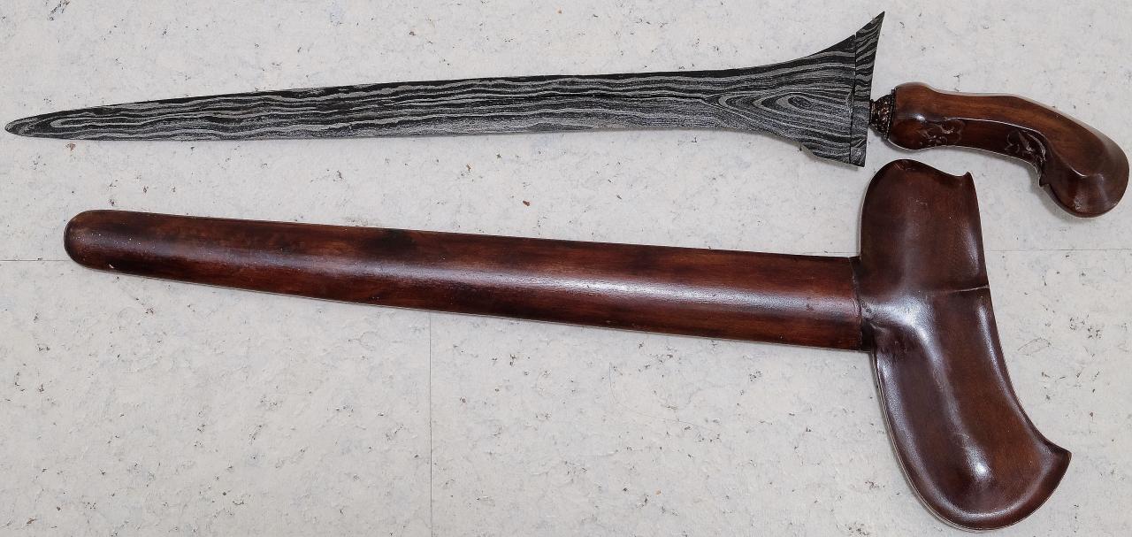

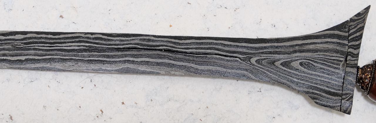

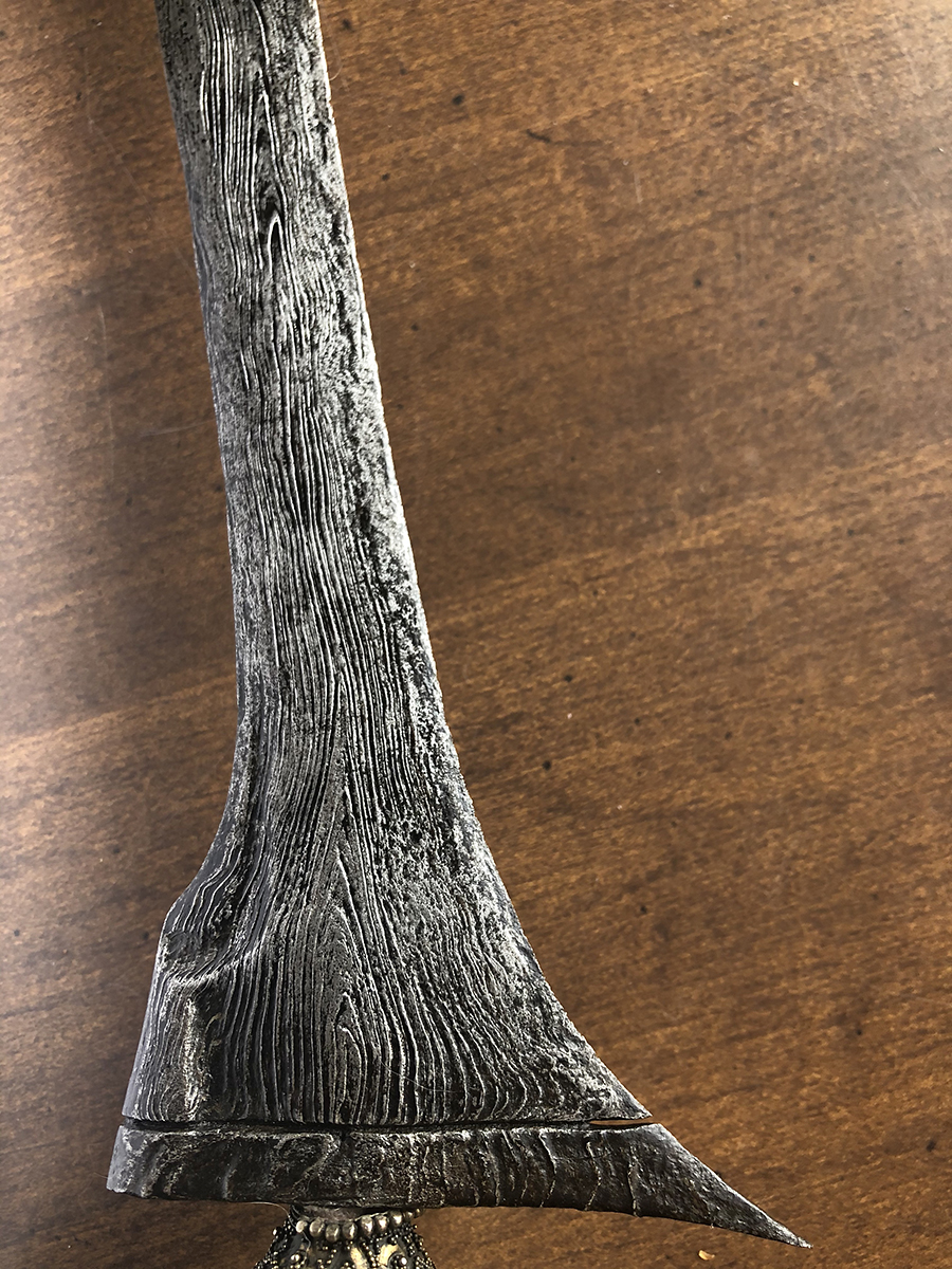

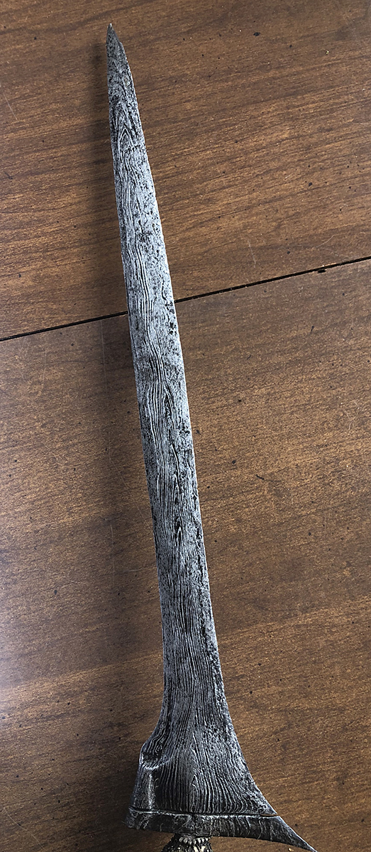

I came across one of these krisses and I was lucky to buy it for an affordable price. I do realize that this king of pamor often may result in a vertical split within the layers and that the Indonesian tradition is that this attributes magical powers to the blade (perhaps an early form of good marketing ).
Nevertheless I found it very charming and decided to acquire it. I Think this may have been a blade made in Madura, probably something arrived in the NL somewhere around the ’50.
Old 14th February 2022, 01:56 PM   #2
Posts: 7,303
I have seen keris that have slots or holes in the blade that were obviously pre-determined and intentional. I do understand that weld failures like what caused the slot in your blade are often accepted as “combong” by many collectors, but that does seem to be more a marketing ploy than anything else, attempting to turn a bad forging into something magickal and desirable.
Old 14th February 2022, 02:06 PM   #3
milandro
Join Date: Jan 2022
Location: Netherlands
Posts: 500
I am aware of that and in fact I suggested the tongue in cheek “ old marketing” .
I have found a number of examples of modernly made krisses with similar forging features.
I understand that a western blacksmith would chuck the blade BUT an Indonesian empuh probably, beside not throwing away some work done, he probably thinks that the process is only partly in his hands and that he is rather the instruments of a superior being that through him creates the blade and maks it inhabited by a spirit and gives the blade its properties.
I am not trying to make this better than what it is (by the way I was very much thrilled to buy the blade) but when I visited the house (a temple really) of an old Indonesian man here in the NL with a couple of hundreds of krisses , a few were like this and he was telling me how important (to him) these things were.
Old 14th February 2022, 11:50 PM   #4
Posts: 7,303
Milandro, i believe you are absolutely correct about that. My comments were not intended to disregard your keris and i have been informed by sources i trust that indeed "Acts of God" are what are important a Javanese Muslim in this case. So when a mistake like this happens it can be seen as a mystic circumstance. I am not sure how many actual empus make accidental mistakes like this in their forging technique, but we should remember that most keris are not made by empus.

If you're interested to know more about this blade, I think it may be worth seeing if this is a Tuban style keris. It has a low gandhik and shallow blumbangan, which are features that might support this classification.
One way of assessing this is by looking straight down onto the flat face of the gonjo, like shown here: http://www.vikingsword.com/vb/showpo...2&postcount=23
This post will give you an idea of what to look for: http://www.vikingsword.com/vb/showpo...2&postcount=17
Of course these cues are visual only. My understanding is that opinions about a keris' classification can change when it is in the hand of someone experienced.

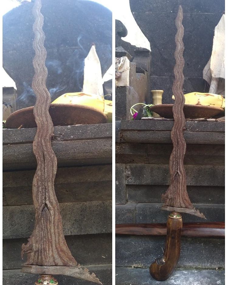

Old 16th February 2022, 11:11 AM   #7
Jean
Join Date: Jun 2009
Posts: 1,740
IMO this is a recently made blade (end of 20th century) so the style should be rather identified as kamardikan or Tuban putran (replica) if you wish. Of course other opinions are welcome . Also the pamor pattern looks more like Raja Abala Raja (King of the Kings) rather than Ujung Gunung, but it is not perfectly executed (weld flaw).
Regarding the use of plastic wrap for preserving the blades, I also don't use it as it it not required ind a dry environment like in Europe and I keep my blades into their scabbards. The single occurrence of slight blade rusting which I experienced was because the scabbard was new and the wood not fully dry so the moisture affected the blade. I always carefully drench my blades with WD40 upon receipt and wipe the excess, and occasionally apply cendana oil for improving the smell if required.

Old 16th February 2022, 11:22 AM   #9
Jean
Join Date: Jun 2009
Posts: 1,740

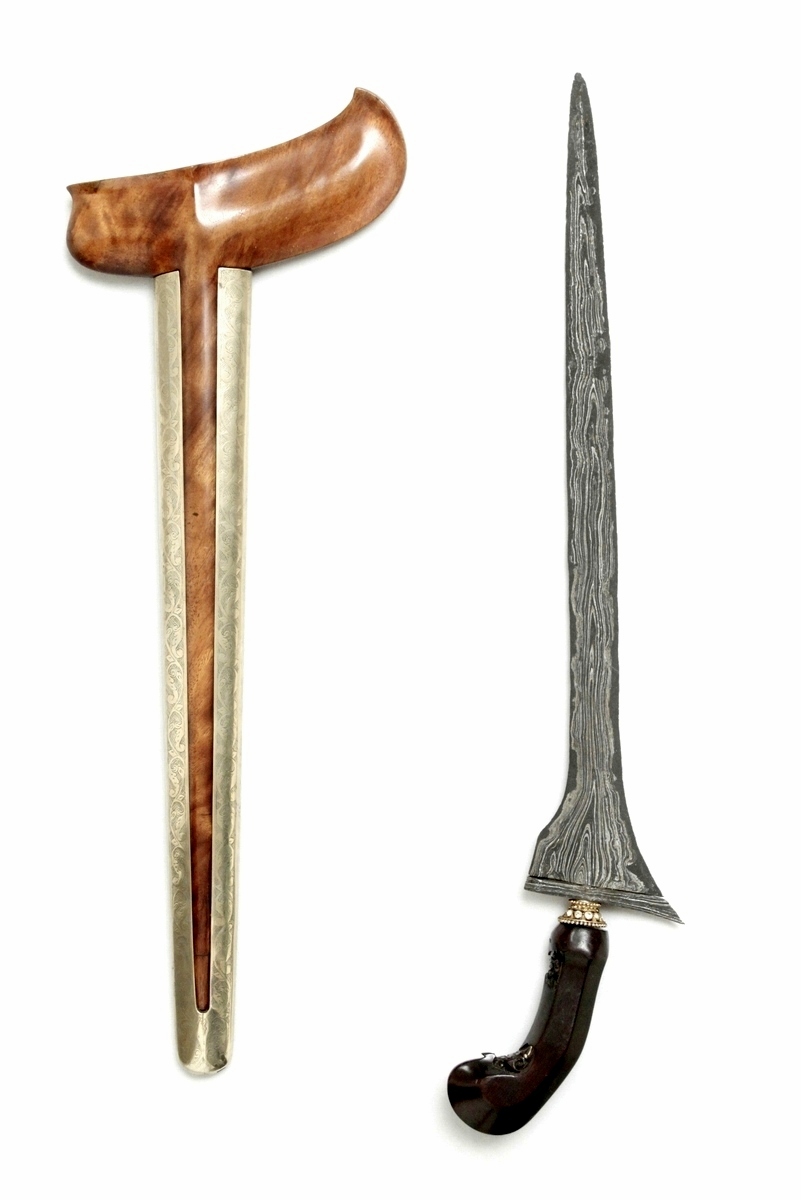

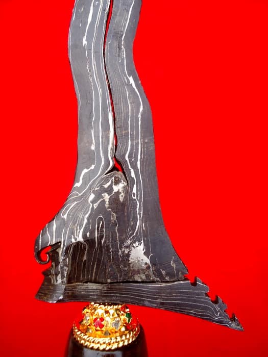

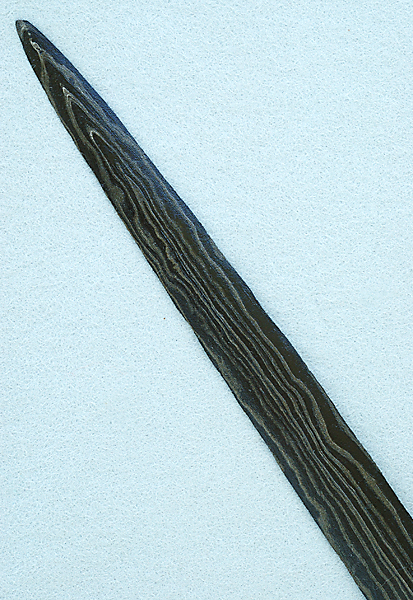

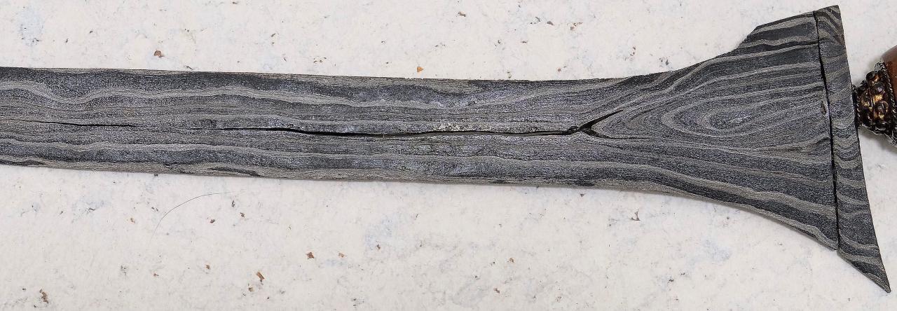

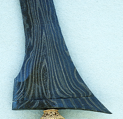

I attach the pics of 2 blades with a pamor pattern tentatively identified as Raja Abala Raja (top) and Ujung Gunung (bottom) for reference and comments if any.

Milandro, I am rather inclined to agree with Jean that while your blade might well conform to Tuban standards, it is not likely to be an old Tuban blade. Seems 20th century you me as well.
As to the pamor, identification is not really my strong point when comparing very similar pamor patterns, but i certainly would not have argued with your Ujung Gunung identification. Here is one of mine for comparison that has been identified as Ujung Gunung by a very reliable source.

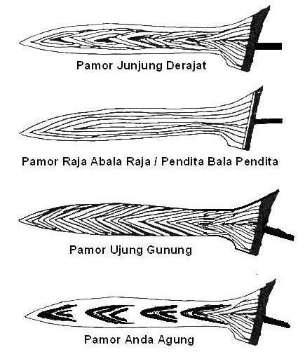

I would also identify the pamor pattern of your blade as rather Raja Abala Raja or Pendita Bala Pendita than Ujung Gunung. As shown in post #8 from Milandro, the triangular motifs of pamor Ujung Gunung are starting from the sides of the blade, while for pamor RAR and PAP they mainly start from the base of the blade.
However if you search "pamor Ujung Gunung" and "pamor Raja Abala Raja" on Google and see the pics, you will get totally confused, so pamor Ujung Gunung may be correctly attributed for your blade...

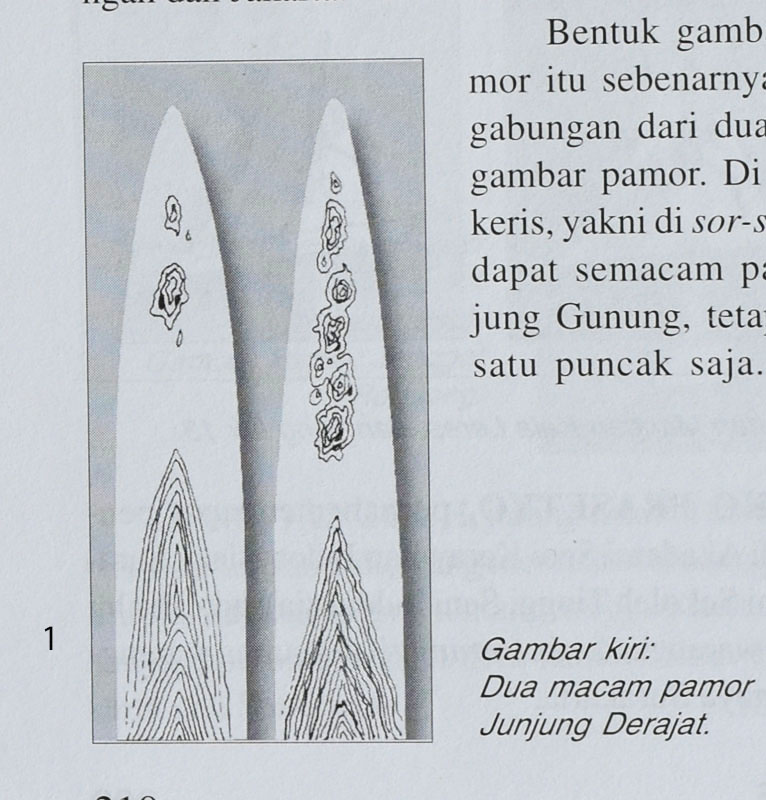

Jean, thank you very much for your post #13.
This demonstrates very nicely exactly what I was commenting on in the first paragraph of my post #12.

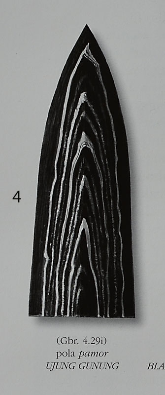

Now, if we look at Milandro's post #8, we can see somebody or other's idea of the names applicable to several pamors, you have referred back to post #8 and used these names & illustrations to classify the pamor that David has shown in post #11.
David has named the pamor in his keris as Ujung Gunung. This keris looks as if it could have come from me, and I would have named it as Ujung Gunung. It was probably a long time ago, but I would still name it as Ujung Gunung today. As to the age of this keris, it could be either current era, or late colonial, I do not remember it, and I cannot differentiate between the two possibilities from a photo.
The established & reliable dealers in Solo would name it as either Ujung Gunung or Junjung Drajad (drajat).
I believe I might have a copy of the publication that Milandro has taken his picture from, but I forget what it is, and I do not have time to look for it.
However, a quick look at recent publications, "Keris Jawa" & "Ensiklopedi Keris", do have pictures of Ujung Gunung, Raja Abala Raja, & Junjung Drajad. I have copied and posted these pics into this post, and added a number to the left hand side of each picture.
1 --- Ensiklopedi Keris
2 --- Ensiklopedi Keris
3 --- Keris Jawa
4 --- Keris Jawa
When we give an opinion on the classification of anything to do with a keris, it is always a very good idea to support that opinion by giving a reference to the place, time, & possibly person that has enabled us to provide that classification.
Incidentally, I have never heard anybody mention Pamor Raja Abala Raja in Solo, I have seen only one example of this pamor and that was in Malang East Jawa some time prior to 1998, this example was almost exactly as shown in EK, that is with motif elements overlaying each other. I forget what the seller named it as, but I doubt that it was Raja Abala Raja, if it has been I would have remembered that name because it was so unusual. It was probably a Kamardikan.
Just one tiny further comment, it might not be a particularly wise idea to use keris information sourced from online searches to validate anything at all to do with keris. Of course, this comment of mine automatically includes this Forum of ours, and I believe many contributors to this forum would agree that even here we need good, solid background knowledge to sort the wheat from the chaff.

I did make note of the drawings presented by Milandro in post #8. The problem here is why should we consider these drawings to be accurate renderings of the manner in which these pamors are formed. Here, for instance, is another set of drawings that present pamor and dhapur. Please note the way Ujung Gunung is depicted on the left in this illustration showing that pamor. Now look at the other illustration i have posted showing someone else's idea of pamor Raja Abala Raja.This one certainly doesn't look like my keris, does it? It looks more like what is described in the illustration Milandro presented as Junjung Derajat.

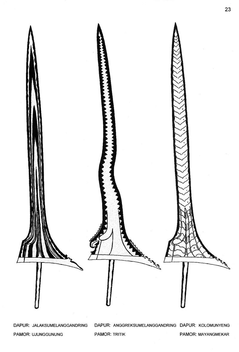

It seems that the pamor pics shown by Milandro basically originate from the book "Pamor Keris" written by Bambang Harsinuksmo and first published in 1985, although B.H differentiates between pamor RAR and PAP. I attach the pages related to these styles of pamor patterns, and it translates approximately as follows: "As a difference (between pamor Ujung Gunung, Junjung Derajat, Raja Abala Raja, and Pandito Bolo Pandito), for pamor Ujung Gunung the base of the angled lines start from the edges of the blade. Pamor Raja Abala Raja is similar to Ujung Gunung, but the angled lines which join together start from several places, from the sor-soran, the middle and the tip of the blade. For pamor Pandito Bolo Pandito, the tip of the the angled lines are all joining together at the tip of the blade".
This being said, David, I am not trying to convince you about the ID of the pamor pattern of your blade, I had great difficulties to identify mine, and as said by Alan, the pamor names may be different in Solo than in Yogya or East Java. Pamor Pandito Bolo Pendito is not mentioned in the EK nor book Keris Jawa for instance.

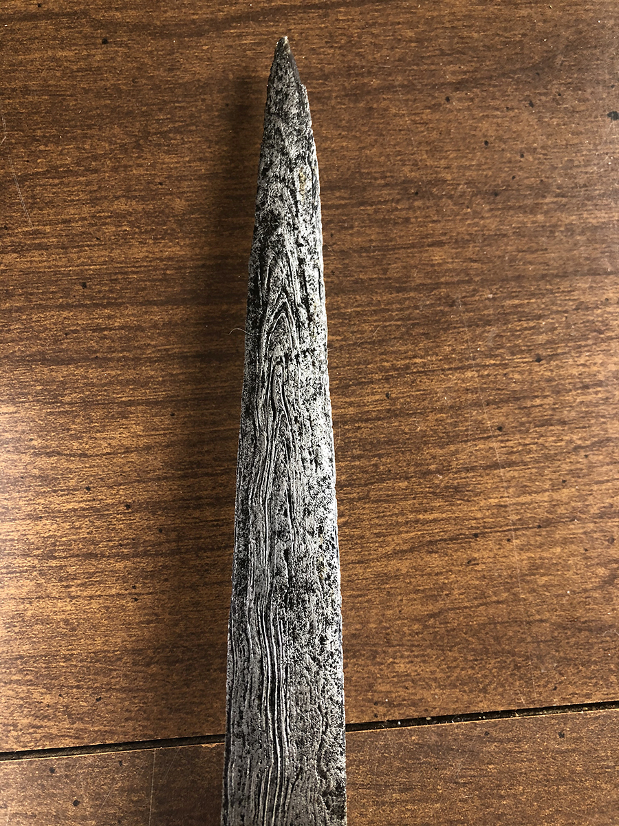

I didn’t get it anywhere else than on this very forum, I used the search engine for this type of pamor there was a discussion, there, there was the address which I used in the link to the image

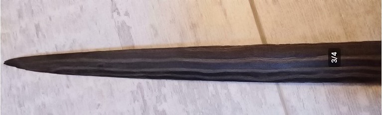

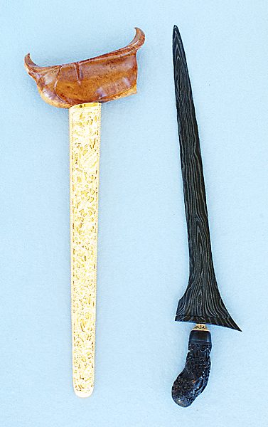

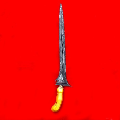

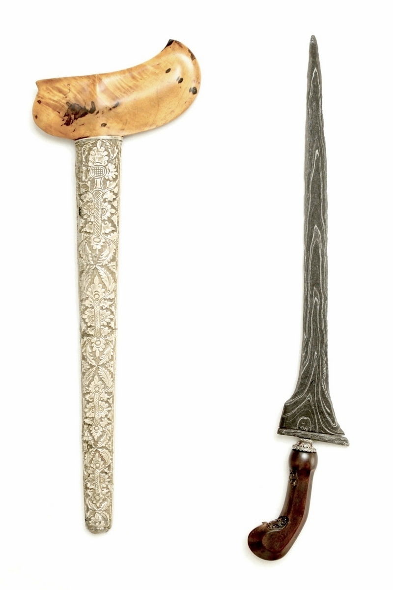

as an extra contribution to this thread (which shows how academic these things may go) , I’ve bought another keris with a SIMILAR ( but not identic) pamor.
For you to study
This is in a Bugis handle and Sarong
Old 18th February 2022, 11:00 AM   #20
Jean
Join Date: Jun 2009
Posts: 1,740
For you to study
This pamor pattern looks rather Adeg Lima or Adeg Tiga/ Teja Kinurung Wengkon IMO Not a Bugis blade BTW.
Old 18th February 2022, 11:08 AM   #21
Posts: 7,255
So Jean, in 1985 Harsrinuksmo publishes these drawings, and 2004(?) in EK he publishes the drawings that I posted.
A comparison between both sets of drawing might be educational.
Harsrinuksmo worked with Lumintu. Who actually produced the drawings?
To try to demonstrate that one representation is more correct than any other is just too silly for words --- I know you are not trying to do this --- but here we have varying representations of a very scarce pamor that I might have met with once in my lifetime, in spite of the fact that each time I went to Indonesia prior to 2015 I saw & handled several thousand keris. I cannot help but wonder if anybody is at all certain about this particular pamor.
Haryoguritno lists it, but I don't think he illustrates it.
The simple bare fact is this:- there is a great deal about keris "knowledge" that is not knowledge at all, it is belief, and that belief can be limited to a very small number of people in a single location.
RAR appears to be a rather difficult pamor to make, if the illustration in EK can be taken as accurate it is not something that is produced with a single billet manipulated in just a couple of operations, if EK is correct it is produced by preparing a number of small motifs which are then overlaid, more or less as a montage, one upon the other.
Yep, this new example is an adeg pamor, some people might call it Adeg Lima --- or adeg + some other number --- but then some other people believe that once an Adeg pamor exceeds three upright strands, that adeg pamor becomes Adeg Sapu, adeg = upright, sapu = broom.
Nothing with keris is carved in stone.
Just one little thing that we need to remember when we are dealing with the contents of EK & KJ. The author of EK was a journalist with an interest in keris who drew heavily upon the Jogja belief systems where Javanese keris are concerned, this of course was inevitable because his principal source of information was Lumintu. The author of KJ was primarily a collector with a very great deal of his wealth invested in keris, we might wonder just how many of his elite keris are still in his possession.
My own perspective is that very, very few keris publications that have been produced in Indonesia have been produced solely for the purpose of spreading knowledge.
I know of only one small, limited publication that is totally untainted by obscure objectives and that provides pure, accurate information on the Javanese Keris, and that is the exhibition guide book that was written by Garrett & Bronwen Solyom in the 1970's:- "The world of the Javanese Keris".
With every other publication we need a very high level of knowledge and a very cautious approach, as well as the ability to read Bahasa Indonesia very well, to extract much of worth from the plethora of Indonesian keris publications that has been produced.

Old 18th February 2022, 02:19 PM   #23
Jean
Join Date: Jun 2009
Posts: 1,740
Thank you Alan and I agree with you. May I know which pamor pattern would you attribute to the 2 blades which I have shown on the pics of post #9?
Old 18th February 2022, 09:07 PM   #24
Posts: 7,255
Jean, the name I would use for those pamors shown in your post #9 would depend on who I was communicating with and what my feelings were at the time.
The ways in which we determine how to name something like this depends upon many factors.
That little phrase "name game" gets bandied about fairly frequently, but not many people understand the rules of the game. I think most Javanese people do understand. Instinctively.
Rule #1:- chose a name that you feel --- note FEEL, not believe or link to reason, FEEL --- will be understood by, and will not create a negative reaction from the person you are dealing with.
When we understand the keris and the society it comes from, we see pretty clearly that we need to create some degree of harmony in order to get anything from any discussion.
Empu Suparman's approach to naming a pamor was to try to understand what it was that the maker tried to create. But he did not necessarily try to get anybody else to agree with him. If he thought that the maker might have been trying to create, say, ujung gunung, and the other party thought perhaps it was adeg gone bad, there would be no dispute. No dispute, but simply a statement of opinion.
HOWEVER, and it is a big "however" the hierarchical position of the other party automatically dictated the name to be used during that interaction.
Where a person did not wish to use his hierarchical position he simply gave no commitment to any one name.
After all, the more names, the better.
Basic Javanese societal guideline.

Old 19th February 2022, 04:28 PM   #27
Posts: 7,303
Please forgive the bad cellphone photos, but i didn't feel up to breaking out the real camera for this.
Here is one more example of this type of pamor, this time on an older keris in my collection that came in East Jawa dress.
I have always considered it Ujung Gunung though others might see this as Junjung Derajat or Raja Abala Raja i suppose.

My thoughts run pretty much the same way as yours, David.
But I know at least one very knowledgeable person in Solo who would initially give that as junjung derajad, however if I were to then call it unjung gunung, it would continue to be called ujung gunung during our conversation.
So does that mean the Solo person & I would be in agreement?
No, not at all.
All it would mean is that I'm a wee bit higher up the ladder.
