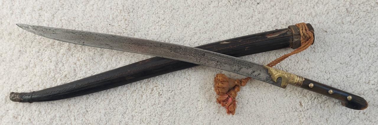

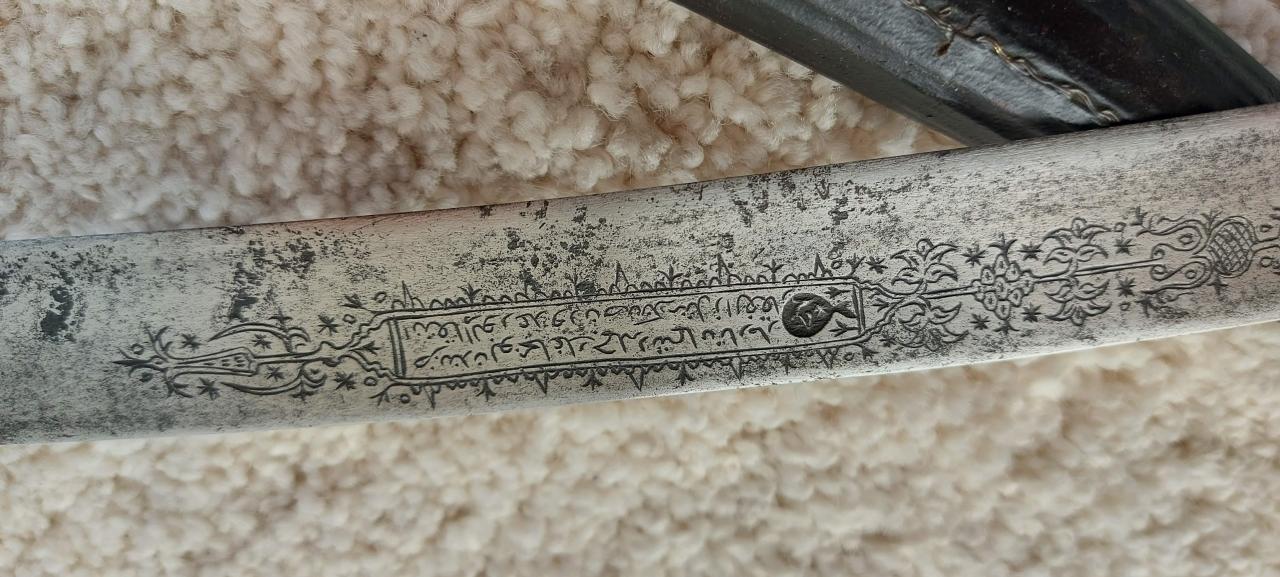

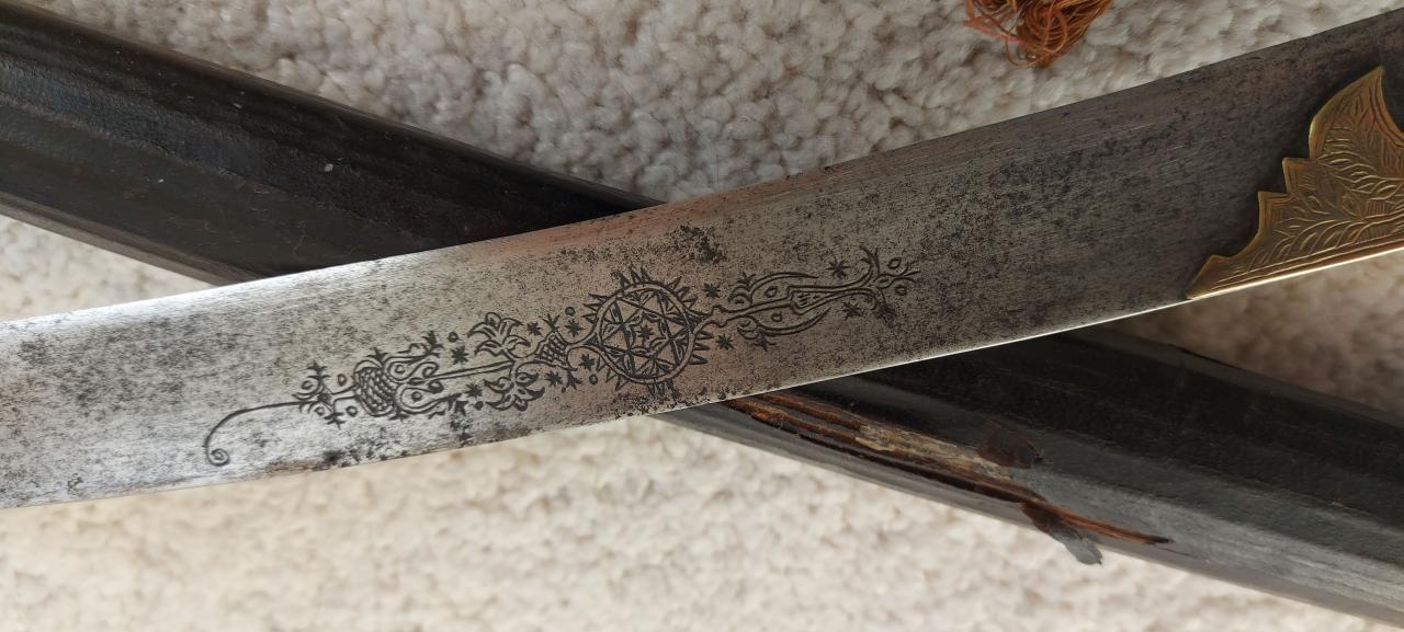

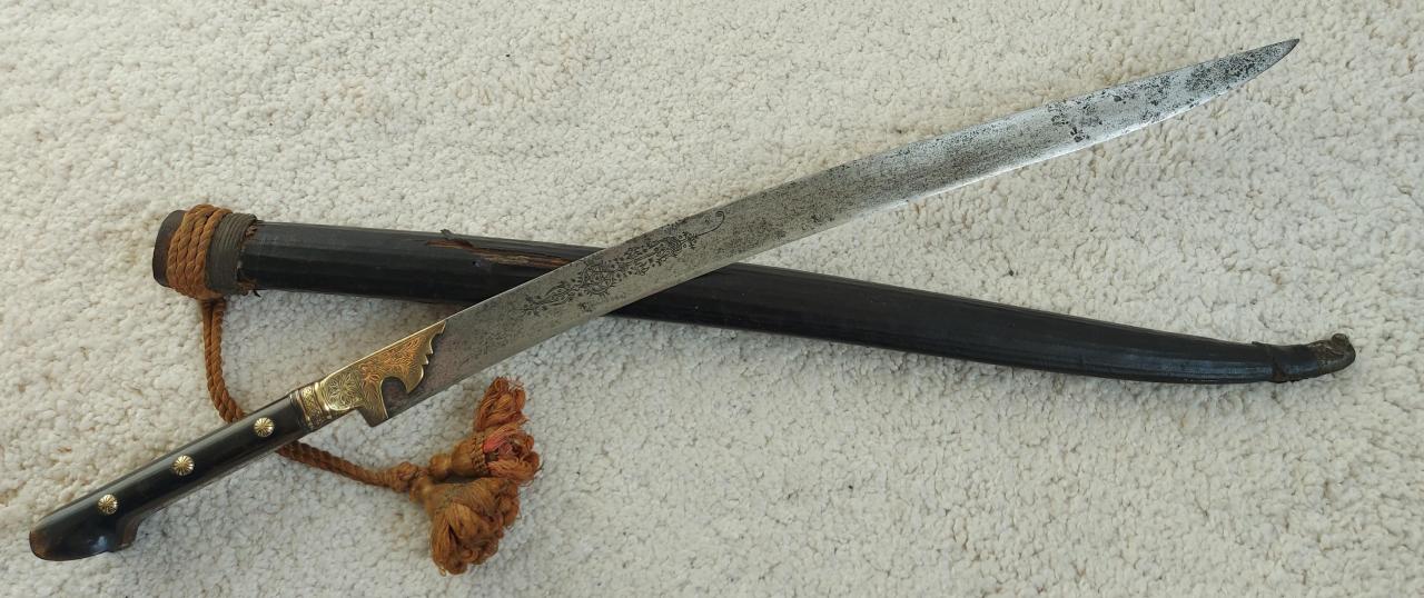

Would you please help me to translate the inscription engraved on the yataghan's blade and possibly date it.
Many thanks for your help.

The engraving on the blade and the inscription are quite standard.
It is very common and characteristic of Greek yataghans and in this form as here I would define it at the very end of the 18th century and in the first two decades of the 19th century (until 1826).
Approximate translation of the inscription: From the sight of this knife, your enemies are scattered, he takes revenge on the enemy like Zulfikar.
Only the photo is upside down. In the stamp, I think the name is Ali.
IMHO the blade is a little older than the handle and the handle is Cretan.
This is a very good yataghan.

Thank you very much for your help and this comprehensive information. For some reason forum turns images upside down when I attach them positioned correctly.
May I wonder why 1826 is a cut-off date in your estimate?
Conduit is offline   Reply With Quote

A more literal translation of this Turkish couplet is
“The entire enemy are scattered at this knife’s blow,
It takes revenge on the enemy like Zülfikar.”
zarbından bu bıçağın cümle düşman tar-ü mar
intikam alır düşmandan sanki misli zülfikar
There is a maker’s mark which reads “Ahmed”
