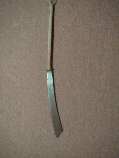

Hello everybody ( And Happy New Year 2020 !!!)

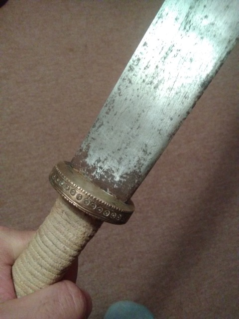

I picked up this long and large sword-polearm in France in a flea market
more than 110cm long half for the blade, half for the handle.
really sharp blade, the back side of the blade is almost 1cm thick...
( not easy to walk with in the street even wrapped with plastic bags.. )
Do you think this model is chinese ? ( maybe vietnamese ? ( guard type ?)

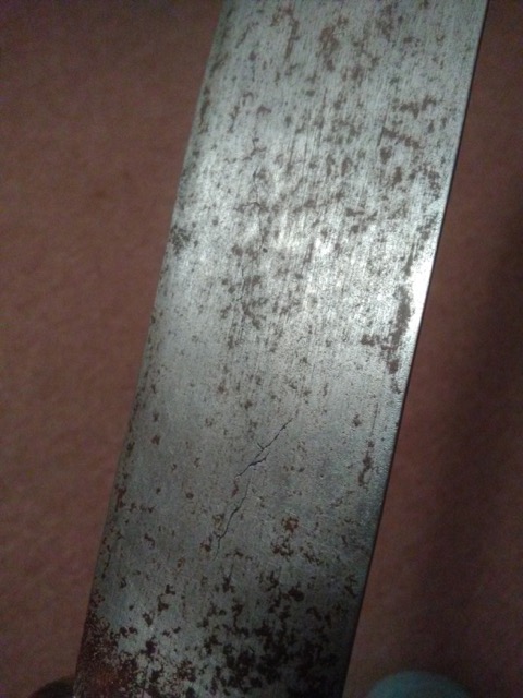

I still havent clean the blade, it seems laminated steel.

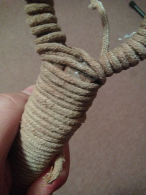

Do you think that the band-rope is a later replacement ?
It's not really well made so
I hesitate to take it off and change it...
I wonder why the handle is so long: too long for a sword,
short for a polearm...
an usual shape ?
What do you think ?
Thank you

It looks like a classic Chinese long sword. I cannot bring the correct name to mind at the moment, but I think it was called something like a "Horse Sword", midway between a pole-arm and a sword and theoretically for bringing down cavalry.

I agree with Ren Ren's assessment of the guard deco. The Vietnamese name for this weapon is dao truong.
While it could have been used as a headsman's implement, falchions of this type were not universally used for the purpose. Images of 19th cent. executions in Vietnam which I have seen in publications tend to show a saber with a narrower, tapering blade more similar to the standard Chinese military liiuyedao or "willow leaf saber". The generic Vietnamese term for weapons with these narrower curving blades is guom.
The handle wrapping on this one looks like a much later or even relatively recent replacement, from its weave and the way it's applied. Many dao truong have grips wound in rattan, which distinguishes them from the flat braided fabric type of cord favored in China.

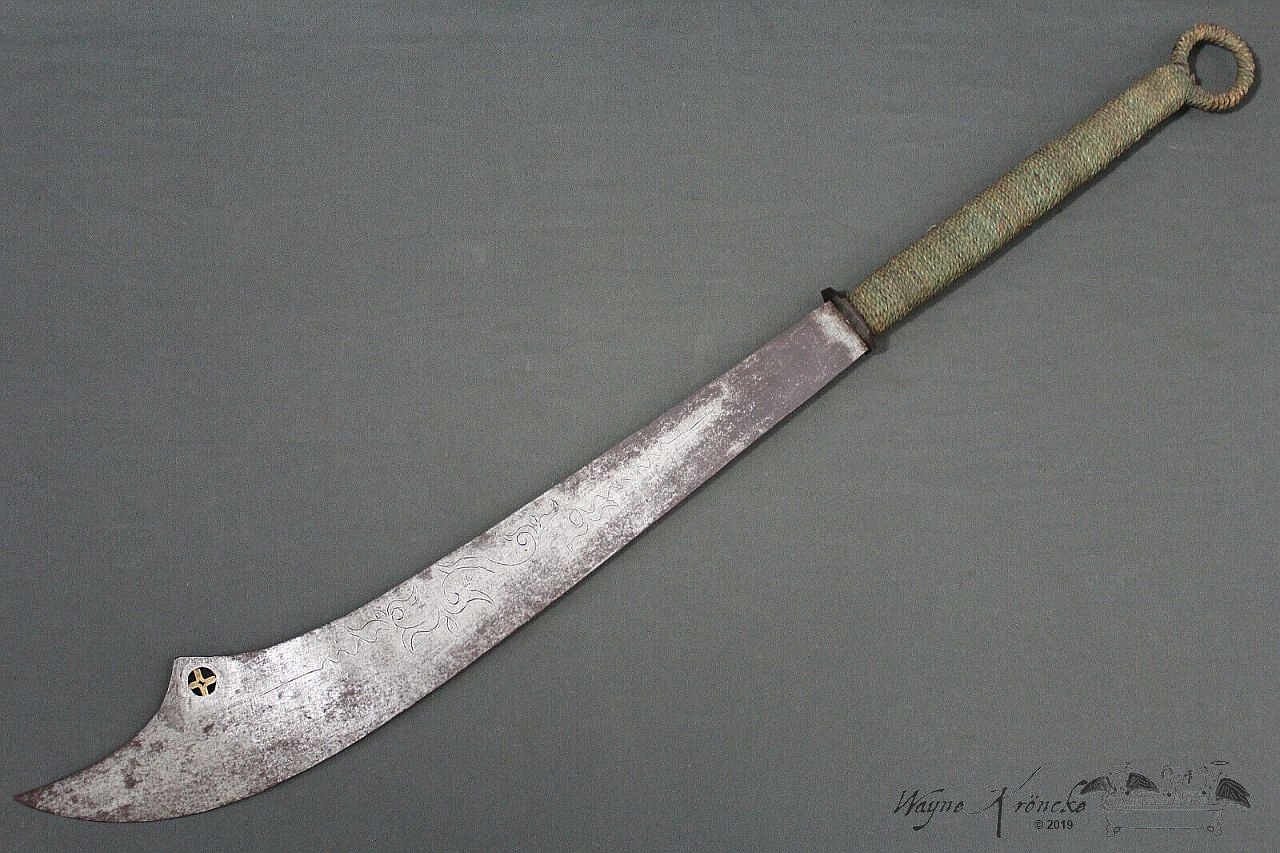

My Viet Truong Dao for comparison.Mine is quite well balanced and feels light and nimble, 85cm. overall, 55cm. blade, grip is wound with a twisted fibrous green cord. I've been told the viet ones frequently have engraved decorations like mine.

Vietnamese blades are often distinguishable from Chinese ones by the simplistic vegetal scrollwork engraved on them. The motif is inspired by the inlaid floral mother of pearl inlays on the hardwood scabbards. Oof military and civil officials swords. Chinese falchion blades are mostly devoid of designs of marks except for military unit marks or slogans

Agreed, a north Vietnamese trường đao (長刀).
Typical Vietnamese features are the very dramatic widening in width combined with the concave clipped tip. Also the small guard and its decoration point towards northern Vietnam.
The wrap is indeed fairly recent. Apart from the type of cord, it is also the way the cord is wrapped at the pommel that looks like: "I don't know what to do here".

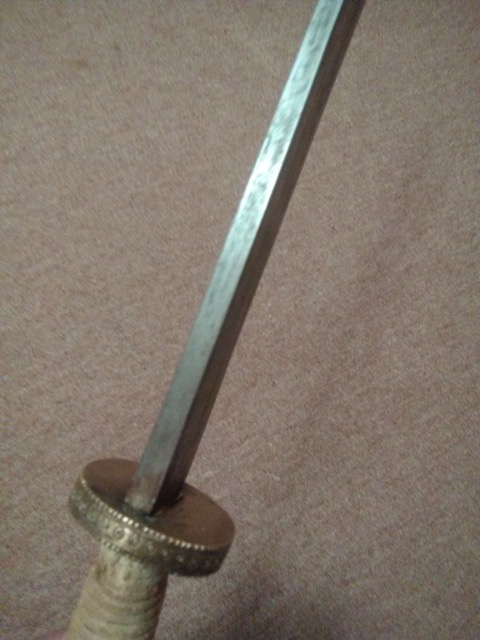

It looks like the hollow part of the guard is directed towards the pommel. Is this the case, or is it massive and just this thick?
As for the executioner's attribution, there are some photos made around 1900 that do show these in the hands of Vietnamese headsmen.
EDIT: I had originally attached pictures of three headsmen with such swords, but someone complained that his grandson was also browsing the forum and kids don't need to see it. I respect that.
But I believe that like in China, there was a degree of freedom as to what weapon would be used for this purpose. You also see Chinese executions performed with the dadao, even though it was not the weapon's main reason for existence either.
Some of these come in pairs with a smaller and a larger one, and I have also seen them with damage from other blades that indicate they were fighting weapons that sometimes were also used for executions.

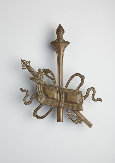

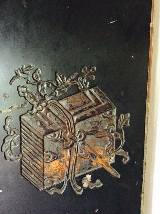

Thanks Peter! There is another symbol characteristic only for Vietnam - sword and bunch of books. Rarely, but it occurs as an inlay on the scabbard of ceremonial swords. This is a sign of a patriotic scientist.
Old 21st January 2020, 11:14 AM   #19
Peter Dekker
Peter Dekker's Avatar
Join Date: Mar 2008
Location: Kingdom of the Netherlands
Posts: 64
Ha, wonderful! I had seen the motif before but had not been able to find its meaning. Do you have a good reference on Vietnamese symbology?

In Russian there is a good book "The Magic World of Patterns. Encyclopedia of Ornamental Motifs of Southeast Asia" (edition of the State Museum of Oriental Art) and an excellent article by the famous ethnographer Y. V. Chesnov "The myth of the sword and the beginning of statehood in East Indochina." About the symbolism of creepers, pumpkin and grapes shoots , I took from there. My friend Vladimir Vetyukov (Ph.D., his dissertation is devoted to the Vietnamese military of the Late Lê era) told me about the symbol of the sword and a bunch of books.
Old 22nd January 2020, 08:10 AM   #21
Kubur
Kubur's Avatar
Posts: 2,145
Yes

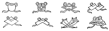

The Eight Precious Things often occur as decorative motives and sometimes individually as Chinese porcelain base marks. They are from top left; the Jewel or "pearl", the Cash coin, the Open Lozenge, the Pair of Books, the Solid Lozenge, the Musical Stone, the Pair of Horns and the Artemisia Leaf.
pair of books
Old 22nd January 2020, 10:19 PM   #22
Ren Ren
Ren Ren's Avatar
Join Date: Jun 2011
Location: Russia, Moscow
Posts: 379
Originally Posted by Kubur
Yes
pair of books
This is a very interesting and rare version of the "Eight treasures" ornament (in Chinese 八寶 Ba bao). I think it was popular in the Ming era.
In part, it coincides with the Buddhist ornament "Eight treasures of the perfect king Chakravartin".

Interesting set indeed. There are many sets of eight precious symbols in use, they seem to have standardized more towards the end of the Qing. The "Eight Buddhist Treasures" at least in Chinese art were somewhat more rigid in composition.
