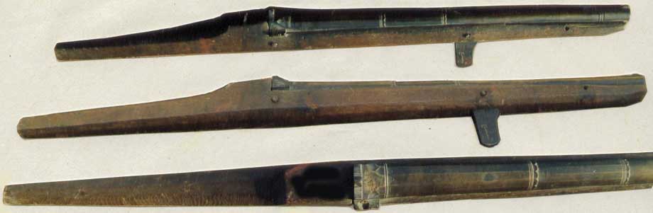

Default A unique bronze barrel wall gun (doppelter Doppelhaken), Nuremberg, ca. 1515-20

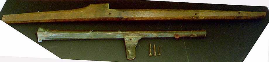

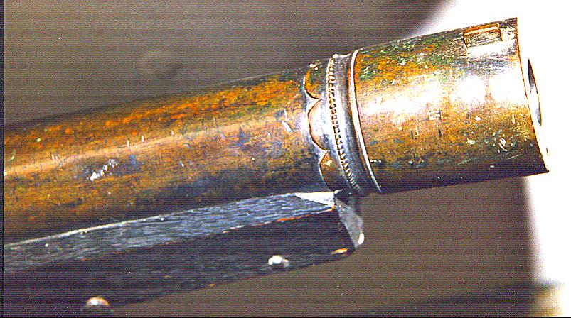

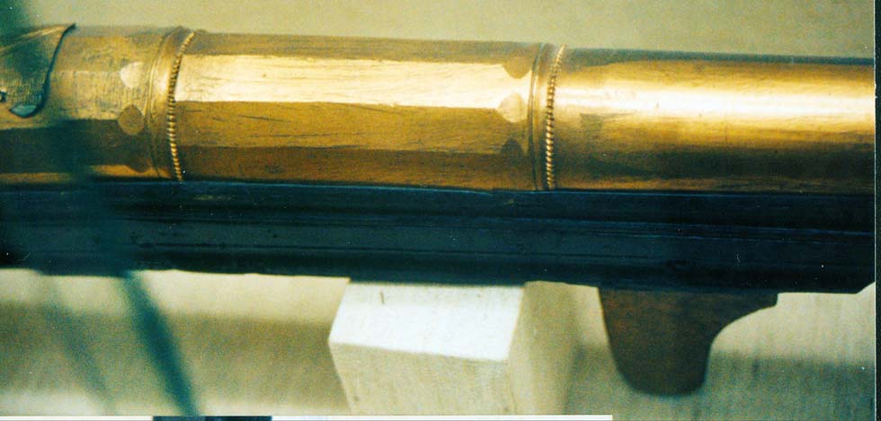

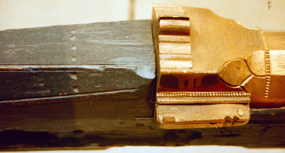

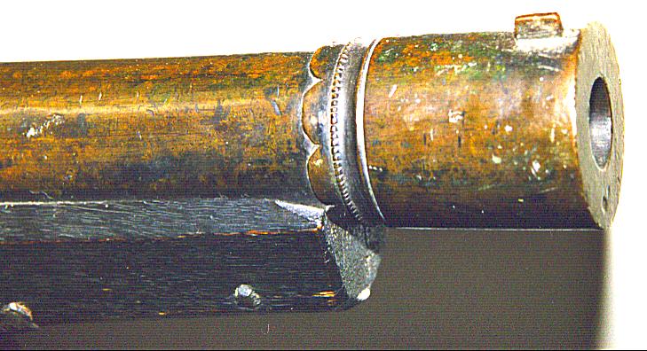

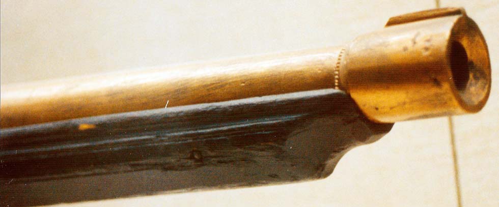

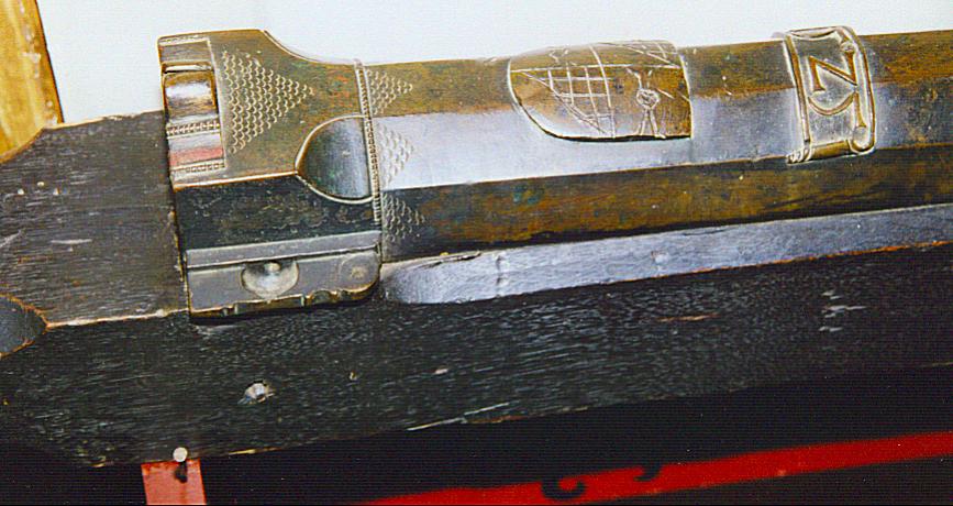

This has been with me for exactly 20 years. I have never seen such a fine sample retaining its original oak stock and patina in any museum. If ever, all you are likely to find are detached barrels or, at best, re-stocked in later times.
The term bronze for this sort of cast barrels has become widely accepted. In illumitated manuscripts of historic periods, however, they were called "brass" haquebut barrels (Messing Hakenpuchsen). As this, of course, depends on the actual part of the components, copper and pewter (bronze) or copper and zinc (brass), we should maybe just call them copper alloys. Metallurgical research has shown that 16th century copper alloy barrels often contain traces of silver.
There is no doubt about this barrel being cast at one of the famous Nuremberg workshops the finest of which, at that period of time, were those of Beham (Peheim) und Pegnitzer. Sadly this barrel does not bear a maker's mark.
Its early Renaissance bronze four stage barrel allows for a close dating to 1515-20. As only bronze barrels follow roughly this scheme of staging it shall be referred to at large here.
Starting at the rear section, we have a short square section (quadratisches Bodenstück) which bears the integral back sight and pan (its cover now missing) and is decorated with a scale pattern and a fir-cone scale frieze (Tannenzapfenschuppen-Fries). Next, divided by an incised double line and fish scales cast in high relief, there is a long twelve sided section (Hinterstück), followed by another, shorter twelve sided section (Mittelstück) which is shifted to the first and also divided from a long round section (Vorderstück) by two incised lines and a fish scale frieze. Divided by another fish scale frieze and two incised lines, a moulded band between, there is an elongated muzzle head (Mündungskopf) bearing a long integral fore sight. The rounded hook is cast to about the middle of the barrel and is incised with a primitive sign composed of various dashes and symbolizing a cypher: this, of course, is not a mark but an improvised form of a number still found in a similar manner, in markings on beer mats today.
This fine and important piece retains its original oak stock attached by three iron nails which enter through two barrel loops beneath the rear end and before the muzzle head respectively, the one in the middle entering through a piercing in the hook.
Its statistics are: overall length 207 cm, barrel 126 cm, cal. 26 mm, overall weight 35 kg, barrel 25 kg, stock 10 kg.
With these measurements it was actually a piece of light artillery, not a long gun.
It was mounted on a wooden tripod and two men were required to fire it: one for aiming the piece and, this done, the second for igniting it (Richt- und Feuerschütze).

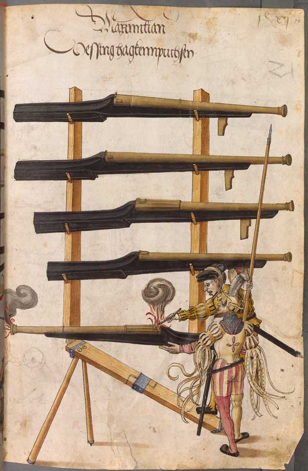

I attach two watercolor sources of illustration from the Maximilian arsenal inventories, early 16th century, showing a somewhat more archaic form of of the barrel. Note the headline in the first referring to the arms as "Maximilian Messing hagkenpuchsn" (brass barrel haquebuts). In the woodcut by Erhard Schön, Nuremberg, ca. 1530, the same primitive way of imitating cyphers is depicted on a slate board in a saloon scene.

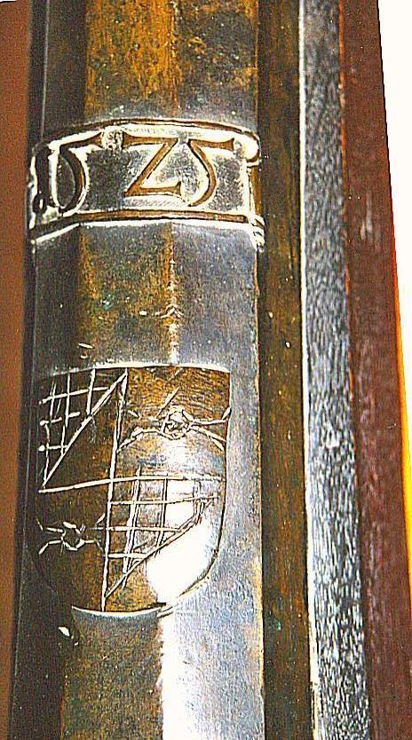

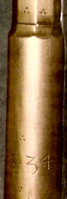

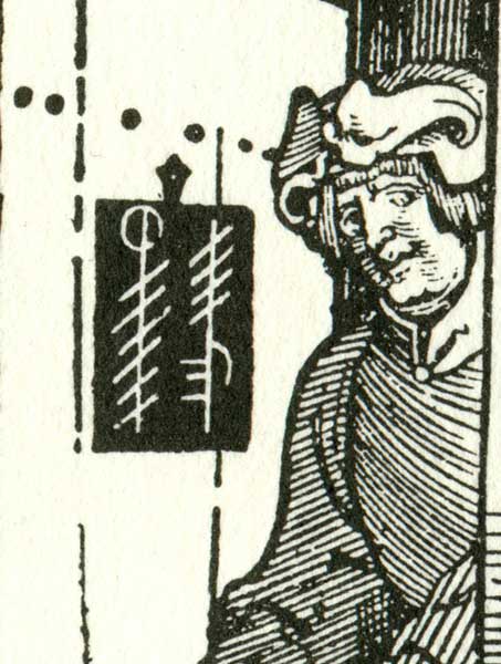

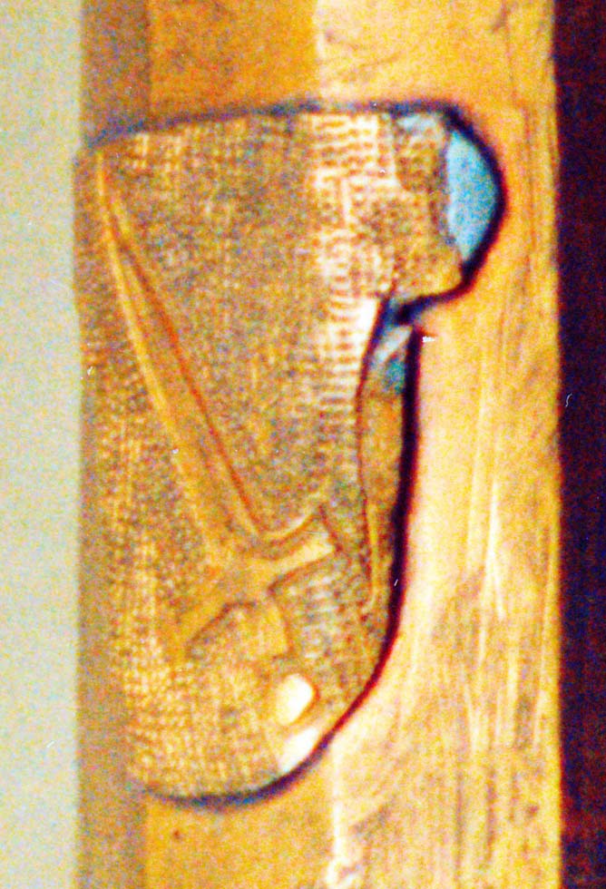

A detail of the stylized cyphers on the slate board, ca. 1530, which compare to the numbering present on the hook of my Doppelhaken.
m

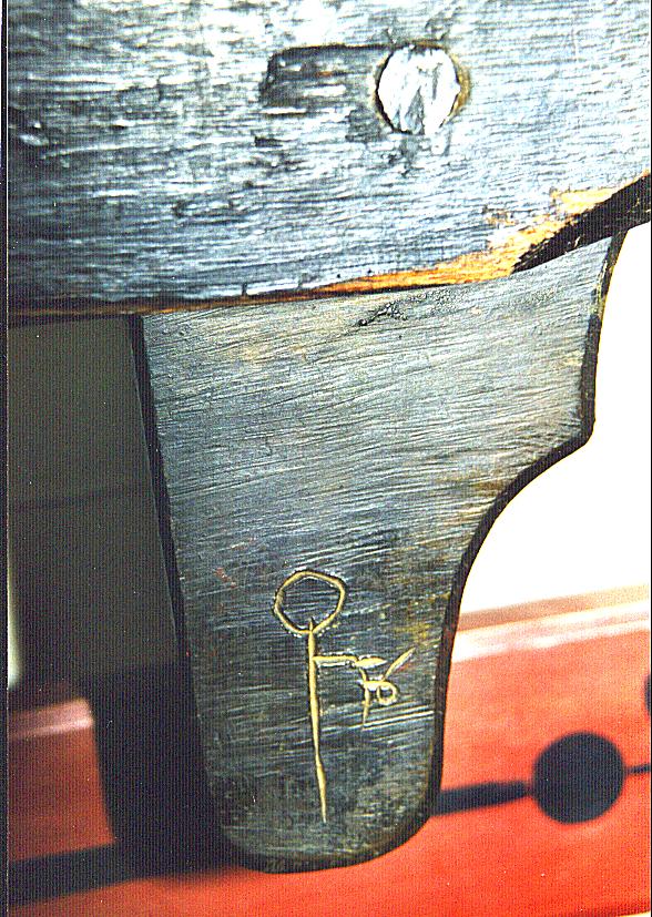

Old 17th January 2009, 07:21 PM   #3
Matchlock
Join Date: Sep 2008
Location: Bavaria, Germany, the center of 15th and 16th century gunmaking
Posts: 3,125

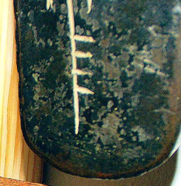

Detail of the numbering on the hook.

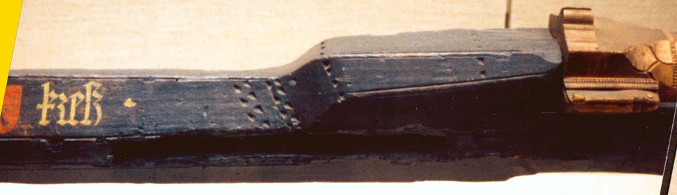

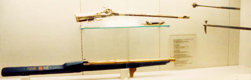

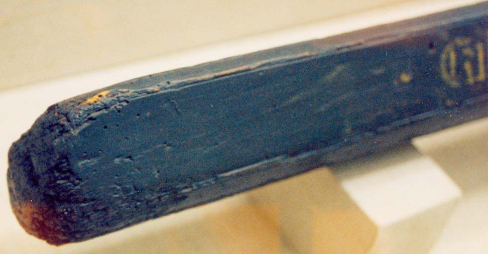

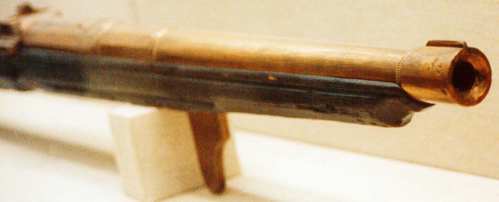

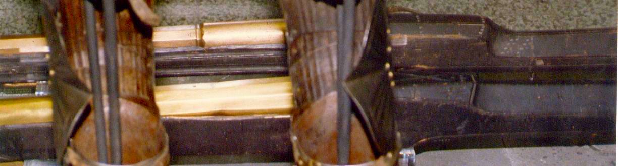

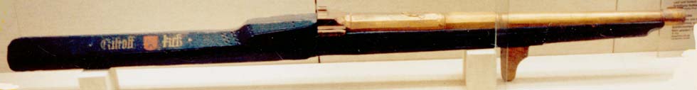

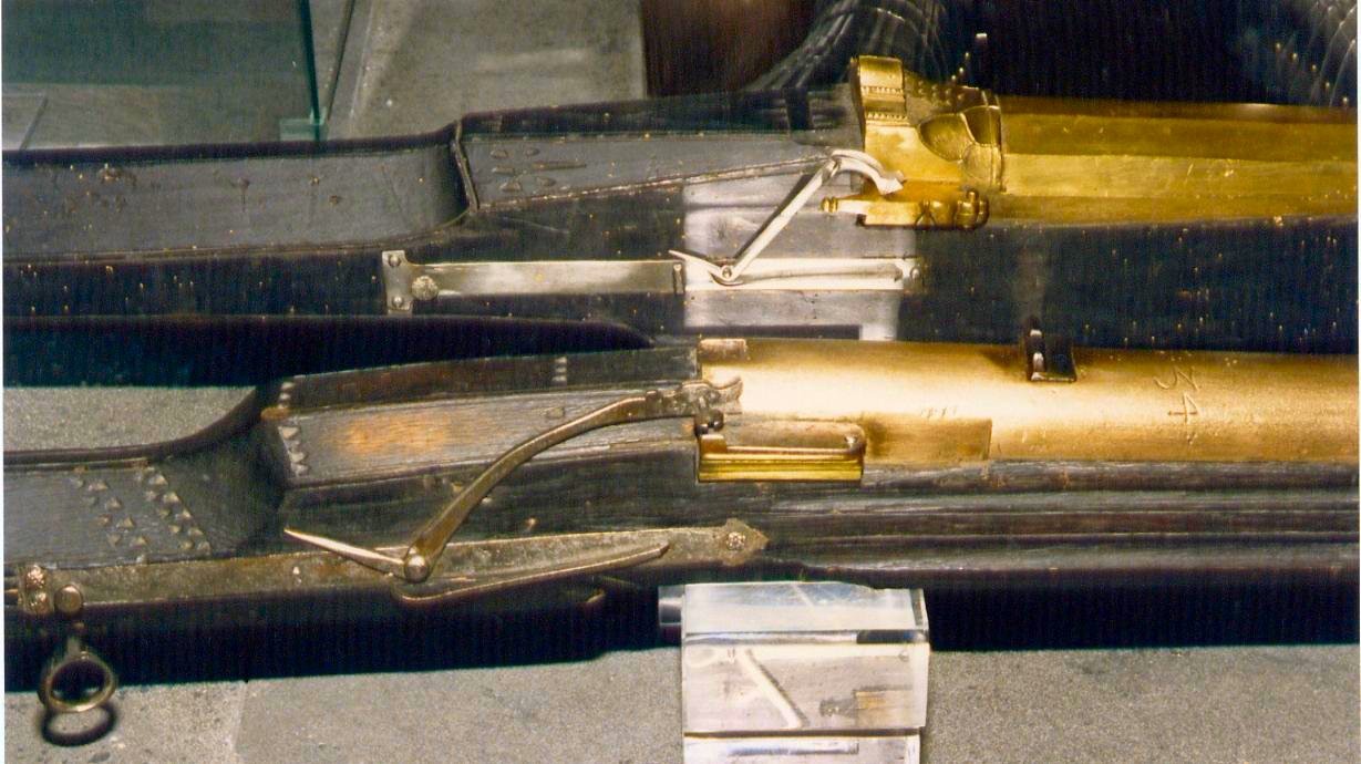

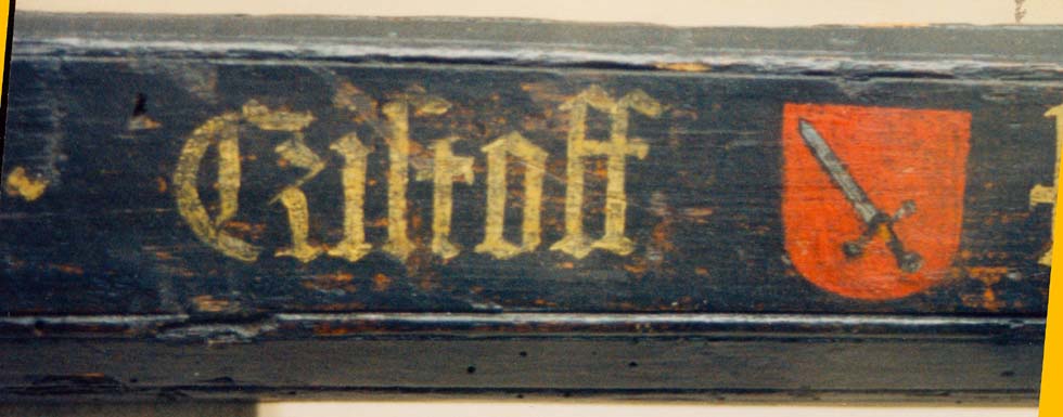

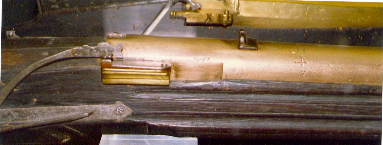

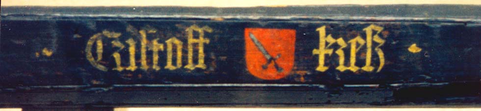

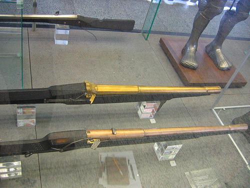

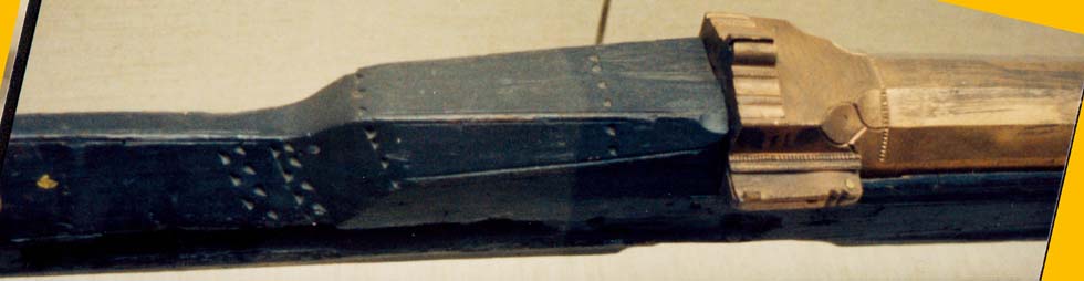

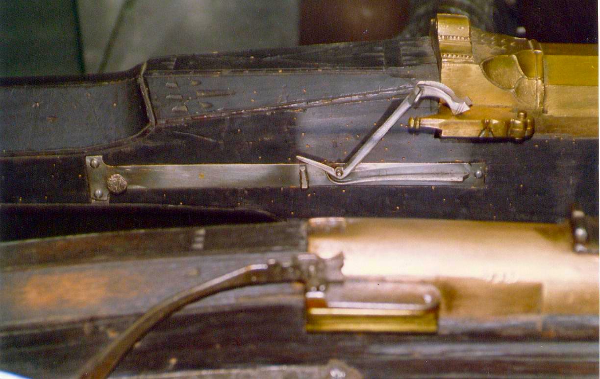

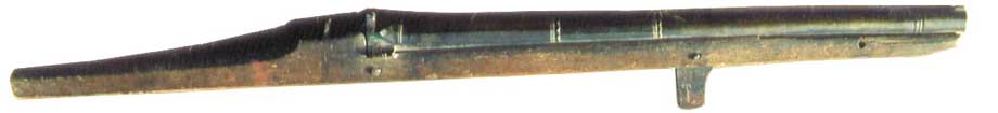

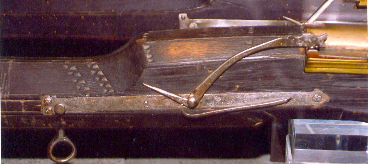

Default Another Very Similar Piece, ca. 1523, at the Germanic National Museum Nuremberg

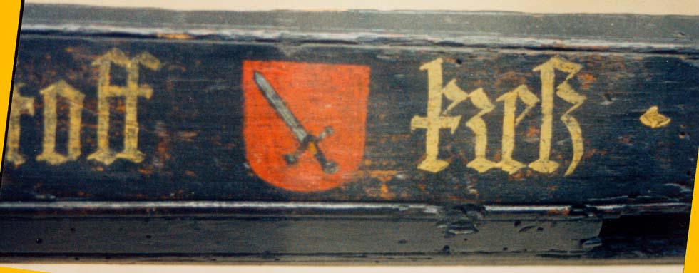

The original snap tinder lock is now missing but there is little doubt that it must have looked a lot like the earliest detached lock in my collection, which you will find pics of below.
The blackened oak full stock is painted with the coat of arms, a sword, and the full name of the Nuremberg war captain Cristoff Kress von Kressenstein, who was given this heavy wall gun by the Nuremberg elders for supporting their campaign against the Franconian robbar baron Thomas von Absberg in 1523. The Kressenstein coat of arms is repeated cast and chiseled in high relief on top of the copper alloy barrel.
Michael

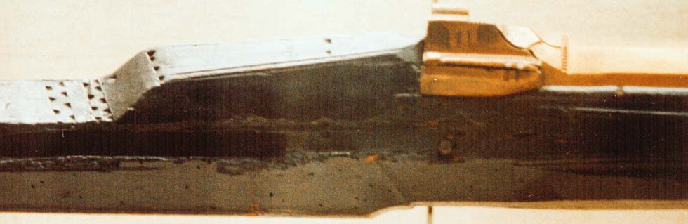

Old 14th October 2009, 03:48 PM   #5
Matchlock
Join Date: Sep 2008
Posts: 3,125
The rest.

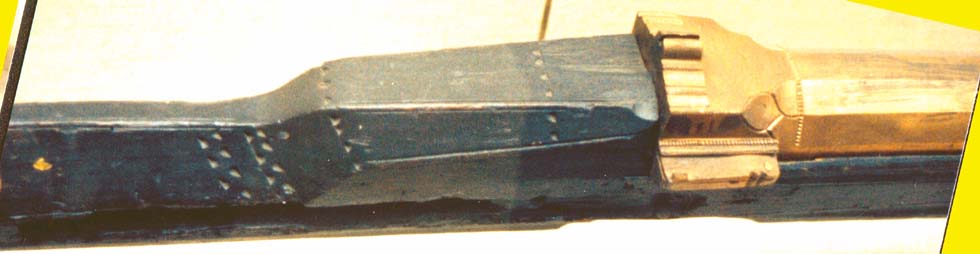

Old 14th October 2009, 04:04 PM   #6
Matchlock
Join Date: Sep 2008
Posts: 3,125

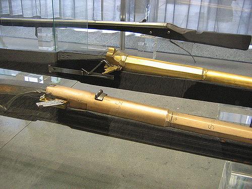

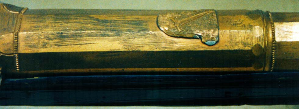

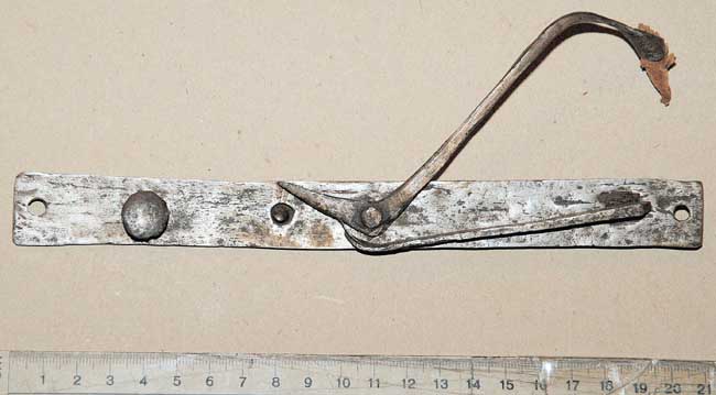

Default Another, Dated 1525, at the Castle of the Prince of Hohenlohe-Langenburg, Franconia
Hohenlohe-Langeburg is the very castle the wall gun in my collection came from. The one presented here today is very similar to mine, except for the somewhat longer muzzle section whose time of origin is documented and backed up by the date 1525 on the barrel, together with the Hohenlohe coat of arms.
Please note that the wall hook is incised with another example of a primitive numbering symbol, very similar to that on the hook of my piece.
Michael

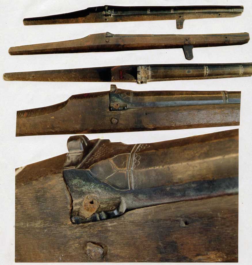

Hi John,
It has been so good to finally meet a third fellowman interested in the same stuff!

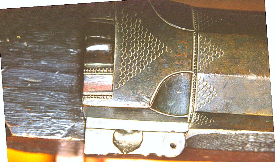

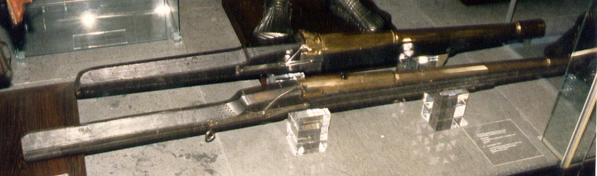

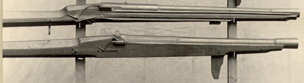

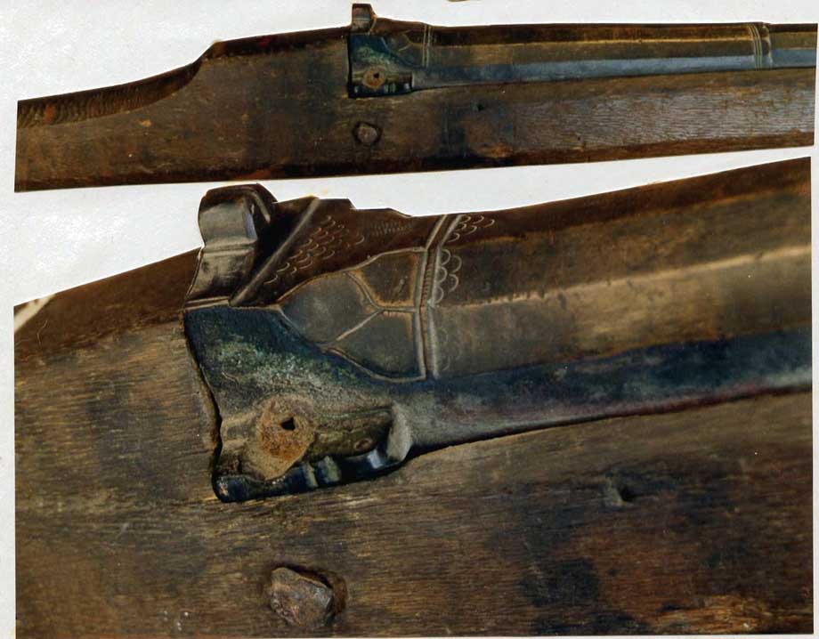

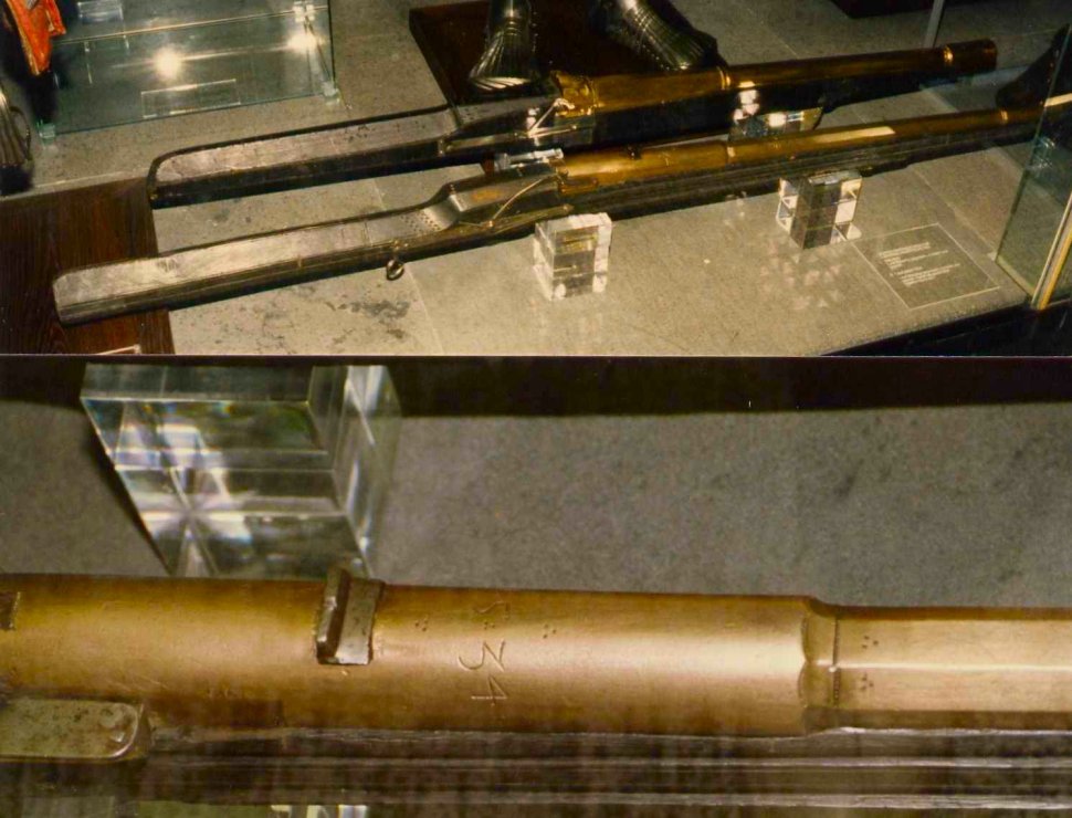

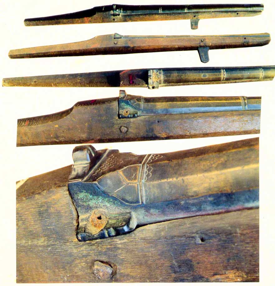

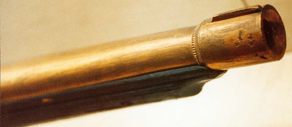

The haquebut you referred to, illustrated by a line drawing in Essenwein's basic work, is still preserved and on display in the Germanisches Nationalmuseum Nürnberg.
I'm attaching the pictures I have taken over two decades, plus a b/w photo taken by the museum about 100 years ago.
The piece is about 1.60 m long overall, the barrel length being ca. 1 m. The snap tinder-lock nailed to the stock at the right hand side of the breech may be contemporary. The stock is oak, painted black. The complete piece might weigh about 20 kg (German: doppelter Doppelhaken) and can be dated closely to ca. 1515-20. It was doubtlessly cast and stocked in Nuremberg.
The second piece on the images is dated 1534 on the bronze barrel, the present backsight being a Thirty Years War alteration (the original integral backsight at the base of the barrel removed).
In order to judge your haquebut, as well as the inscription, I would need to see overall images and close-ups.
Michael

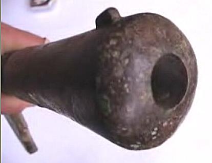

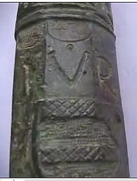

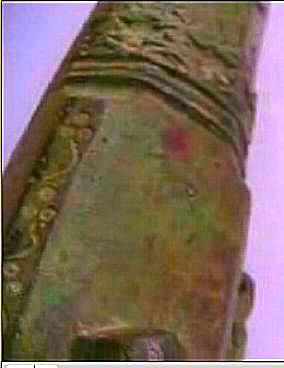

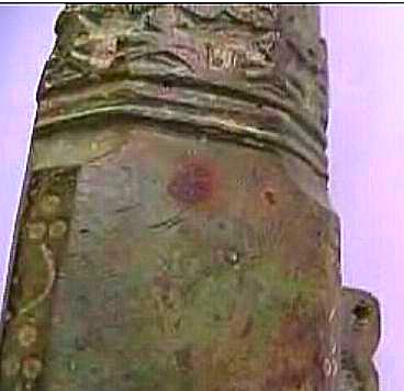

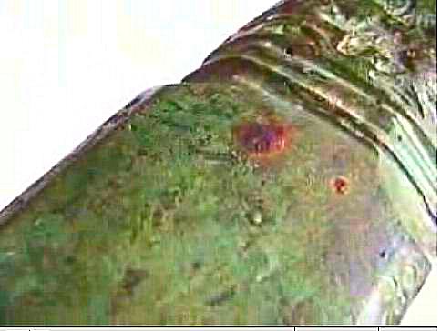

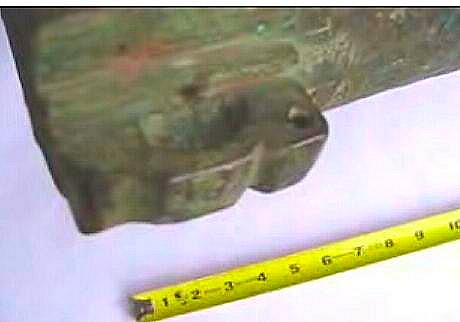

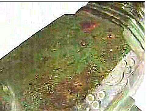

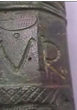

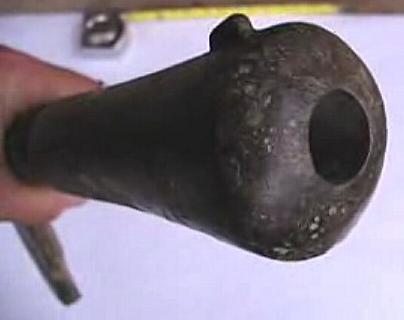

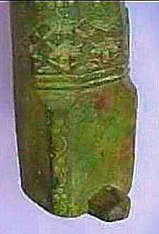

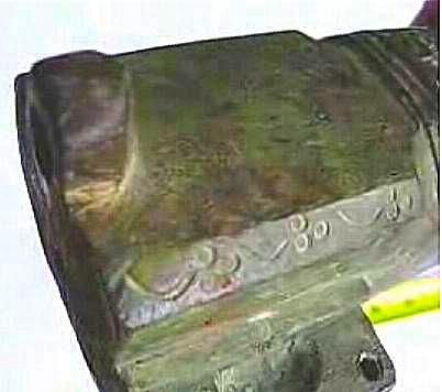

Default Thanks, and slideshow of the von Schellenberg hackbut

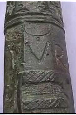

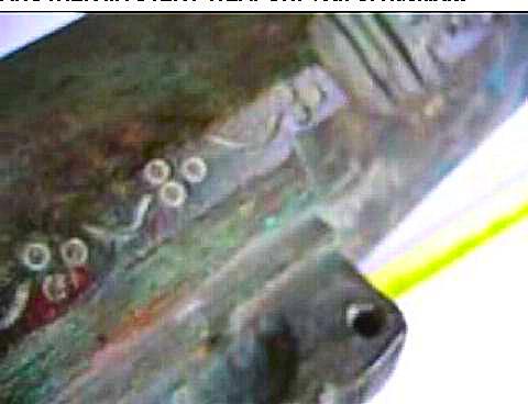

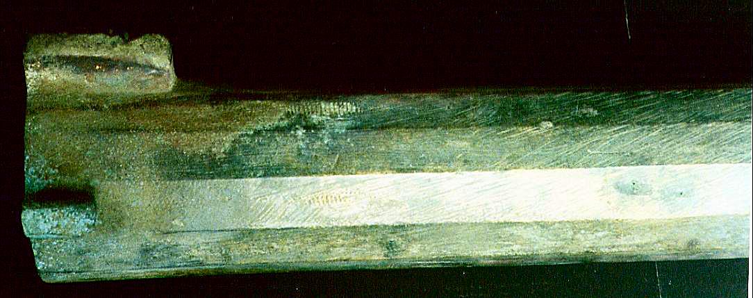

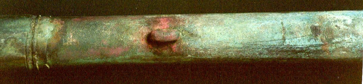

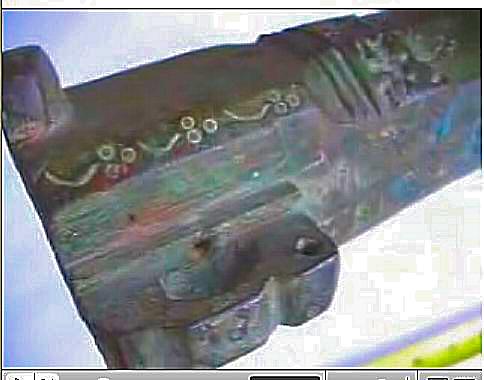

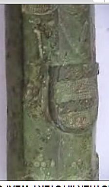

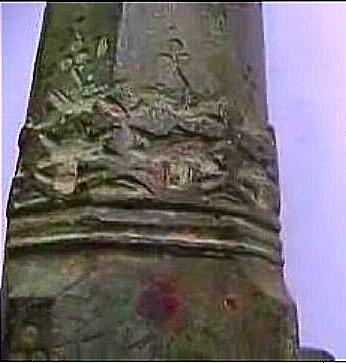

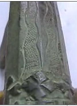

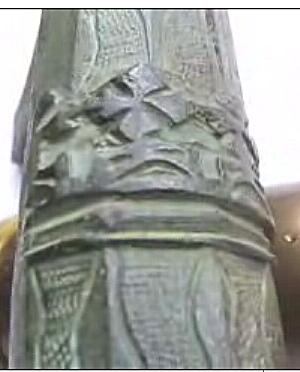

Michael, thanks so much for the photos, that's a lot easier for me than having to deal with the museum.
I have this little slideshow of the hackbut, and if this is not adequate I will sit down and try to figure out how to post photos individually on this forum; of course I have separate url's for each one.

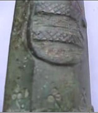

This hackbut was ordered by Ulrich von Schellenberg; you must be familiar with him because you like the Katzbalger, and Ulrich's sword in the KHM is one one of the finest I can imagine. I have a photo of it if anyone needs it but I have a feeling you all know that one.

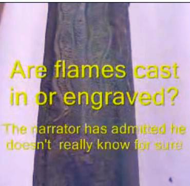

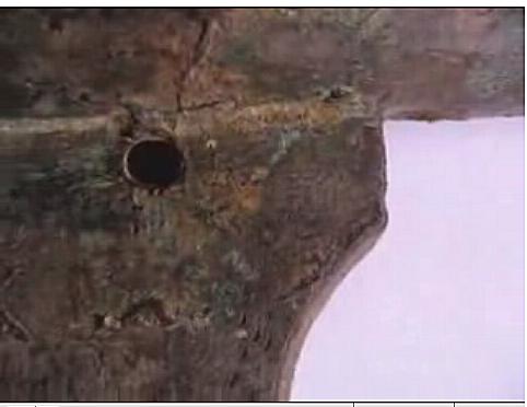

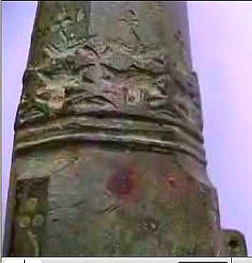

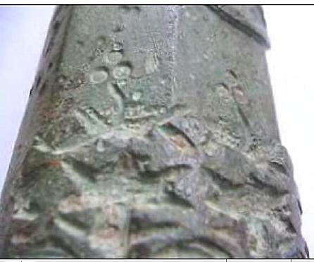

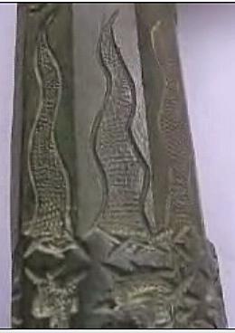

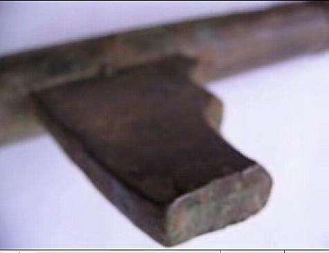

The barrel is all I have, it weighs 36 lbs, is 36.75 inches long, and the bore measures 20.3mm, or 0.8 inches.

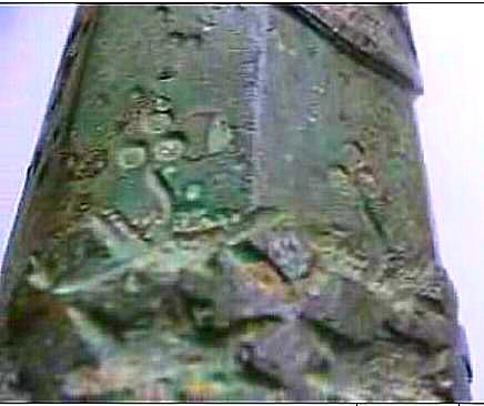

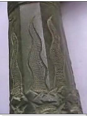

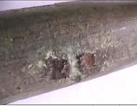

The barrel is bronze with a few iron inclusions including the chaplets for the core and one iron ring underneath (broken off.)
Decorations include flames, trefoils, and other unknown geometric shapes in patterns or rings around the barrel. The coat of arms is that of von Schellenberg.

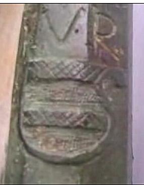

Above the coat of arms are the letters which at first appear to be "I V R" but I am told by historians should be read as "J U R." I have thought of several possibilities for these letters but have not arrived on one that is foolproof yet.
Here's the slideshow, just mouse over the grid to see the photos.
There are several photos of a small round mark which appears to be struck, on the flash pan, and I thought it might be some kind of proof mark or maker's mark, but it is very indistinct, some simple figure, perhaps a bird in flight, in a circle?
Any insight you can give on this is most welcome.

Hi John,
I would have been much disappointed by myself, had I not recognized your barrel (remember it's not a complete haquebut) at first sight though the images on photobucket are tiny.
For all who wish to learn more on that item and its coat-of-arms, I post all the (unfortunately very small) images originally posted by the Springfield Arsenal because they were searching for information. I have to admit that was astonished to see the term of a the Late Gothic ornament quatrefoil misspelled as quatrafoil by a musem staff member ...
Your barrel with its unusually fine and profusely rich chiseled Early Renaissance decoration can be dated to ca. 1525-35. The originally swiveling bronze pan cover is now missing, just as on my Doppelhaken.
In order to be able and tell you more I would definitely need good-resolution images of the whole piece, as well as of all the details you questioned.
As a Medieval and Renaissance arms historian I can affirm the information given to you on how to interpret the three initials on your barrel. I am quite sure though they mark some later kind of arsenal inventory signature, and not that of the original owner.
In any case, this is a very fine - apart from obviously being preserved in excavated or salvaged condition - and espacially historically high-ranking item in early firearms history, so congratulations!
Do you have other similar items to match? I posted many items and overviews from my highly specialized collection here over the years, just see my threads.
Michael

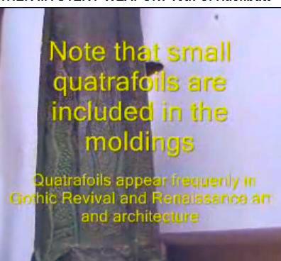

Michael, I should clear up the misspelling:
The video that came from was produced and directed by me, my company is Springfield Arsenal LLC. Perhaps you were thinking of the US National Park facility in Springfield, MA, known as "Springfield Arsenal," an historic site. We have nothing to do with that, we are a small company dealing in military relics, with a sizeable collection of artillery and odd items on the side.
Of course now you must recognize that the misspelling was inserted on purpose to attract the attention of, and elicit comments from highly educated and knowledgeable persons such as yourself!
I will make it a point to make larger images of the hackbut barrel available, forgive me but I will probably continue to use the term hackbut out of habit even though it is obviously a barrel.
I have asked some local experts in Altdeutsch here in the US to assist with a competent translation of about a paragraph of material on Ulrich von Schellenberg, from the online version of the ADB. The text is in what I'm told is "very old German." Google translate cannot make sense out of much of it. I had years of German in school but that was centuries ago, or so it seems, and most of it is gone, and I cannot make sense regarding who is doing what to whom in some cases. Friends who are native German-speakers cannot read it. There may also be some errors in it, or it could simply be my mis-reading. One portion of it mentions "when Ulrich was just beginning his military career in 1501.." That does not make sense to me because since he was born in 1487, he would have been only 14 years of age in 1501, at which time I suspect he had not yet left home to attend law school in Italy.
We have two other odd early weapons and will certainly undertake discussion of those here after we get the basic information on this hackbut digested.

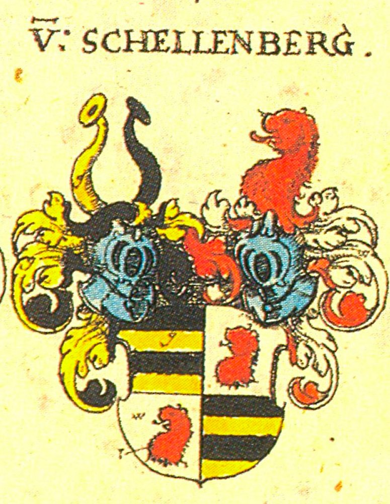

Here are the coats-of-arms of the von-Schellenberg family,
a) 16th c., Kissleg, Allgäu, Southwest Bavaria, and
b) their device of 1609 (after Siebmacher).

You are correct. Those bars and colors of the basic "blazon" are always present. The shield shape changed over time with the general practice of the heralds.
The following well-known book shows an earlier shield type that matches the shield shape on the hackbut. The book states that this earlier shape which I call the "coffee cup" was used only from 1470-1525, as I recall on page 72 or nearby.

Default New Info
I've found a more extensive biography on Ulrich von Schellenberg, here:
http://springfieldarsenal.files.wor...oes-excerpt.pdf
Unfortunately it is in German script so I can't transfer it to Google translate for the usual quick-and-dirty translation. I wonder if there are any free German script OCR programs out there so I could at least turn it into characters to enter an automatic translator? I can transliterate German script into more useful font, but takes more time than I have.
I'm not going to bother Michael about this one, he's already spent enough time translating this stuff.
I've also thought more about the "JUR" marking on the gun. I still believe it will be impossible to determine, with certainty, what that stands for, however it is almost certainly from a later period than the "1525" estimated date of manufacture, as Michael has said. One reason we know that is because the letters were crowded into a nice open space intentionally left above the coat-of-arms so the c.o.a. would be reasonably centered in an open (plain undecorated) area. I think the letters indicate a subsequent owner, after Ulrich had left the battle zone of northern Italy ca. 1529. It is possible that it was captured at some point, or more likely simply retained by whatever Swiss mercenary was using it, probably with Ulrich's consent. Or perhaps it remained under control of Ulrich's commander, General Ramon de Cardona. Who knows.
