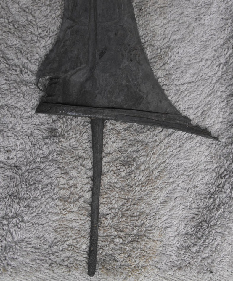

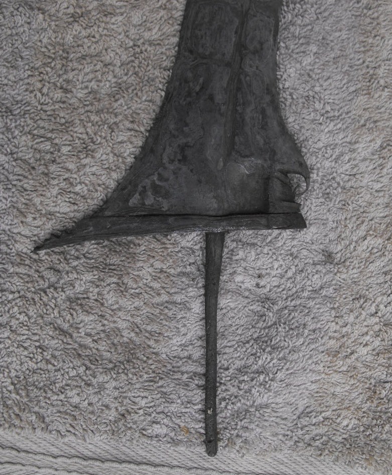

Default Wilah nr2 hope you can help with identification
This blade is about 35 cm without pesi, when i bought this one they told it was from East Java/Madura, but i don't know if that is true.
Harley is offline   Reply With Quote

Yes, it possibly is East Jawa, I don't think Madura, very unlikely to be Central Jawa.
Not much of a blade, and nothing I can see to allow me to take a punt at giving it a classification.

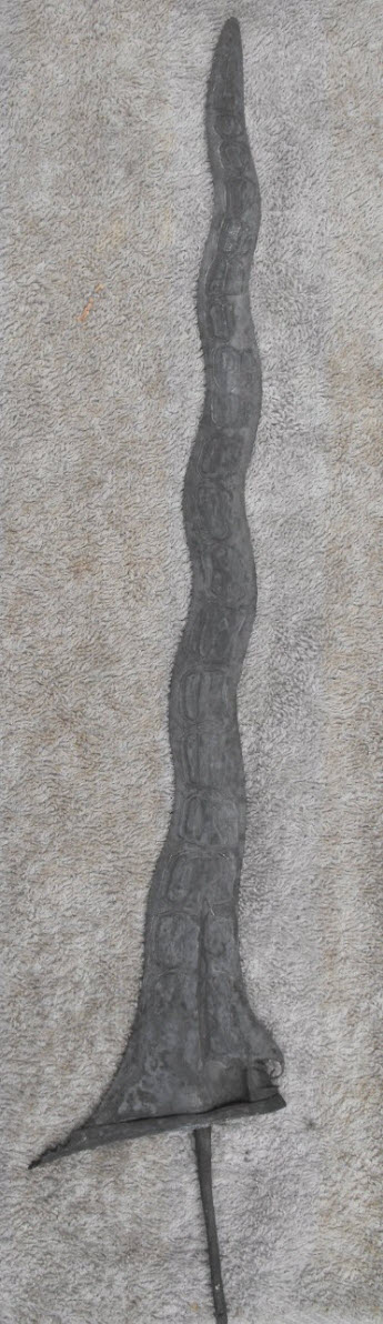

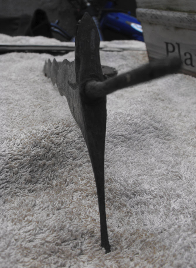

Thank you Alan, i shall place the third wilah here, because i think that it is a sort of the same as this one.
And i hope that this time i do it in the right way, but you have to scroll
regards,
Ben

Harley, this blade is vastly better than the previous one.
I am uncertain as to a classification, but I think possibly north coast, towards the west. Stained properly this blade would come up nicely. Not a bad blade at all.

Hullo everybody,
Harley, your blades that I have seen seem to come from the Cirebon/Tegal area. If all of them are similar, you must have had a field day buying them up.
BTW ..... if they are indeed from this area, then I would call them 'Sunda', especially if they are longer than 'normal' (i.e. more akin to the larger Balinese blades). The Sunda traditionally prefer their blades to be 'dry' looking. Hence they don't stain them.
Blades tend to be simple and not 'proud'/intimidating.
WRT to dapur, that's more difficult.
Cirebon has had the longest exposure to Jawa influence. So the blades tend to follow the prevailing pakem Jawa. Though there are still those who adhere to the old pakem. However, I have noticed blades which seem to be some form of 'marriage' between the two. Confusion? Or merely commercial opportunism?

That is a nice surprise!
Thank you again Alan, you're of the greatest help to me.
Hello Amuk Murugul,
To my untrained eyes they where similar, but it says more about me then about the wilah's i 'm afraid
I don't think they are longer as usual, this one is 35,5 cm(I forgot to mention).
I can Imagen that it's so difficult to tell something about the blades and even more when there is some kind of marriage between to different styles.
Thank you very much for your contribution!

Amuk, I cannot disagree that the second blade that has been posted may be able to be classified as Cirebon, however, in the system of classification that I was taught, Cirebon is not recognized as a classification.
The relevant classification that includes Cirebon is Pajajaran, and Pajajaran is sub-divided into at least three sub classifications, which are numbered, not named.
However, I am very reluctant to identify this second blade as Pajajaran, because although there are some indicators which point to Pajajaran, for instance, the bata rubuh blumbangan, there are too many conflicting indicators, and as the blade is out of stain it is impossible to appraise the nature of the pamor, which is a key indicator for Pajajaran keris.
Still, it may be able to be tagged as Cirebon. Regrettably I have never encountered a list of indicators for a Cirebon classification, either within the system that I was taught, nor anywhere else.
The first blade posted is quite dissimilar to the second blade. My inclination is to place it as East Jawa, but the quality of the blade is really too low to permit any sort of realistic attempt at classification, and from the photos I cannot even guess what the material might be like. In fact, it could be from anywhere, so if you feel inclined to place it in West Jawa, or Sunda, I will respect your opinion, but in the absence of indicators it is difficult for me to understand how you came to that opinion.
