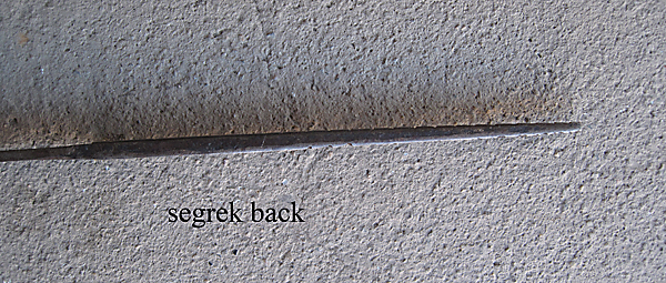

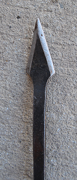

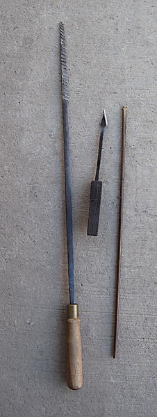

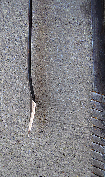

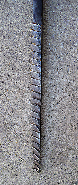

Here's pics of the tools to work inside a wrongko.
The segrek cuts on the draw stroke, I forged this one out of a car coil spring.
The knife is designed to get inside the top of the wrongko, I forged this from an old chisel.

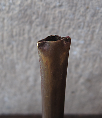

The copper tube is pinched together at the end to increase [pressure of air blown through it

Impressive tools!!! I get the rough idea. For a brief couple of seconds I forgot we were discussing about keris, these images remind me of torture devices in some movies
Anyway, you blow air into the wrongko using the copper tube? So basically the idea is to remove the dirty portions of the wood by chipping it off minimally, then blow air to clean the bits away?

Posts: 7,254
Yes, that's about it.
However, to just clean the inside I use rifle cleaning rods and brushes, as I have already advised.
The segrek is used to make a gandar, you only need to use it on a finished gandar if the inside is contaminated in some way and you need to cut away more wood.
