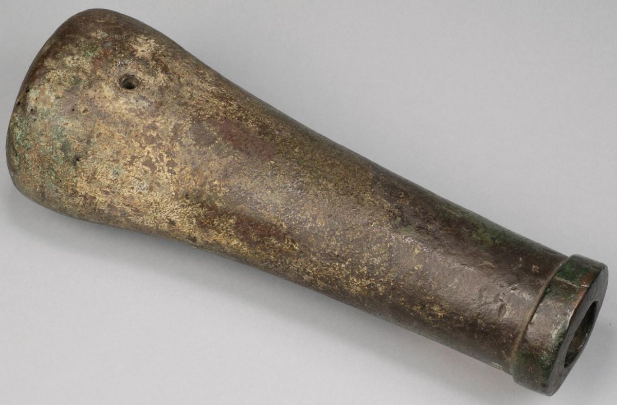

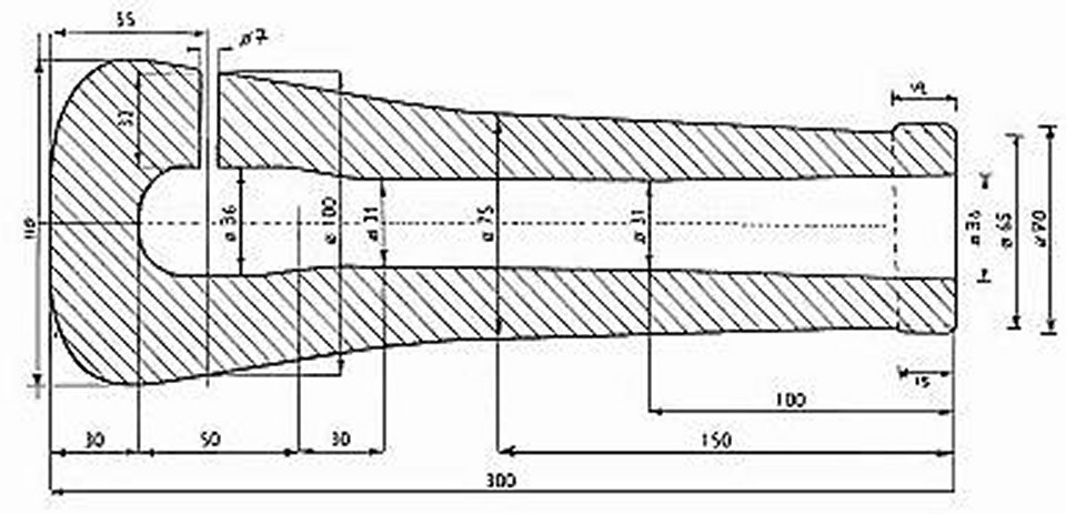

A cast-bronze vase-shaped gun barrel very close to those pictured by de Milemete has become famous as the world's oldest known gun, the so-called Loshult gun, and is now preserved in the Statens Historiska Museet Stockholm, inv.-no. 2891 (attachments).
It is generally dated ca. 1330-50 and measures 31 cm overall, at a weight of 9.050 kilograms; the bore at the muzzle is 36 mm narrowing down to 31 mm on its way to the rear, which seems ideal for firing arrows featuring a cord binding for a tight fit in the muzzle, to minimize gas loss.

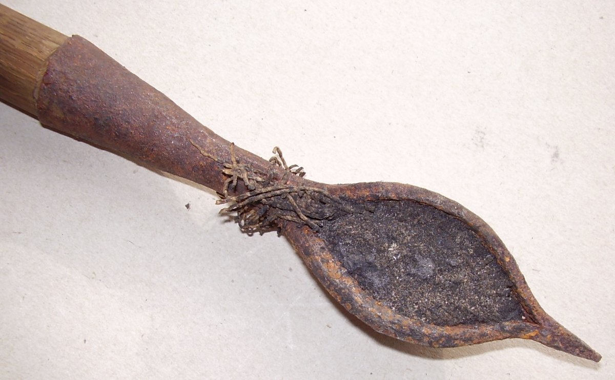

For a couple of years, one of two sensational extremely fine and authentic specimens of an earliest type of incendiary gun arrow has been in the author's collection: the pointed head constructed of four clasps retaining much of its original incendiary mass wrapped in raw linen, the matchcord probably originally attached now missing. The oaken haft retains two thin iron flights (damaged), much of a fragile cord binding in the rear section, probably of hemp, and an iron reinforcing plate pinned to the bottom.

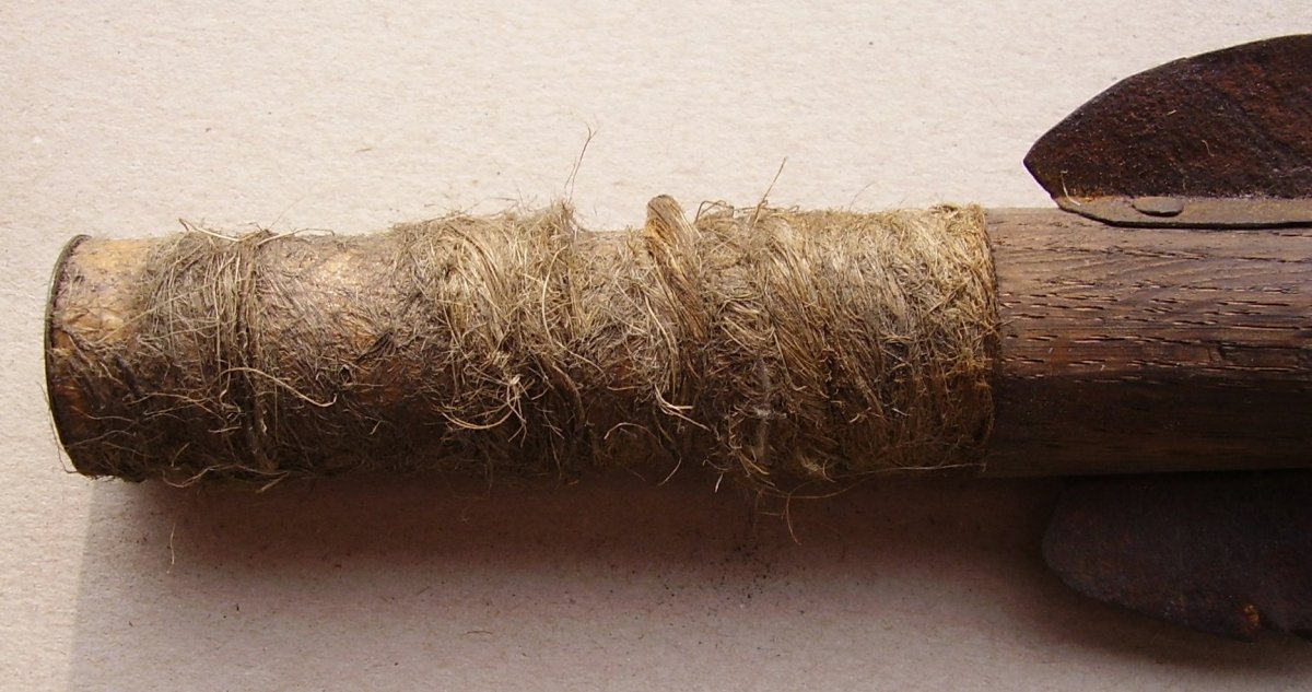

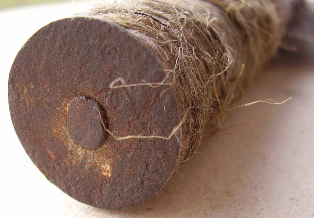

This incendiary gun arrow closely corresponds to those illustrated by de Milemete in 1326-7, and the construction of its haft, flights and reinforcing iron bottom plate is consistent with the few other remaining gun arrows which, however, are of later type.
The incendiary mass seems to be largely the same used in contemporary quoits and incendiary arrows for crossbows:
http://www.vikingsword.com/vb/showt...cendiary+arrows
What is remarkable is the fact that the socket of this arrow head is not attached by a nail but just put on the pointed haft, as is the case with crossbow bolts! When the wood was still fresh this certainly provided a tight fit but as the wood has shrunken it is loose now, just like on most crossbow quarrels (see attachments).

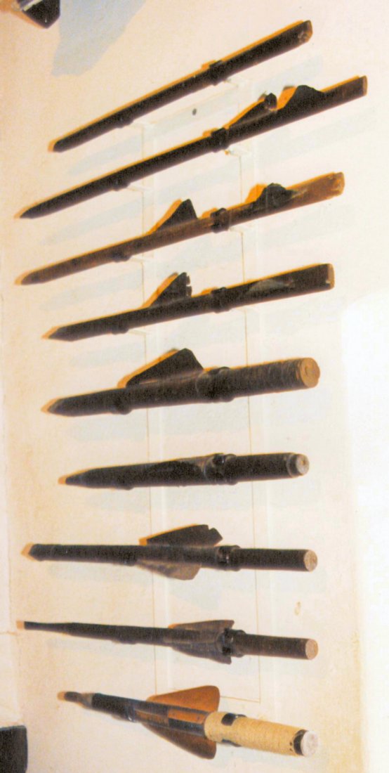

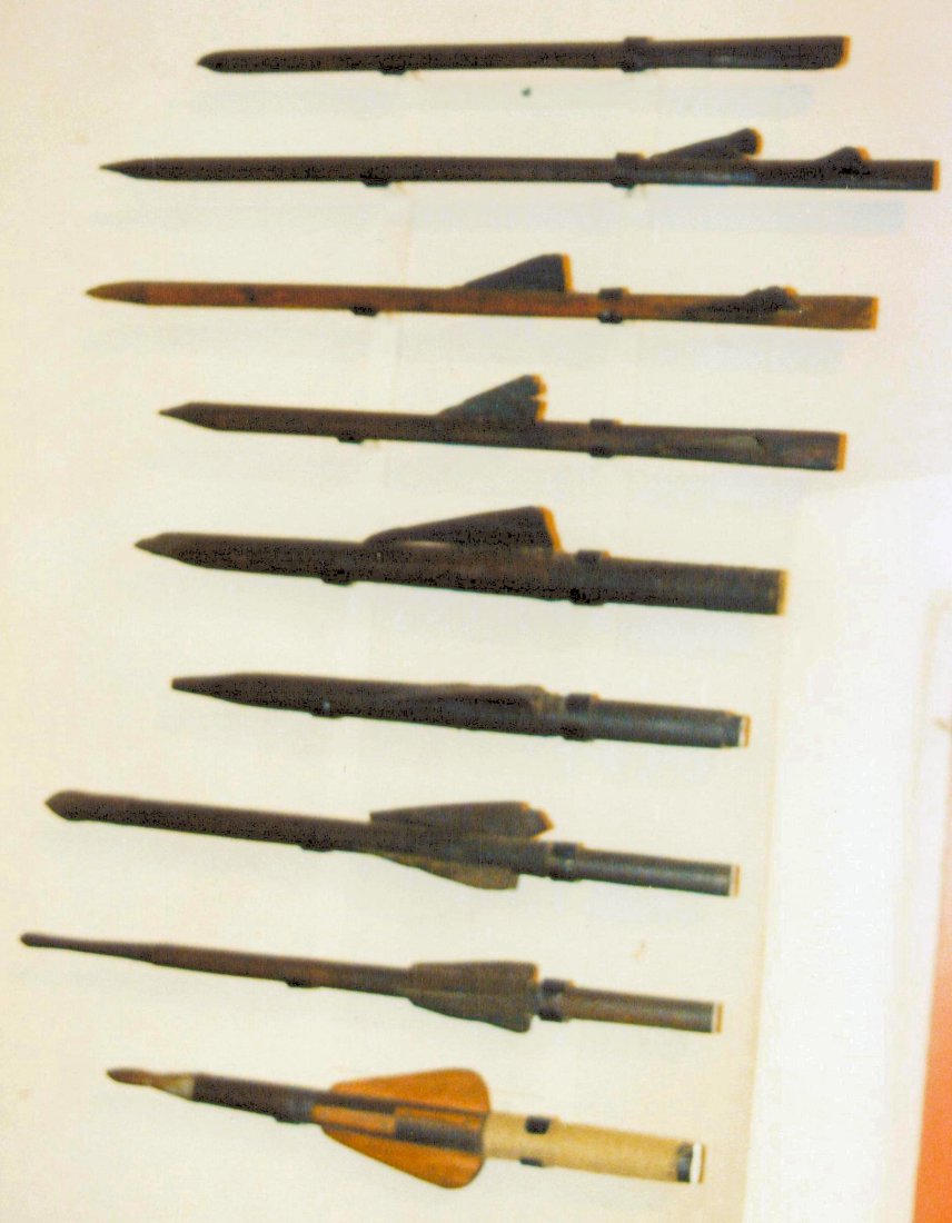

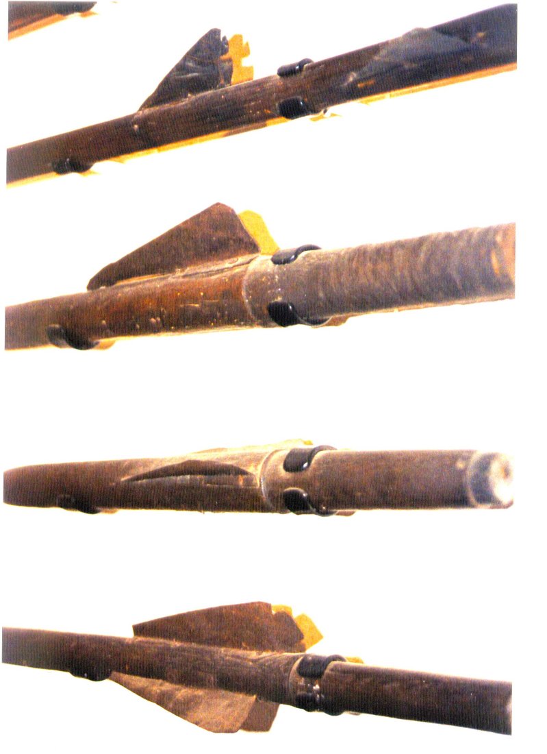

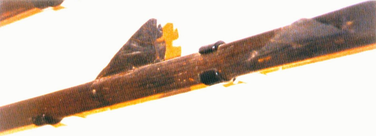

On July 3rd, 1987, the author attended the collections at Burg Eltz by special appointment, and still holds a written document to prove that he was the first to actually identify eight original gun arrows preserved there (following attachments).
Some of their heads are missing but all remaining heads are of the characteristically stout, pointed, metal piercing shape known from crossbow bolts but not recorded for gun arrows prior to ca. 1400. Most Eltz specimens retain their original hemp binding, their iron flights and pinned iron reinforcing bottom plate.
Three of the Eltz gun arrows are interestingly equiped with three iron flights each: two arranged the usual way, and the third placed in shifted position behind them.
The usual number of flights seems to have been two, just like on conventional arrows and crossbow bolts.
The one displayed at the bottom, on the photos showing the group of nine, is a modern reproduction (attachments: all author's photos of July 3rd, 1987, still showing the old display arrangement).
These gun arrows, their provenance still being unsettled, have been tentatively attributed to a historic feud taking place at Eltz Castle in 1331-2. At least one of them was claimed to have been an excavated find from castle ruins. This statement has meanwhile been disclaimed and should be seriously doubted, regarding the fact that all of these arrows are preserved in identical condition, and that organic material such as hemp would have hardly stood hundreds of years of burial. The author, on the grounds pointed out above, doubts the early dating and is convinced that they should be correctly dated 'late 14th to early 15th c.', on the grounds of the illustrative sources presented.
No earlier date can be proven for them but the sources quoted by the author suggest a date of ca. 1400 by the earliest.

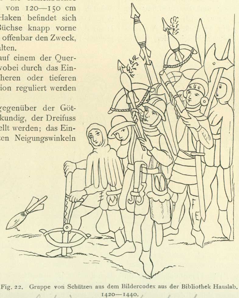

P.S. As is often the case with my computer, b/w jpg attachments of line drawings do not show up on the forum.
In case you cannot open the two line drawings of ca. 1410-30 and ca. 1440 respectively via the links given at bottom, they can be seen in Tittmann's essay - please see link provided above!

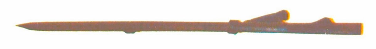

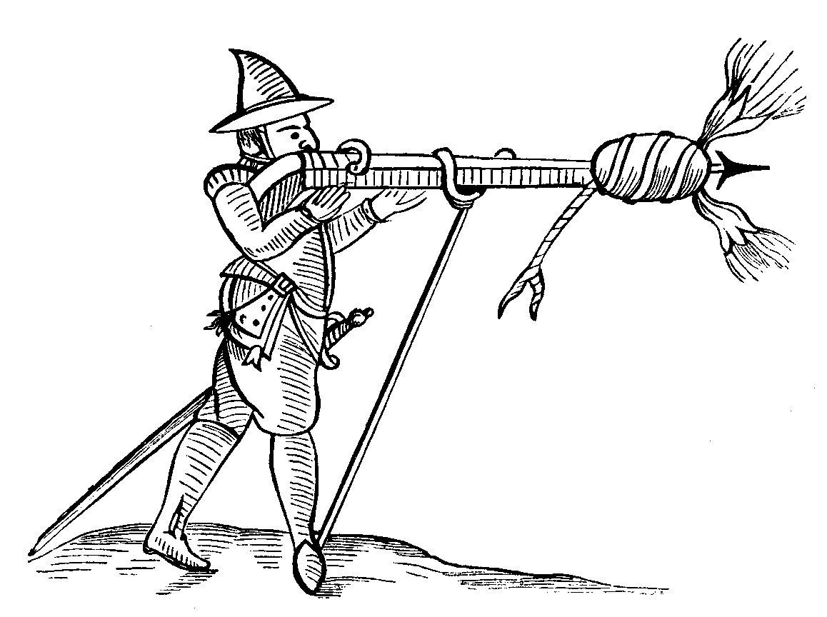

The latest known depiction of an (incendiary) gun arrow: a Spanish musketeer, ca. 1570.

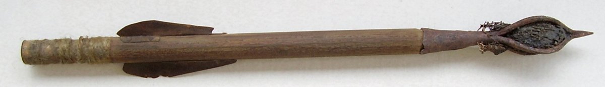

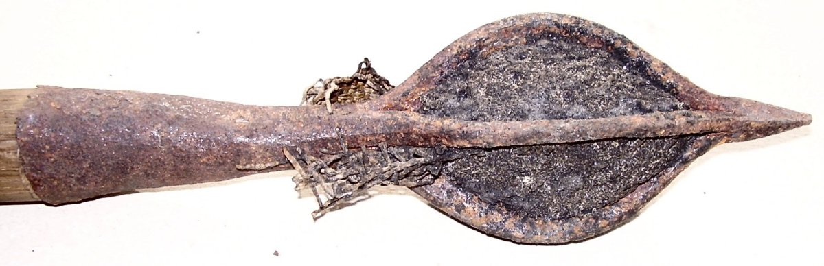

The only known surviving specimen of an incendiary gun arrow, probably ca. 1330-50, in the author's collection.

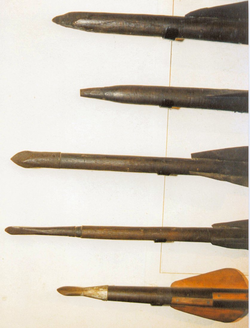

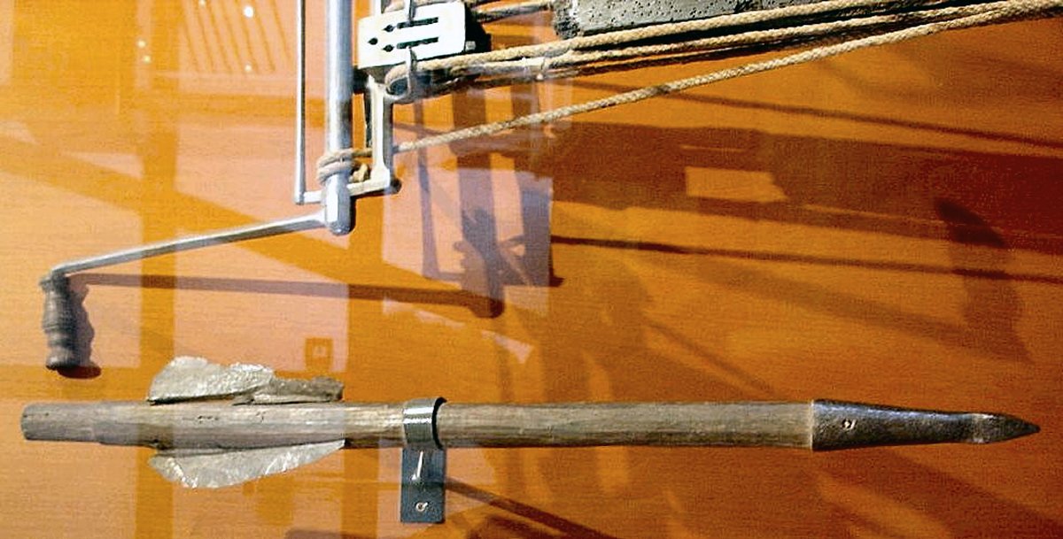

Eight original gun arrows of ca. late 14th to early-15th c. date, at Eltz Castle (and one reconstruction at the bottom); photographs by the author on July 3rd, 1987.

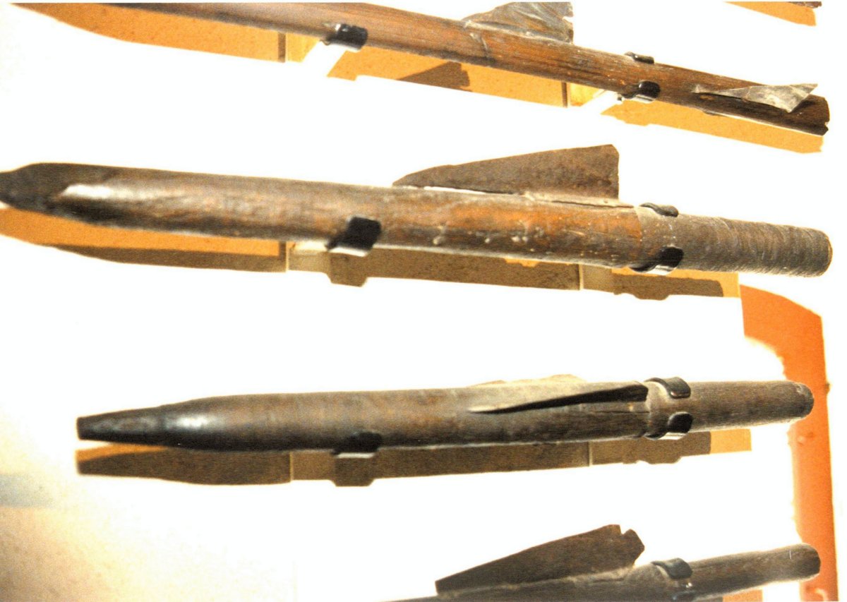

More of the Burg Eltz arrows.

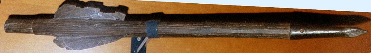

And the gun arrow at the Nuremberg Imperial Castle also identified by the author, displayed next to a wall crossbow.
Interestingly, the socket of the arrow head shows a piercing for a nail but actually no nail has ever entered - see close-up at bottom!

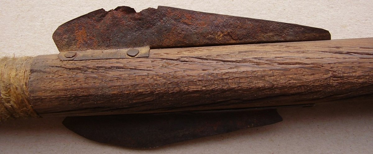

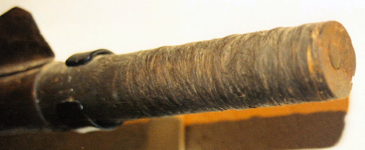

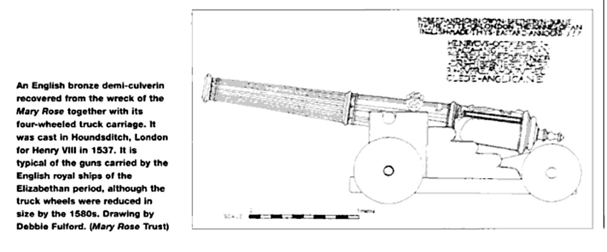

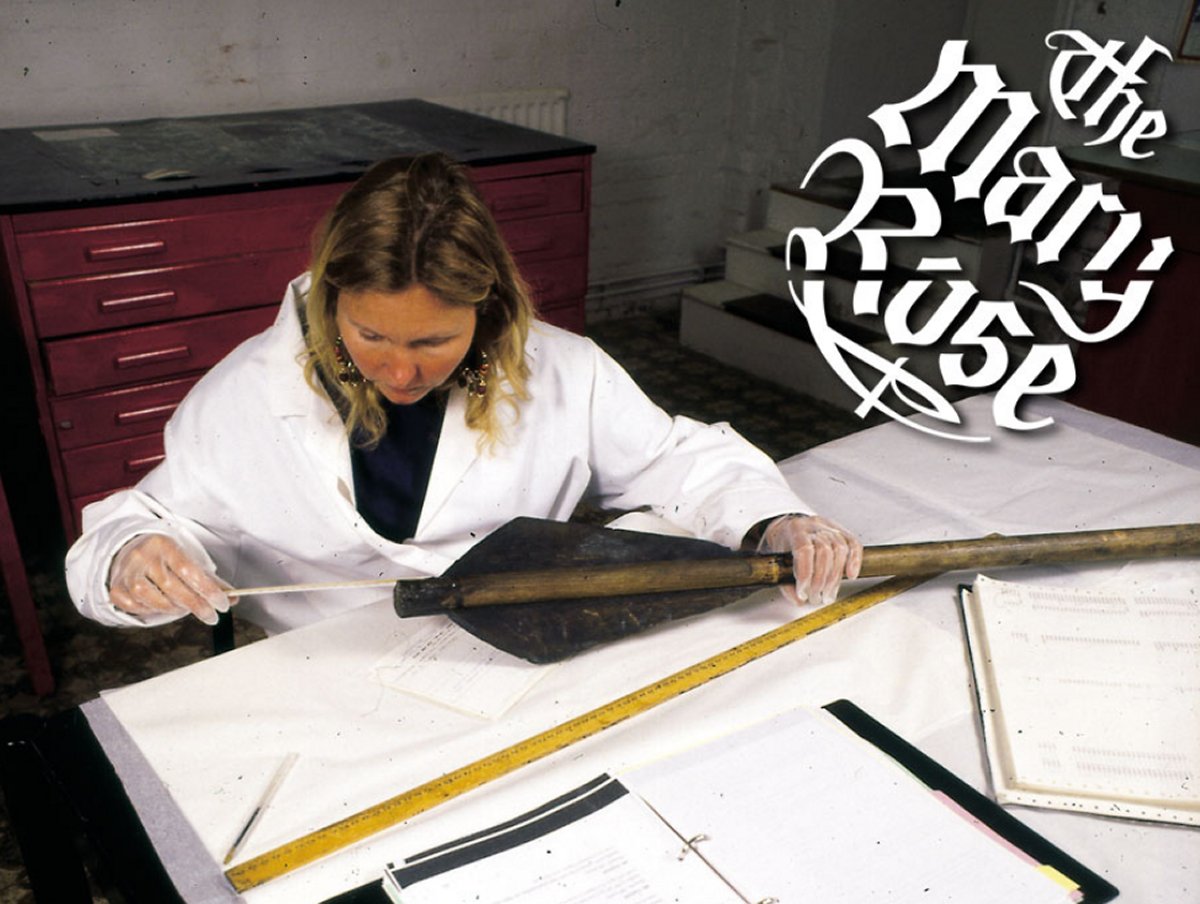

A huge incendiary gun arrow was salvaged, alongside a bronze demiculverin (!), from the wreck of the Mary Rose (sunk 1545).
The haft is of silver fir, the flights are oak.
At the extreme rear end, right behind the flights, a dark area is visible, most probably the former place of a hemp or cord binding gasket.

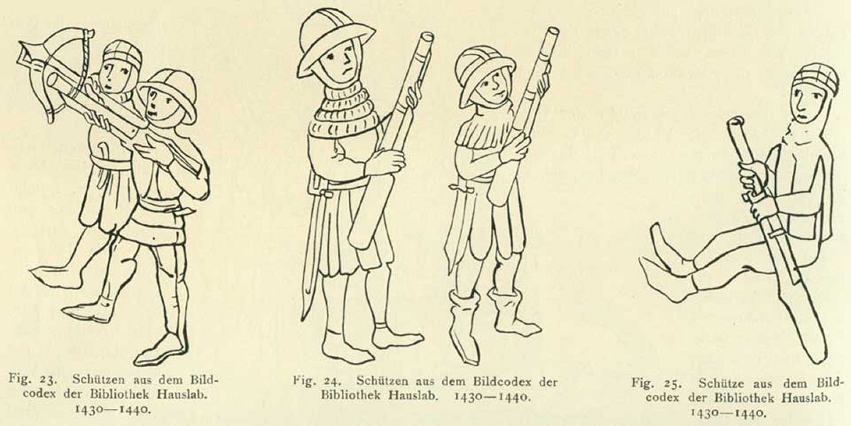

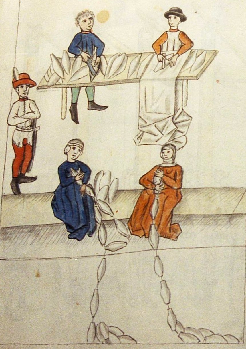

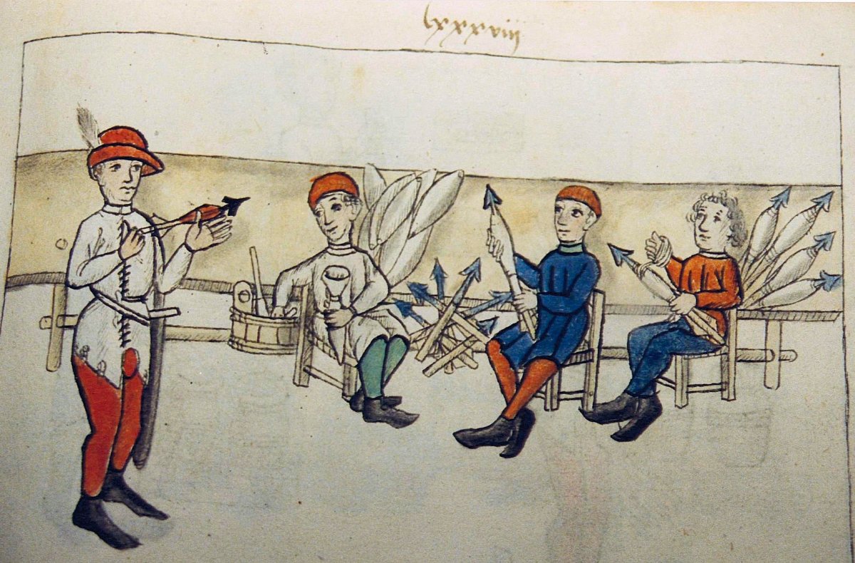

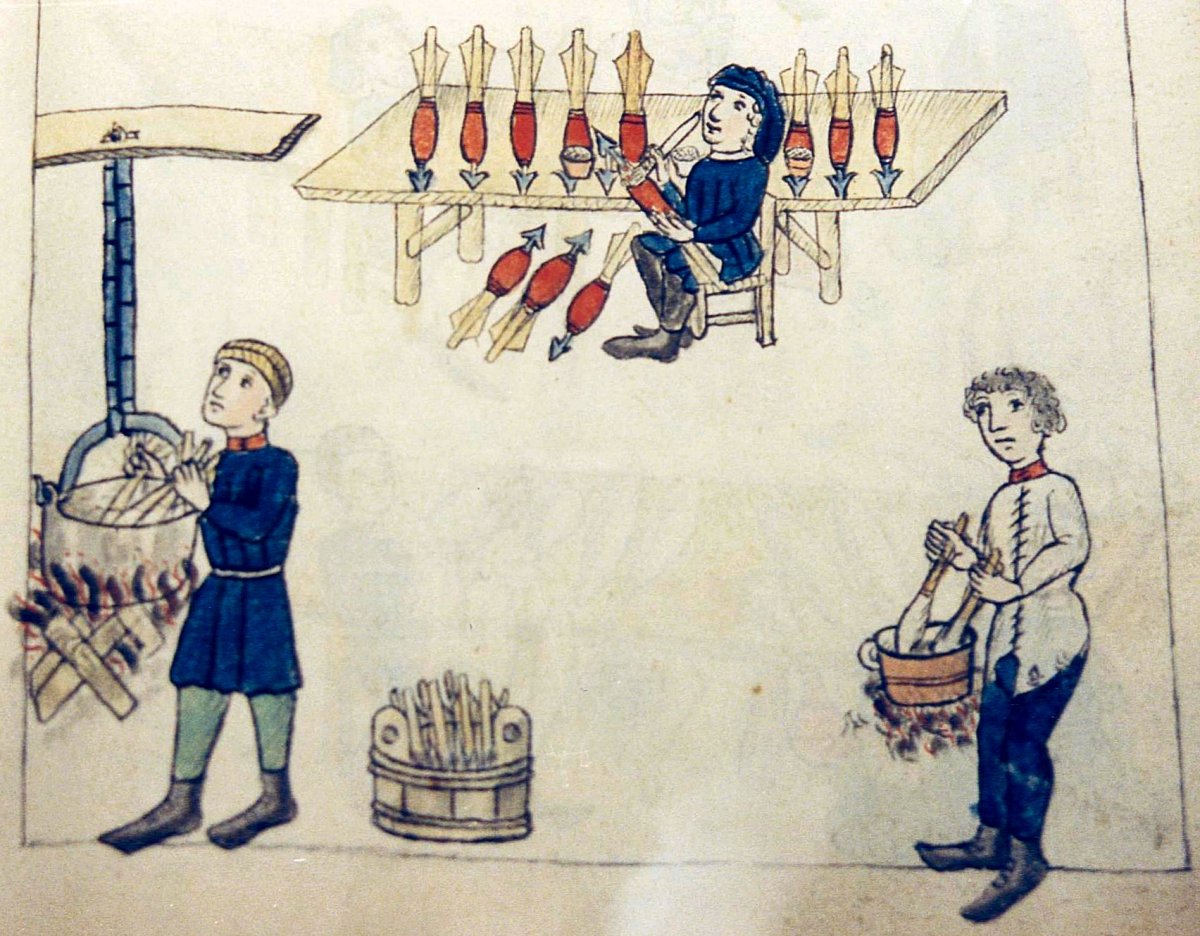

Incendiary arrows for both guns and crossbows, and how they were manufactured:
from the famous Hauslab manuscript, 1442, now in the Royal Armouries Leeds.
Author's photos, apart from the top five attachments.
