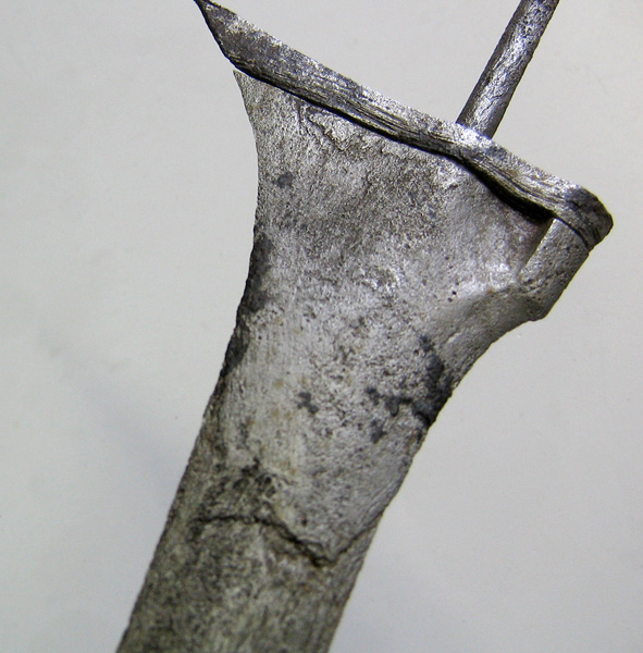

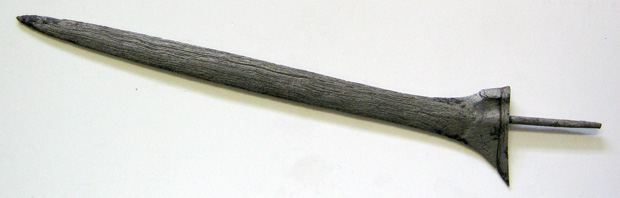

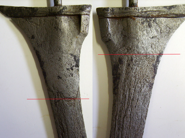

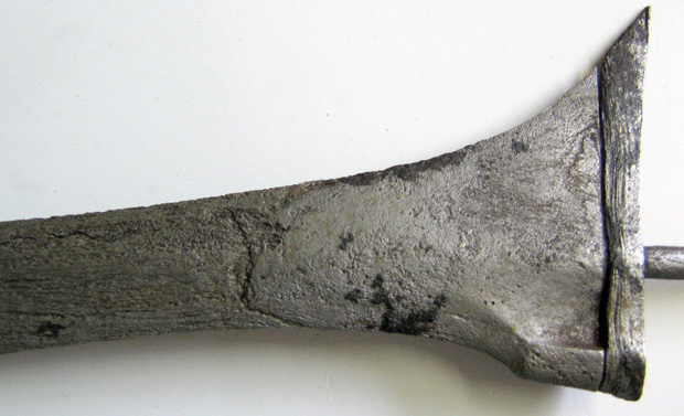

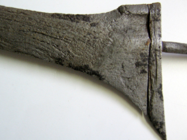

After removing a thick layer of rust, there appears a keris made of two pieces?
After cleaning, some questions came to my mind:
Was it done because someone appreciates the "pusaka" value of one half?
Or imho. this was made of two different broken pieces, and becomes a commercial keris.
But still, is it not difficult (and expensive) to forge two distinct halves together?
I would like to hear if anyone knows about these fabrications / repairs.

Corroded sor-soran repaired by welding?
Old 9th July 2012, 08:38 AM   #3
Posts: 2,965
From the photos I cannot say with certainty, but the most likely explanation for this is that the maker miscalculated in the forging, and has needed to leave in place the residue of the protective layer used when welding pamor miring, in order to provide the width and thickness required in the sorsoran.

mr. Maisey thanks for your comment,
miscalculation of the maker had not yet occurred to me.
but that option is reasonable to assume, because if I look more closely
the "fault line" is not at the same level and I guessed that if a keris would break, he just might break in half
sirek is offline   Reply With Quote

I do not know as much about these blades as Alan, but it appears to be a rather standard lap weld. I have several old non-keris blades with the same type of weld.
I think it uncommon a manufacturing technique for keris, but not at all rare for blacksmith techniques in general.
I would think if the outer sides were left in place then the weld would not be at the consistent angle on the edge...it appears to be two pieces...not three with an uneven grind.
It could be
-two keris blades being saved and reworked into one
or
-making one blade from bits laying around
Ric
Richard Furrer is offline   Reply With Quote
Old 13th July 2012, 08:03 PM   #7
Posts: 2,965
Yes Richard, I agree that this does look like a standard, run-of-the-mill lap weld, but as with many of the comments I make in respect of keris, I am not giving my opinion on this blade simply from the appearance of the blade in the photo. I have seen a similar thing done a number of times before. In addition to what I have previously seen, the material that has been used for the sorsoran and gonjo of this blade is of remarkably poor quality:- it is not what we could expect to see used for a keris blade, but it is exactly what we could expect to see used as sacrificial material to protect a pattern weld. Still, without having the thing in my hand, it is difficult to be certain of anything.
