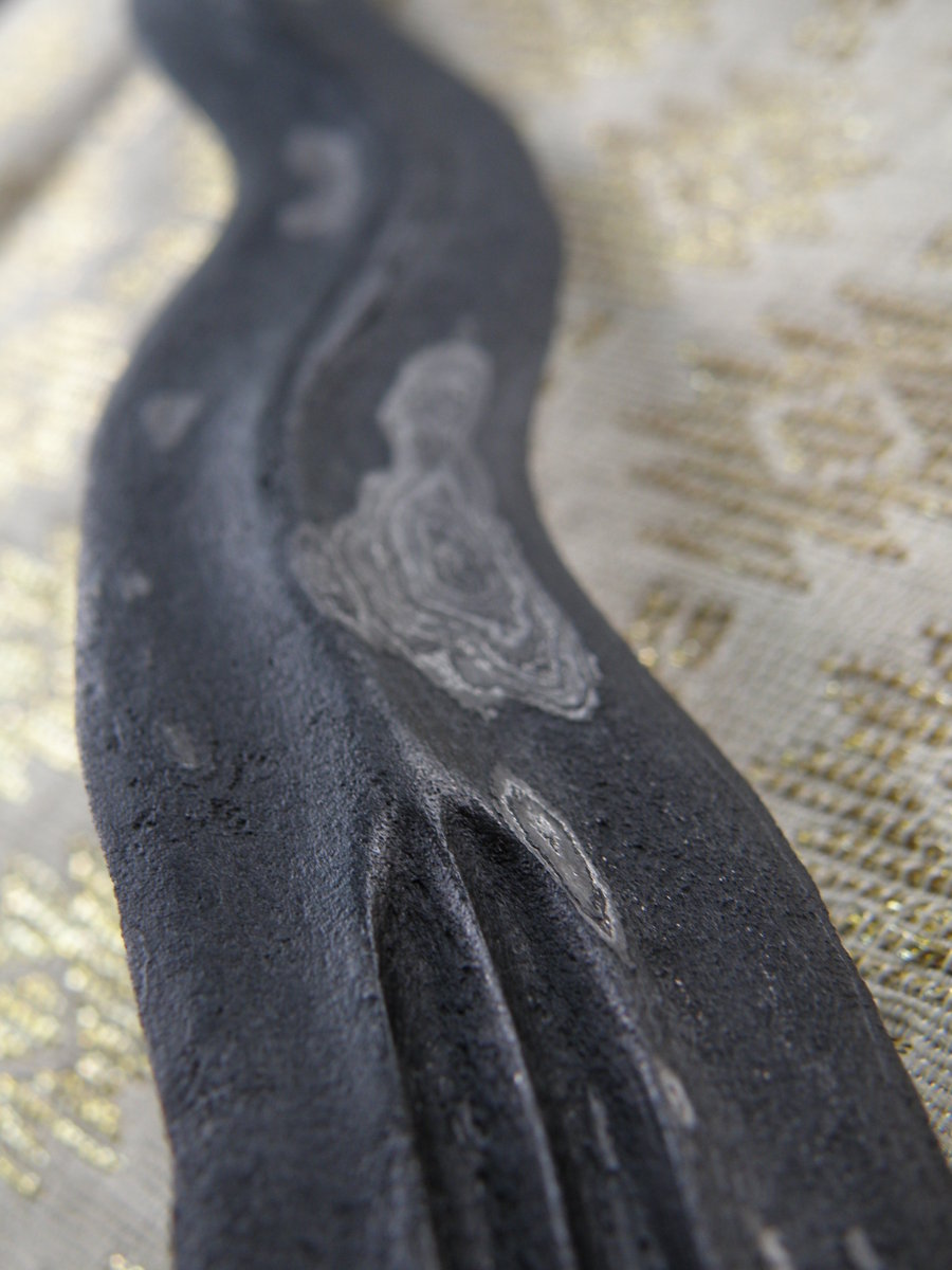

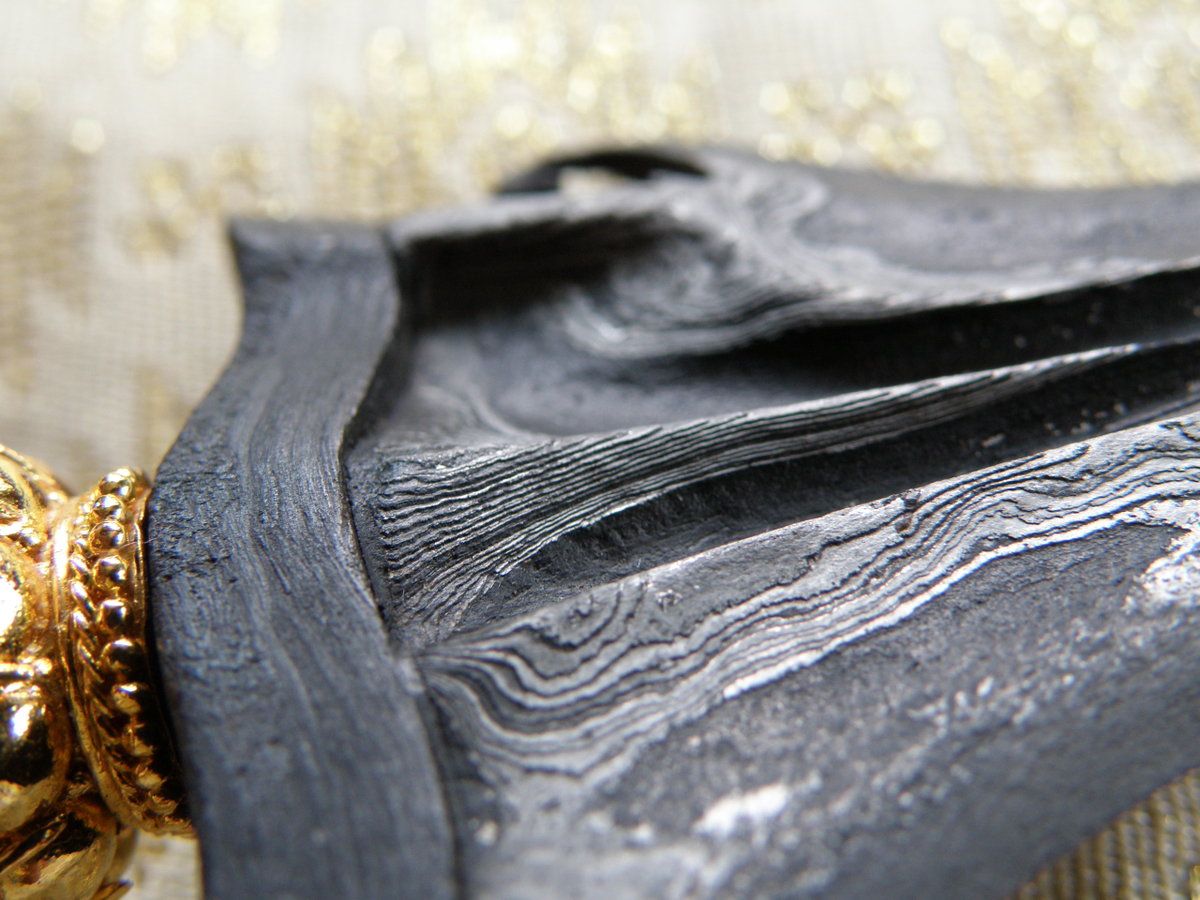

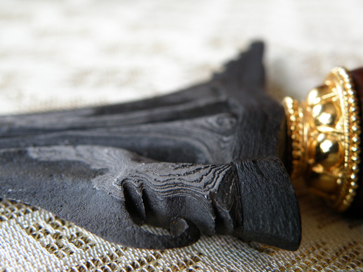

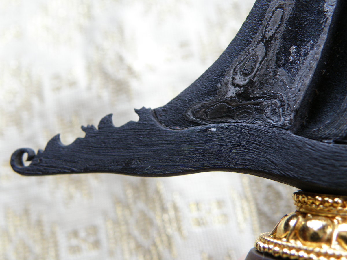

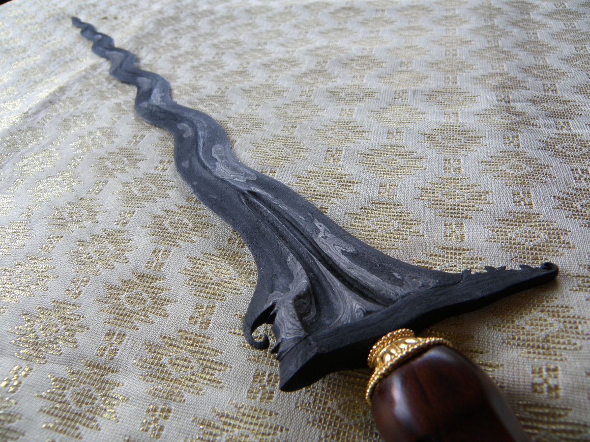

I had this piece down back the road of my early days in keris collecting. As a newbie back then (nor that I was seasoned enough now..), I was easily distracted by other upcoming potential until I somehow neglected this piece.
So here it is, I was told it was of tangguh Pajang but IMHO it's Mataram, at best. The most puzzling part is the gonjo, where the purpose of wilut and execution of kanyut at the ekor cicak was beyond my comprehension.
Hope anybody can give some input, comments or critics wherever necessary. Any of that would be much welcomed, and is pretty much vital in my need to understand this keris better.
Otherwise, enjoy some pictures, buddies...

I won't speak to the age of this keris, but where do you see a repair?

Well, maybe besutan at the edge, or a replacement gonjo?
I can only guess, coz I don't really know, Dave.

From the pictures I don't see any steel core and the gonjo seems to properly match with the blade both physically and colour-wise. In spite of the worn-out pamor and iron pitting, the ricikan look neat and sharp (kembang kacang, greneng, etc) so I would assess the blade as probably recent but other opinions are welcome.

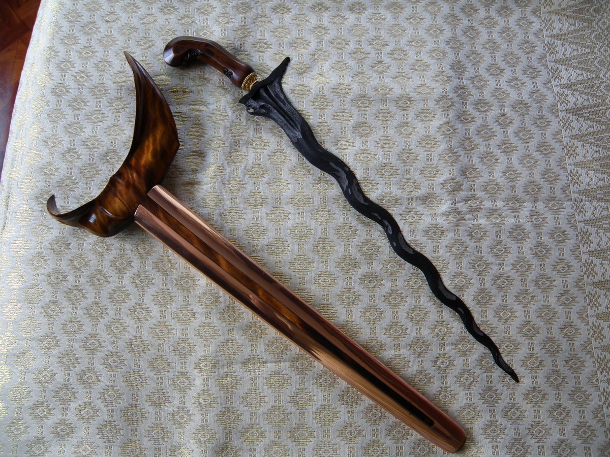

I like the worn out pamor.
And the pendok, Is it suassa ?

Look very closely at the joint between the gonjo and the base of the blade, especially directly under the pesi, now look at the degree of erosion to the greneng.
Draw your own conclusions.

I really couldn't tell if the pendok is really suassa...how to test it?

What I see is very little erosion to the greneng, and what looks like filler between the blade & gonjo .

The greneng seems very clean. The junction of the base of blade and gonjo seems to show quite a lot more erosion, particularly when you look at the 4th photo. I see either there is filler or something else has happened to remove the layering on the base of the blade. Not so easy to judge given the focus on the pictures but the erosion on the kembang kacang is more like that on the blade than that of the greneng

Since epoxy resins became available in Jawa they have been mixed with iron filings and used on keris to fill the gap between the blade base and the gonjo. This was being done long before the keris revival that took place in the mid-1970's and the prolific production that commenced during the late 1980's and continues until today.
There is nothing wrong with a filler between the gonjo and the blade base.
Its original use was to preserve old keris and to protect the blade base and gonjo from further erosion. With current era keris its use has a similar purpose, but where filler is used in a recent keris, it should be as thin as possible, it should not be used as substitute for a poor fit.
In this keris there is very little erosion to any of the ricikan, and especially not to the greneng, but the gap between the gonjo and the blade base is what we could expect to see in a very old keris that had been neglected. Since this is not an old keris, what we are looking at is sub-standard workmanship.
This is quite an acceptable keris for use with formal Javanese dress, and the wrongko does appear to be very nice. As a collectable? We all have our own likes and dislikes.

Based upon what I can see in these photos it is my opinion that this is current era keris.
