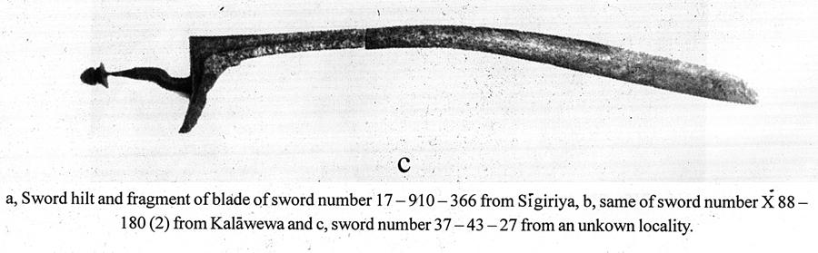

3.The nature of the blade profile does seem to have storta characteristics, at least in certain examples of those North Italian swords which of course had varying forms. Then there is the case of the creatures head on the peak of the blade at the back nearing the point, which resembles various 'oriental style mythical beasts.
Salaams Jim, This is indeed a puzzle! I suggest that one scenario may have the weapon arriving into the Philipines via Acapulco and across the Pacific...whilst another perhaps has a hybrid being made for presentation specially and from existing parts of various different mixed Chinese and other spare parts in the King of Spains workshops in the Philipines? It puzzles a lot of people that here we are holding up for comparison a Spanish delivered sword of curious origin presented to the Japanese in Manila in 1620, looking like a hybrid Sri Lankan Kastane but possibly nothing to do with Sri Lanka at all! (except the hilt is interesting from that perspective) see below for another clearly Lion like hilt on a Storta.
I have identified a number of weapons whose blades meet some of the criteria but I wonder where the monster came from?...If the blade is a Storta was it struck later perhaps just prior to the presentation date? If the Japanese struck the blade stamps did they simply add the monster decoration at the same time? Is it all a mixed bag with Chinese/ Oriental features? The fullers are very interesting...as you note.
Please see http://www.vikingsword.com/vb/showthread.php?t=12064 where a comparison is quite close.
Viewing the Storta line up below we also confront a Lion Head hilt...?
Ibrahiim al Balooshi.

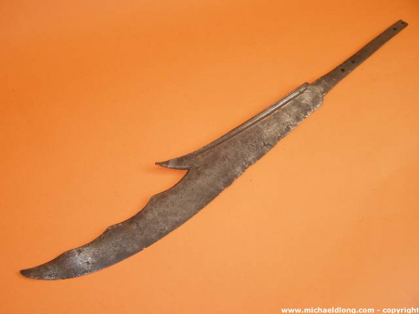

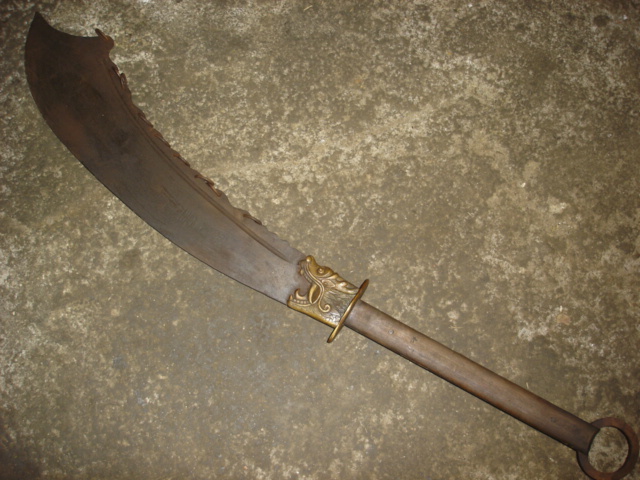

DANGER CONJECTURE AHEAD. THE JAPANESE AMBASSADOR WAS PRESENT IN SPAIN FOR TWO YEARS SO PERHAPS A SWORD COULD HAVE BEEN SPECIALY COMISSIONED AND MADE. HE MAY HAVE SEEN THE VARIOUS SWORDS FROM OTHER COUNTRIES PRESENT IN SPAINS MUSEUMS. THOSE ACCOMPANING HIM WOULD HAVE REPORTED TO THE KING ANYTHING HE FOUND MOST INTERESTING AND COMENTED ON. THE LAW AGAINST GIVING SPANISH ARMS TO A FORIGNER MAY HAVE BEEN BYPASSED BY HAVING A SWORD COMISSIONED ESPECIALLY FOR THE AMBASSADOR INCORPORATING THE FEATURES AND TYPES HE MOST ADMIRED WHEN LOOKING AT THE EXAMPLES IN SPANISH COLLECTIONS.
THE CARVING ON THE BACK OF THE BLADE AS WELL AS ITS FORM DOES NOT RESEMBLE A SIRI LANKAN KASTANE BLADE IT LOOKS MORE LIKE THE SPANISH BLADE SHAPE. THE DRAGON OR MONSTER CARVED INTO THE BLADE LOOKS MORE LIKE WHAT IS SEEN ON CHINESE OR OTHER ASIAN COUNTRIES POLE ARM BLADES. THE HANDLE IS CLOSE TO THE KASTANE FORM BUT A BIT DIFFERENT. THERE DOSENT SEEM TO BE A SCABBARD FOR THE SWORD AND THE ONE IN THE PAINTING HAS A SCABBARD LOOKING MORE LIKE A LEATHER EUROPEAN FORM THAN ONE FROM CEYLON. MOST KASTANE DO NOT HAVE A SCABBARD AS THEY ARE USUALLY MADE OF THIN WOOD AND ARE VERY FRAGILE. THE SILVER ONES HOLD UP BETTER BUT ARE OFTEN MISSING AS WELL. IF THERE WAS A KASTANE PRESENT IN THE COLLECTIONS IN SPAIN PERHAPS ITS SCABBARD WAS MISSING AS WELL.
WHAT WOULD PROVIDE SOME GOOD INFORMATION AND NOT JUST CONJECTURE WOULD BE TO HAVE SOMEONE FAMILIAR WITH FORGED BLADES FROM SPAIN LOOK AT THE SWORD AS WELL AS SOMEONE EXPERT IN SIRI LANKAN WORKMANSHIP. UNTIL THEN WE MUST DIG AND SPECULATE AND PERHAPS HIT ON SOME FACTS ALONG THE WAY .
I DON'T HAVE A PICTURE OF A BLADE WITH A CARVED MONSTER BUT INCLUDE TWO CHINESE BLADES A POLE ARM BLADE AND A SWORD.

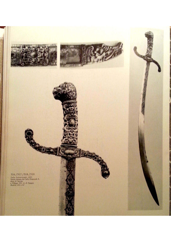

Posts: 10,862
Pics from Boccia & Coelho ("Armi Bianche Italiene", 1975, #516-519), this is an Italian sword presented to Philip III of Spain by Carlo Emanuel I of Savoy (1562-1630) apparently in 1603.
Worthy of note, the lionhead, and the 'monster head' on the scabbard tip.
While the blade is more of a narrow type with yelman rather than the form on the Hasekura example, these other features are interesting in considering influences present in Spain prior to the mission's arrival.

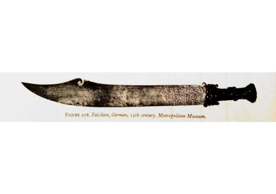

Posts: 10,862

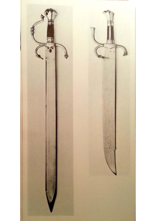

This is a falchion stated German from Stone (1934, p.224, #276) and stated 15th century. There is little information in text in Stone on this sword, its reference is shown as "A Cyclopedia of Costume or Dictionary of Dress" (James R. Planche, N.Y. 1877).
Please note the pronounced peak on this example, resembling this notable feature on the Hasekura sword. While the German provenance is of course distracting from our focus on Spain, and Italy, it is important to note that going through Calvert (1907, "Spanish Arms & Armour") there are profusely examples of German armour supplied to Spanish nobles and monarchs.
Armourers were typically actually 'brokers' and assembled harness components from many subcontracted artisans. With this they often furnished swords in many cases.
The 15th century classification is of course considerably earlier than the period we are discussing, but these blade profiles remained prevalent for many generations, even centuries with tradition bound Spain .

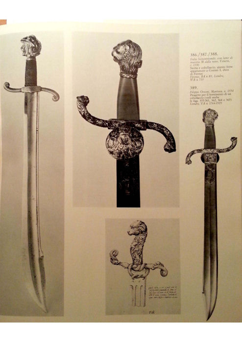

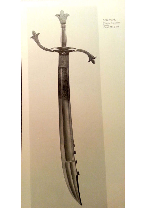

Another grouping of stortas from Boccia & Coelho (upper left #509) is from Venice c.1600.
(upper right, #543, #544) are both from Naples c. 1600-10
below #386, 387, 388 are from Venice c 1550, note the recurved crossguards reflecting basic form of developing hit system, also the human and lionheads.
* The late Tony North in his "Late 15th Century Italian Sword" (Connoisseur, 1975) notes the developed hilt system similar to nimcha of North Africa and of course kastane probably developed from this type sword hilt, citing Charles Buttin with concurring views.
Quite interesting is the sketch of a zoomorphic head in carved ivory from Italy (#389) dating from c1554. Of note, the deeply channeled fullers cf. those seen in the Hasekura kastane. Again, there are many Italian swords with these deeply channeled fullers, often in elaborate sectioning.

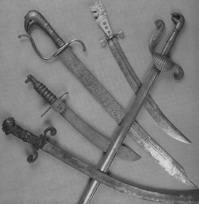

What interesting here is the lionhead on this sword (of European form of course) and most notably the monster head on the scabbard tip .
It would seem that the use of figure heads was in place in Italy, and possibly elsewhere in Europe by mid 16th century, and as seen here, this and the 'monster' head were already featured on swords in Spain prior to the Hasekura mission.
If indeed the blade was produced in Spain placing this type of monster head on the peak of the blade, and spurious markings (as often placed) were added, could the second marking be a European attempt at Japanese characters?
I think we can rule out China as a place for blade provenance, and as seen, the Philippine possibility is out. Oriental influences seem quite present by the time of this sword c.1603.
The other images are pretty much explained in each post.
I want to note that these images and data are from the books referenced and photos using phone as noted.

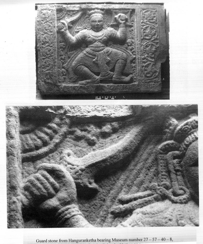

Dear KukulzA
I am including a few references regarding a basic timeline of Sri Lankan swords primarily from the publication “Ancient Swords Daggers & Knives in the Sri Lankan museums” by P.H.D.H.De Silva and S. Wickramasinghe (2006)
You are correct that the Kasthana and the D guard swords are the last common forms of the Sinhala swords. The earliest swords where evidence survive from the Anuradhapura and Polonnaruwa kingdoms going back more than 2000 bp. were mostly down curved swords and straight long double edged blades. There are many forms of short curved and Gladius type weapons illustrated but with little surviving artifacts. the early types are always simple and in-ornate. the transformation of ornate arms (in general) is possibly in the Gampola or Dambadeni kingdom era and couple of centuries prior to the arrival of the portuguese. the massive destruction wrought on by the portuguese destroyed most of the incidental evidence that would have assisted in constructing a proper timeline.
Vandoo the proper spelling is Sri Lanka and not SIRI Lanka
Prasanna

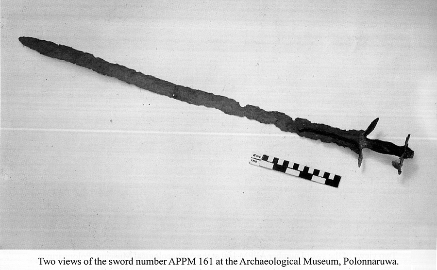

Prasanna Weerakkody
Prasanna Weerakkody's Avatar
Join Date: Sep 2011
Location: Sri Lanka
Posts: 52
sorry images failed to attach- re sending
Prasanna
Prasanna Weerakkody is offline   Reply With Quote
Old 1st February 2014, 04:32 AM   #255
Prasanna Weerakkody
Join Date: Sep 2011
Location: Sri Lanka
Posts: 52
Adding two more swords. including "Kandy ritual sword" extracted from a paper by G.L.Anandalal Nanayakkara (included in the above publication) which I believe is a valuable link as a transitional surviving link between the polonnanruwa era swords and the Kasthana. it also contain predecessors of the animal forms on the guards as well.
p.s. there is a class of replica weapons used in Devala and Kovils where different deities are worshiped. the arms used usually parallel actual arms in use at the time. so IF this was only a "ritual sword" there was very likely a real arm as well at that period of a similar form.
prasanna

Salaams Gustav, If I can simply illustrate how far we have advanced on this thread our understanding of the developed main thrust of this topic "The Kastane " and incidentally the broader view regarding other Sri Lankan weapons as well as the fine addition by Prasanne on the likely origins of the sword seen on the Sri Lankan National Flag etc;
We are perhaps close to identifying the Japanese item with what could well be a Falchion/Storta blade ... which forms a great little side avenue for research and which has taken many hours of deliberate and exacting research. The avenue includes potential links to oriental weapons and influence through Portuguese involvement in Sri Lankan designs from the outset in 1505. The journey by Hasekura Tsunenaga has been an amazing episode where parallel research opened my eyes in addition to the Sri Lankan/Chinese relations with the Ming dynasty etc. Getting a clear picture of Hasekura's involvement has been confounded by incomplete data and conflicting reports but I believe we are much better informed than before and despite the idiosyncrasies of 400 years of clouded detail understandably lost in time.
Much of the involvement by the three invaders Portuguese, Dutch and British has been unfurled and their effects on the key weapon in the Sri Lankan blades arsenal; The Kastane. We have observed the link with the Royal Workshops, the development of the weapon as a Court Sword and badge of office and rank. The ancient historical link and influence of design by Buddhist/Hindu pre-history has been given great attention.
Over all great strides have been made in our understanding; Therefor I have to ask of your remark above...Is that the best you can do?

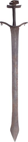

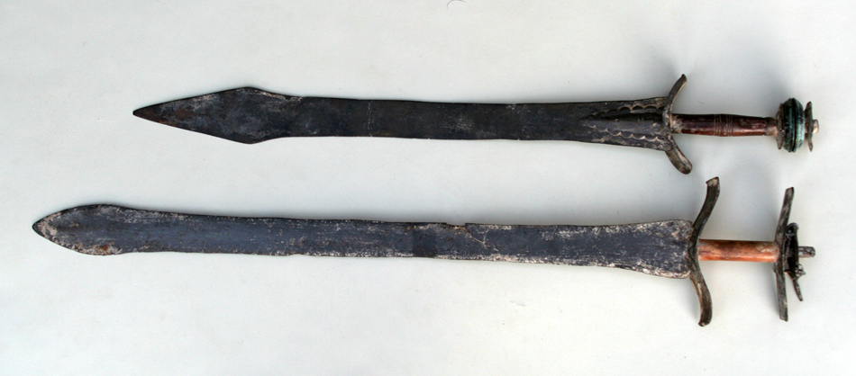

Old 2nd February 2014, 03:52 AM   #262
Dear Prasanna,
In your post #254 you showed an old and presumably Sri Lankan patissa.
Quite some time ago I posted 2 of my patissas:
http://www.vikingsword.com/vb/showthread.php?t=6012
Do you think they might be Sri Lankan as well? Will you hazard a guess re. their age?
They are made out of bloomery steel, the earliest and the most primitive way of obtaining enough material to hammer into a blade.

Posts: 52
Fernando- still a bit puzzled by the Calachurro. The term “Kala Kiringne” is still in use for a type of knuckle duster. but even the word “Kala Kirichchiya” is not in proper use as to my knowledge. been discussing this with some Angam folk as well, but nothing significant is extant that clearly indicate this arm.
My personal assumption though is that it probably refers to the short wide bladed sword depicted as in the Gladiator at “Ambekke devale” illustration above. though no artifacts of these swords are found this sword is the most prolifically illustrated sword of the period. I am including an image from a frieze in Ridi-vihara depicting gladiators fighting with these swords.
Ariel, interesting to see those swords. The similar styled Sri Lankan swords are dated roughly between 5th -12th centuries in both Anuradhapura and Polonnaruwa kingdoms. I would not be sure of a particular name given to them though; there are references to patissa in certain sources I am not sure if it refers to this. There is one curious difference though in construction; the Sinhala swords are assembled as hilt and guard sections inserted to a rod extension of the blade and held together with a screw on end piece similar to the X -ray radiograph image shown. your hilts seem to be cast separately and fitted to the blade with pins. (??)

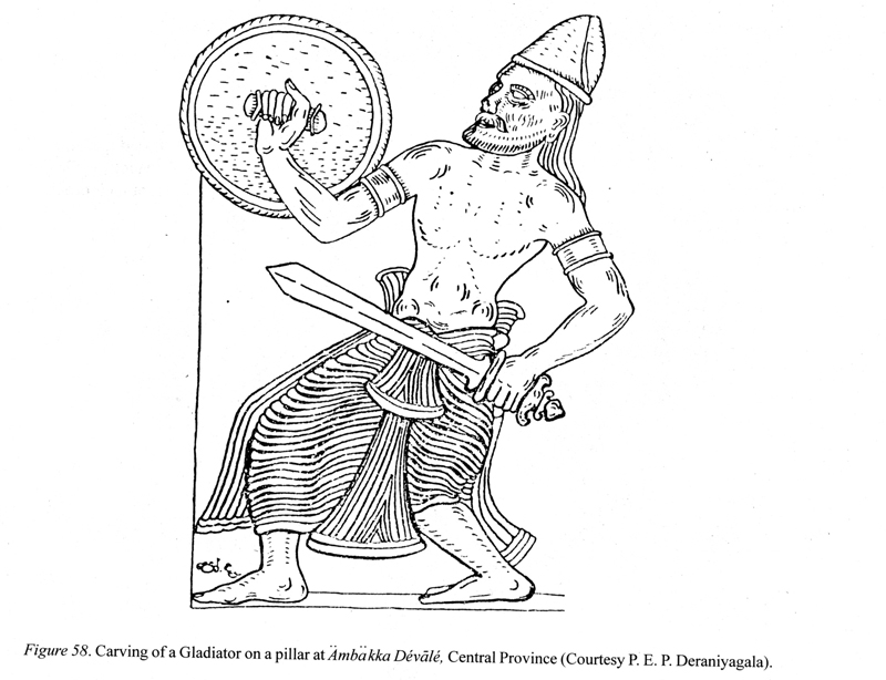

Originally Posted by Prasanna Weerakkody
...I am including an image from a frieze in Ridi-vihara depicting gladiators fighting with these swords...
Amazing!
See how a Portuguese has depicted the Chingalas* in the XVI century ... pass his naíve trace and artist's freedom.
(Watercolours belonging to the Casanatense Codice, from which i have both a basic and a de luxe reproduction ... both full of support articles and chronicles).
* or Chingalás; how the Portuguese called the Sinhalese in those days.

Fernando,
great to have this image- actually it seems quite accurate, the Hair and mustache styles, ornaments etc. match the style of the Sinhalese (Chingalas) at the time. so the weapons should also be faithfully reproduced. the swords match the local illustrations as well. Fantastic image find. Thanks again for sharing.

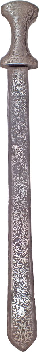

Old 13th February 2014, 06:04 AM   #270
HERE ARE SOME PICTURES OF SOUTH INDIAN SWORDS. #1. PICTURE IS REFERRED TO AS A PATTISA AND HAS A 18.5 INCH BLADE. #2. PICTURE SOUTH INDIA TEMPLE SWORDS. #3. NAYAR TEMPLE SWORD.
THESE ARE SIMULAR TO THE SWORDS DEPICTED ABOVE. I ASSUME DURING CEYLONS HISTORY POWER MAY HAVE BEEN HELD BY KINGDOMS IN SOUTHERN INDIA OVER PARTS OF CEYLON AND LIKEWISE CEYLON MAY HAVE HELD TERRITORY IN SOUTHERN INDIA. THIS OFTEN OCCURS EITHER BY TREATY OR FORCE OF ARMS BUT AS I DON'T KNOW THE HISTORY I DON'T KNOW.
I HAVE SEEN SOMETHING SIMULAR IN THIS SWORD FORM (ESPECIALLY THE BLADE ) IN JAPANESE AND CHINESE ART USUALLY REPRESENTED AS A TEMPLE SWORD.
