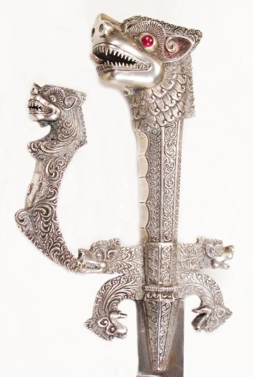

Interesting bit of bed head carving showing zoomorphic characters ... and below that the King inspecting Mudalyers/leaders late in the English period.
Ibrahiim al Balooshi.

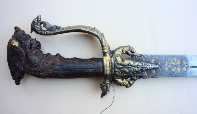

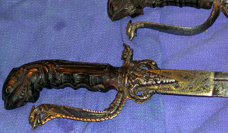

Here are a few pics of the two I have owned. The more complete hilt example is still in my possession

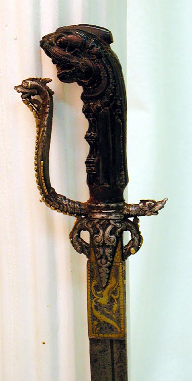

Here are two from my collection.

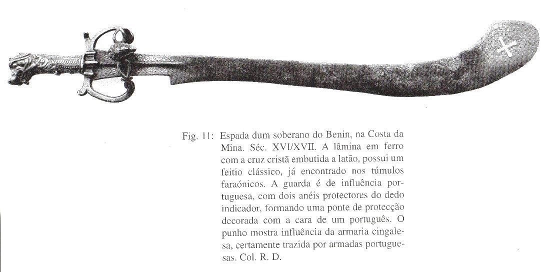

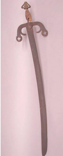

Salaams Fernando, Your post at #80.
I have to point out the nature of this sword which has nothing to do with Sri Lankan weapons since it is the preferred design having a lions head of the kings of such tribes in West Africa ~ Benin and Dahomey regions.
The author of the sword write up and picture(Rainer Daehnhardt) forces the description in such a way as to be Certain that this weapon sailed with the Portuguese to the far flung corners of the Indian Ocean where it is imagined it took on the mantle ...or hilt... of the Kastane...or that it in any way was influenced by that weapon. I would suggest that "It most Certainly did not". See http://www.vikingsword.com/vb/showth...d=1#post220003
I further cast doubt upon the claim that this is a Christian cross. Again the reference above refers. It is more likely to be Voodoo inspired.
I have to point out the nature of this sword which has nothing to do with Sri Lankan weapons ...
Boa tarde Senhor Balooshi,
Either my alzheimer level is rather intense or this issue has already been approached and, a consensual perspective was established, for i would not resurrect it unless i had some fresh news to produce. I am afraid that, if i tried to remodel old beaten material, just keep the present thead going, i would be, as we say here, raining on the wet. In the other thread where plausibitiy of writers description was at stake we assumed that often true sounding assumptions miss actual veracity, like the case of this specific sword examle, which was ascertained within the hour, if i well remember
So .. let me keep consistent .

Salaams Fernando, Thank you very much for your reply. I am so pleased you agree that the offending weapon description has no place in this thread nor in others ... and that since it pollutes the story in several threads with its spurious reference to weapons of West Africa; Benin and Dahomey regions in particular having certainly travelled to the Indian Ocean in Portuguese Battleships...etc etc ..therefor they must be influenced by Kastane (Sinhalese Armoury weapons) that those pages too should be purged of such material. It is nonsense.
I repeat your advice ...Quote"For as much as authors claim their knowledge and state their opinions as if they were facts, lack of substantial evidence often forms their strong adversary".Unquote.
On the subject of raining in the wet... What new evidence have you supported in this thread ? We have here and in the sister thread at http://www.vikingsword.com/vb/showth...000#post220000 massive support of clear inter regional influence from mainly South India but also inter religious mirroring of architecture concerning the Kastane linked to Budhist and Hindu designs which are not affected by Portuguese constructs nor does it appear to have any link at all with the Nimcha... and by the way the other spurious sword from your author, a Nimcha Sword from Zanzibar, I recall is also wrongly written up with the detail of a Moroccan Nimcha... Should we perhaps not be more careful with our referencing material?
I would be pleased to see a proof regarding the Christian Cross in the blade as so far as is understood this is a Voodoo geometry although any light you can throw on it other than the author writing that this is a Christian Cross related to those on Pharaohic Tombs?
I would be careful identifying the equilateral cross as being solely "Voodoo geometry" Ibrahiim. (Btw, the more proper term would be Vodun or Vodoun. While Certain diaspora sects in Louisiana use the term, Voodoo carries far to much bad Hollywood movie baggage with it).This symbol is both ancient and prolific and can be found amongst cultures spread all across the globe with various meanings. In many cases it represents a solar symbology, the four directions, the four elements, etc. Depends on the culture. You are correct that in West African cultures such as the Ewe and Fon it represents the crossroads, the meeting of the spirit world and the material. However, the equilateral cross also has a place in Christian iconography as well in many variations. So while it is most logical to assume that the equilateral cross when found on a solely African weapon most probably does not have a Christian affiliation, it is not so clear as to the meaning and purpose of such a symbol when it appears on weapons outside West African spheres.
Salaams and thank you David for your input which I agree with entirely with the following caveat; The tribal leaders in West Africa very quickly adopted the Crucifix and would appear to have inserted the Cross into their broad leaf shaped swords probably from the Portuguese and as I have just outlined in
http://www.vikingsword.com/vb/showthread.php?t=23002 at #20
I believe this "Religious" geometry would have suggested to them a special extra degree of power over their people ... Your Vodun and Vodoun are correct terminology although I had researched the New Orleans and Haiti cultural aspects and Voodoo seemed linked which I think it is in part and shown by the diagrams at the other thread and came with the slaves from West Africa. Your indication about the cross roads symbolic meaning is particularly welcome and underscores what I have already written.

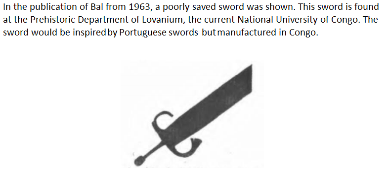

Old 30th August 2017, 06:36 PM   #165
...So while it is most logical to assume that the equilateral cross when found on a solely African weapon most probably does not have a Christian affiliation, it is not so clear as to the meaning and purpose of such a symbol when it appears on weapons outside West African spheres.

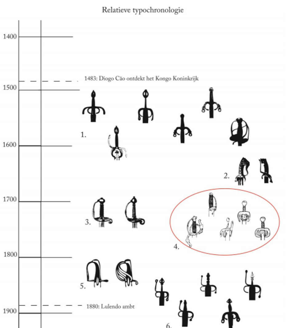

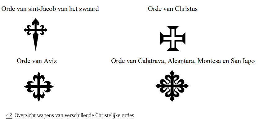

Several Congolese swords are found with such crosses in their quillon discs, David. I hardly see these perforations as symbols originated (different than adopted) by Kongo Africans. Amazingly a scholar (Wanynn 1961,65) even names them as Greek crosses.
The order of Christus, for one, was also present in the Kongo kingdom and had swords in their possession as a sign of status (Schellings 1949, 12).
The Kongo kingdom was defined by the mutation process where European elements were incorporated in domestic culture.
Portuguese arrived in Congo in 1482 and soon converted the local monarchs to Christianty. The first monarch to be baptized was Nzinga-a-Nkuwu, with Christian name Joăo I in 1491. The process went smoothly because the Christian elements called for domestic ideas on their own ideology. Afonso I (1509-1540), the secong king converted to christianty, had seen this well, and confirmed his power for the Europeans and for the domestic population by the setting up with catholicism. The European elite symbol, the sword, was taken over. Together with the crucifix, these two European elements have certainly incorporated most of the habits of the Bakongo (Wannyn 1961, 67).
Deceased Kongo monarchs were found buried with these swords in a Christian attitude.
The symbolism behind the sword for the Bakongo is reduced to the domestic ideas concerning iron and their own theology which was reflected in the form of the sword. Also the rituals which were carried out with the swords reflected this symbolism; in any case the swords came initially from Europe. At the time of the Portugese, European swords were used. Later these became scarcer and domestic copies started being made.
The last soba to have a portuguese Christian name was Soba Nkanga-a-Lukeni, Garcia II (1641-1661). This adds to two centuries of culture blending.

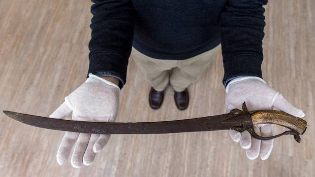

Posts: 4,408
An interesting gift from Russia to Sri Lanka was made in the form of a previously lost sword now returned....and gifted to the National Museum.

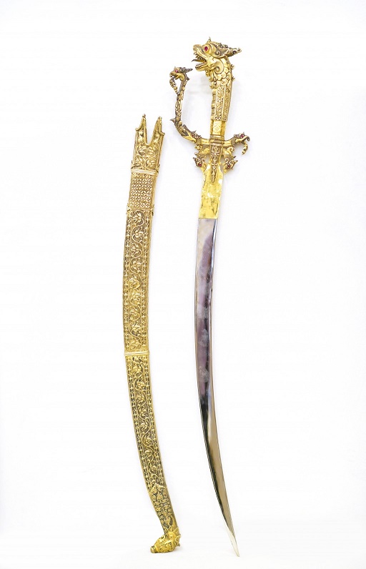

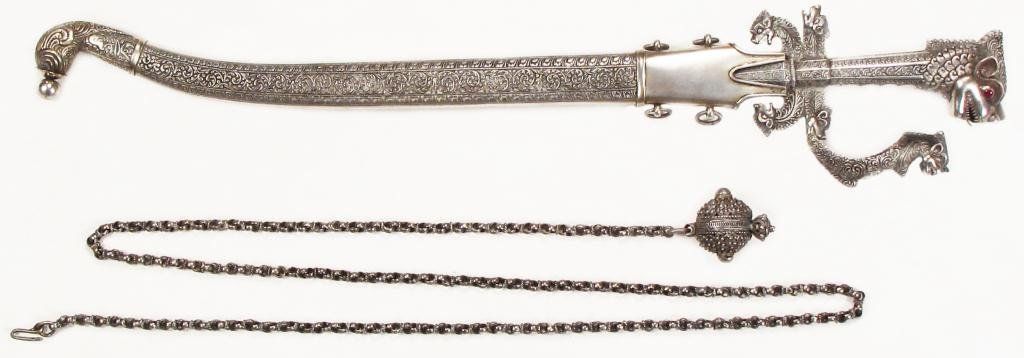

THE KASTANE . Its Architecture.
I present here an interesting write up on a sold item see http://www.icollector.com/A-FINE-PRE...WORD_i15525534 where it states~
Quote"An exceptional example of classic form, wrought entirely of silver. The hilt elaborately chiseled with scrollwork, the pommel a fully-modeled makara head with ruby eyes, the guard with five further monsterheads, and the face of a fanged demon on the knucklebow. The lightly-curved, single-edged blade with blunt ricasso. In its finely embellished silver scabbard decorated en suite with the hilt, the terminal likewise formed as a monster head, and inscribed, MUDALIYAR B.P. AMERASINGHE. With its handwrought silver chain baldric terminating in a large filigreed bead. Second half of the 19th century.The term 'mudaliyar' is a Tamil honorific, generally applied to a high-ranking member of the military or government. Overall length 60 cm. Condition I." Unquote.
The proviso here being that the use of words by auctioneers and museums may vary considerably in describing the Deities and that a sympathetic viewpoint has already been adopted here on thread. Interesting is the silver chain baldric although something not noted by the auctioneers is The Humanoid Face, outward facing, sometimes refered to as The Humanoid Crocodile on the Knuckleguard which is another Deity not always present but every bit as fascinating. I think this is the Kirtimukha. With this in mind readers may note the extraordinary descriptive given at #49 to which I would add; Lions Head form... in many examples.
Unusually the so called Quilon structures(Vajra) are wide in this late model as opposed to earlier form which are close together. In this case has the European style of Quilon been adopted? Personally and since this was not a fighting weapon (court and badge of office only) I do not think so but it is noted in the margin for others to comment.

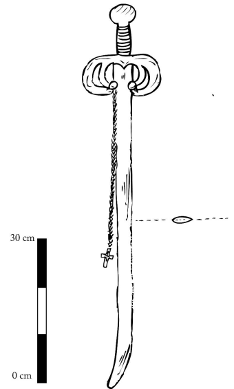

In previous discussions, there has been the illustration(attached) with an entry in a book by Mr. Rainer Daehnhardt, which shows a sword (cutlass) with a cutlass type blade distinctive to Dahomey, West Africa. What is notable here is that its hilt is remarkably similar to the Sinhalese kastane with lionhead.
It has been suggested that this hybrid may reveal possible links between these vastly distant locations or possible developmental influences.
Actually I believe it is simply a notation to the similarity to a Ceylonese hilt.
It is well known to us as students of ethnographica that such instances of items of distinctly regional or cultural form may turn up occasionally in situations where they are completely incongruent in areas far distant and disconnected from their point of origin.
This seems a case of the union of a foreign or 'exotic' hilt being joined to a Dahomean blade in the oft used convention of such hybridization with diplomatically oriented swords.
Some time ago in discussions here there was a case of what appears a hanger type sword of kastane form (but has been rehilted it seems without the lionhead) and shown described as a 'dragon sword', found in British Columbia in Canada. This was discussed in a book titled "Similkeen: The Pictograph Country" (Bill Barlee,1978) and other research revealed an inventory of 1836 of the Northwest Co. which included 12 'dragon swords'.
("Rocky Mountain Outfit, 1836, Fontanelle, Fitzpatrick &Co.", papers of the American Fur Company, Reel 7, vols. Y & Z, Missouri Historical Society).
It is compelling to think of these as examples of 'kastane' which had arrived somehow in this unusual setting, with the resounding question of 'how did they get here?'.
In one explanation, it is noted there was an ill fated Spanish expedition into these regions mid 18th century (suggesting the term 'turtle people' in native legend there referred to the cuirasses of the Spaniards. It is conceivable that the Spanish had acquired some of these Ceylonese swords via their colonies in the Philippines, as trade entrepots there of course would have networked with others trading in Ceylon.
* shown is the route of the Hasekura embassy of 17th c. where a kastane was acquired from the King of Spain, either in Spain or Philippines.
However, the trade company case with 12 swords listed as 'dragon' swords seems much more likely conditionally. Some suggestion has been made that the term 'dragon' may be a contracted use of the term 'dragoon' of course referring to the heavy cavalry sabres. There is always that possibility, except that no other examples of these dragoon swords are known in these contexts. The was a favor for shorter weapons such as hangers, and the 'broadswords' listed were actually short, heavy artillery sidearms (the term broadsword was still generically used in those times).

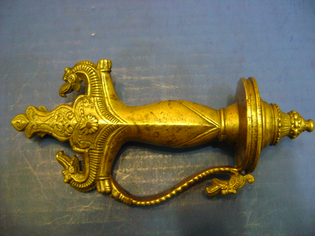

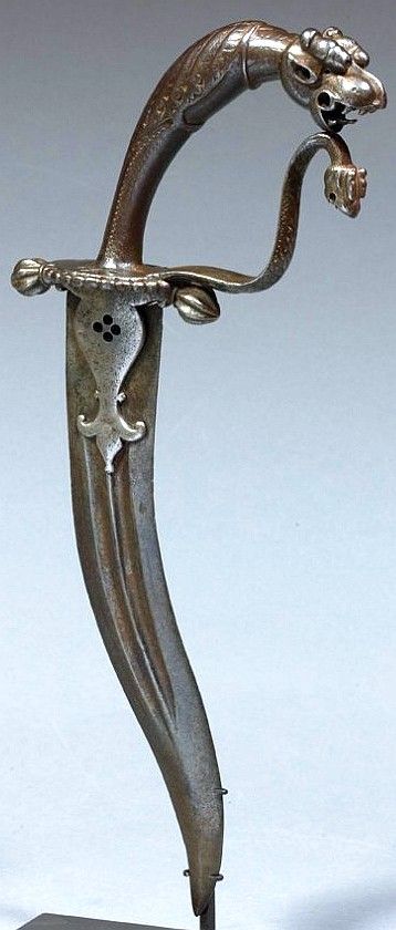

Returning to the potential origins of the Sinhalese kastane form, an interesting example of dagger/short sword is shown in "Arts of the Muslim Knight", Furasiyya Foundation, 2008 (p.206, #197). It is listed as Deccani, probably Bahamanid dynasty and of 15th century.
It seems that these Deccani influences, the downturned quillons with Makara heads, and the general configuration of the hilt pommel and knuckleguard are remarkably compelling as a proto-kastane form.
These influences diffusing via Tamils to the east, provided a compelling conduit with their trade and diplomatic contacts into Ceylon with the central kingdom of Kandy. The artisans and craftsman of this kingdom were well known for their work on the piha kaetta knives so key in royal regalia, and apparently development of the kastane into a sword of status as well.
Here again, certain elements and influences were syncretically combined in the form of hilt we know existed before c. 1600.

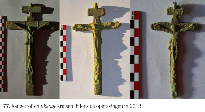

Regarding the West African Dahomey sword ..or the write up with the weapon... it is conveniently some would say willy-nilly even... given the write up as having certainly bounced back from a deployment with the Portuguese Battle Fleet from Sri Lanka and having influence from their armoury... from the Kastane . This is doubtful since why would a machette tribal sword make such a journey and be given this most peculiar treatment? It appears as a flambouyant idea straight from the head of the author without any proof but as a seemingly fanciful notion.
On the other hand concerning the Cross cut into the broad leaf style of blade; it is plausible that some shades of Portuguese influence in their long association in the region may have occurred and wall art in caves bears this out to some degree. Black Crab swords with similar crosses are further evidence of such liaison but as for the weapons going off on tour with the Portuguese Armada for me it is a bridge too far...That does not rule out a hilt being brought back from such an adventure and possibly being presented to a chief... but that is a very different notion. If the hilt is not a bring back from the Indian Ocean then where is it from?... I have suggested that this is either a home grown carved big cat favoured by chieftains in Dahomey regions or perhaps a Storta Hilt perhaps as a gift. Looking at the skills of the Ivory carvers in the region I suggest that this is the origin. Home grown in other words.

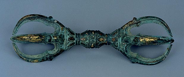

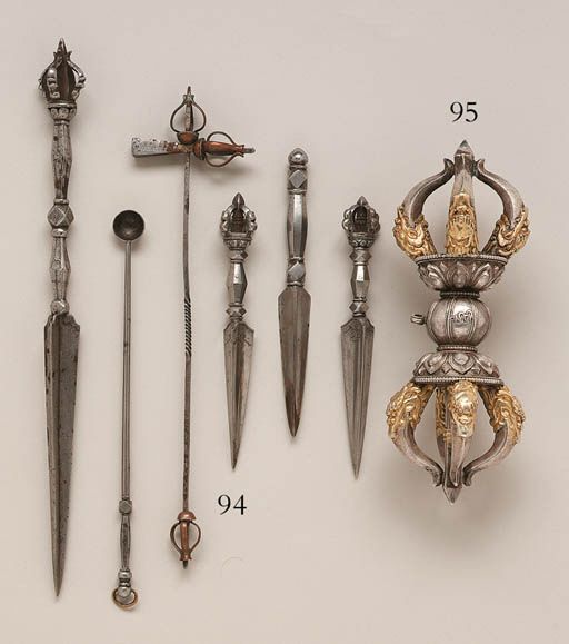

Here I bring on all the architectural details in picture form onto this thread from the other Sri Lankan epic.

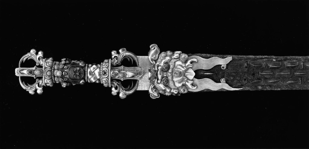

First I make reference to #176 above where the weapons from arts of the Muslim Knights are shown thus a search light is shining on the South Indian weaponry shown there by Jim from
Quote"Arts of the Muslim Knight", Furasiyya Foundation, 2008 (p.206, #197). It is listed as Deccani, probably Bahamanid dynasty and of 15th century." Unquote.
Viewers may see a degree of Religious linkage from the adjacent Buddhist cultures and in particular from the main source India. Others may see the fact that The Great Buddha himself is said to have visited the country and that although there are different types of the religion they flowed like a tide in and out with large periods of time in one form or the other.

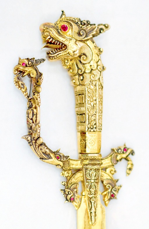

What the pictorial below shows is the obvious transition of architecture on the Kastane from Southern India and also mirrored from Tibetan weapons either direct or bounced in via Indian form.

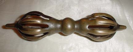

The quillons are probably not quilons per se...They are Vajra and important tools and insignia in the Buddhist religion said to have been carried by The Great Buddha into Tibet personally and since the Kastana we know ...was never a Battle Field weapon these thunderbolts or diamonds that they represent were never meant to be for fighting but as badge of rank or court swords. For this reason it matters little that the finials comprising dragon heads are invariably closed on the blade in the narrowed throat and in direct contrast with any European type.
The deity comprising the main hilt is powerful represented by a Lion or Makara, hand carved and studded with precious stones.
The Tail represents another revered creature; The Peacock.
In the handguard we see several creatures including a Humanoid faced crocodile, probably Kurtimucha, in the Robert Hales picture at left where he also notes the provenance of the middle picture as Mysore or Madras.
Other Deities spill down the hand guard onto the cross guard area in typical Yali, dragon or monster form.
The scabbard is resplendent in decorative style culminating occasionally in a decorated ball perhaps a pearl or sometimes another zoomorphic arrangement.
Conclusion. Overall I see no external European involvement whatsoever moreover every inch of the Kastane cries out as Buddhist/Hindu style. The majority of influence appears from India thus it is from there that I suggest the form evolved. Tibet also offers strong reflections but it is not known to what extent each is measured. Except for late European blades being refitted to these exorbitant and magnificent hilts I confirm the importance of this sword as being solely produced in Sri Lankan workshops with no input visible from European sources.

Hi Jim,
I see that the image of the Benin sword belonging in the collection of Mister Rainer Daehnhardt makes its millionth appearance. Should i ever realize this picture would become viral, i wouldn't take part in such promotion as, despite the eventuality of its owner being so proud to possess such famous item, he might as well not be so fond of what has been written about him, for every time such picture shows up together with its text, as it comes in the book, it is tagged with a string of rejections in a mode of unpleasant, even caustic, adjectives and connotations, even occasionally based on misinterpretations, not making a distinction between the role of either book neither post author ... notwithstanding the recurrent assumption that the sword description belongs only to the book author and, as personally opined, its veracity being admitedly susceptible of implausibility, as timely quoted such not being an uncommon phenomenon. For i guess that, the only way for this picture appearance to cease being repeatedly tied to the whipping pole, is to humbly discourage its posting.
Old 6th September 2017, 02:46 AM   #180
Posts: 10,860
WOW!
Actually the sword Mr. Daehnhardt has in his book is a most valid example, and serves well to illustrate the apparently numerous examples of hybrid or rehilted instances of these very distinct hilts.
Swords are famously known for being remounted, and married in often incongruent assemblies as they are refurbished with changing hands as heirlooms, trade items, diplomatic hybrids or any number of cases.
It seems to me that this sword is likely one such example. Every author has examples or references in their books that may be reconsidered in later times as new evidence or examples are found. Actually every author hopes and expects to be corrected as others work forward researching their subject matter and text. Most include notices in their forwards in the publication that they are responsible for any errors or material which may be disproven or reconsidered.
Consider that in my case as a writer, clearly most of what I express as comment or observation is quickly critiqued, whether refuted or rebutted and many times even agreed with..either way I think of it as constructive and often helpful in learning much in the manner I describe.
I do not agree that the Daehnhardt example should be censored out of dialogue regarding the Sinhalese kastane, as I have noted it is an example of hybrid in the spectrum of these hilts in other contexts.
The 'Sendai' example of c.1613 in Japan is another example of this distinct hilt form with what appears a 'foreign' blade type. Again, it serves as an example of this hilt in terminus post quem with well established provenance.
