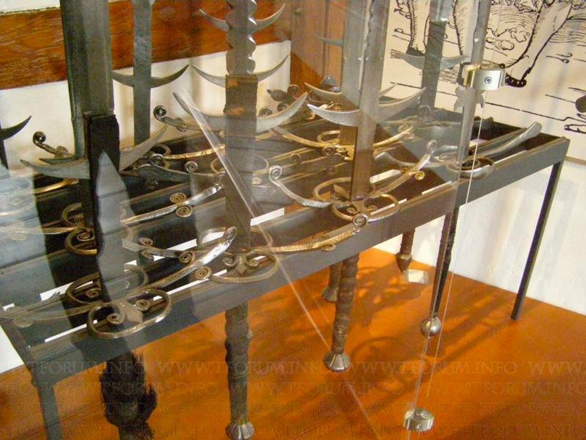

Two-handed processional swords, late 16th c., including flambergs, on exhibition in the Imperial Castle (Kaiserburg) Nuremberg; inaptly presented against a woodcut of early-16th c. date depicting much earlier Landsknecht swords.
m
