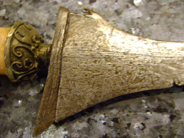

Old 20th June 2012, 01:05 AM   #94

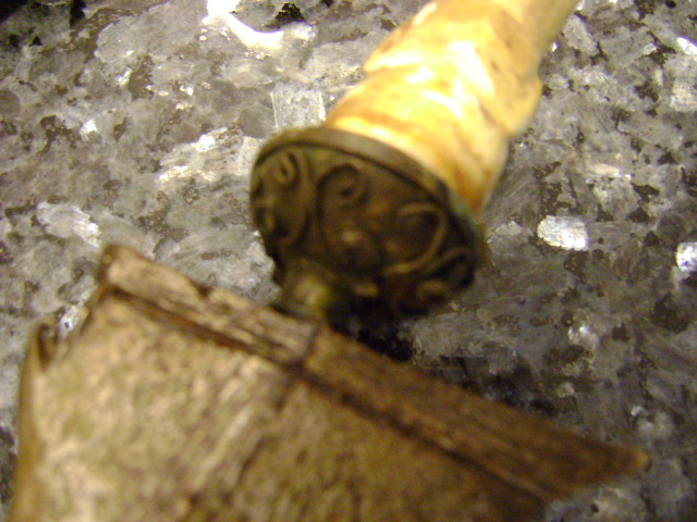

Dear Mr. Maisey,
Many thanks for offering your help.
These are the best pics I could take. Hope they are OK for your eye.

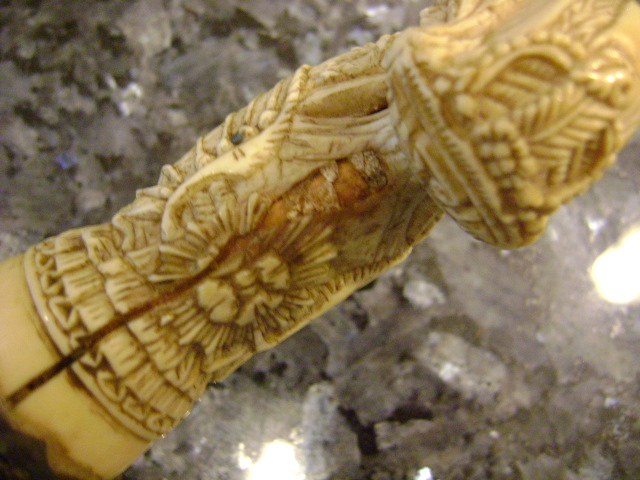

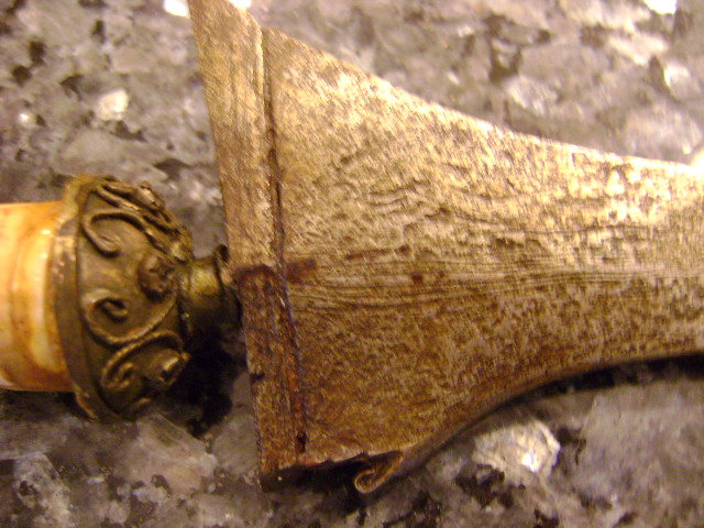

Old 20th June 2012, 01:06 AM   #95
Keris #2
Old 20th June 2012, 01:15 AM   #96

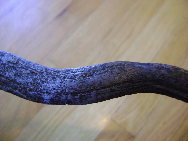

Keris #3
Old 20th June 2012, 01:17 AM   #97
Keris #3 additional pics

Old 21st June 2012, 09:12 AM   #99
Posts: 7,255
Post 94
keris is probably Madura sepuh (old Madura), dress Jogja branggah ( or ladrangan).
Tidy it up a little bit and this would be a pretty decent keris
Post 95
There is no full length photo of the keris or the scabbard
To comment accurately on keris from photos is very difficult, we need to see the keris full length + close up of the sorsoran (the blade base as far as the first luk), and we need to see the scabbard full length. Additional close ups can be useful, but without those full length pics we're only making even wilder guesses than are usual.
Here is my wild guess for post 95, which I might change if I see a couple of full length pics.
This is a dealer's montage. The top of the scabbard (atasan) is a Solo gayaman, but the motif on the pendok is a Jogja motif, I can't see the full pendok, but my bet is that its a Jogja pendok. We do not fit Jogja pendok to Solo scabbard. The hilt looks like some sort of Peninsula or Sumatera or Bugis hilt, I do not have sufficient knowledge of variation in this hilt style to comment accurately. The material might be shell, which would make it pretty desirable. The cup under the hilt ( I hesitate to call it a pendongkok) is totally incorrect, it doesn't belong here. It was probably made in East Jawa.
The keris itself (ie, the blade) looks like it might be pretty OK. From what I can see I'm guessing Pajajaran. Clean it, stain it, give it a decent set of clothes. If the hilt is shell, clean and mount as a cabinet piece, by itself.
Post 96
Another dealer's montage.
In spite of the crack this is a nice hilt. The hilt cup does not belong with this hilt. I'd suggest that you demount the hilt, give it a good hand rub with baby oil, and mount as a cabinet piece. Hilt is Madura of course, but it displays both Sumenep and Pamekesan characteristics, I'd need to think about this a bit before I committed myself on origin.
The atasan of the wrongko looks like somebody's idea of a Palembang atasan, the pendok is Central Jawa it has a Jogja motif, might be Jogja, might be Banyumas, need to see it full length, but whatever it is it does not belong with this scabbard or hilt.
The keris itself is possibly old Madura ( Madura Sepuh) and not bad.
The two keris in posts 95 and 96 should be stripped of their dress and given new decent quality scabbards and hilts. They are worth treating with a modicum of respect.
The keris in post 94 just needs a little bit of tidying up.
I do appreciate that you made an effort to give me pics I could work with Ariel, but those full length shots are essential.:- full length blade, full length scabbard, close up of sorsoran, camera at 90 degrees to subject; hilts can be difficult, because a Jogja hilt and a Solo hilt can easily be confused if the side profile cannot be clearly seen, with figural hilts we need to be able to see the front and side, possibly a front three-quarter shot is the most useful.
Actually, these three keris are nice start for a collection. It is not at all unusual for the various component parts of a full keris to be mixed as two of yours are. About the only way to avoid this is to buy from specialist dealers, and even then some incorrect mixing can occur, mostly to satisfy the whims of buyers.

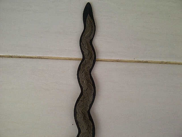

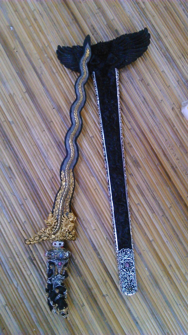

Just to revive this thread on keris kemardikan I'd like to share a photo I came across on Toni Junus' Facebook page.
This keris won the SNKI Keris Award for The World in 2010.
Name: Kanjeng Kyai Singa Kura
Dhapur: Singa Kura Bener
Pamor: Jarot Asem
My main attraction to this keris is due to its slender shape and intriguing pamor, which is at the same time simple and complex. I think I would have liked the blade better without the singa-kura gandik, but that's personal preference. Does anyone know if there is any symbolism behind the lion-tortoise combo or is it just for show?
Hopefully other members will have more interesting modern keris to share.
Bjorn is offline   Reply With Quote

Unfortunately I can't give any insights on what the animal characters represent or symbolize. But I agree, beautiful pamor and a complex one at that. A Balinese Empu (Pande) recently finished creating a Keris with this fine pamor on my request. I couldn't be happier.
shadejoy is offline   Reply With Quote
Old 29th October 2014, 02:37 AM   #113
Posts: 7,255
A Balinese pande made a keris with this pamor?
Incredible!
The lion-tortoise on the keris shown is purely for artistic ornamentation, however if interpreted in older representations, the lion can be associated in Hindu belief with warriors, in Chinese belief they are a protective motif.
Prajapati, the First Being became a tortoise to have a child, and he supports the universe. I think that the elements of the universe also are carried by his body --- not certain on this.
Later, Wisnu became a tortoise (Second Incarnation) so his shell could support Mount Mandhara.
Both these motifs are loaded with symbolism, its just a matter of how they are interpreted.

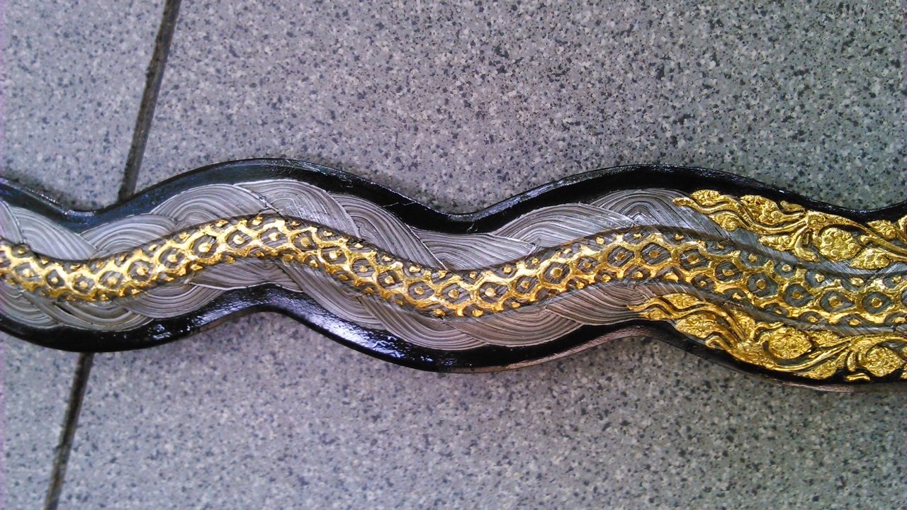

Interesting interpretation.
Yes, Pande Made Gde Suardika.
It took a little over 11 months and as strange as it may sound (..or careless, depends on how you look at it) never once did I ever communicate with him in person during the time.
I very much agree in one of the old threads implying that Kamardikan Kerises seldom get much appreciation as what they truly deserve compare to old Kerises.

So Shadejoy, this keris that you have shown us is the product of Pande Made Gde Suardika ?
Superb work, and an immense advance upon the work that I have previously seen attributed to this maker. Truly incredible.
Thank you very much for permitting us to see this keris.

I've also seen the work of several other makers from Bali, as well as the work of most makers from Central Jawa who have worked from the mid-1970's through to the present time, in addition I have seen the work of a great many makers from Madura. I have no documentation of most of these makers. That's not what I do, and frankly, I find it completely unnecessary. However, I have spent several months every year in Jawa and Bali for over 40 years, I've seen a lot of makers working, I know several of them as personal friends, and 30 odd years ago I was taught by a couple of the legendary ones.
What amazes me with this keris you have posted photos of is that Pande Suardika could have created this pamor. It is an extremely complex pamor, the Balinese makers in general are known more for the excellence of their carving, rather than their ability in complex pattern welding, and this pamor is about as complex as it gets. For a pamor like this to come from a foundation of next to nothing is purely incredible. The blades I have seen that were attributed to Pande Suardika were very simple mlumah pamors, not highly complex pamors like this one.
Additionally, Pande Suardika is known for his commitment to the creation of blades with a spiritual content, he is not known for creating blades as a commercial undertaking, but rather for creating blades intended for use as a pusaka. His blades are usually quite heavy, and he has a reputation for very detailed work.
However, if I had been asked who I thought might have made this blade Pande Suardika would not have entered my mind.
This keris is an exceptionally fine piece of current era work, but it stuns me that it was produced by Pande Suardika.

Top artistic piece (similar to those displayed in the Neka museum) but frankly this very nice pamor pattern Jarot Asem looks strange to me, as if it was applied on the iron and not traditionally welded, look how perfect the edges are?
Old 30th October 2014, 02:21 PM   #119
Posts: 6,441
I agree Jean, the pamor looks somehow ....odd .

No, I'm not implying I've seen blades attributed to him, I'm stating that I've seen blades attributed to him.
Good for you.
Several months ago (or probably last year) I saw one article mentioning him being commisioned to create a Pusaka for one of the Puris (Temples) in Bali. The Keris was indeed quite simple. I think the pamor that I saw was Pedaringan Kebak, a common pamor in my opinion.
You are right, Pande Made Gde Suardika doesn't have 'inventory'. I certainly consider the Keris that I showed you as Pusaka. But whether the Keris has spiritual content or not is a subjective matter. For me, I couldn't help to admire Bli Pande for his dedication and his disclipine in preserving the esoteric values in Keris-making. Moreover, I wouldn't know a thing about spiritual plane as I am not a spiritual nor religious person. But I don't deny the existence of other form of being that are unseen.
It is also quite interesting to realize once I got the Keris in my hand. The Keris seems to have darker blade compare to Javanese Kerises that I had which brings more contrast to its Pamor. It is without a doubt heavier than any Kerises that I have come across in my possesion and it could be for many reasons. But I do have a perspective that in general, Balinese Kerises tend to be stockier and heavier than Javanese Kerises. But anyone can dispute it as I have also seen a Balinese Keris that is small in size and comparable to Javanese Keris.
Thank you very much Alan and Jean for your appreciation. I am glad I can share this with you.
