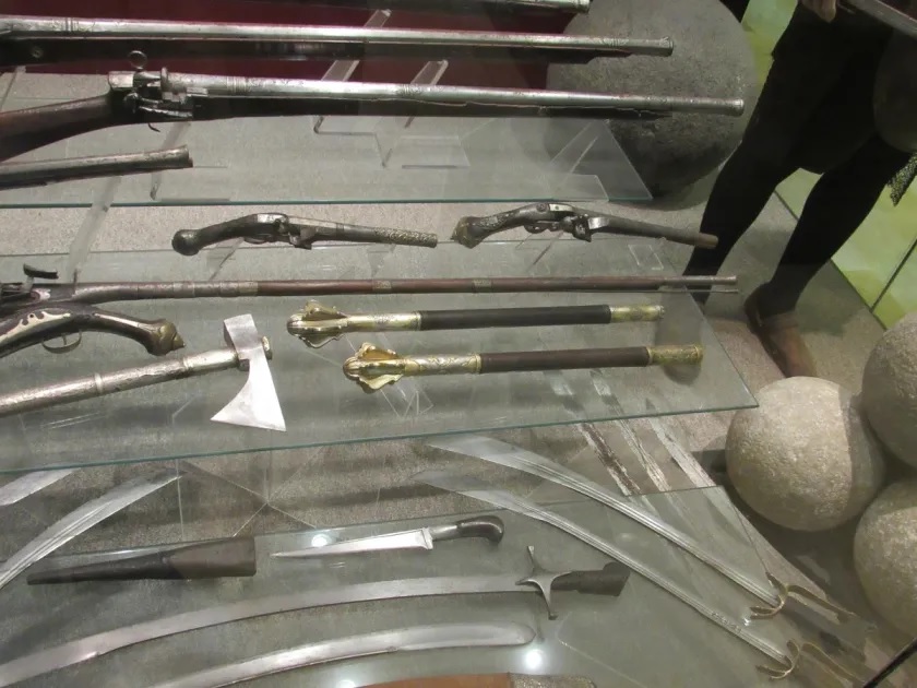

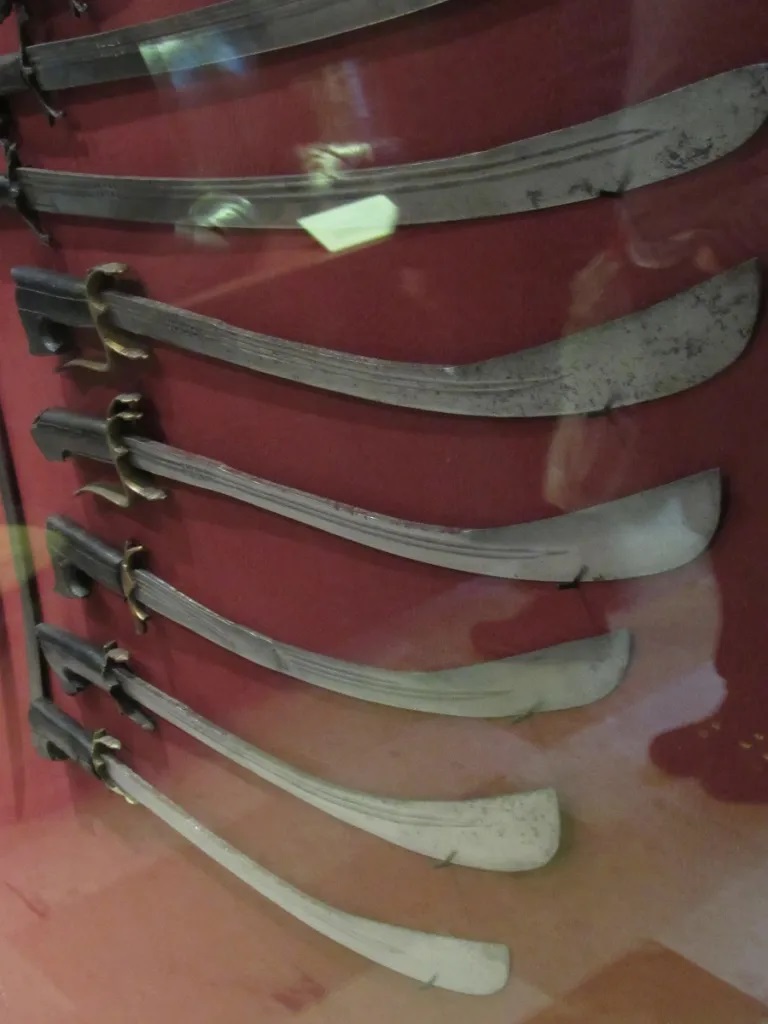

The Yemeni hilted nimcha has no markings. This type of blade, with a large yelman seems to have been quite popular with Barbary pirates. The Grand Master's Palace Armory in Malta has a collection of swords taken from Barbary pirates and many of them have similar blades. I suspect at least a portion of them were made in Europe.
