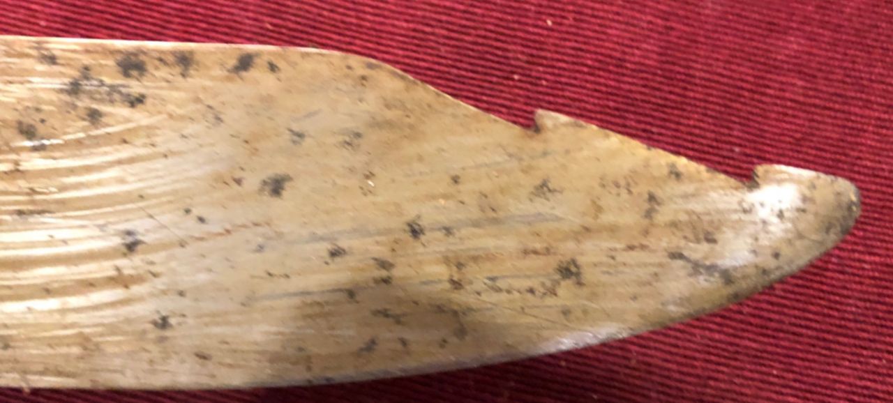

Originally Posted by corrado26 View Post
Here come two fotos of a Prussian husar sabre with a very faint notch at the back of its blade - maybe it is nothing else than a light damage....
corrado26

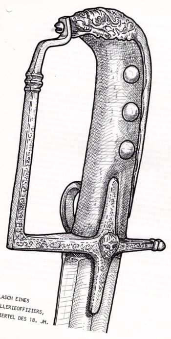

When I first noticed the 'notches' in the drawings of Austrian swords in the Wagner book, I thought at first the same thing, must be damage.
But then as I looked at the other drawings (about 6 if I recall), they all had the same notch....then in reading the text, I found that Wagner had surmised these 'notches' were for aggravating wounds.
I checked the references for the source weapons Wagner had used, and wrote to the museums noted to acquire actual photos of the subject weapons.
In each case, the photos revealed that the notches were indeed there.
In the case you have posted here, the blade has TWO very shallow notches. These clearly would serve no utility purpose, and why two?
It can be seen they are deliberately placed.

My example of this type saber has the Hungarian arms but is not marked as to maker, and does have the same notch.
I personally do not think these notches have a utilitarian purpose, but perhaps something more symbolic. In the time researching these notches, there have been no satisfactory explanations to this curious feature on many Austrian swords.
Wagner states it was to worsen wounds, however, despite sounding viable, the truth of the matter is from what I found, this may cause the weapon to become lodged, thus disarming the user. Also, how would this apply to such a notch on the blade back of a saber? a cutting weapon.
Maybe the notch was a perceived advantage when used in a falso dritto or a montante sotto mano? The second cut if would tend to gut or emasculate an unarmored opponent. At the top of the stroke it could get to the face and eyes of an overextended opponent. With shorter blades it has been taught when the edge is just above eye level and move your blade down your opponent again. I don't know if these sabers have that kind of agility. The notches on cane cutters were used to bring an object to you. Either way it would appear to me to have created a natural place for the point to snap.
Very well placed notes, and actually I did contact several 'Masters of Arms' to ask for their opinions on this 'notching'. They honestly had no idea what useful purpose these would serve (I think I still have the letters but its been nearly 20 years).
The note on the potential for weakening the point seems reasonable as well.
This would be the case regardless of what the intended use was.
The idea of holding a cooking pot over a fire seems unlikely as well, as the blade could be damaged by the heat as previously noted.

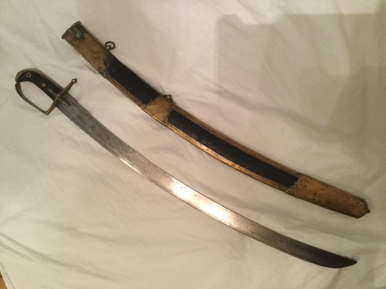

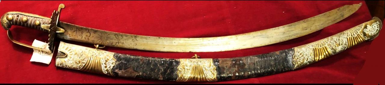

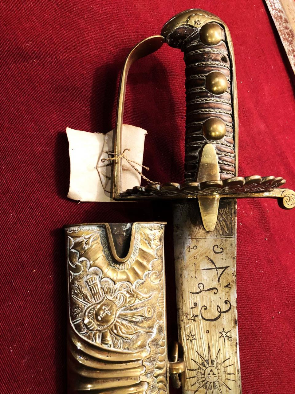

Hi Jim, Thank you so much for posting photos of your interesting pandour sword! In fact itÂ’s the first time I see what it really looks like, as I had only seen WagnerÂ’s drawing of it before. ItÂ’s a very interesting sword for what was an interesting corps to say the least. ItÂ’s amazing that it also has the curious notch. I noticed that your blade appears to have a second fuller near the back towards the tip, which is also unusual.
The Habsburg empire was a ”Hausmacht” or a dynastic power consisting of a number of separate countries united by their common crowned head which was the Kaiser: By the Grace of God Emperor of Austria, King of Hungary and Bohemia, Dalmatia, Croatia, Slavonia, Galicia, Lodomeria and Illyria; King of Jerusalem, etc. So the Kaiser was Emperor of Austria as well as king of all these other lands in a personal capacity. When he was removed from the throne after WWI (he never formally abdicated) the empire naturally disintegrated. There was an institution which was the Imperial and Royal Army (kaiserlich und königlich) which operated in the whole empire, and then there were national armies like the Royal Hungarian Home Guard (Honved) which existed in parallel. Famous corps like the hussars and pandours originated from the Hungarian lands (pre WWI borders) where they resisted Ottoman expansion into Europe. So they often used local Hungarian insignia rather than the Imperial Austro (-Hungarian) ones on their uniforms, arms, flags etc. The imperial army probably looked down at them as not much better than brigands, but they impressed the rest of Europe when Austria used them in the 30 year war and onwards. The Holy Roman Empire was just a loose confederation of many German states, of which Austria was one.
Hungary was almost annihilated in the Ottoman wars and much of its territory devastated and occupied. So itÂ’s not strange that there wasnÂ’t much manufacturing going on in those war torn lands. I have read that there was some production of blades in what is now Slovakia (part of Hungary pre-WWI) which has mountains and iron ore. But as you mention, much was imported.
In terms of the notch on the blade I wouldnÂ’t be surprised if its function was indeed what Wagner stated. The war against the Ottomans was desperate and quite cruel. Many of the soldiers stationed along the frontline in what was termed the Military Frontier were either defending their homes and families there, or were displaced refugees from lands already occupied by the Ottomans. So weapons were often designed to inflict as much physical harm as possible which is reflected in their dimensions and designs. There may have been certain bravado involved as well of course. As an example I would mention CorradoÂ’s Pottenstein sabre which I noticed has an extremely wide blade (almost exaggerated) which I know was popular amongst the Slavic troops in the Military Frontier (located in pre-WWI borders Hungary) and probably local Hungarian troops as well. It positively looks like a meat cleaver! With regards to Austro-Hungarian silver sabres they do appear from time to time in auctions and seem to have had some sort of ceremonial function as they are obviously decorated at an expense greater than what was normal.
Old 17th October 2021, 10:54 PM   #67
Posts: 10,872
Thank you Victrix!!!
As I noted, the profound complexity of all these principalities, duchies, etc. is so hard to grasp, at least for me. You have done a great job of condensing some of it for my limited comprehension!!
As you note, these irregular troops, known loosely as 'Pandurs' were known and feared for their ruthless character and indeed atrocities. Von Trenck himself was known for this type of reputation and much if not most of his life he was in trouble, even condemned to death for what amounts to war crimes etc.
He in fact was imprisoned and his units disbanded. He died in prison in 1749, and his mummified remains are in the Capuchin monastery in Brno.
Part of the intended demeanor of these forces was a fearsome 'oriental' look, scalp locks, drooping mustaches like mongols, cossacks etc. and exotic clothing along with fearsome looking weapons.
Many of these swords had dramatically profiled blades, large, dramatic curves, etc.
I still think that the notch was for perhaps that type of implication, to instill fear in accord with thier brutal reputation. In actual practicality, the notch would have been a hindrance. In most writing I have read on the serrated edges on blades, it is noted that this is the case.
The dreaded sawtooth bayonets of WWI for example:
Allied troops thought these were to worsen wounds, and were horrified at the thought of this.......any soldier found with one of this was dispatched on sight.
Psychological effect in warfare is key, and this kind of lore travels fast.
Imagine the tales of these wild forces, who deliberately 'hooked' their blades to eviscerate their victims.
It seems to fall neatly in place with the dreaded 'image' of the terrifying Pandurs. That reputation prevailed..........and into the next century, blades were adorned in hubris with the image of the Pandur. Sort of like exaggerated Bowie knives with 'Remember the Alamo'.

from my understanding these notches or "claws" are indeed primarilily intended to assist in collecting items from the ground, cloaks, coats, banners.. haversacks ect..
and then seocndary by some that it will produce a worse wound or a greater chance of a deep wound by an accidential swipe with the back of the blade. (for example you thrust overhand but miss and the person passes to the back of your sword sliding against the back edge and spine. some of these weapons have little back edge and would cause little or no harm..
and thirdly to make a bigger wound when withdrawn in a thrust.. (some notched swords look to be styles that can hardly thrust and some notches are not very sharp at all)
i think they serve all three functions and in soem cases one or two of the three.
but i suspect picking items from the ground is the main function,
these also i imagine were ground off swords by armourers and so we see it less often.
pickign items up with you sword is not an unushal activity and you can see footage fo cossacks doing it too.. a lil rough seciton would make it much easier.. poeple could and maybe did carry a stick or a hook as well but.... your a skilled horseman.. dashing and brave not a guy with a stick with a hook in it rummaging for loot...
the mongols, kalmyks ect had hooks and spikes on their spears for this function, as well as pulling tents down and dehorsing poeple for capture..
id imsgine thier loot sacks were filled with shiny things and gooddies with these hooks, id much rather a hook on a spear. but if you have a sword a nice little gooddie hook would be handy,
i think the hooks at the back of the blade as a weapon seems misguided, almost like a meme.. one person said its good so all did it. which is pretty common in military realms.
as remember there is much better things for this.. the yelman on the original mongol and turkic swords is exactly that, a broad blade to alow a deep destructive wound on the thrust an advantagis unintentional cut with the back of the blade in an overhand thrust, later it becomes decorative in more curved blades.
one would have been wiser to order a blade like that. but as they were limited to these issued blades with blades that didnt have these properties they modified them with barbs to cause some harm, if you were stuck with it it would indeed make a bit of tearing on the way out.
as to the blade catching, its not likely.. it will just pull free as if nothing happened. the notches are small and would just tear the target, would woundnt notice any difference.

Ausjulius, you have put some deep thought into this and I appreciate your perspectives. However, I began studying this curious phenomenon back in the 90s, and reached the museums holding the swords Wagner (1967) depicted in his drawings. I wanted to confirm that these notches did exist in the actual sword blades, which they did.
In my communications with all of the officials contacted, none had any adequate idea on the notches, in fact seemed surprised there was any attention to the feature in the first place.
The only responses did somewhat echo Wagner's surmising these were to worsen wounds etc.
In various conversations with masters of arms in various regions, none of course had any thoughts on the case which was outside the bounds of regular fencing.
The only cases I found, as I have mentioned in my previous posts, these ONLY occurred on numerous example of Austrian swords, and this was by no means a usual or common practice of notching. The only exception I found was the suggestion of a couple of French hussar sabers having this. It should be noted that French hussars often closely followed Hungarian/Austrian in the 18th c.
So if these notches were such a prescribed practice for utility, worsening wounds or such pragmatic purposes.......why not on ANY other swords of ANY other countries?
Hooks, barbs etc. may be common on axes, polearms but NOT the kind of thing you would see on a standard combat side arm like a sword.
The notches are too shallow to effectively hold things picked up from the ground, unless perhaps to snag an item of clothing or material.
Why would a horseman compromise his blade for such nonsense?
The 'yelman' was NEVER intended for thrusting or any such purpose with the blade. The Poles called this feature colloquially 'the feather' , and its purpose was to add weight and momentum to the slashing cut. This has been made clear to me by sources who were Polish military history authorities, and the same purpose seems logically applied to other blades with this feature.
Sword 'catching' features are typically presumed as pragmatic explanation as in actual combat, such a 'catch' would seem almost surprising and coincidental.
In the thrust, which in combat was nearly always fatal, why would a wound need to be worsened, and with the potential of the blade becoming lodged in the victim?
These are just the views I have come up with in the years I've studied this, but I really appreciate input and exchange of ideas. Typically interest in this has been nominal at best, so thank you.

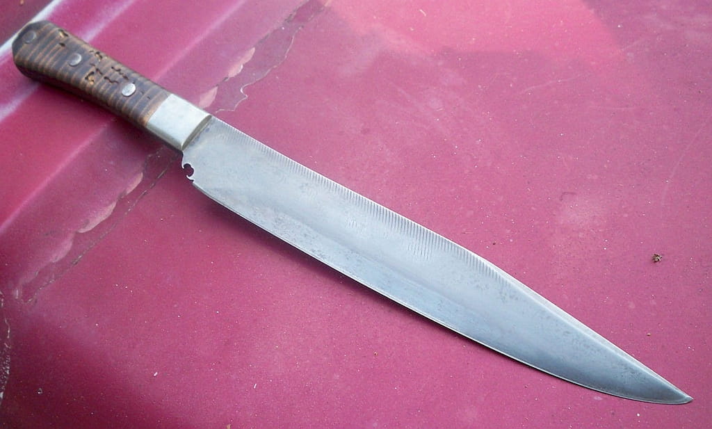

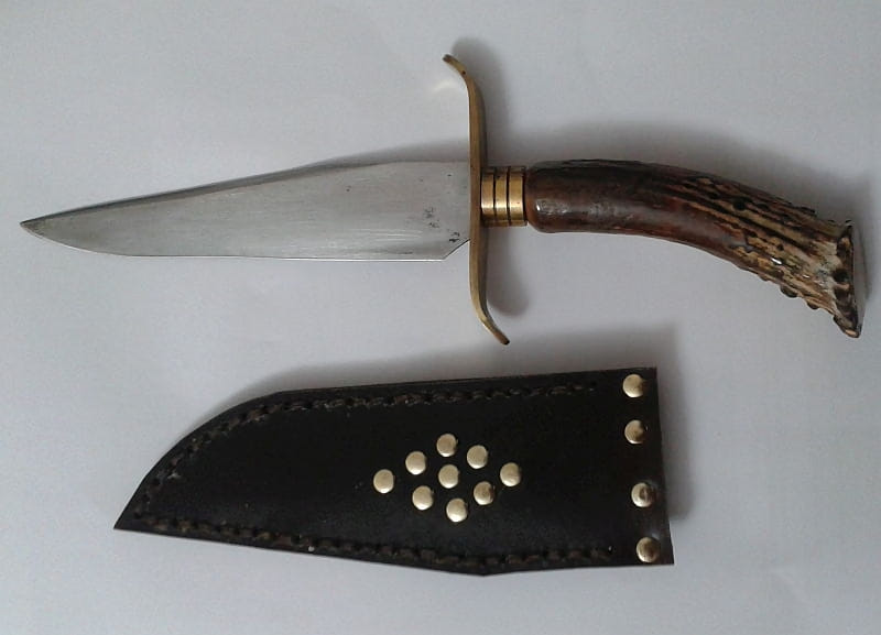

Since there was no illustration of the Spanish Notch:
The 'Spanish notch' is another one which came up in my research years ago (now I really want to find these notes!). It was in an article in a magazine around 1979, and I cannot recall the authors name. No satisfactory conclusion was ever found but it seems these notches on the back of the blade were on 'Meditteranean' knives. These were typically used aboard ships by sailors, who used them of course as weapons in the expected knife fights among themselves. It was from these that the Bowie brothers learned the art of knife fighting, and it is believed that they were ancestors of the fabled 'Bowie' knife.
I was told by a blacksmith working in the James Black smithy in Arkansas, home of the 'Bowie', that Black always 'notched' his blades. These had no purpose but were a vestigial nod to those early knives, mostly Spanish but many French ( prevalent in Louisiana of course).
Originally Posted by From wiki:
Some Bowie knives had a notch on the bottom of the blade near the hilt known as a "Spanish Notch". The Spanish Notch is often cited as a mechanism for catching an opponent's blade; however, some Bowie researchers hold that the Spanish Notch is ill-suited to this function and frequently fails to achieve the desired results. These researchers, instead, hold that the Spanish Notch has the much more mundane function as a tool for stripping sinew and repairing rope and nets, as a guide to assist in sharpening the blade (assuring that the sharpening process starts at a specific point and not further up the edge), or as a point to relieve stress on the blade during use.
A picture is worth a ....aw, you know...
My 'Fowler' Bowie with the 'Spanish' notch:
I suspect it is just a traditional decorative feature, much like the cho or kaudi on a khukuri, which also has a 'nobody really knows why' reputation. I have other bowies with various 'spanish notches'. I'll add a thought that they were the starting point for sharpening. Which looks like the reason for the very plain notch on my smaller "gambler's" bowie at the bottom.
Old 4th January 2022, 02:22 PM   #75
Interested Party
Interested Party's Avatar
Join Date: Dec 2019
Location: Eastern Sierra
Posts: 535
Interesting. I had always believed a Spanish notch was an indention in a self-guard to help prevent the hand from slipping forward onto a blade. To me the second illustration shows a choil used to prevent the thick and hard to sharpen portion of a blade at the end of the ricasso (which this blade lacks).
I personally have always found the choil more of a nuisance than a help especially if the distal end of the notch doesn't slope towards the point. That said I have been told that large choils are used with big knives to allow fingering the blade to help with delicate tasks. I have heard, and maybe read it on this site as well, that specially shaped choils on some knife patterns help with tasks that are regionally common. I always wondered if the cho didn't start that way, or maybe it is just a linga.
The first example seems to somewhere between all three a notch, a choil, and decoration. I am sorry not to have my own illustrations. I delayed this post almost a week and realized I would never publish it if I waited on pictures any longer.

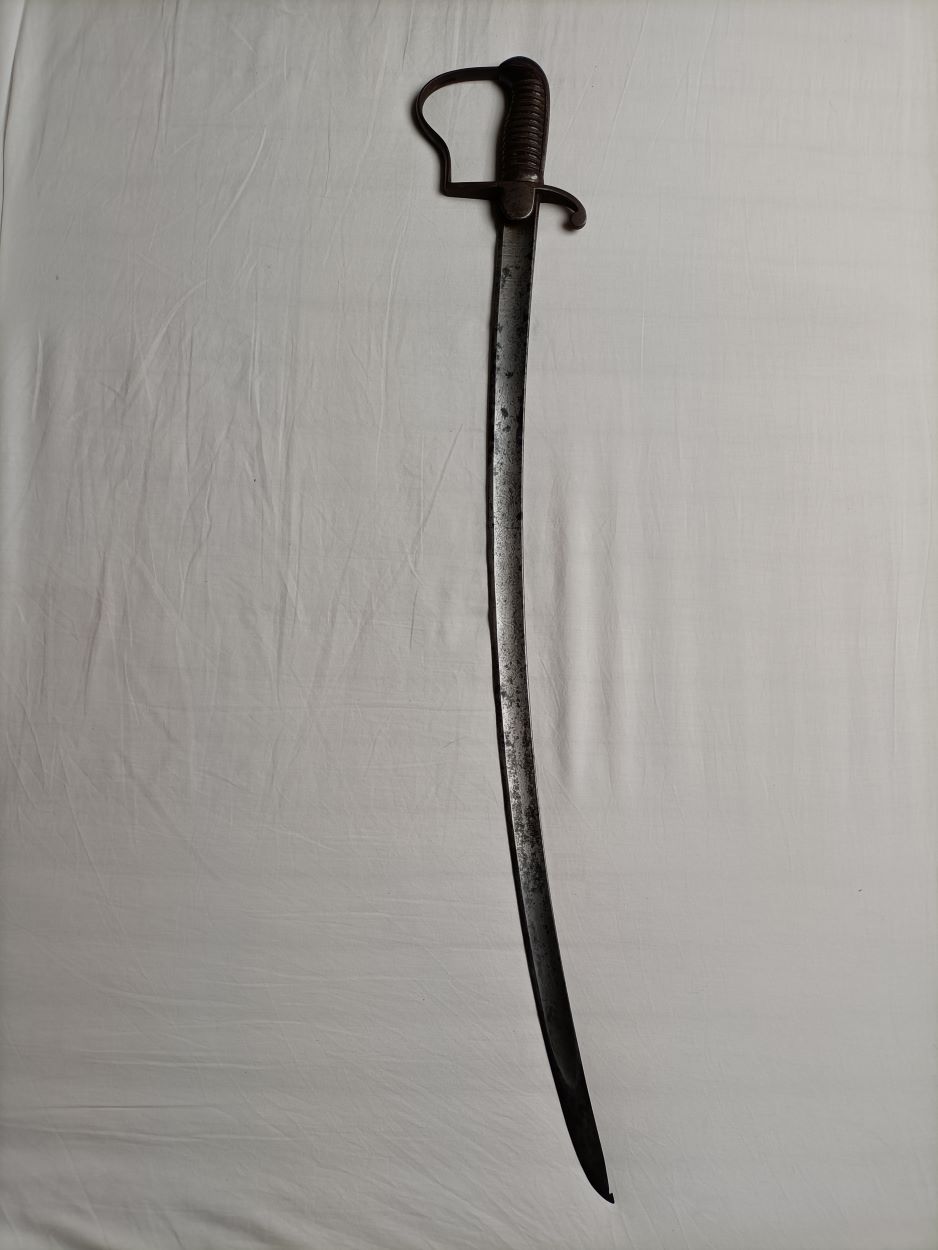

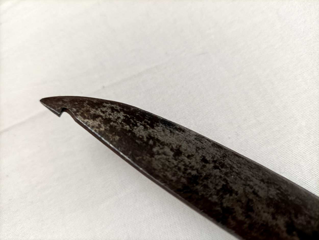

Interesting discussion about the hook. I myself have a Dutch cavalry officers saber model 1813. This one also has this strange hook (see pictures).

Originally Posted by Victrix View Post
the question is whether it's significant that these notches occur on blades which were used by Austrian cavalry during the time of Prince Eugene of Savoy, or whether this is a mere coincidence. Finally I would be interested to see photos of Prussian, French, or other swords with similar notches on their blades to prove that the practice was not limited to Austria.
Here are fotos of a probably Bavarian husar sabre around 1710 with a blade with two notches
Old 12th December 2022, 05:49 PM   #79
Posts: 10,872
Udo, thank you so much for this! I cannot believe I missed these other most valuable entries bv Victrix and Cel7 et al.....and Wayne, well noted on the Spanish notch.....another anomaly of this genre.
I think the mention of the 'swiping back cut' is a most viable suggestion. In some sword fighting the Italians used a diversionary slashing cut termed 'stramazone', which usually was on the forehead. This resulted of course in bleeding into the eyes and rendering the opponent notably distracted, unable to defend properly.
This seems more viable for such a feature than for dramatic wounding, which would be redundant in a thrust.
The notions of these relatively shallow and small notches for picking up items off the ground or for catching reins seem a bit tenuous and unlikely.
Thanks to JT88 for the Pottenstein detail!

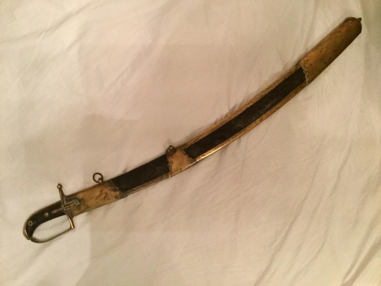

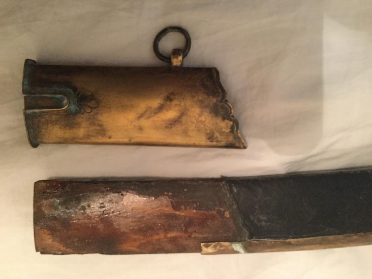

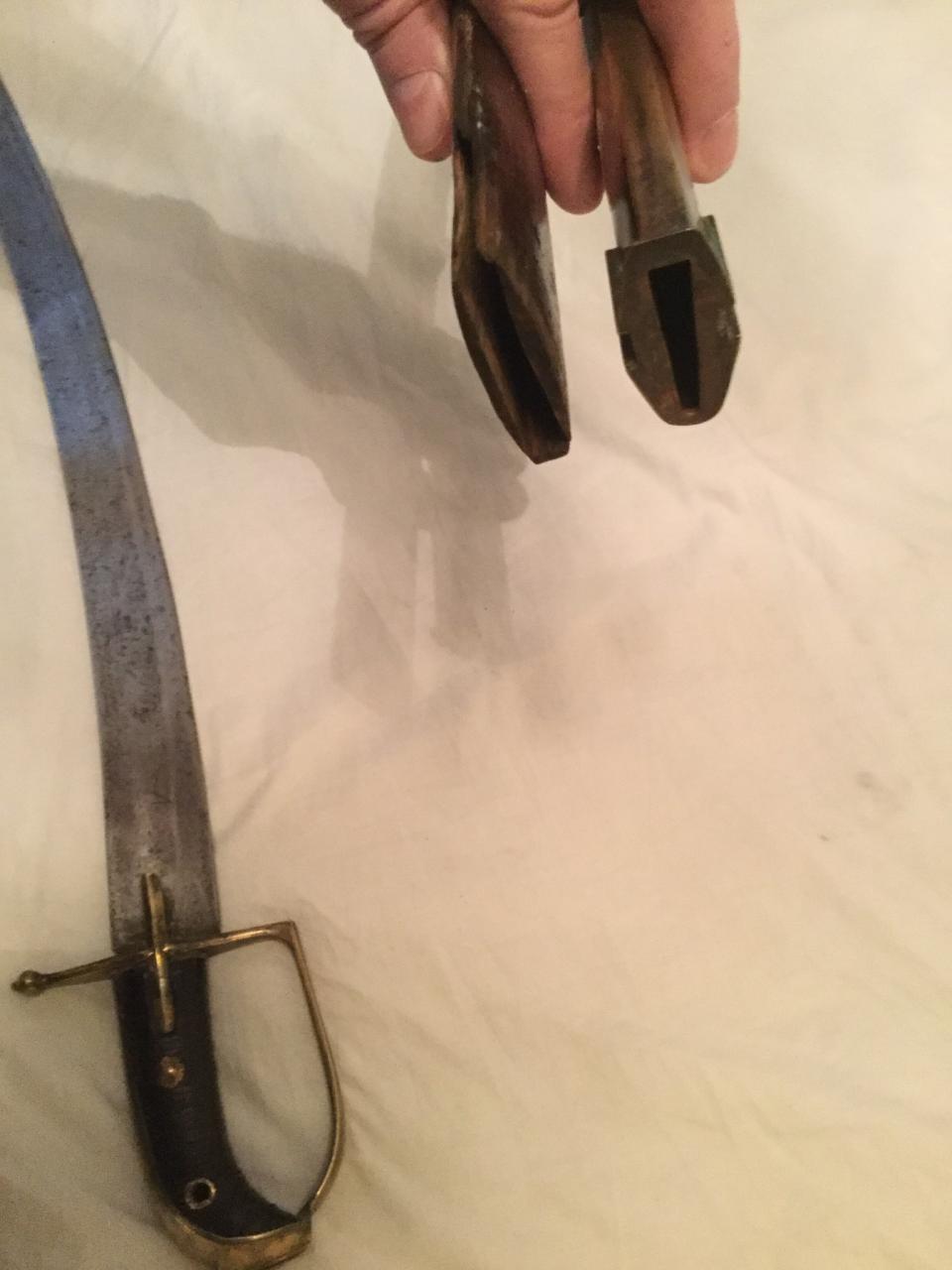

I have some pics of this sabre in an uncleaned state which I thought I’d share with you. I know some of you have reservations about cleaning antique items and that they should show patina to prove their age. In this case I decided to clean the item to restore its former dignity and show its real beauty. The brass also showed green oxidation which caused me concern about possible future damage. The brass mouth of the scabbard is loose so I show you what this looks like (anatomy).
Old 14th January 2024, 02:46 PM   #81
awdaniec666
awdaniec666's Avatar
Join Date: May 2021
Location: Central Europe
Posts: 177
Here are fotos of a probably Bavarian husar sabre around 1710...
Corrado, what makes this specimen probably Bavarian? I am curious about the references. Thanks.

Posts: 1,268
Hilts with these big rivets I only know from Bavarian swords and sabres, so I wrote "probably". See the scans from "Gerd Maier, Bayerische Blankwaffen Teil 1-3"
