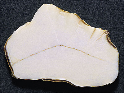

And sometimes a picture can tell much more as written words. The picture is taken from here: http://www.beyars.com/de_elfenbein-f...pferdzahn.html Unfortunately all written in german language.

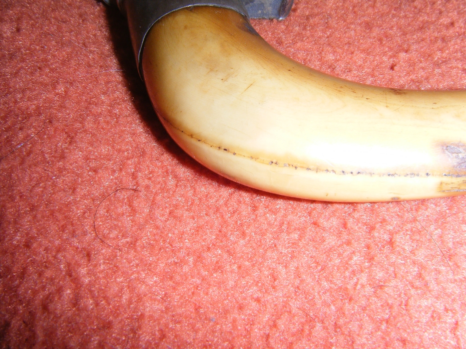

And here for comparison the handle from one of my badik handles. Sorry for be a pain in this matter but I am very very positive about to assign hippo ivory by this "dots in a row".
