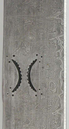

Great contributions on this trusty tulwar, and its great to see Jens' example as a wonderful benchmark. With the comparable markings it would seem that this tulwar is likely Rajasthan regions and the 1870's into latter part of the century seems quite plausible. If I'm not mistaken, the dotted script on Jens' example suggests Bikaner armoury, which is in Rajasthan.
The interesting symbol enclosed by the sickle marks seems to recall the same practice used by European makers on thier blades. There is still a long way to go in trying to understand the more temporal possibilities in many of the stamped symbols on these blades beyond simple commercial or inventory uses.

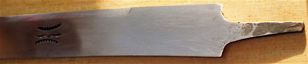

Careful use of the Dremel seems to work very well, I'm always amazed when people take a file to roughly sharpen a blade rather than finish it properly with a steel or a stone. The 'double-sided' steel on your Tulwar is very intriguing, I do of course know of constructing a blade using soft and hard steels Viking, Japanese etc., but I'm at a bit of a loss as to the exact thinking behind wootz/mono side by side unless it is purely decorative or an exhibition of the swordsmith's skill. If you know more! There appears to be two small fullers on one side of the blade only? Very unusual. Thanks for your interest.

Atlantia,
In this case it was easy to get a flat surface with Dremel 511 - I just followed the edge, and as the 511 is not a grinding wheel it was no problem. In Norman's case it could be a problem, but I think that if he takes it easy and does not press too hard, it will work
How many 511's I used? I don't remember, maybe about 6-8.
No I did not finish with anything, I only used the 511.

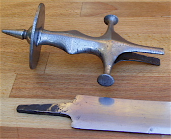

Just a quick update. Using a hot air gun to remove the hilt made it a quick and easy job, five minutes and it was done no mess. The scratches, gouges and grinder marks are so deep in places that on the 6 inches I attempted I had to resort to a selection of files, fine to ultra fine, to make any progress. I also used some fine paper but I've still a way to go. Despite the problems progress is being made. Thanks to all for their input.

Looking good mate, silicon carbide paper on a block and files are the method I've alweays used. Slow as hell but forgiving of mistakes.
Hmmm, hot air gun!! Good call! I might have to do my pair of bikiner Tulwars soon

Markings are always a puzzle (as we know!! ) . These markings are derived from early marks believed from N. Italian blademaking centers and termed 'sickle marks'. These migrated with Italian trade, probably out of Genoa, and were widely copied in other centers, especially Solingen.
The native bladesmiths in India, among others, used interpretations of these markings as a mark of quality, and probably, as you note, applied the mark in whatever fashion they chose. It seems these sickle marks are almost standard on the blades of Afghan paluaors.
Beautiful pattern in that blade!!!

I don’t know if it is a Dremel 511, on the thing is says Dremel Multi, so I suppose that is what it is .
I used abrasive buffs fine 512 S – but before you start I would recommend that you get a handful of these abrasive buffs as the steel is very hard, and the buffs relatively soft in order not to scratch the blade.
