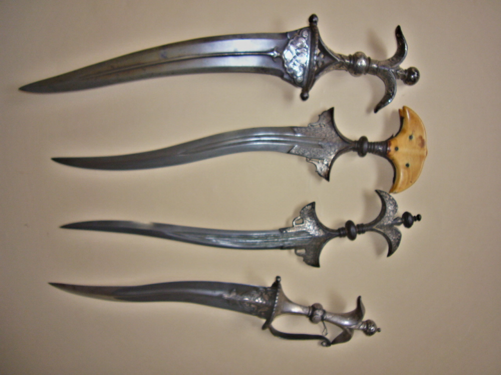

If I may, not to detract from the banter, and following Ian in returning to objectivity, I think possibly this entire situation is partly 'name game' and partly a variant form from one to another.
In Pant (1980) he notes the 'KHANJARLI' (p.179) and that Egerton has wrongly termed several 'kanjarli' (502-505) and pictured with the lunette pommels as khanjhars.
In checking Egerton however, it is as noted, but 500,501 ARE described as Khanjharli, but not pictured.
In searching old posts here, I found one which had a chilanum grouping, but one had a lunette ivory pommel instead of the flared 'arms' type. With that I thought perhaps this is a variation.
As 'khanjharli' does not appear in the index or glossary in "Hindu Arms & Armor", Robert Elgood, 2004............I had not found this, but looking back at the chapter on Vijaranagaram there it was..........p.179:
Chilanum and khanjharli, with notes that the form probably evolved in Vijayanagara with Maratha conquests in Orissa. Orissa, known for elephants may have presented the ivory to be used to form the lunette style hilts. The lunette form pommel is seen in Deccani dagger types (also seen in Elgood, p.175).
The chilanum is typically regarded as a Maratha originated dagger (some suggest Nepal but that may be from diffusion northeast) . While Pant suggests Hindu origins, perhaps that is due to the Vijayanagara examples of chilanum.
Clearly terminology, influences and diffusion of styles add more confusion to the identification of weapon forms and the semantics in describing them.
The image of the Sikh warrior in the original post, may have had the term khanjarli used to describe what we know as a chilanum. ....due to the case noted.
If he was in the Deccan, where these daggers (chilanum) were well known, the term khanjarli may have inadvertantly been used to describe a chilanum, although not the variant 'khanjarli' >..a word known to the photographer or others captioning the photo.
As far as finding a warrior of cultural region wearing these recurved, lunette pommel daggers.....look to art work from Vijayanagara 17th century, and Marathas there.....specifically Orissa, also in Madras, c. 1758, (as per Zarkoe Selo cat. p.276) an example from Arkati.
I hope this helps.

As I have shown in my earlier post, the khanjarli appears to have been a variation of the Maratha chilanum with the ivory lunette as a pommel which came into regions of Orissa in their incursions. This is clearly shown in Elgoods" Hindu Arms and Ritual" as noted with an ivory lunette pommeled example among other 'chilanum'.
This again, is the reason the Sikh in the original post was 'supposed' to have a khanjarli, it referred to the chilanum clearly seen in his sash.
After this research, I was furnished the attached photo from another personal friend, which is a remarkable find to say the least! He indicates this image is from Pondicherry, a location in these regions on the eastern side of India, c. 1838.
Again the plate of Chilanum from Elgood. It would seem that the khanjarli developed into a slightly smaller weapon perhaps leading to the term with suffix 'li' which I think may be a diminutive of 'khanjhar' ?
