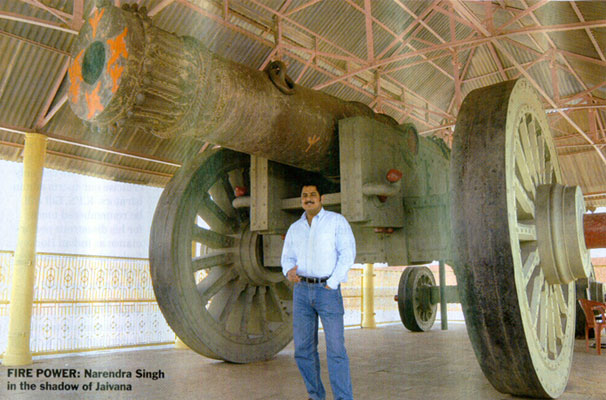

On a different note and back to India, attached a new picture of the Jaivana, this time with the advantage of having Mr. Narendra Singh under it, which gives us a more realistic idea of its dimensions. Note that this is/was tagged, not as the largest cannon out there but, the largest wheeled cannon out there ... which makes a 'little' difference.

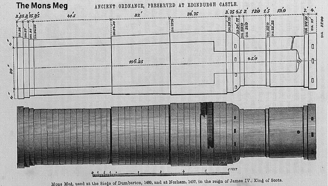

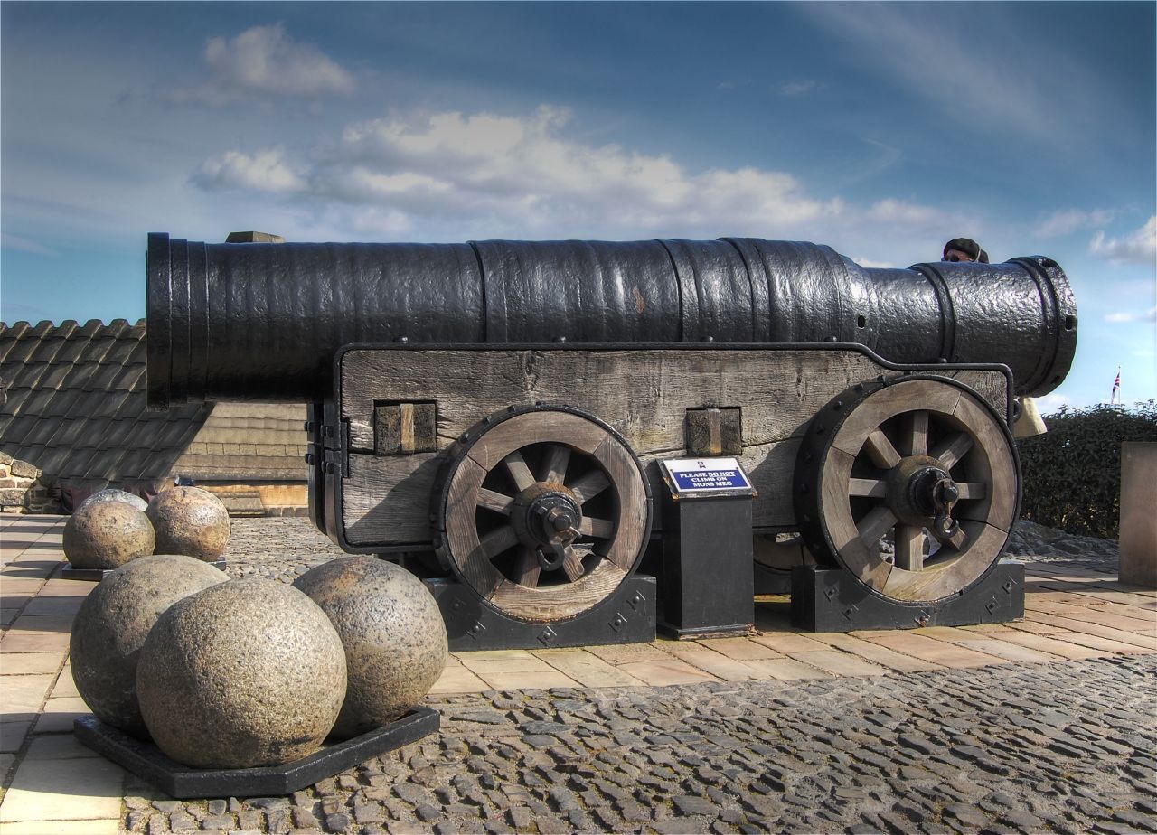

Mons Meg: https://simple.wikipedia.org/wiki/Mons_Meg

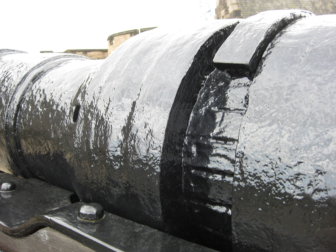

Another Photo broadside, and of the section that failed, retiring the weapon (It's just a flesh wound). Looks like a hoop failure. Apparently range was around 2 miles, balls have been found that far away from it's firing point. note the holes for tools used in re-assembling the screwed parts. Probably a slightly bigger set like the coupling tool also below.

Turning again to the comparison I mentioned in my earlier post of the huge cannon used in the 1957 movie, "The Pride and the Passion", I have found that the Jaivana cannon was actually the inspiration for the 1933 novel "The Gun" by E F Forester which the movie was based on.
Fernando thank you again for the resounding detail and information on the Mons Meg phenomenon, and especially the images associated. I had neglected to thank you for the important perspective suggesting the probable 'political' nature of the unfortunate bursting of the gun in 1680. This discussion had brought forth key insights into the nature of this huge gun with the construction using iron staves...which seems to be the manner of construction of the breech loader deck or swivel guns of 16th-18th c.
I found it interesting that the term 'murderer' was used for Mons Meg, and one form of the deck guns (with stave construction) was also termed 'the murderer'.

Fernando and Wayne, well observed on the sectioning of the Mons Meg is indeed logistically advantageous, but with possible issues as Fernando notes with escape of gasses etc.

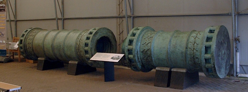

On the Dardanelles cannon Michael Kritoboulus, a Greek dude that wrote the history of the Ottoman conquest of the Eastern Roman Empire under Sultan Mehmet II, describes the (some) foundry details of the cannon but kept silence on the technique used to cast the screw parts.
All we know is that its threads were sharp and clean as they were on the day they left the foundry and, according to naval officers who unscrewed the breech in 1868, it took a total power of 40 tons of jacks and man power to dismantle it.
Although we ignore what tools the Turks used for the operation, providing this ever took place, it is evident that the means used to unscrew it in 1868 were not properly a set of pipe wrenches. Also my theory on the gasses escape meets no case.

Today's engineers and production managers can still marvel at this two-piece design connected by reasonably precise male and female threads, fabricated on a ponderous scale in a pre-mechanized age several centuries past.
I also wonder about the design of the apparatus built by the Ottomans to assemble these guns, and dismantle them as needed. The 1868 effort in Britain undoubtedly utilized the best resources of Victorian-era engineering and manufacturing, but that would be stacking the Industrial Revolution against medieval technology.
Pipe wrenches... yes, Nando, probably not however the underlying principles still involve leverage and rotational movement, generating enouth torque. The rows of circumferential lug-recesses, and very substantial ones at that in thick mouldings dedicated to the purpose, show us that Orban and his Turkish students had thought things out carefully. Barring the discovery of an illustrated Otto treatise on the manufacture, care, and feeding of these monsters, perhaps we can get an idea of what sort of mechanism was used from ancient texts dealing with mechanical subjects, by notables such as Archimedes, Vitruvius, et al. We do know that Islamic scholars of the Middle Ages were avid students of classical works on mathematics and the sciences.
Now, to your question of leakage of combustion gases from the joint. It would depend, I suppose, on how precise and tight those threads actually were. After all, in use the two components would be tightly screwed together much like the breechplug to the barrel of any muzzle loading pistol or shoulder gun. In other words, a "fixed breech". There shouldn't be any leaking of gases if the threading is suitably tight (ignoring for now the inevitable and small loss of pressure via the vent or touchhole).
Looking forward to other breech designs and how designers coped with gas leakage, it seems to me that this became a problem with breech-loading systems, which involved either a removable chamber-piece (the Portuguese berço cannon and its north European and Oriental equivalents being an example) , or a breechblock that pivoted, rotated, or slid in any number of directions depending on the system (Lorenzoni, Hall, Westley-Richards, Dreyse, Chassepot, ad infinitum) This is because with any movable-breech system, explosive gases will trump the best manufacturing tolerances.
Engineers kept trying different workarounds -- the Prussian Dreyse bolt action needle-fire gun (so named for its slender extended firing pin that pierced a paper cartridge to hit the primer) was a notorious gas leaker but its designers provided a chamfer to the barrel stub that fitted a rebated bolt face that directed most of the gas and particulate matter away from the shooter's face -- at least if there wasn't a headwind. The Frenchman Chassepot improved this greatly by designing his bolt action with an obdurator seal on the bolt head, made of a rubber like substance.. Worked like a charm but the gasket had to be replaced after so-many shots and a soldier's kit contained a special spanner and a packet of spares.
Early breech loading cannon with interrupted-screw hinged breech units would leak gas because the threads were interrupted to allow the opening of the breech and these channels negated the sealing action of screw threads (see above). Believe it or not, this principle was explored by several inventors way before the 19th cent. Discovery of rubber and like substances in the industrial age allowed the breeches to be fitted with obdurator seals analogous in function to the bolt gasket on the French needle-fire guns, and voilà , the result was quite functional.
The magic pill that cured gas leakage was the perfection of the metallic cartridge case, which contained projectile, propellant, and primer in a single, fixed unit. On firing, the explosion expanded the case enough to seal the breech effectively, and the inherent sturdiness of this "fixed ammunition" made for all sorts of possibilities in the way of repeating-fire arms, and ultimately those capable of fully-automatic rapid fire.

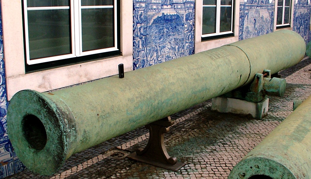

Yet you could browse on an even bigger thing, the Bijapur Malik-E-Maidan. Its specs are impressive; not so lengthy with 4,5 mts but, with a 55 tons weight, 1,5 mt diameter and a 700 millimeters bore.

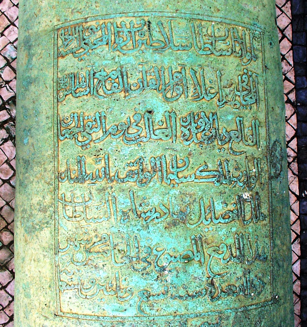

Concerning guns with inscriptions, like the ZAMZAMMA, i can not go without showing the TIRO DE DIU, so called due to its use in the First Siege of Diu in 1538.This basilisk was cast in bronze in 1533 during the reign of Sultan Bahadur Shah of Gujarat
It cast in one solid piece and has no ornaments whatsoever except for some laudatory Arabic inscriptions that can be roughly translated as follows:
From our Lord the Sultan of Sultans of all ages; life-giver of the tradition of the Prophet of the Merciful God; the one that fights for the exaltation of the precepts of the Koran; the destroyer of the arguments of the supporters of wickedness; the one that casts away the houses of worshipers of idols; the Victor of the day when the two armies will meet; heir to the kingdom of Solomon; the one who trusts in the God the Benefactor; the possessor of all the virtues – Bahadur-Shah.
After the defeat of the Muslim forces, the gun was sent to Lisbon to serve defense purposes. Later in 18th century it was sent to the Arsenal in Lisbon to be melted so that the metal could be used to cast a statue of king D. José I. However, a religious scholar noticed and translated the Arabic inscriptions on the gun and, once discovering the historical value of the piece, the gun was spared.
This non wheeled beast weighs 20 tons, measures 6,12 mts (5,90 mts core) with 91 cm width (incl. trunnions) and 24 cm caliber.
It is now on display on the Cannon yard at the Military Museum of Lisbon.
