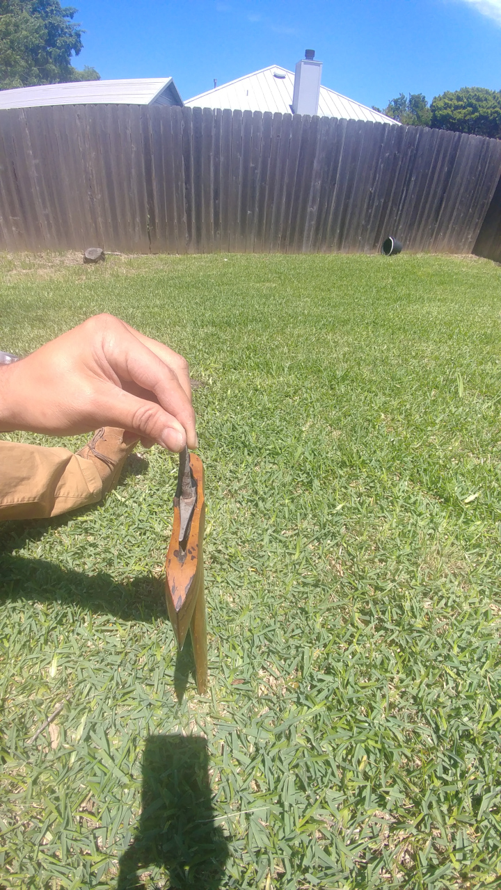

Fit:
QuisUtDeus is offline   Reply With Quote
Old 13th May 2019, 08:51 PM   #38
QuisUtDeus
Join Date: May 2019
Posts: 30

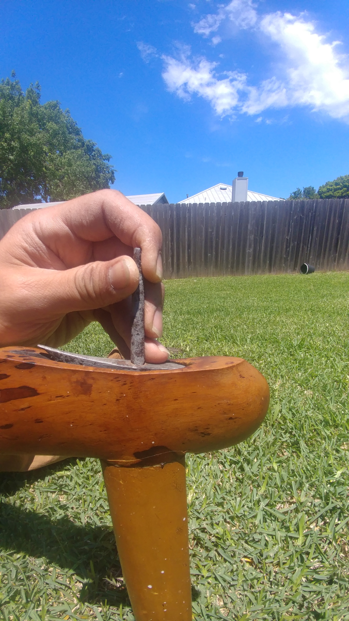

Sorry, I'm still not used to using the forum. This is how the blade fits:

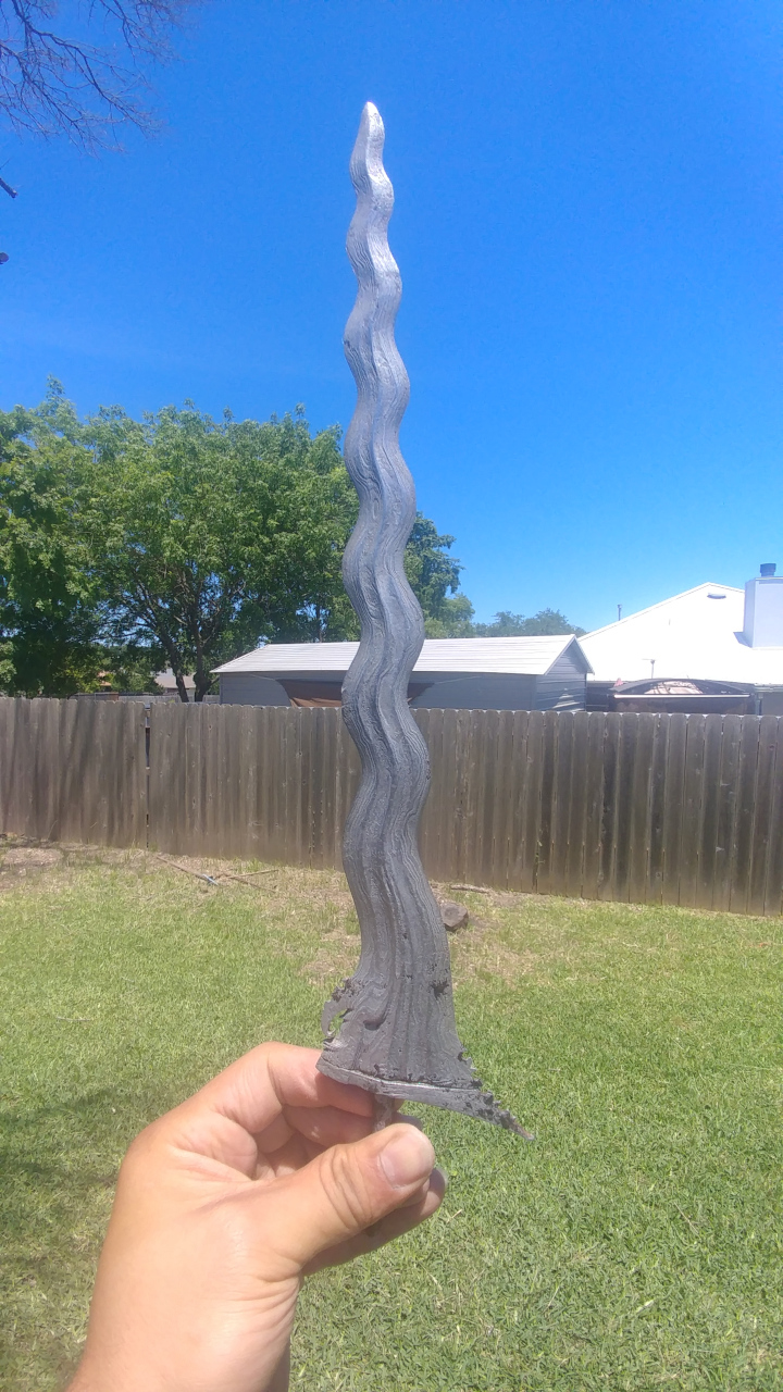

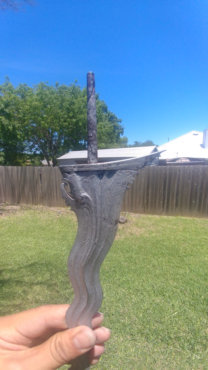

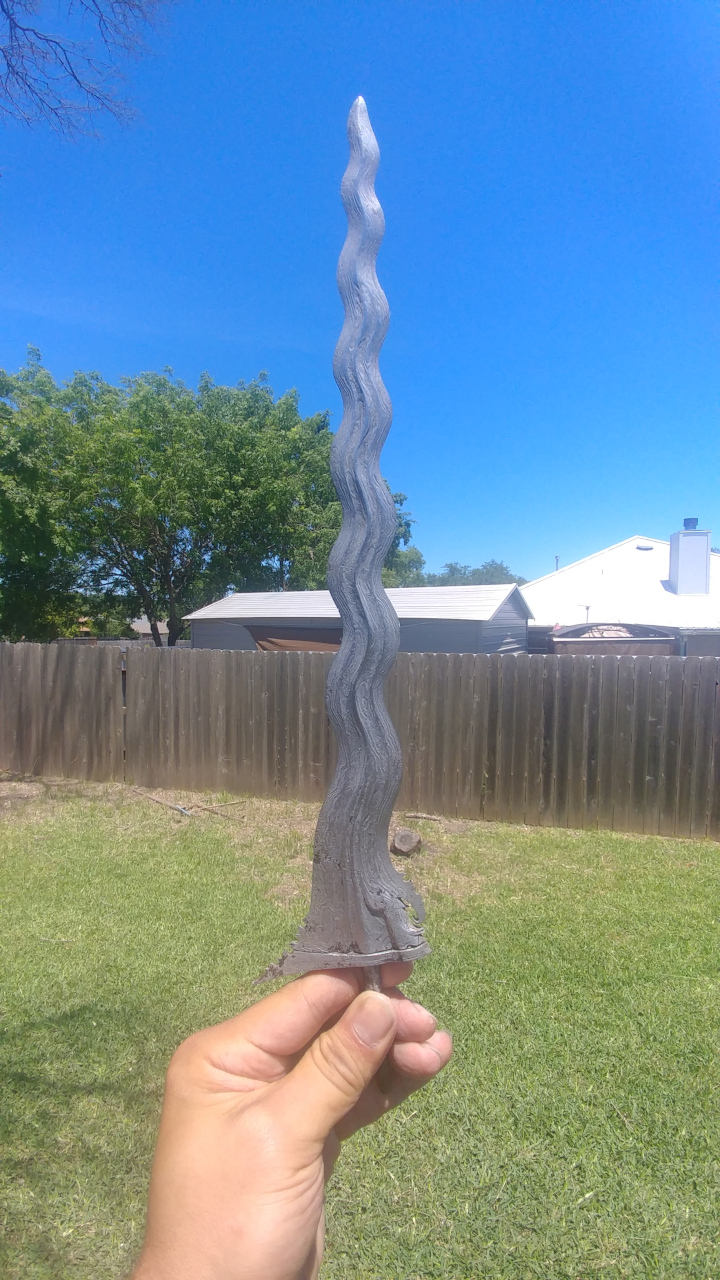

This is the blade cleaned up, for the most part:

Thanks for the additional photos. It doesn't look like you should have too much trouble adjusting the fit to this sheath.
The new photos reveal features that i hadn't quite noticed before, like the fullers that run almost 3/4 of the way up the blade. Frankly, the keris appears even less Lombok in these last shots. This isn't t say that it is not, but i feel like there are some Bugis influence working in there. Of course, that would not be completely out of character in Lombok i suppose. Anyway, certainly not a Bali blade. It does seem to be a nice keris regardless of its exact origins.
I hear that you are strong on traveling with this keris to the Philippines, but i personally would not consider making such a trip with it. You really do risk the chance of running into trouble whenever you cross boarders with it. If i were you i would try my best tp keep the keris in the States and do the work on your own.

Yeah, you're right David, Alan was asleep and right now he's drinking coffee to help him wake up.
There are a lot of questions that seem to have been generated overnight, but there is really only one thing that needs to be attended to first, before the work on this keris can proceed.
I am going to assume that Quis wants the very best job that can be done on this wrongko , so I'm not going to advise any short-cuts, I'm going to try to provide advice that if done carefully will restore this wrongko to a better state than it was in before the damage occurred. This will take time and care.
The first thing to do is to remove the small pieces of wood that have broken away from the atasan or gambar of the wrongko. (top part of scabbard = atasan, gambar)
We do this by taking a couple of small pieces of cloth --- old handkerchiefs are good --- tearing the cloth into narrow strips, wetting those strips, squeezing excess water from them, and pushing them into the mouth of the gandar ("stem" of scabbard = gandar). We then take another couple of strips of cloth, wet them, squeeze out the excess water and wrap around the top of the gandar, over the broken pieces of wood adhering to it.
It might take anywhere between overnight and a few days for the adhesive that is holding the broken wood in place to soften sufficiently to permit it to let go of the broken wood. Check the wood every 12 hours or so, ensure that the cloth is kept damp.
When the adhesive bond softens sufficiently to release the wood, very gently free the broken pieces from the top of the gandar. At the same time carefully and gently use a small, sharp tool to remove the old adhesive, this old adhesive should be soft, so it should not be difficult to remove. You need to remove all of the old adhesive.
When the broken wood is free of the gandar and clean, and the inside mating surfaces of the atasan are clean, set everything aside for a few days and allow it to dry thoroughly.
When the pieces are dry let us have a look at the work you have done and we can move to the next step. The aim is to repair the atasan before we begin the job of re-aligning the blade and putting everything back together again.
