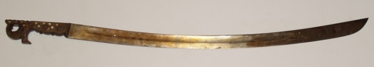

Though fuzzy the label does indeed seem to state that the sword is from Morocco with an English blade, which is the first actual evidence we have that these may be from Africa. The decoration does not look Moroccan. Maybe we can compare these to Mauritanian daggers for better comparison in decoration, assuming these are from Southern Morocco/Western Sahara.
Old 22nd January 2019, 09:10 PM   #32
Posts: 10,860
While Kubur is right, there were indeed early commercial contacts with England, and I have seen Moroccan sa'if s with ANDREA FERARA blades and we have seen later blades by MOLE deeper into the interior.
However as Teodor has noted, the motif and design of hits (the determinate factor as blades were diffused all over) is indeed 'Spanish' and not Moroccan. What is intriguing is the familiar hand 'nock' as seen on Moroccan sa'if.
My thoughts are that these forms, 'Berber' and guanabacoa (Cubano etc) are best regarded as 'Spanish Main' forms (thus Spanish colonial), and hilted in shops in these ports and entrepots in Central to South America as well as Cuba. .....which traveled as far as Philippines (as per findings in past discussions).
As I have mentioned, my example has a distinctly English blade (M1796 light cavalry) as I have an original M1796 and put together, the blades are an exact match (as Wayne showed in earlier discussion). Mine has been reprofiled but the fullers match exactly.
My example of the Brazilian espada with striated shell guard (as previously noted) has a British blade by Isaac & Co. (marked on blade back as with British convention in 19th c.).
My 'Berber' is also marked with MANUE(L) at the forte transversely as seen on other blades in these sabres with M1796 blades. Some can be read as MANUEL DE ……..rest obscured. This does NOT mean Morocco, but clearly an importer in the Spanish colonies in either Cuba or some other entrepot in these regions of Spanish colonization.
There were MANY surplus British M1796 blades in Spain after the Peninsular campaigns, and as well known many British blades were coming into both Portugal and Spain. As these campaigns ended, new patterns of sword were being developed in England for cavalry, so these stores of 'surplus' were either left, or sold off as required.
So YES...….plenty of British blades were out there, but I think these which came to Morocco were already mounted in Spanish hilts.
With other areas of the Sahara, it was much the same from Mali to Algeria and parts of Morocco to the French...….these French blades were common on many West African and Saharan swords. The troops cavalierly traded them off much as these Spanish troops in Moroccan regions did.
There is no doubt that many of these forms were 'found' in North African contexts, particularly Spanish Morocco...……..but the idea they were 'produced' there I do not agree with. I recall when I first began researching these about 21 yrs ago, and working with Pierce Chamberlain ("Spanish Military Weapons in Colonial America" 1972) he admitted he had no idea on these forms, but over time contacted other sources. It was then that he wrote me when finding many of these in Cuban context. I had found the 'Berber' forms in Mexican collections, and we even found examples with clear Philippine or Indonesian mofif. Some of these had Filipino inscriptions from insurrection events there.

Yes precisely Sahara occidental, the Spanish part
and the sword that i posted yesterday is decorated like the Mukhala from the Agadir region...

You clearly know Morocco well, and Western Sahara certainly did receive its share of the Spanish arms and blades we are talking about. It very likely was an entrepot in which these blades might have been produced (hilted) with the local 'embellishments'. This one seems beautifully done in silver with that red stone (I dare not guess what it is) and a well done copy of these 'Cuban' swords. It does seem that often in such places, such 'other ranks' swords and otherwise 'common' swords were sometimes commissioned from artisans for ceremonial wear.
Such 'upgraded' weapons fashioned in 'the manner of' the arms well known were often commissioned it seems in this way by either officers or perhaps dignitaries and possibly in diplomatic cases. Such instances are evident in Egypt during the Condominium, Aden in Arabia, various stations in India etc.
The one you posted is surely an anomaly and I can only guess (as above) at the circumstances. Whatever the case, it sure makes the one I have and most I have seen pretty much 'ugly ducklings'!!

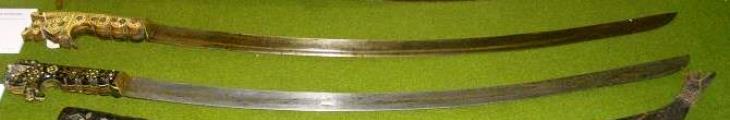

The following is an email received from my acquainted Señor Juan L. Calvó:
Estimado Señor Viana,
Celebro tener noticias suyas. Los machetes de su interés, tengo entendido son dominicanos, propios de la etnia de la Isla de Santo Domingo. Esto me fue informado con posterioridad a la clausura del Museo, por lo que en su ficha me limite a anotar el origen apuntado por el coleccionista que cedió estas piezas,
Reciba un afectuoso saludo
Juan L. Calvó
Which in a rough translation we can read:
Those machetes in which you show interest are, as i have understood, ethnically Dominican, from the Santo Domingo island. This was informed after the museum closure, for i simply made note of such origin in their records, after being enlightened by the collector who has ceded these pieces (to the museum).
I realize this later information would have taken place during conversations had with the owning collector, when the Barcelona municipality decided to close the museum (2009) and requested them to withdraw their property.
Time we compare those examples from Barcelona examples to the one originally posted by Mahratt ... just saying .

Well said Fernando, and the synopsis in your previous post was a perfectly orchestrated example of how complex the classification of ethnographic forms can be!
I think what we can take from the discussion exercise in this case is that these particular forms of machete/guanabacoa types seem to have developed at an uncertain location in the Spanish colonies sometime probably earlier to mid 19th c.
Obviously with the trade and other commerce in these regions and with the maritime routes throughout as a conduit, there was considerable diffusion of these forms. Therefore the futility of trying to assign a certain classification to them is made difficult by this.
I have thought for some time (again it has been two decades or more that these have been studied) that these are perhaps best broadly classified as Spanish colonial swords often in use as machetes.
Any regionally oriented assessment to specific examples of these may be best assessed and described by locally distinct 'dress or decoration' and key inscriptions or blade motif which obviously denote areas and/or period.
Clearly there are examples with Dominican inscriptions......so these illustrate presence there; similarly there are examples in Philippines so again.......and so on. I think Senor Calvo's paper is superb, and well illustrated.
Fernando's point is well made, and I think the discussion going forward will be well served by further examples and any notes on provenance when possible without focus on debating what to call them. The 'Berber' term is yet another example of collectors terms which we have come to use for colloquial uniformity for discussion and reference.

Thank you Fernando,
So now the Montjuic examples have been confirmed to be Dominican as well. Personally, based on the factual evidence we have, for me these swords are Dominican. Others can make their own conclusions, my goal is to find what I believe is true for myself, not convince anyone in anything.
