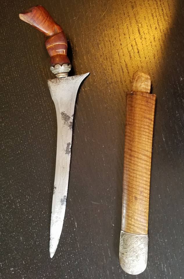

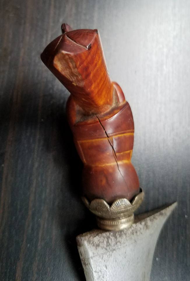

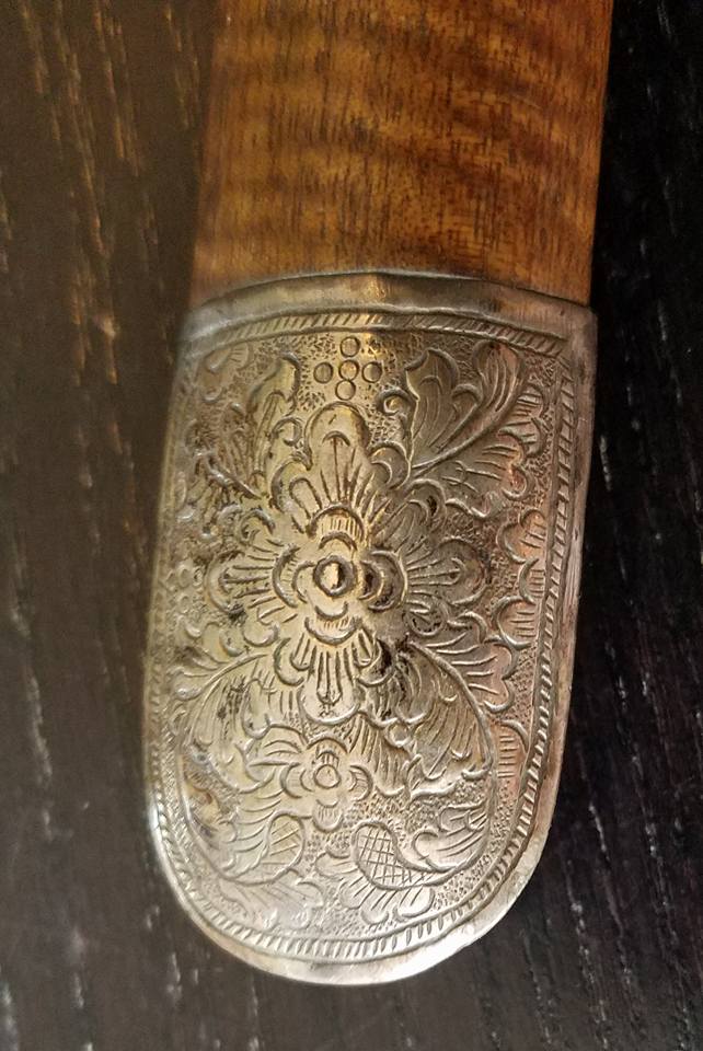

Hello All,
I'm late to the party, but here' my one Keris Selit. Like many, the hilt is Jawa Demam. The blade is sepokal. The Sampir is sadly missing, but the gandar is remarkably chatoyant. I'm pretty sure the buntut is silver.
The blade is sadly held in the hilt with an adhesive, and I've been hesitant to try the candle method to remove it, given the stress crack on the hilt. Someday soon I'll bite the bullet and take care of that inactive rust.
Anyway, Enjoy!
Thanks,
Leif

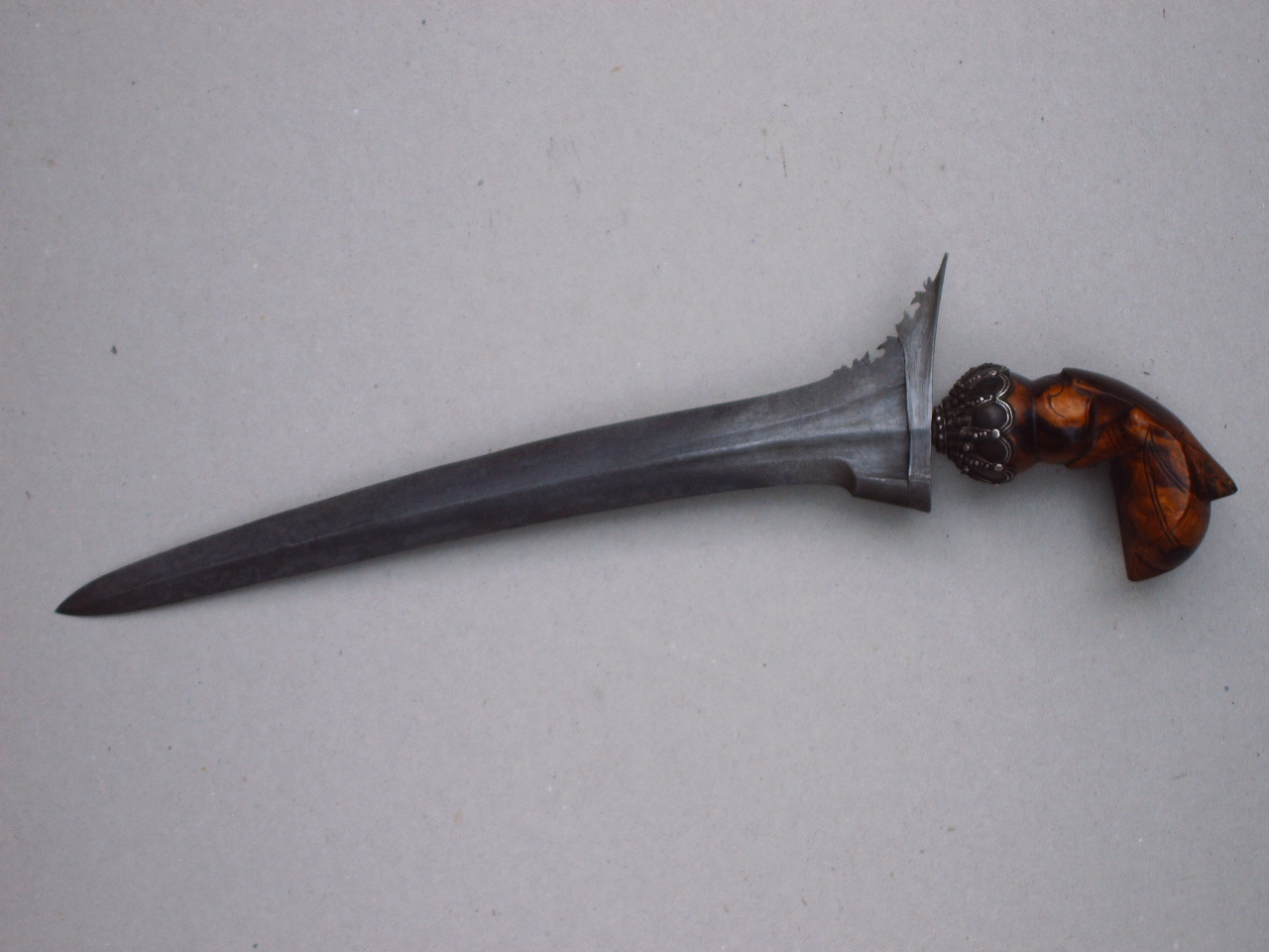

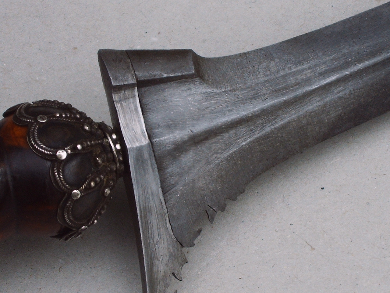

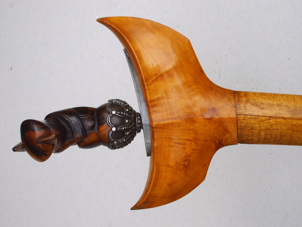

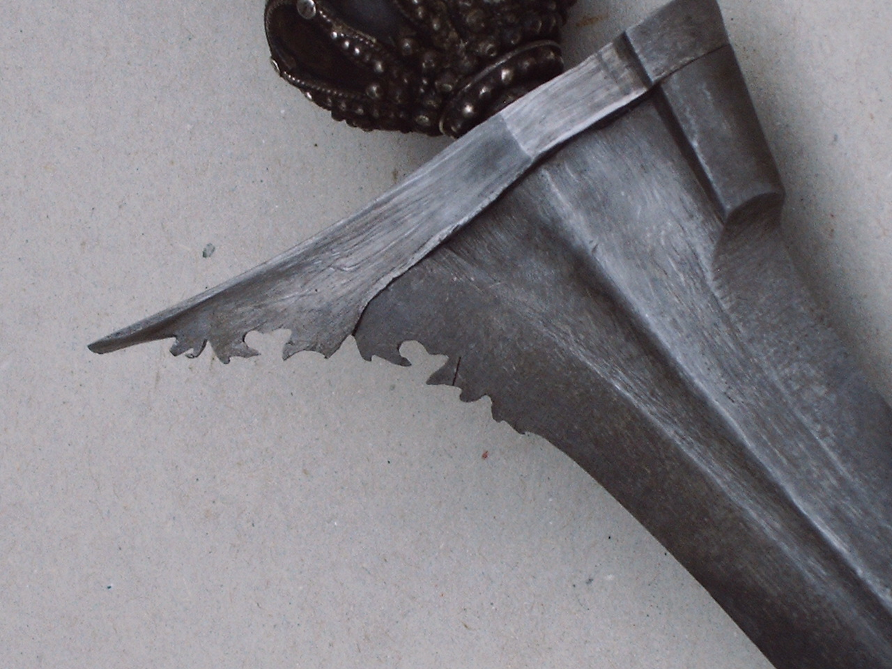

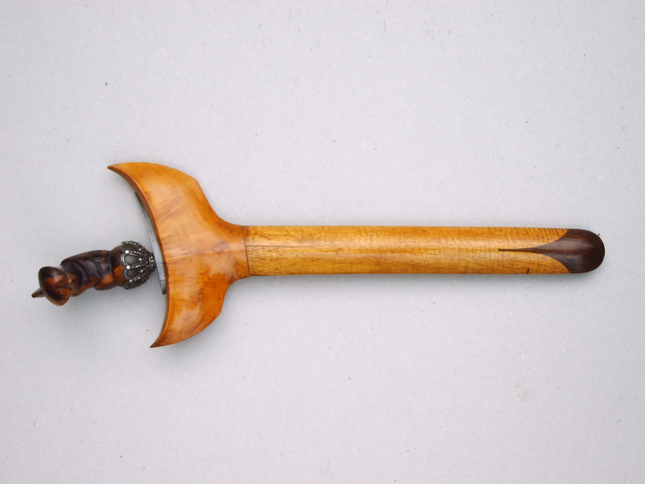

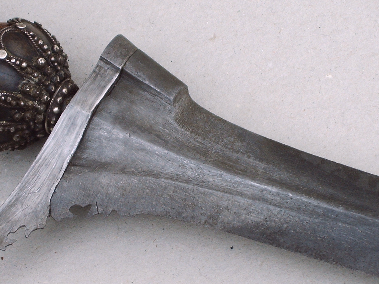

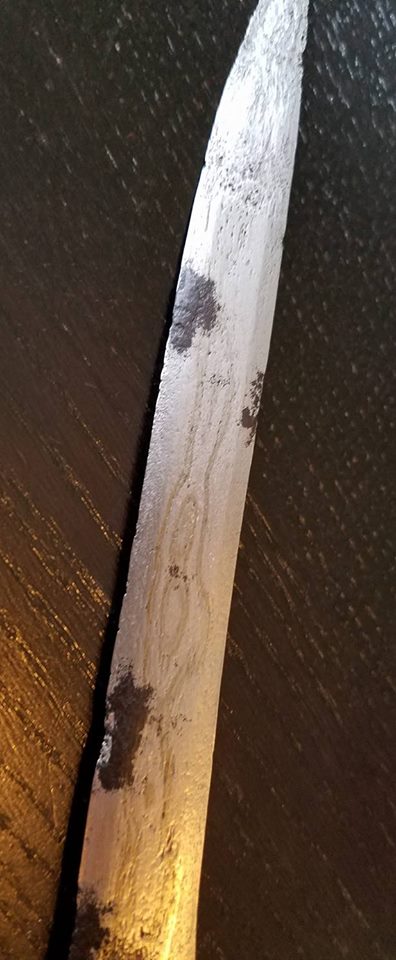

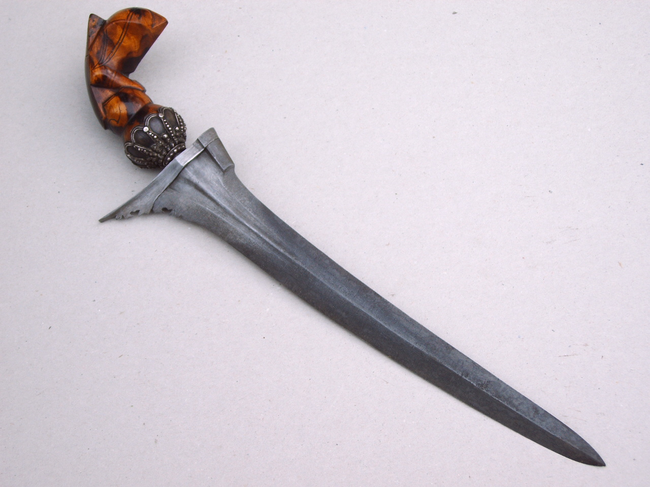

While cleaning blades and making pictures I took some care of this Malay Keris Selit I have for a longer time already. It's from Northern Peninsula, 23,2 cm blade. A little bit unusual for KS because it's Pandai Saras type blade in a Saribulan sheath.
For years I thought it would be mono-steel, around or even post WWII. The blade retains file marks, running horizontal at the edges and vertical in Kruwingan (which isn't unusual, they are carefully done). After some hours in pineapple juice it became clear, that:
1) the blade is hardened (it's actually very sharp);
2) it was treated with Warangan;
3) it most probably is very finely laminated, but - it looks almost like sham. My photograph and etching skills are not good enough to show it properly, yet there are some hints even in my lousy pictures. It's also a bit difficult to see under the file work.
Gonjo perhaps could be from a different material.
Old 15th April 2018, 11:23 AM   #36
Post
Hello Gustav,
That's a nice Keris Selit! I'm not sure whether this concept applied to pre-20th century Kelantan/Pattani culture - their usually long blades and scabbards would certainly make these smaller ones more convenient to wear on special occasions (especially ceremonial events with lots of sitting...).
There do appear to be some PS variants; while short blades tend to be more stout, I'm not convinced that this really represents a PS style though. However, it clearly exhibits northern Malay features and it may be a moot point what name to tag on it...
There are many northern Malay keris blades that are laminated, usually with somewhat subdued contrast like in, e. g., Aceh blades.
Do you associate monosteel in Malayan keris with the WW2 period and later? I'd expect them to have access to monosteel quite a lot earlier and utilize it for keris, too.
Yup, really extensive treatment down into the sogokan area!
Like I emailed you a while back, I wouldn't be surprised to find warangan on (untouched) antique blades from pretty much all over the archipelago (including the northern Malay region).
Fruit juices also darken steel/etc. though - what criteria speak for warangan, specifically?
I guess I see what you mean - could this possibly be shear steel? This also can exhibit sham-like internal structure resembling crucible steel.
It definitely is laminated with contrasting material - this pamor hasn't been utilized for the blade for sure!
Interesting keris, congrats and thanks for posting! Let me know if ...
Old 15th April 2018, 07:07 PM   #37
Gustav
Join Date: Jun 2009
Posts: 1,346
Hello Kai;
One of the most characteristic, distinctive features for a PS is the central ridge (Odo-Odo), continued on Gonjo. It is present. Also Greneng on my blade is absolutely typical for PS.
I own about 10 Peninsular blades and have seen some more. They are older ones; for two, including this KS, I am not so sure and would accept period around WWII as a possible time frame of making. These are the latest ones. None of my blades or old (pre-WWII) blades I have seen, are made from mono-steel. My impression until now is, that, even if mono-steel was used for tools already in 19th cent., Keris blades still would be made from laminated material.
I have never had or expressed a contrary oppinion, au contraire.
I am sure you have experienced many times - after some time in juice the blade turns deep black in some places and these places start "to bleed" while scrubbing the blade.
Perhaps. It's something I haven't seen before (except for the Gonjo).
