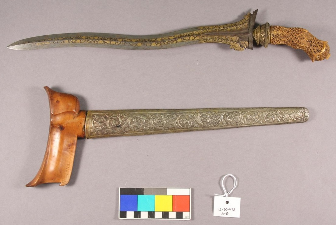

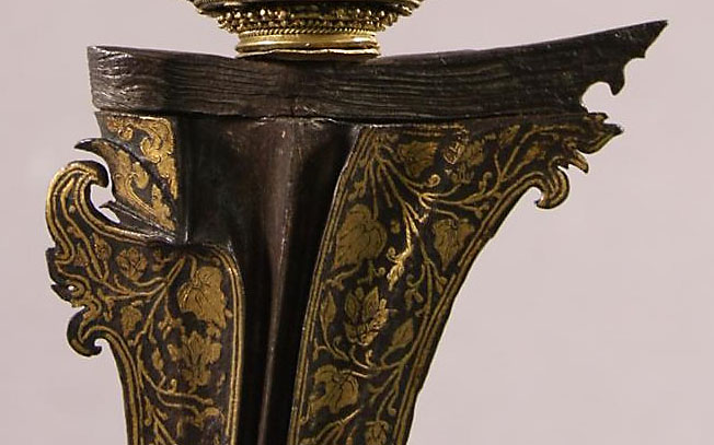

So lets not try to categorise any of these very small parts of keris, that have no provenance, into "Jawa" or "Bali" or anywhere else.
Thanks for your reply Alan. Yes, it is very difficult to come up with a hypothesis about keris that does not have exact provenance and age.
The problem about the keris that have the element that you showed above is that it seems that it was put together very quickly to be sold. The warangka is Palembang, pendok probably Solo, Minangkabau hilt cup, hilt is probably Palembang and ganja from a Bugis keris. It comes from Pennsylvania University Museum collection. It was a gift probably from 1942. I think the website was now updated with larger pictures as the images that I looked before were smaller in size. (Image below) and the link:
https://www.penn.museum/collections/object/244340
Even the ones in KrisDisk, in my opinion we can only use the date it came into the collection. The geographical origin can be diverse as those keris can be brought to the place of collection from anywhere.
About the particular design you mentioned above, an issue that probably may raise is the legitimacy to use a design. Does the design really have a meaning or it simply come from a creative mind that does not need authority to create new designs on a keris?
Actually a greneng somewhat similar to this appeared in Malay kerises where the "gap" is actually a dha (or it becomes a dha) - as far as I am concerned, I think Malay pandai keris does not need authority to introduce new designs.
Then, if the design does has a meaning or it was a Dha copied from Pajajaran, does it have to be in a specific style/location?
To answer/hypothesize these questions, we need something solid to tie it to. and at the moment I have none. I look forward on your insights about this Alan. Thank you.

Thank you very much Rasdan, we now have some idea of the background of the keris that appears to be the best presented example of this variant element.
An excellent contribution to this investigation. Again I thank you.
My inclination is to disregard the hilt and scabbard, and even the gonjo, and just focus on the body of the keris. We still have no usable provenance, but at least we now know that there is no usable provenance.
My current opinion is that we have a North Coast Jawa blade, possibly able to be categorised as Banten. I may be wrong, but for the moment that is where my thoughts will start.
Anything in a European collection can only be dated as before the date that it was first catalogued. There can be assumed provenance for a period before this, such as we have with the kerises in the Bargello that came from the Medicis, but prior to a catalogue date, we're really only guessing.
You have raised the question as to whether we have an artistic contribution to keris design, or whether we have a socio-religious contribution to design, that is to say, do we have art, or do we have symbolism that can be tied to belief?
Certainly, after Islam much of the Hindu-Buddhist symbolism was corrupted and often interpreted in a different way to the way in which it was understood as a Hindu-Buddhist icon. Of course, this probably occurred even before Islamic domination also, so the question is always there:- art or symbol?
Then again, as in Western artistic traditions we can have art and symbol:- elements of a work of art that are most certainly artistic elements can very often be interpreted also as symbols, and carry a message that can only be read by those people who have been educated in this symbolism.
At the moment we have a few keris with examples of a design element that has not previously been commented upon by people who are qualified to do so.
Actually, that's all we have.
But from my perspective this is more than enough to commence a determined effort to try to align this new element --- for the sake of convenience, let's call it Gustav's Element --- yes, let's try to align Gustav's Element with known forms from old Jawa, say, pre-1700 Jawa.
I at least intend to follow this route. A few months, or years of keeping this form as a template in my mind may some day result in a match with something. There is no hurry, we have a form, let's see if we can find out what that form is.
The last thing we need is to get bogged down with non-productive quibbling.

Alan, I checked my outgoing mails, and see, that I actually have sent you a mail about that Keris with the link to Penn Museum back in 06.11.2012. We had a correspondence about it and spoke about "three prong Ron Dha".

Alan, here it is:
Yes, I also immediately thought about this different Ron Dha. A kris in Sweden, collected before 1676 (Jensen, page 85) also has a similar RD, and also one of the Keris in Munich, which is not depicted at Jensen.
Would you see some similarity between the (third) element of this RD, the nearest one to Gonjo, and the feature, much bigger of course, yet at the same place on some Megantoro's (the best one depicted at Bezemer)?

Regarding the age determination of Kerisses: the Keris 1 is donated to the Penn Museum in 1942 - nevertheless it has a blade, which most probably was made in the 1500'ties. Keris 5 came into VKM (then Natural History Museum) at the end of 19th. cent. It has a blade much older then that, we can see that.
Of course is the first mentioning of a Keris in a catalogue of a collection the first graspable point (often very uncertain) in "biography" of that Keris, and it is a very important fact. But it would be quite shortsighted to equate that date to the date of manufacture of Keris. There are a lot of funny descriptions around in Museums on different objects exactly because of that - and because of lacking research.

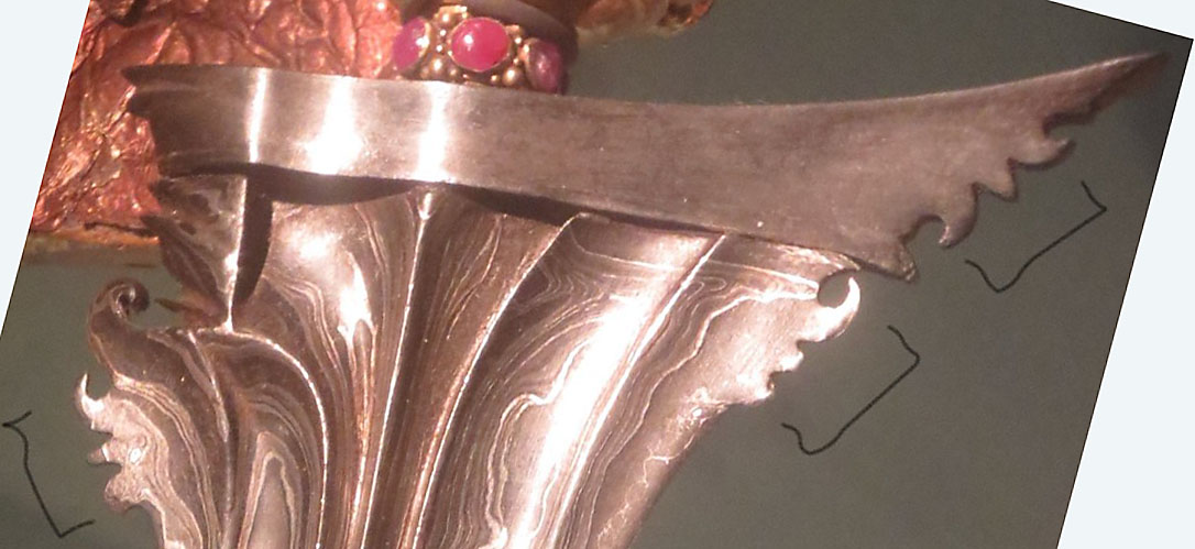

So, looking once more at the beautiful old Penn Museum keris in post #31 above, and reading up on all that has been said, I am starting to wonder if that three-pronged Gustav-element maybe still is around, but has been corrupted to such an extent through time that it is not easily recogniseable anymore? Please see the greneng on my Java keris and note the element on the far end of the gonjo, next to the ron dha (to the left of it, at the very end). Recall that the two "wings" on the sides of the thingil in the Gustav-element are not mirror images of one another; they are different. On my keris I think I see the same element: there's the thingil in the centre, and what remains of two side-prongs which slant differently.
I probably am "seeing things" because it is what I WANT to see, but I mention this for any comment you might want to make, even if it is "Whoa, boy!"
Johan

No worries, at this brainstorming stage all comments may help to spur our thinking. I have been trying to look into this in more detail but still need more time to come up with something reasonable, hopefully.
I guess the part you're highlighting is not an offspring of Gustav's element: The main difference seems to be the wide, rounded gaps (compared to the narrow and acute gaps with GE). I don't think that there's a missing link that will bridge this gap...
We have several clues that may help to verify any working hypothesis:
1. Similar shape of the parts of the element? (Including evolutionary links for any changes.)
2. Positional information - is placement/function basically the same?
3. Rhythm (or language) - does the order of the greneng appear to be correct (or does the hypothesized meaning make any sense)?
It is very possible that the elements (or their parts) do change over time - we should be able to trace them back to the original element though to make a compelling case IMHO.

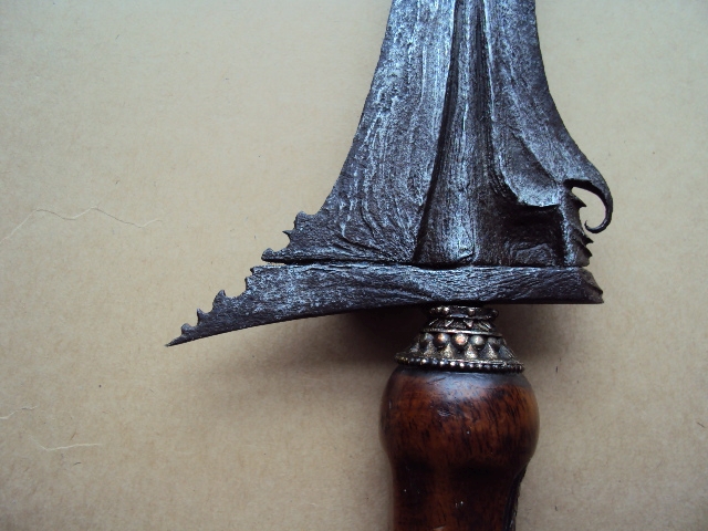

One last uncertainty which is still in my mind while we are on this topic of the greneng, is: how do we differentiate between a greneng element and PART of a greneng element? (You will recall the Gustav element actually consists of three parts - it was described as the "three-pronged element").
While the pic of the Java keris is still directly above, may I use it as an example? As far as I can make out, that greneng has only three elements. Reading from right to left (top to bottom), I see a ron dha on the blade, then another ron dha on the gonjo, and then ONE last element. I am asking if any of you in the know agree with me, or do you discern more than these three elements on this keris?
Johan

Johan, there are a number of earlier posts in this thread that identify elements of a greneng. I think I probably posted most of them, and I did this to try to make the point that the entire subject is confused and full of contradiction.
The keris you are now inquiring about is probably classifiable as Pajajaran, this places it as west Jawa, into Sunda. The greneng is not the typical Javanese greneng we are accustomed to, and the element that takes the place of the kanyut is not nameable under present convention.
However, having seen the way this idiocy works, I am sure that some people would not have much difficulty in giving every pimple in the sorsoran, either accidental or intentional, a long complicated totally meaningless name --- and they still would not understand anything at all about what they were looking at.

This goes to show how new collectors can become swept up in the enthusiasm of the old collectors: when the old collectors become engrossed in their fascinating discussions over "every pimple", we newbies get enthused and want to participate in like fashion. I, as a retired lecturer, who frequently made use of practical examples in classroom discussion, was however quick to bring in an actual keris so that what can be said about the greneng is directed to a point. (Recall our posts concerning the Penn Museum keris?)
I don't think the ENTIRE subject has become confused; what might need to be done is that the confusion where it surfaces should be addressed. We now & then tend to leave discussions hanging in the air.
I glean from what has been said about the greneng in the pic, that there ARE indeed three elements of which two are ron dhas and one cannot be interpreted. Especially appreciated is the bold statement by Alan that "the greneng is not the typical Javanese greneng we are accustomed to, and the element that takes the place of the kanyut is not nameable under present convention."

Personally I see a (worn) ripandan above the rondha located on the wadidang (blade side) and another ripandan or protrusion below the rondha located on the ganja but it is not really important.

Johan, regrettably the diagrams in my previous posts are not very clear, they're OK if you know what you are looking for, but if you do not, they can be confusing.
The kanyut is the second last named part before the extreme end of the greneng, it is the part that looks like the decline of a hill, the last part is the buntut mimi, which viewed from above becomes the buntut urang.
There has been extensive discussion on tangguh over years in this forum. Different people think about it in different ways. The best way for a collector who is outside the heart of the keris world in Central Jawa to think about it is that the names are simply classifications. Names associated with old eras will refer to old keris, names associated with recent eras will refer to more recent keris, but it is best not to think of the name of the classification as always inferring an age for the keris. With younger keris, say, after mid-17th century, there can be a grain of accuracy in a link between name and era, but in older keris not a lot of people will accept that the tangguh name really links to the age of the keris, but it is likely that the name will link to a geographic location.

Well Gavin, i think that if you have keris from outside the Jawa/Bali nexus that you think have this feature (with all respects to Gustav i have trouble referring to it as "Gustav's Element" ) i think it would be interesting to see them, especially considering that the general thought here seems to be that the understanding of the ron dha's true meaning and the "reading" of the greneng was lost in the keris' transition to Islam. Let's see what you have.
Old 27th August 2017, 10:57 PM   #60
Posts: 7,255
I know I dubbed the feature I have in mind "Gustav's Discovery", or "element" or "whatever", and I did that for ease of identification. If anybody wishes to call this specific feature something else, it is not any sort of a problem to me.
However, if we look closely at "Gustav's Element" (for want of a better name) what we find is that there is not just one single element to consider. I think Gustav called it a "tri-partite" element at one point, but that "tri-partite" element has a number of forms that may or may not be related.
The form shown in Post #26, is, I believe, the oldest example shown (gold kinatah), and is a distinct example that shows detail and style that I believe is the most pure of the examples shown, "pure" in the sense that an attempt seems to have been made to represent in iron a form that might be able to be identified elsewhere:- note the tiny spike from the root of the central curved spike, something like this cannot be accidental, it must be able to be interpreted, a matching form in another medium must exist.
However, if we look at the other examples it seems to me that we could be looking at a different representation of something, in the other couple of examples shown in this original thread, and in other examples that I have seen, the same distinct statement that we can see in the Post #26 example does not exist. By a very large stretch of imagination it might exist, or it might be a distillation, or a corruption, or something else entirely.
For example, look at the "tri-partite element" in Post #31. This is a Bali keris. Anybody who has done even the smallest amount of reading on Balinese culture and society will be aware of the importance of the number 3 in Bali. To quote Murni & Copeland :- "everything comes in threes in Bali".
The "tri-partite" element in a Bali keris is open to any number of possible interpretations. As Dr. David suggested:-
"This is just a thought, and allowing that nothing is cast in stone when 'reading' a keris, is it possible that the feature identified in Gustav's examples is a representation of Siwa's trisula and hence a continuation of the Shivatic notation."
This idea is totally defensible and fits perfectly, for the form shown in this Bali keris. The keris itself is an icon of Siwa, why not put another icon of Siwa into the enhancements on a keris? It is a good idea, but it needs some sort of confirmation, and speaking only for myself, I have not encountered that confirmation, even though I could mount a very good logical argument to support the "good idea".
But does this element in the Bali keris look like the element in the keris with kinatah? To my eye it does not. There are any number of three part elements in a keris, but the original as shown in Post #26 is quite unique and distinct.
This form in Post #26 is the form that needs to be addressed:- solve this riddle and then it is possible to look at later variations of the "tri-partite" form and consider if we are looking at a derivation of the original, a corruption of the original, or something else entirely.
We need to identify the form of the tripartite element shown on the keris with gold kinatah.
Then we have a beginning.
Everything else comes later.
