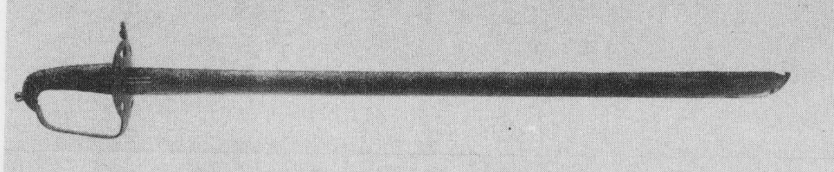

In Wagner, there are actually five exemplars illustrated with the notch feature:
Plate 2, p.372, a cavalry broadsword of beginning of 18th c. Prince Eugene inscription.
Plate 3, an Austrian cuirassier broadsword early 18th c.
Plate 7, an Austrian heavy cavalry broadsword in use until c.1740
Plate 35, a Pandour officers sabre c.1747, Hungarian
Plate 39, an Austrian hussar sergeants sabre 1768
All of these are notched at back of blade near tip.
I recall having thought at one time that these notched had to do with the notorious Pandour units, however it seems only that one officers sabre had the notch. There are no other examples throughout the book which have any such notch, only these Austrian examples, which seem anomalies.
I have never (since research began c. 1994) found sound reference to other notched blades other than unsubstantiated comments from other collectors and dealers who had seen them on French examples in cases. I have seen a British sabre of c.1780 with this exact notch but have not the details to support . It would seem the other instances mentioned regarding the Prussian cases are similarly surmised.
In original research in the 90s, I wanted to confirm that the examples in Wagner actually had the notch and this was not artists license, so I contacted the museums he cited for the originals. While they sent me photos of the original swords, when asked, the officials typically claimed they 'had no idea what the notches were for'. This seemed surprising as these were primarily Czech museums, where Wagner had been a curator.

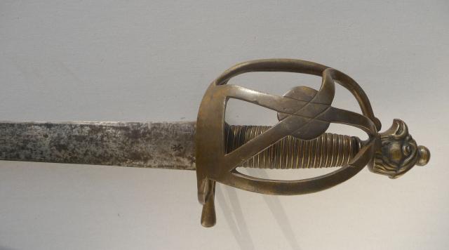

These notches are at no way limited to Austian swords. There are Prussian cuirassier swords M 1732 with such a notch as well as Saxon cavalry swords M 1764. The foto shows the the tip of the Prussian sword.

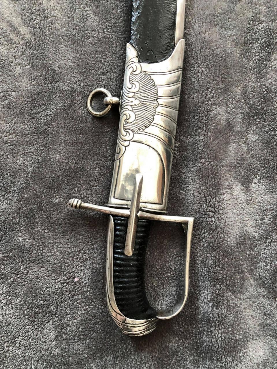

Hey guys, sorry to resurrect a long-dead thread, but I have recently acquired a Hungarian "Madonna saber" which from what I can find was made somewhere between 1760-1811. It is a beautiful example as pictured.
There is scarce information on these swords. There are a few similarities as mention above in Wagner which I identified on page 407. I also own "Ungarischer Sabel und Husaren-Pallasch" which solidifies it as a Hungarian saber. Goes on to say that these were almost all foreign-made, mine being a Pottenstein example. I wanted to know what other resources are available for further research on these swords and specifically on Pottenstein as a maker. I've not been able to find anything on Pottenstein specifically and very limited information on Madonna sabers as a whole.
The sword handles beautifully, far more impressive in construction than my 1796. Le Marchant obviously derived his sabers from these.
Its stats are as follows:
Sword in scabbard weight: 3 lb 10.5 oz/1660g
Sword weight: 1 lb 12 oz/ 794g
37 3/4'" long
33" blade
8" POB from the hilt
I only own a 1796LC officers which is obviously a well-constructed light blade, but it seems to be somewhere between that sword and my 1811 Blucher which is a beast.
Thanks for the look!
JT88 is offline   Reply With Quote

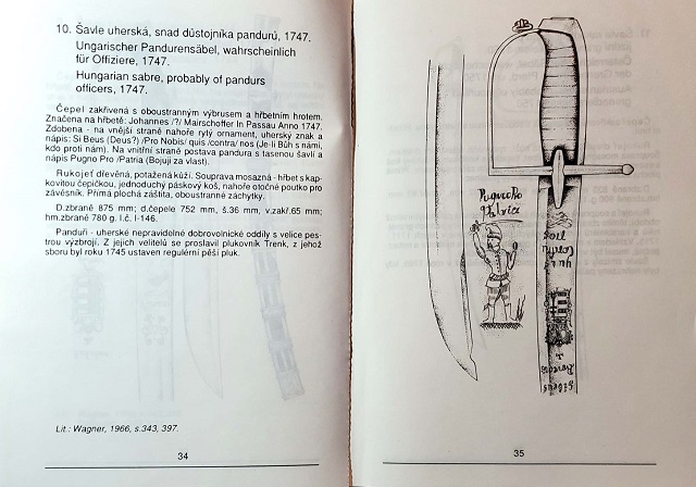

I am curious about the reference to Wagner.
My copy "Cut & Thrust Weapons" (Prague, 1967) shows virtually this exact saber among Austrian swords as Hungarian mid 18th c. and with Pottenstein as place of manufacture.
Here I would note that Pottenstein seems to be a judicial district, and electoral region in Bavaria. It is often confusing as swords often, if not typically have the arms of Hungary, but clearly this was Austro-Hungary, the Holy Roman Empire.
While it seems possible there were blade makers at Pottenstein, it seems more likely this was where the saber was 'outfitted'.
It is interesting that this example is silver metal, the book example is brass.
The use of the Madonna falls into place with many of the religious and neo-classic themes popular in Hungary and East European regions.
What is most curious in the Madonna depiction is that the figure is standing on the face of the 'man in the moon' which is a common depiction in the cosmology of many European blades. The image of this moon also shows the line along the back of the head which represents a rostrum, as depicted in the moons used in Spain for espaderos del rey.
In references on Hungarian arms I have read it is noted that there was a predeliction for symbolic representation on arms in this period. In Poland there was a use of representations of important rulers, and those particular swords were termed in accord with the figure on the blade. For example 'zygmuntowka' (King Sigismund); 'batorowka' (King Stephen Bathory).

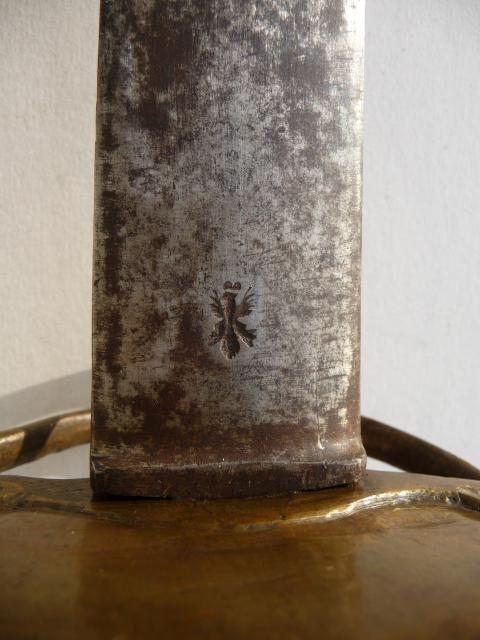

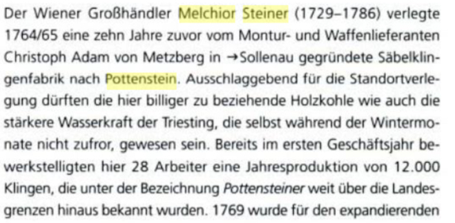

In the 18thC Austria manufactured sword blades mainly in Pottenstein and Weiz. Melchior Steiner started production of sword blades in Pottenstein (lower Austria) in 1765. He successfully competed with foreign imports on price and quality. On his death in 1786, his nephew Melchior Ritter von Steiner took over the arms factory which did well and became the market leader in Austria. The factory was converted into a metal and machinery goods manufacturer in 1828.
I read somewhere that gild/brass decorations on uniforms and arms in Austria-Hungary was reserved for the Crown. Silver plated hussar sabres were used by private palace and castle guards (including ceremonial duties). The Austro-Hungarian empire contained some large estates.
Below text is from Das industrielle Erbe Niederösterreichs: Geschichte, Technik, Architektur (2006) by Gerhard A Stadler.

There would be no Pottenstein blades marked as such prior to 1765 as the previous factory was based in Sollenau (see text).
The gilding would be reserved for Army officers, not private estate guards. Not sure where I got that from, so unconfirmed. Hussar regiments were recognized from uniform colours and it’s possible some used gilding and others used silver (so also unconfirmed).

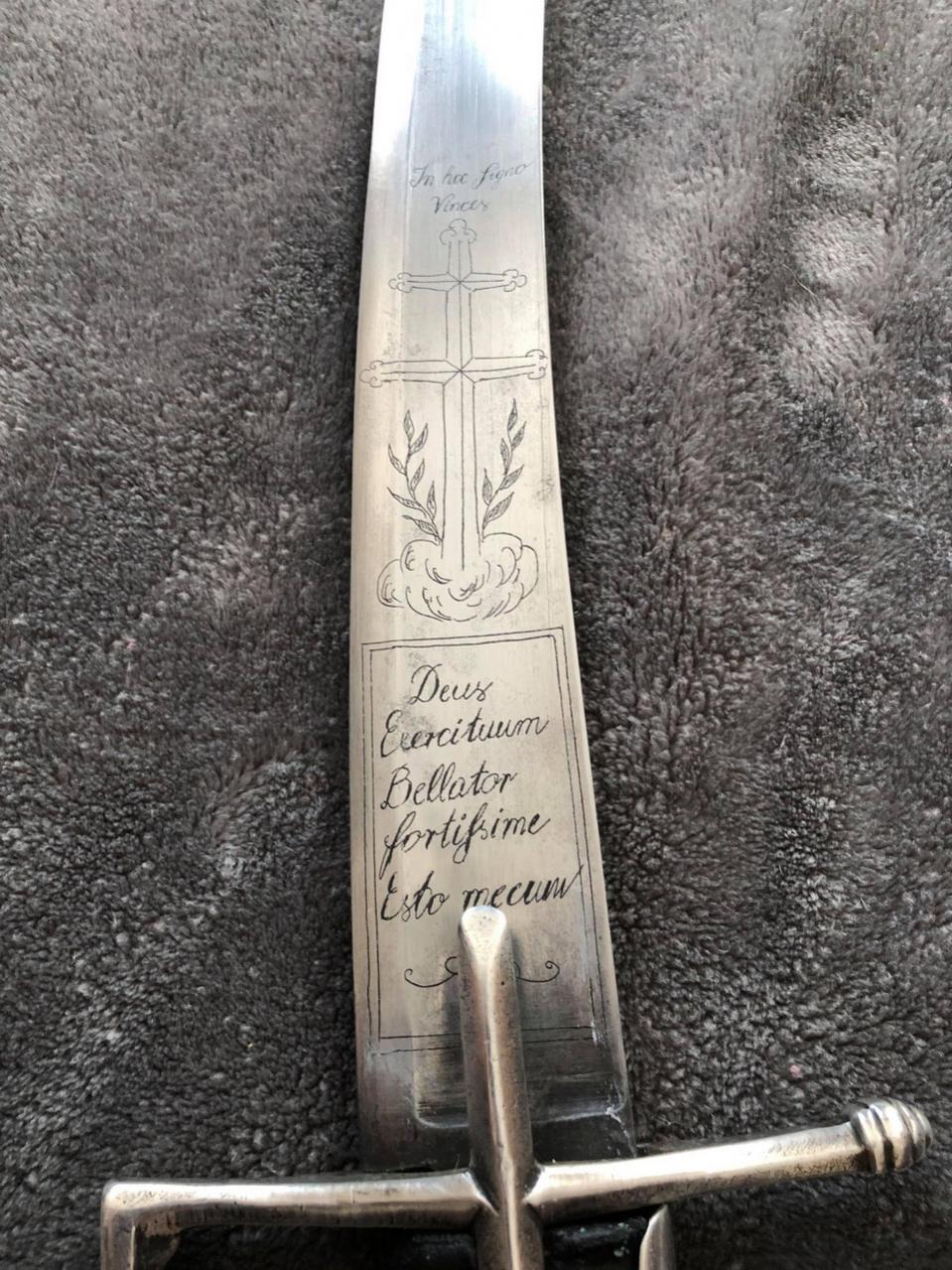

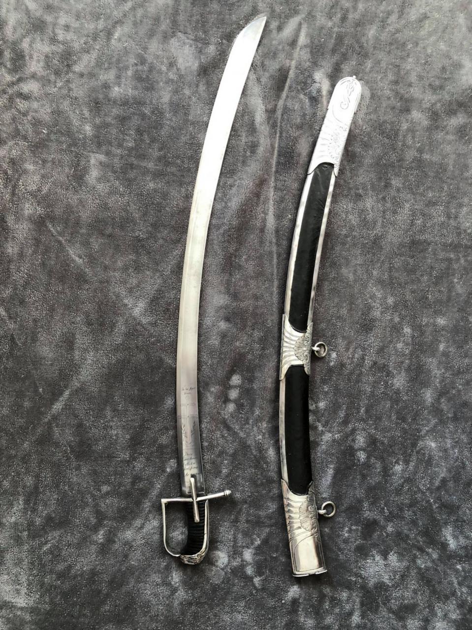

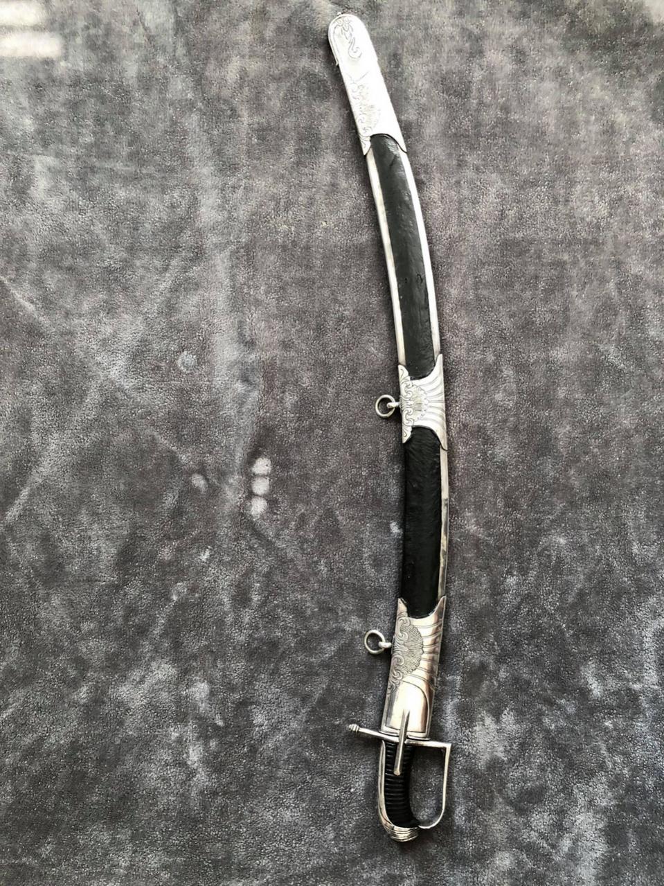

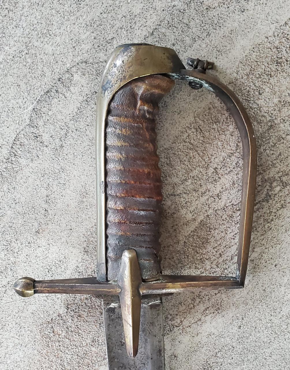

Have you seen any other with silver hardware? It’s not plated, my guess from its polishing characteristics is that it is low grade silver. I haven’t been able to find another example that is not brass.

Maybe it’s the Bavarian Pottenstein
Note that there is a senior and a junior Melchior Steiner (see the text). The factory was started by the uncle and continued with the nephew (knighted) according to the sources. It’s possible that there was some blade production in Pottenstein at a smaller level before the factory, but I’m not aware of this. The location seems to have been very good. It’s rare to find dated blades so it might be an artesenal example. Also not sure how exact the dating is as it was a long time ago now.

A production start at Pottenstein in 1765 is IMHO impossible because Melchior Steiner was baptised not before novembre 21. 1762. But as there are sabres with the Pottenstein signature of the year 1749, the information given with 1765 must be wrong.
Possible as his source says that it began with his uncle or father. What’s the earliest sample anyone has seen of a Pottenstein blade?
Are you able to tell me any more about my sample? Or where you’ve found information? The two books I listed are the only I’ve found thus far.
The Pottenstein blades seem far rarer than either the Fringian or Solingen examples. Treasures

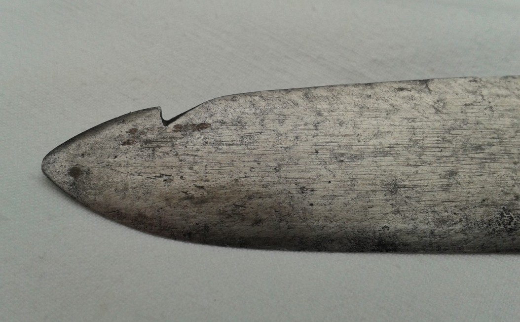

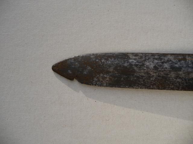

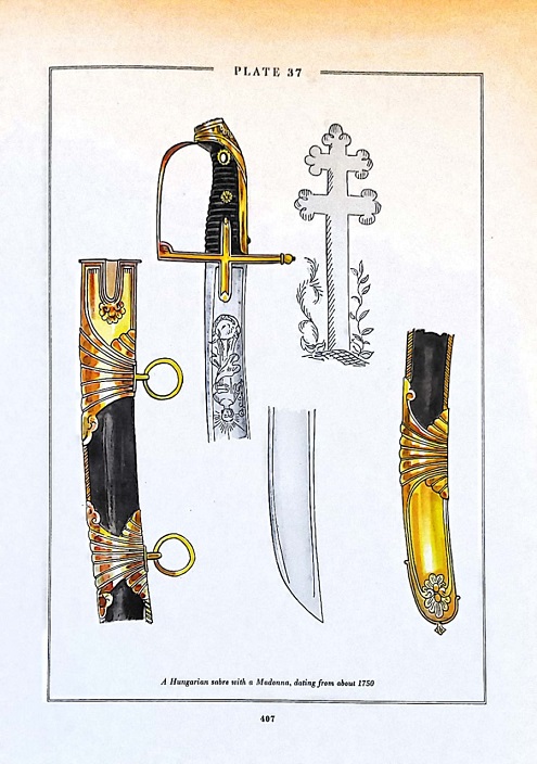

In Wagner, (p.350) the detail on a saber listed as that of a Pandour officer , by swordsmith Mairschoffer I , Passau, anno 1747.
The illustration shows the blade as 'Hungarian' and having a 'notch' near the point.
The illustration here from Konipsky & Moudry (1991) is the same.
My example of this type saber has the Hungarian arms but is not marked as to maker, and does have the same notch.

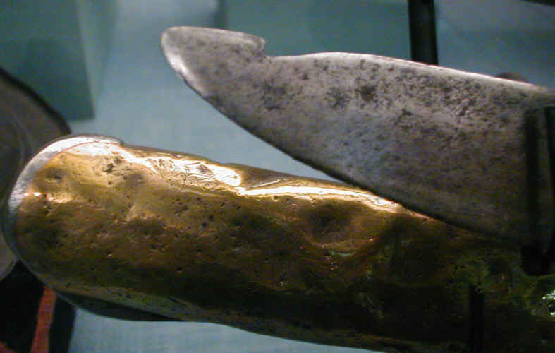

I personally do not think these notches have a utilitarian purpose, but perhaps something more symbolic. In the time researching these notches, there have been no satisfactory explanations to this curious feature on many Austrian swords.
Wagner states it was to worsen wounds, however, despite sounding viable, the truth of the matter is from what I found, this may cause the weapon to become lodged, thus disarming the user. Also, how would this apply to such a notch on the blade back of a saber? a cutting weapon.
Is such 'symbolic' notching feasible? With the Landsknechts, I had read (passim) that they wore clothing that was deliberately torn and tattered to represent 'battled' garments of their predecessors in combat. Notches were placed in firearms as a kind of tally at times (though no evidence supports western gunfighters doing this in reality) .
I did find evidence of a few cases of this 'notching' with French hussars of the period through contacts in France, but this information does not have confirmation.
