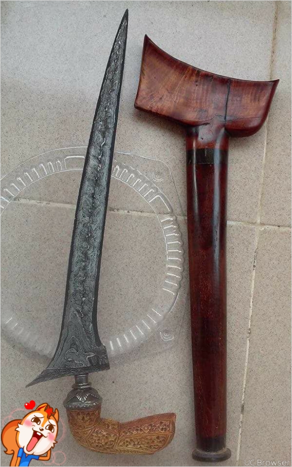

Hello Andi,
Thanks for your efforts in posting keris Bugis on this forum and bearing with us and the language issues! (There are many participants whose primary language is not English. Thus, we know it can be tough, especially at the start - learning by doing can be also fun though...)
Old 6th March 2017, 05:04 PM   #37
Post
Hello Nik,
Please also keep in mind that standards of quality can change between regions. There are already differences between Bugis blades from southern Sulawesi and Bugis-influenced keris from the Malay peninsula. Traditional Jawa tastes are very different.
Let me explain why I am, personally, not so fond of the keris blade shown in post #17:
Disclaimer. This is a keris with miring pamor which is much, much more difficult to forge than most other pamor (and much more costly since more material is lost in the process). Thus, we're speaking of high level skill not needed for more common keris!
1. The kurissi pamor is not well controlled: If you follow the twistcore from the base (very broad, distorted) to the tip (distorted in another way), there is no real consistency, no real motif exhibited in the final result (for both lines of twistcore).
2. There is a massive cold shut between the two rows of twistcore (from the base pretty much into the distal third of the blade); apparently the pande was working at his limits here.
3. Just as disconcerting is that this (non-)joint is not following the middle of the blade (ada ada) and the luk (also seen on the other side of the blade).
4. IMHO the garap of the blade and flow of lines don't look refined. Compare with the other blade shown in the last pic of post #16: The blade on the left looks fair while the last luk of this keris seems to almost fall off...
5. I'm also not a fan of the greneng at the base of the blade and, especially, the pejetan... (Maybe the gonjo got replaced or the greneng restored but still there seems to be finesse missing here.)
Please do correct me if I'm wrong with any of the raised concerns! Andi and Yasir, I apologize for being frank - just trying to help you, Nik...

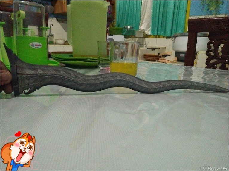

Default sepokal
Dear all
This time I post a keris without camera effects, hopefully be discussed together ,. keris Bugis sepokal

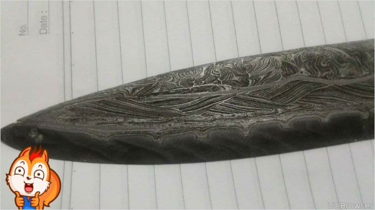

Default pamor
Dear all
slightly deviated from the discussion, we Bugis have expertise in making this the dagger with beautiful and hard PAMOR, my upload so you can to see a different

Hello Andi,
Nice fittings of the keris shown in #39!
With what metal have the gaps in this blade been closed?

Old 7th March 2017, 03:27 PM   #44
Posts: 6,441
Originally Posted by kai
Hello Andi,
The blade looks like it has cold shuts on both sides almost the entire length.
