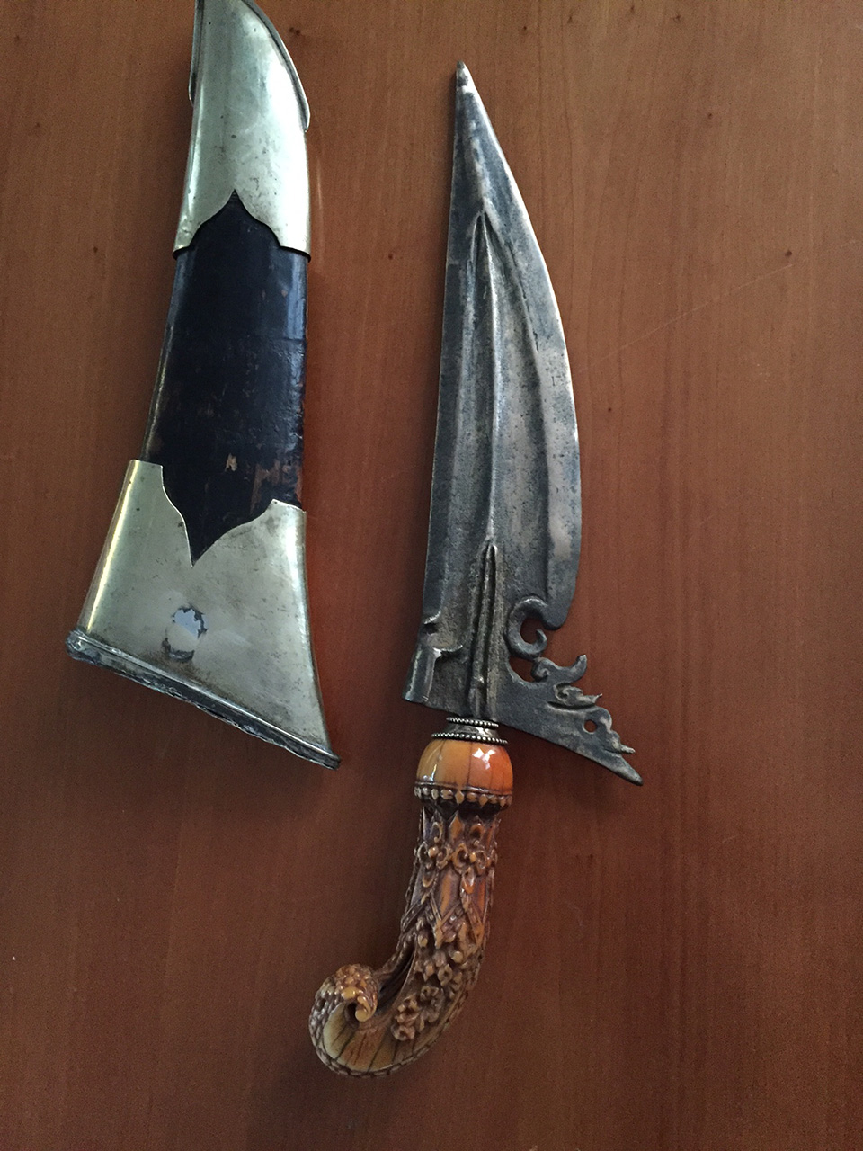

in line with pusaka's post here's a bronze keris offered to me by local seller here in Indonesia
Dhapur sinom, with quite nice crisp lines, making me assume the blade is kamardikan era, but the owner said it was Mataram era, and quite old
he said this blade once has certificate from Museum Keris from Taman Mini Indonesia Indah, but now lost
for now I did not have the budget to buy it, so I posted it here for discussion
any opinion is welcome. Enjoy
thanks
Donny

label reads :
straight keris : bronze
dhapur : sinom
tangguh : mataraman
Rongko : ladrang solo
wood : sono keling
pendhak : slorok kuningan sari
length : 36 cm, peksi 7.5 cm
Donny

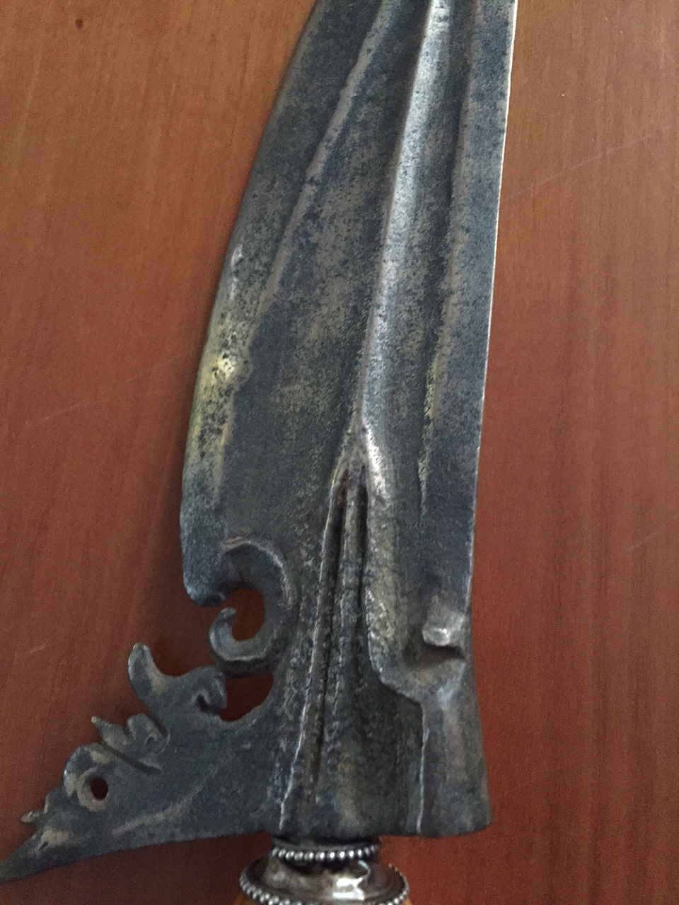

Interesting blade, it does not look very recent from the pics, you can see the cleaning product deposits left in the cavities. The style is rather PB than Mataram? Twenty years ago the TMII Museum Pusaka used to sell some quite good and certified krisses.

Actual Marius, old bronze keris are a real thing and may in some ways be more valuable to a collector of keris than one made of solid gold.
The real question here would be is this a legitimate old bronze keris. I have some serious doubts.

Regarding the age of the Keris, my bet is on very recent production by casting.
