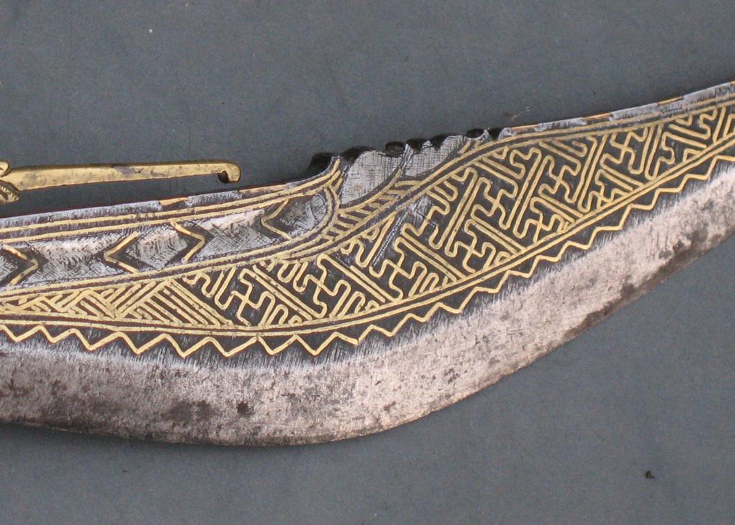

Old 9th August 2015, 09:12 PM   #45
asomotif
asomotif's Avatar
Join Date: Nov 2006
Posts: 2,238
Good evening.
Found a picture of 4 examples from an auction at Christies 1997.
Maybe nice for reference / comparisson.
Willem
Old 25th October 2015, 10:02 PM   #46
asomotif
asomotif's Avatar
Join Date: Nov 2006
Posts: 2,238
Ps. here is my example.
