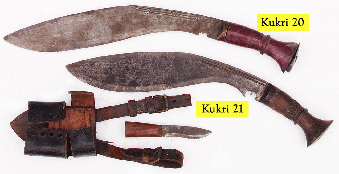

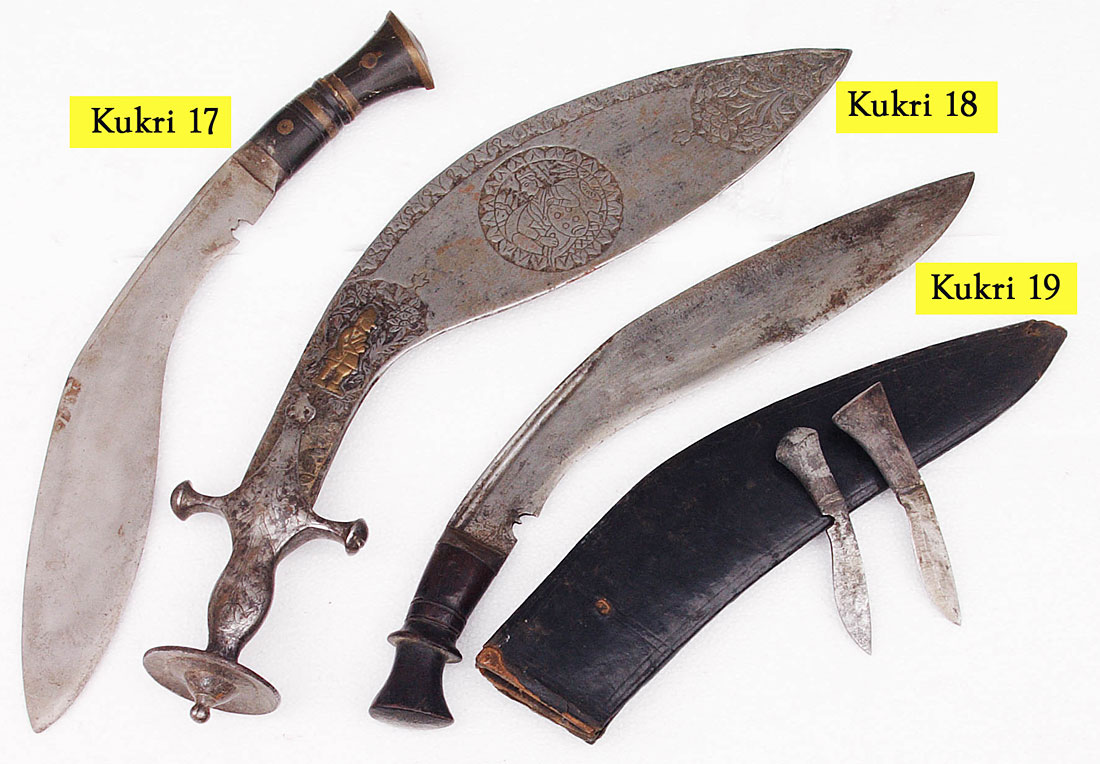

Here is the next group...

Kukri no.17, most likey a WW2 IA issue kukri
No.18, tourist
No.19, most likely late 19th, or very early 20th century military issue kukri
No.20, most likely a civilian kukri WW2-1960's
No.21, civilian kukri circa WW2
sirupate is offline   Reply With Quote

Hi Bill,
#18 is an interesting beastie!
Many of these were made in the early part of the last century for the British 'Raj' market as decorator pieces.
I'm sure there is a printed advertisment floating around somewhere from the first quarter 20thC, showing them with other 'familiar' 'indo-persian' weapons made for the same purpose which now are often optimistically described as 'ceremonial' or 'parade'.
The mix of styles is fantastic, the exaggerated Kukri blade decorated in chiseled 'indo persian' style, the rather nice Tulwar hilt. What a great thing!
I've often wondered if some of these were married up with older hilts. Even the one on yours is every bit as good (better in fact) that a hilt on a fine persian wootz Shamshir bladed Tulwar that I own.
#21 is shown with the same combination frog and karda/chakmak pouches that are usually seen with the Indian ww2 era private purchase Kukri like #1 & #2.

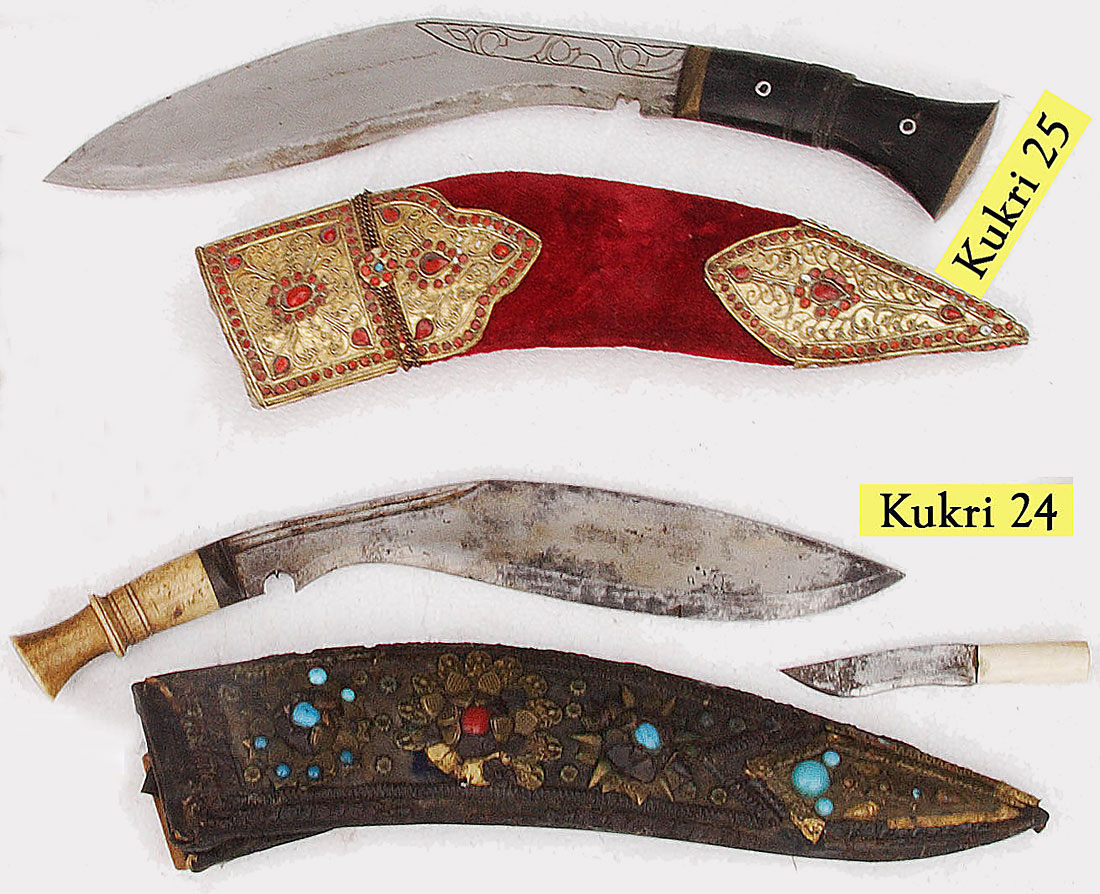

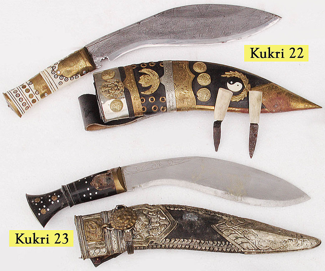

Old 22nd February 2012, 01:50 AM   #43
Lee
Lee's Avatar
Posts: 1,006
And the next group...
Old 23rd February 2012, 05:48 PM   #44
sirupate
Location: England
Posts: 373
Hello Lee, with the information already given about the other kukri, you might well be able to work out what the kukri are in your last post.
Put down what you think they are and we will take it from there
