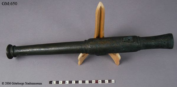

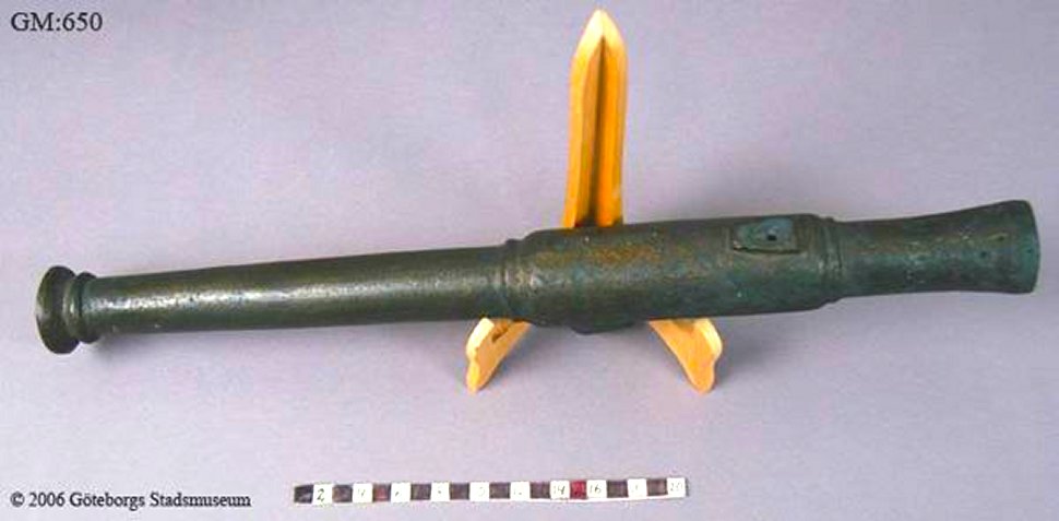

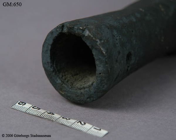

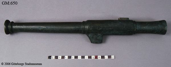

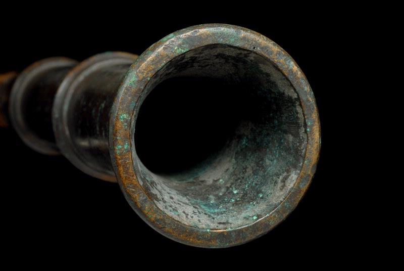

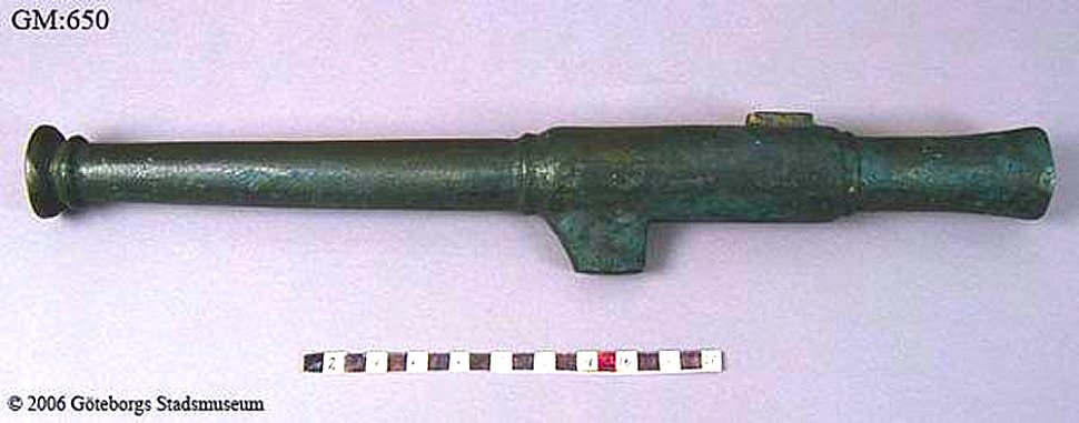

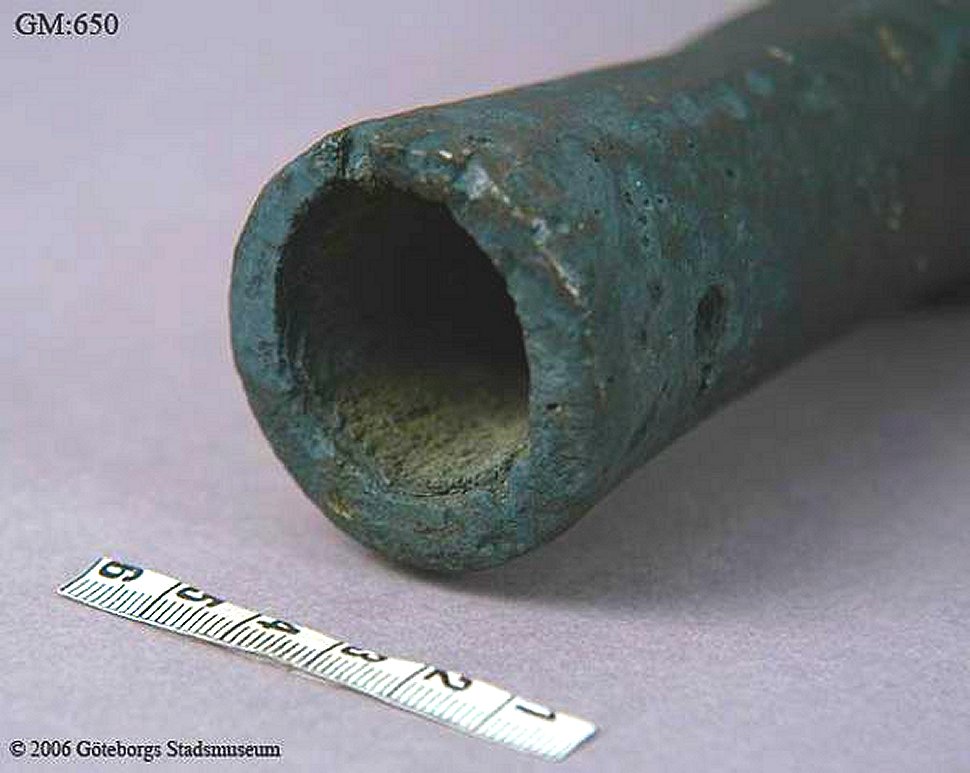

The beautiful bronze handgonne from Göteborg
http://carlotta.gotlib.goteborg.se/p...bjMasidn=35125
I think it late 15 century (the front side of the muzzle let us to suggest it)

Old 28th November 2011, 05:51 PM   #38
Matchlock
Matchlock's Avatar
Join Date: Sep 2008
Posts: 4,310
Hi Alexander the Great ,
Another great and astonishing find, thank you very much for sharing!
I think your dating is exactly right, and post the photoshopped (though low-rez) pics.
Thanks again,
Michael

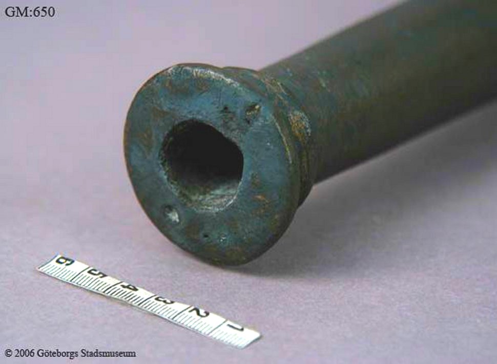

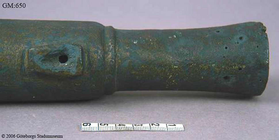

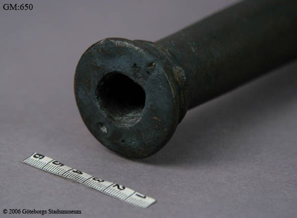

It seems that hook has been broken. Look at the Berns chronics. We can see the muzzle neb of absoulutly similar shape.
Michael, i remember that You discussed barrel that looks like this cut in half
http://www.vikingsword.com/vb/showth...2091&highlight
But I think that it is not early 15 century. I guess it much later
By the way this museum is not so far from Saint-Petersberg. So, It is possibly that I will visit this museum to make some photos of this handgonne
Spiridonov is offline   Reply With Quote

Now that you beat me at my own game ( ) I have to admit you were right: that curious double barrel haquebut actually should be dated 'late 15th c.' as well!
Thank you so much again, and of course additional images would be great if you could take them!
And as to the hook, I of course agree it was either cut of broken off.
Michael

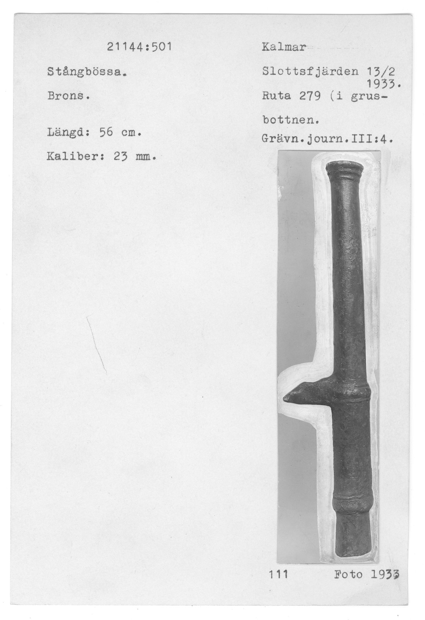

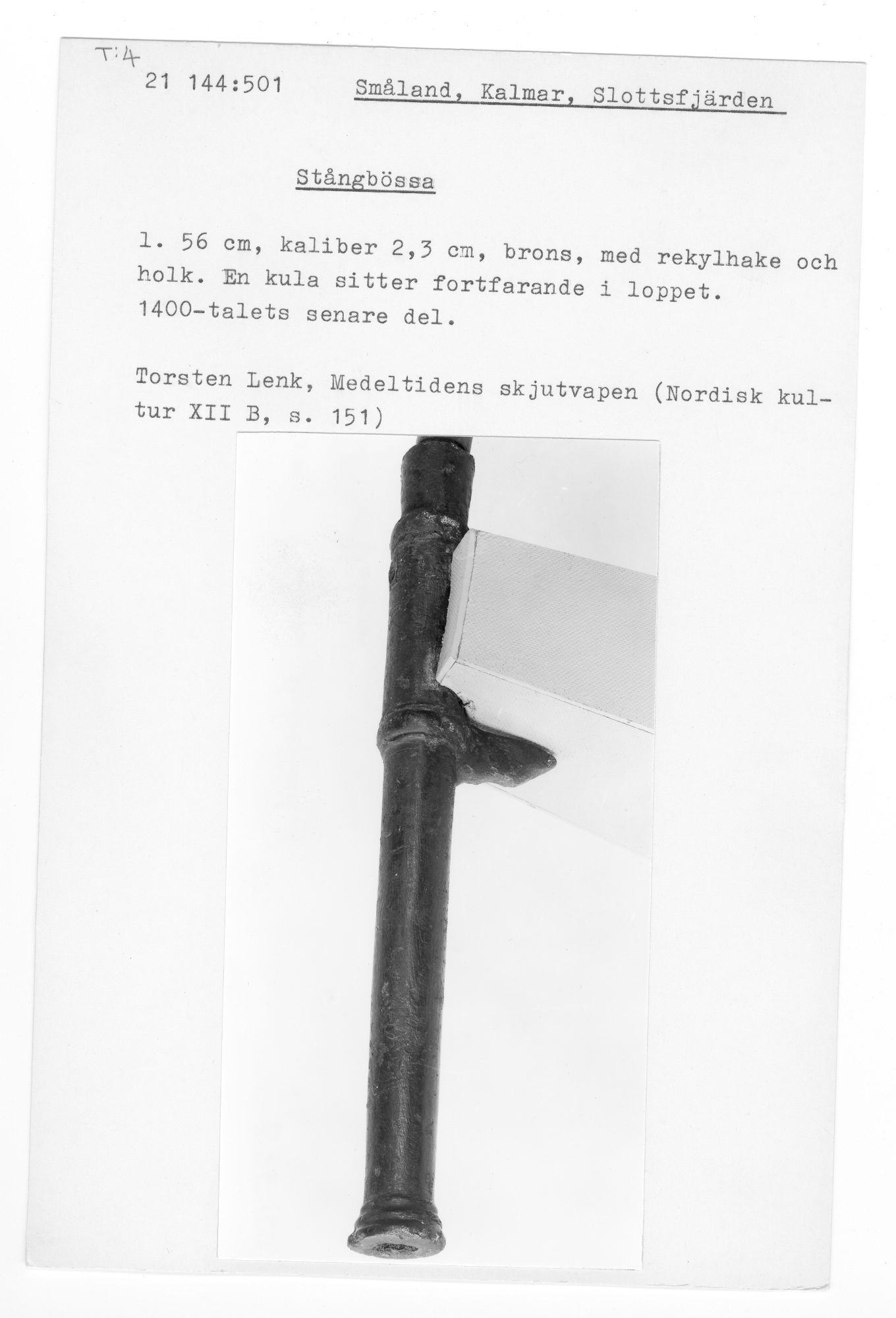

The barrel of absolutely similar type ( handgonne from Kalmar (Sweden))
http://mis.historiska.se/mis/sok/bild.asp?uid=315308
http://catview.historiska.se/catview.../highres/48315
http://catview.historiska.se/catview...highres/103066

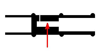

[QUOTE=Spiridonov]I mean chamber tapering inside of barrel (Like on Tannenberg handgonne). [/QUOTE.
I think this should be actually called a bore narrowing behind a bell-mouthed or widened muzzle.
I have often found this with a lot of 15th c. barrels when exactly measured, e.g. with my own famous haquebut barrel dated 1481, which you yourself handled in my collection. I think it was just an easy method to simplify loading the gun, especially with any kind of shot.

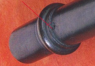

Michael I mean not a bore narrowing but this part of barrel:

Hi Alexander,
I don't know whether this barrel has a narrowed bore at the breech but regarding its date I doubt it has.
Michael

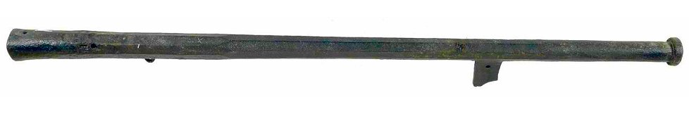

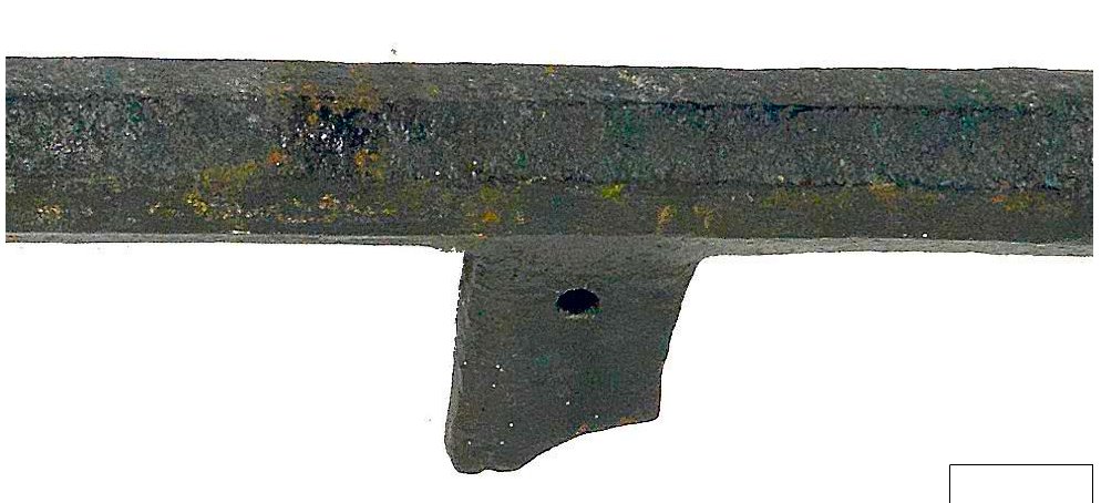

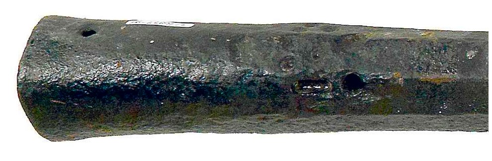

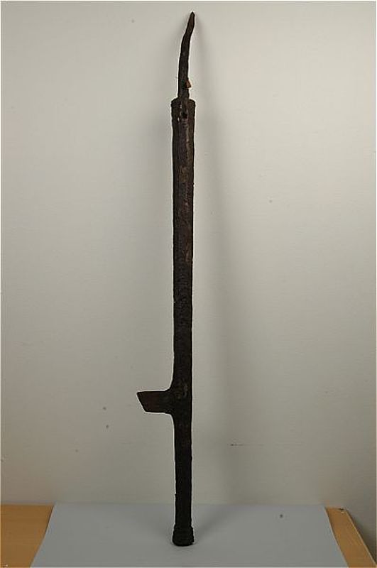

An unusually large (135 cm long) and heavy (ca. 15 kg) wrought iron tiller-socketed haquebut barrel, ca. 1490-1500, sold at the Dorotheum Vienna a few days ago. It fteched more than 9,300 euro.
On top of the end of the socket (tube) you can see the nail hole for fixing the (now missing) tiller. A bit further to the right, there is the touch hole on the right hand side.
As the later-added barrel loops and the hole in the hook indicate, it was alterated for a full stock during its working life, most probably in the 1520's, the Peasants' Wars. It must also have been then that a dove-tailed igniting pan was attached to the touch hole (now missing); the dovetail is still visible.
Michael

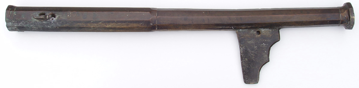

http://www.handgonne.com/gonne_1a.html
Michael, I think that 14 is the wrong date. What do You think about this barrel? It dont't looks like european at all

It's of Chinese origin and probably 18th c., that's why it doesn't look European. There are many of these around on the market.
Michael

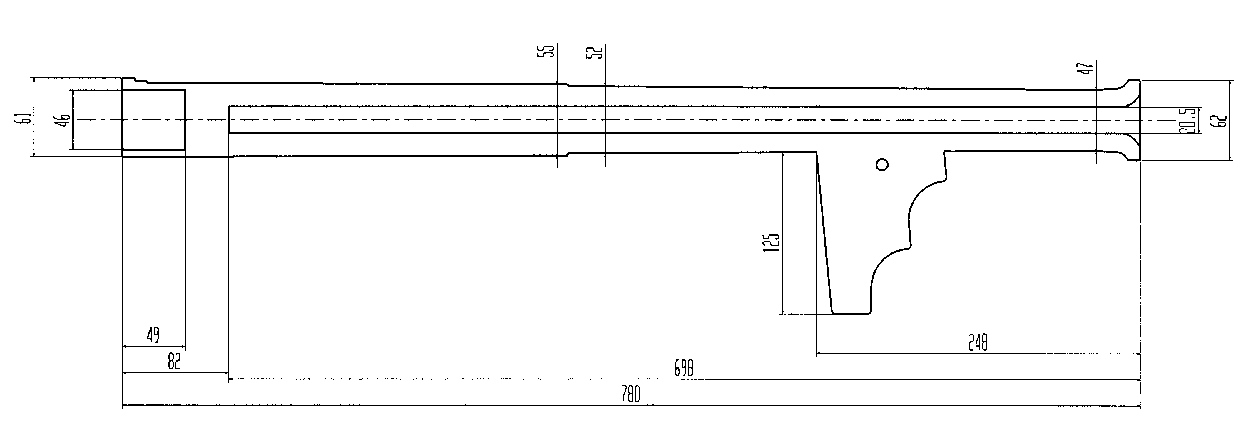

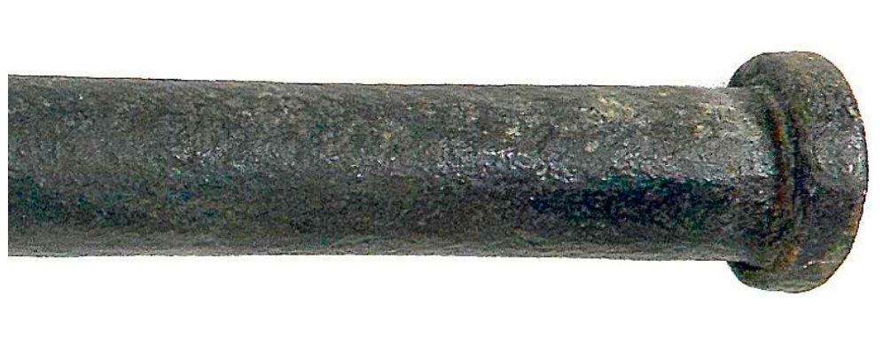

A German bronze hackbut c.1470-1500. Lenght 780 mm,
Bore 20.5 mm Weight 11.8 kg
Swordfish is offline   Reply With Quote

Good job, Swordfish,
Where is this barrel, which was originally fitted with a tiller stock and later alterated to full-stock, preserved?
Michael

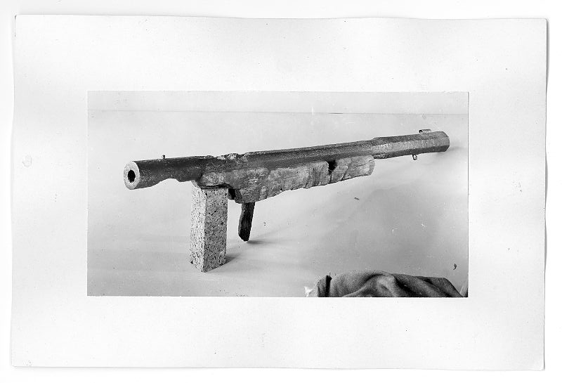

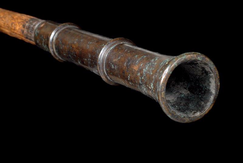

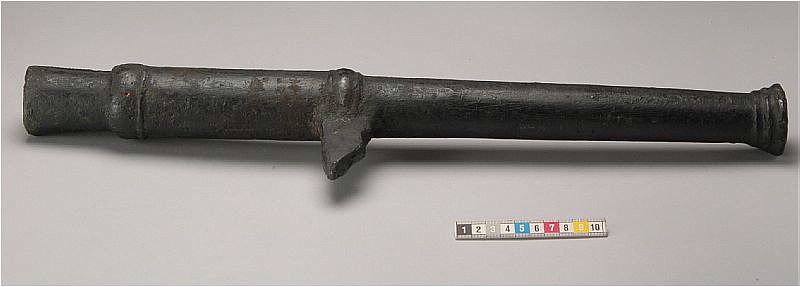

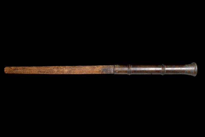

Here are two hackbuts from Sweden:
http://www.historiska.se/data/?foremal=123316
With remains of the wooden shaft. Found in Skåne in the region of Norra Åsum, this one is undated. Barrel 101 cm, calibre 19 mm
http://www.historiska.se/data/?foremal=115866
Found in Stockholm, dated to the late middle ages. Barrel 106 cm, calibre not mentioned.
